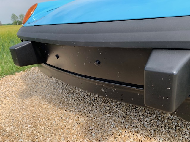

Hi there,
does anyone know what kind of screws/ plugs I could use to cover the front license plate 'squreish' holes...?
thanks
S.Attached Image

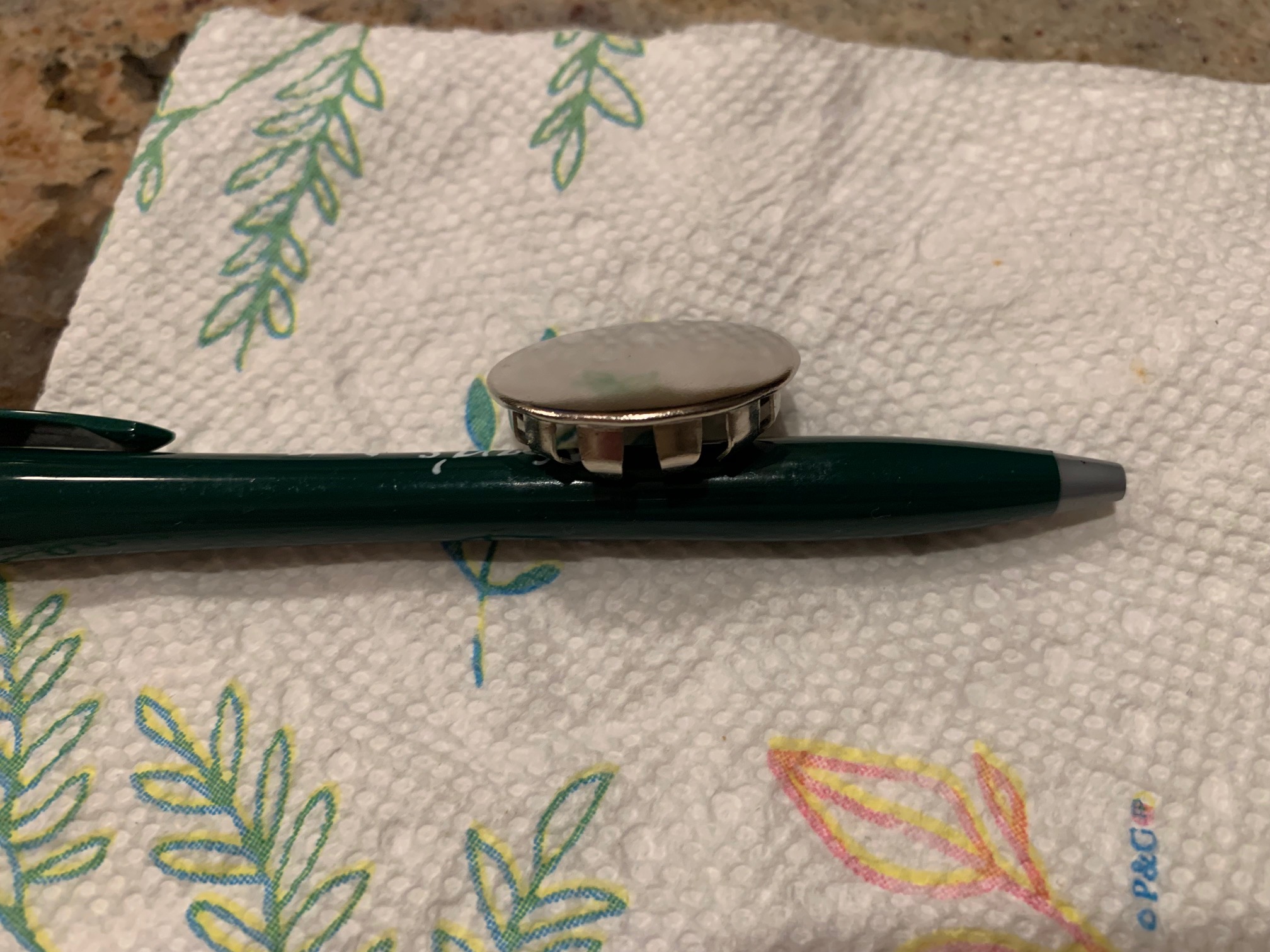

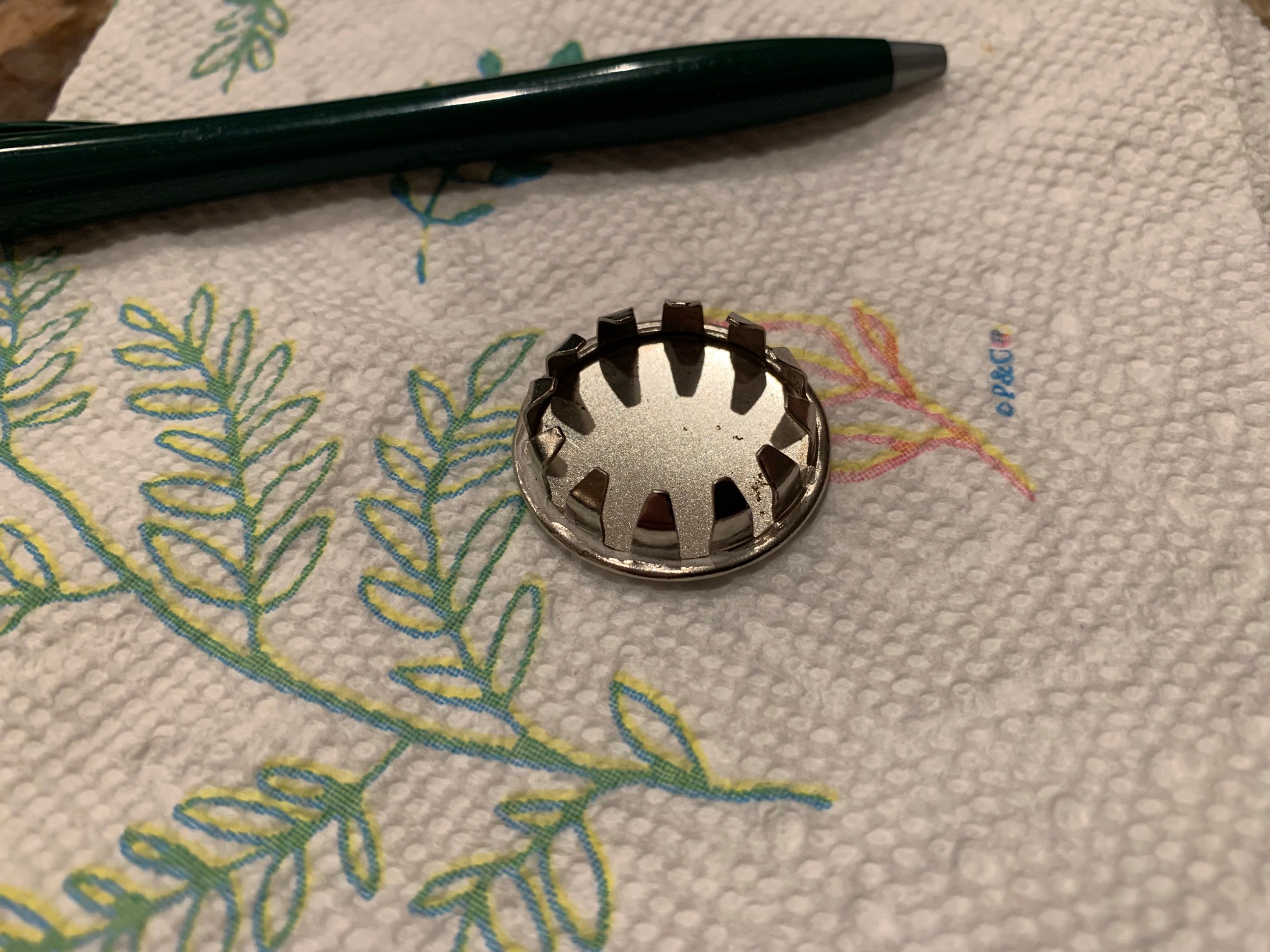

Local hardware store-SS Plugs. Cut off the top and bottom tabs to put a round peg in a square hole.

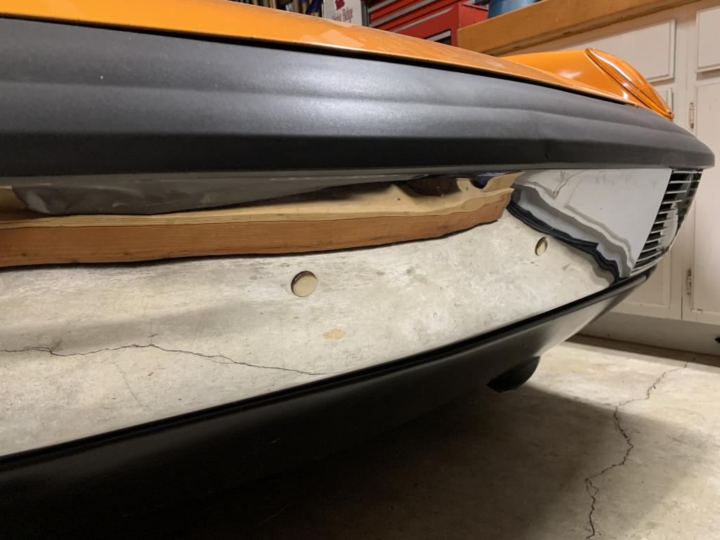

I went to Ace Hardware and bought 2 chrome cap screws and then pulled the screw receivers out of the bumper and installed the 2 cap screws. O had the bumper off at the time and they look great. Cost about $3. (IMG:style_emoticons/default/beerchug.gif)

QUOTE(gonzo54 @ Nov 23 2021, 03:08 PM) *
@Stef914 Here are a couple of pictures-
