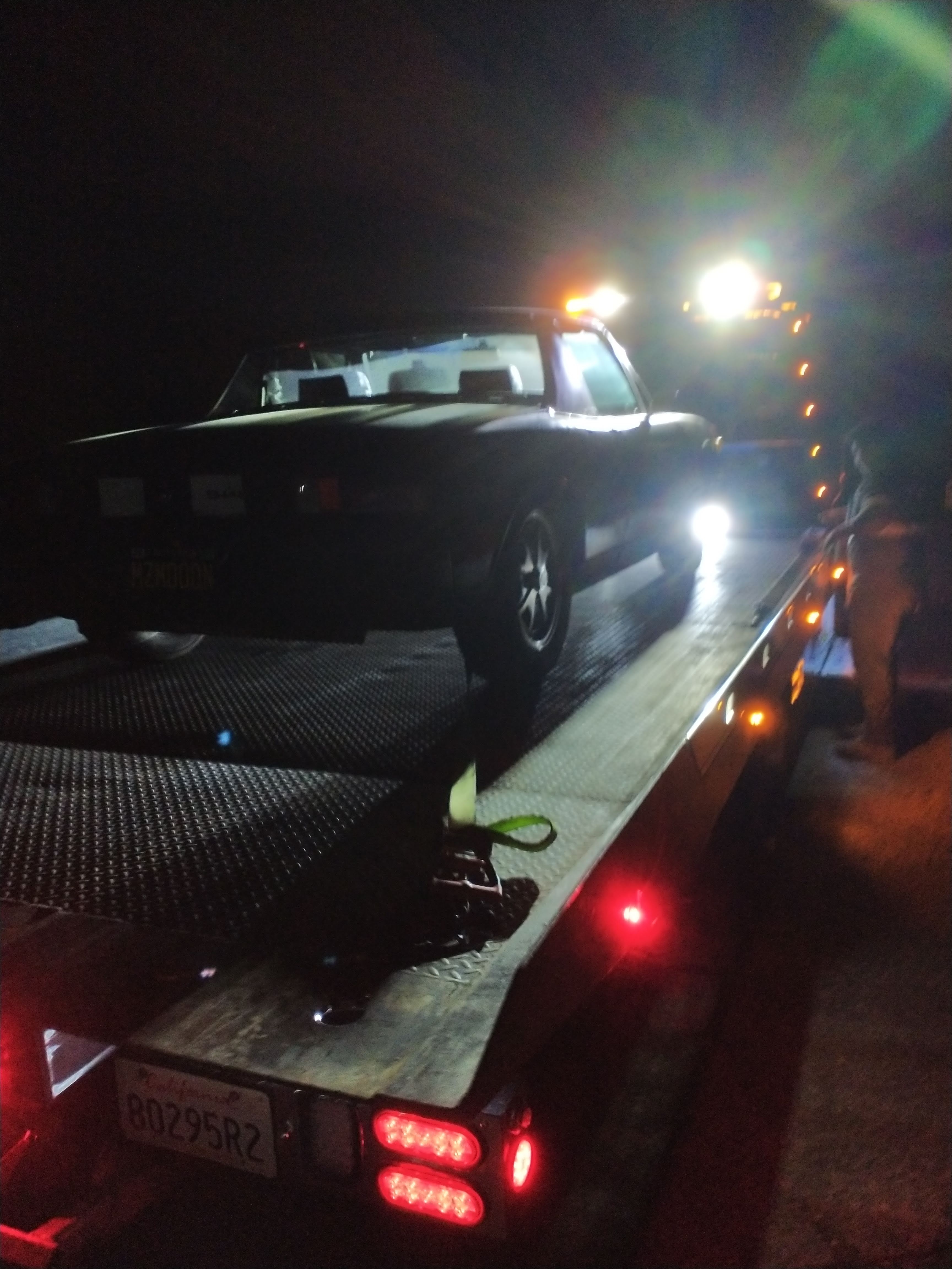

> Got an Uber for the 914 tonight, not sure what happened

It felt like I ran out of gas.
Going to have to give it the once over in the morning
