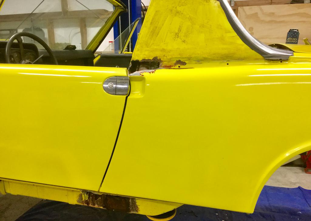

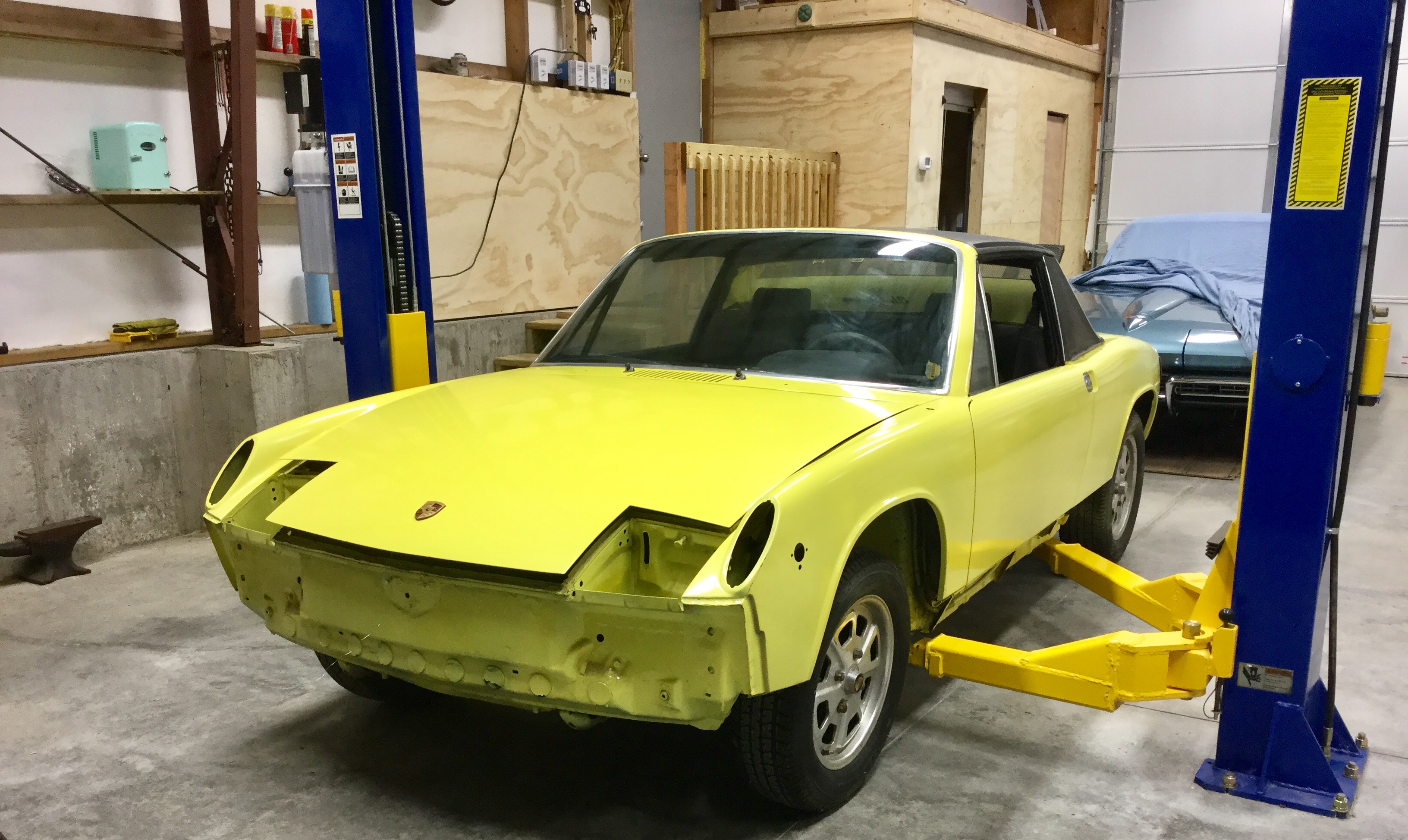

Here she is... when I initially started

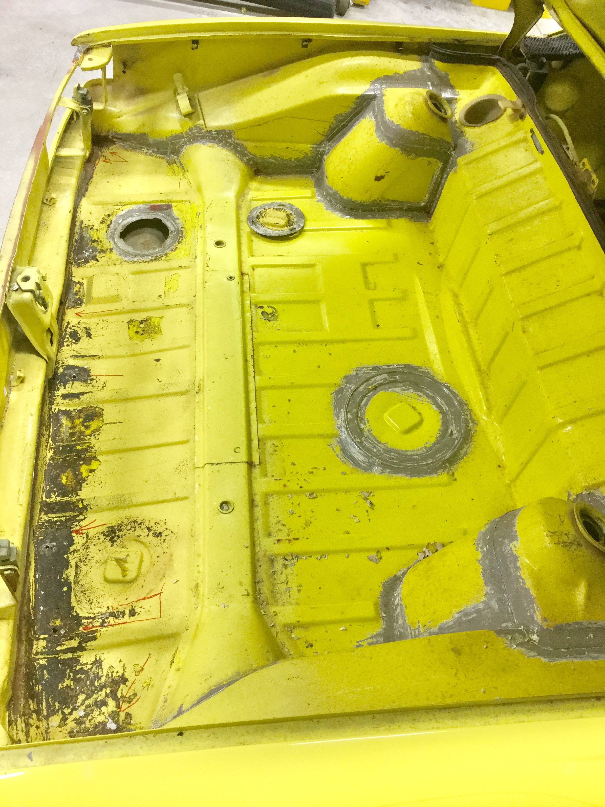

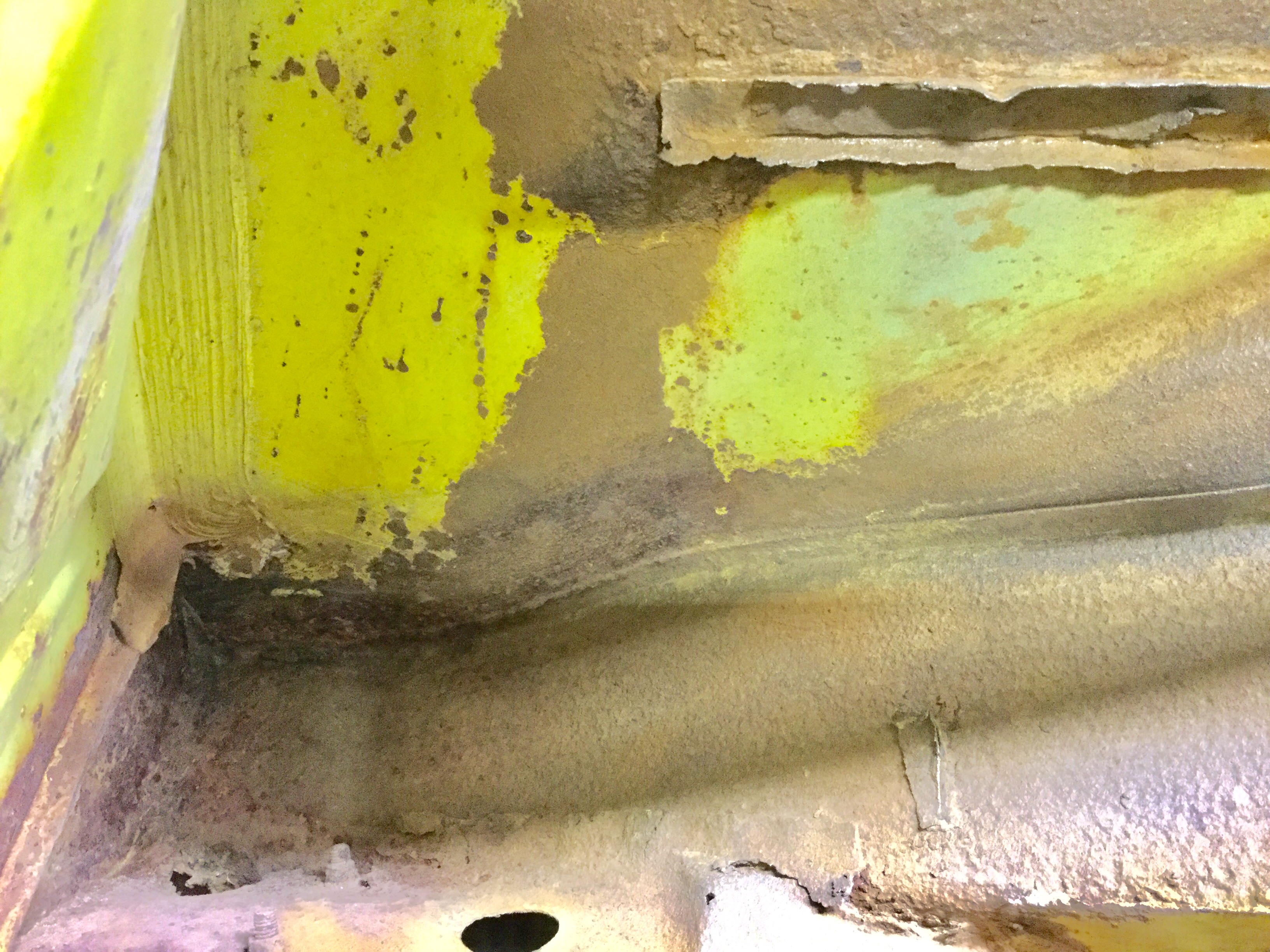

Alain V.   “Hell hole” area didn’t look too bad, at fir...   Jan 2 2022, 03:42 PM

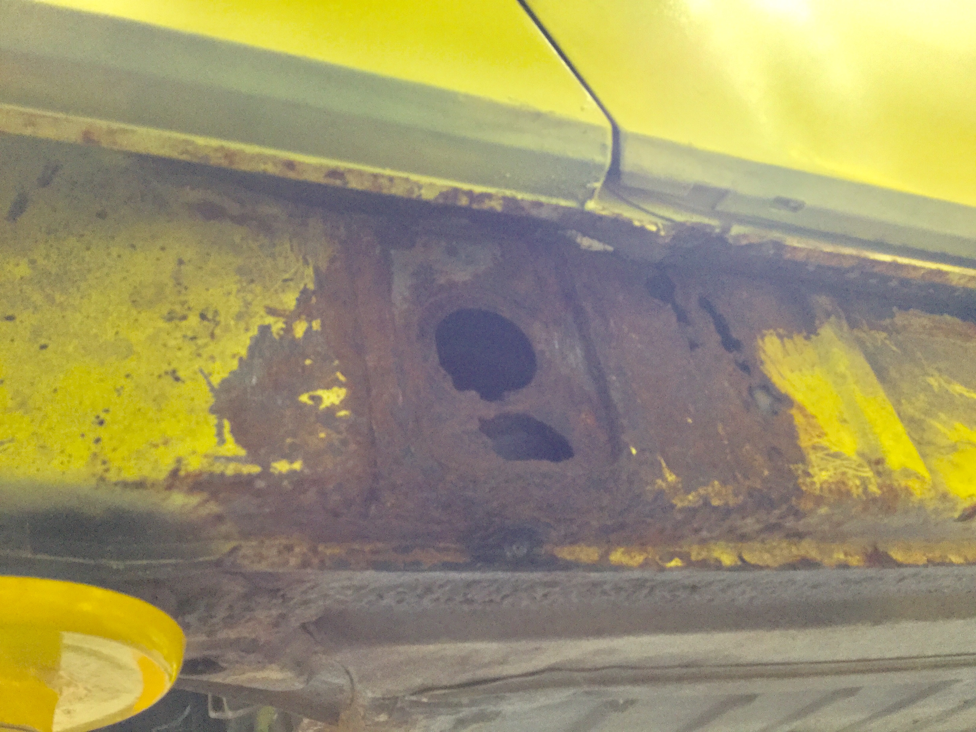

Alain V.   Outside of jack pad area looked a little rough   Jan 2 2022, 03:45 PM

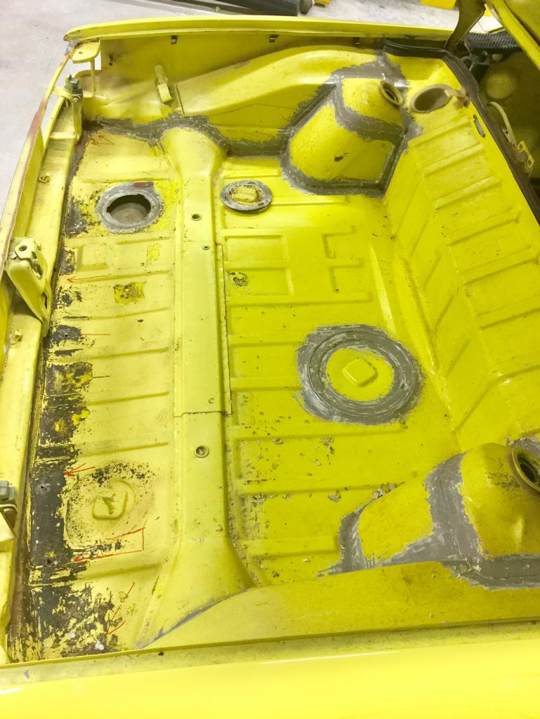

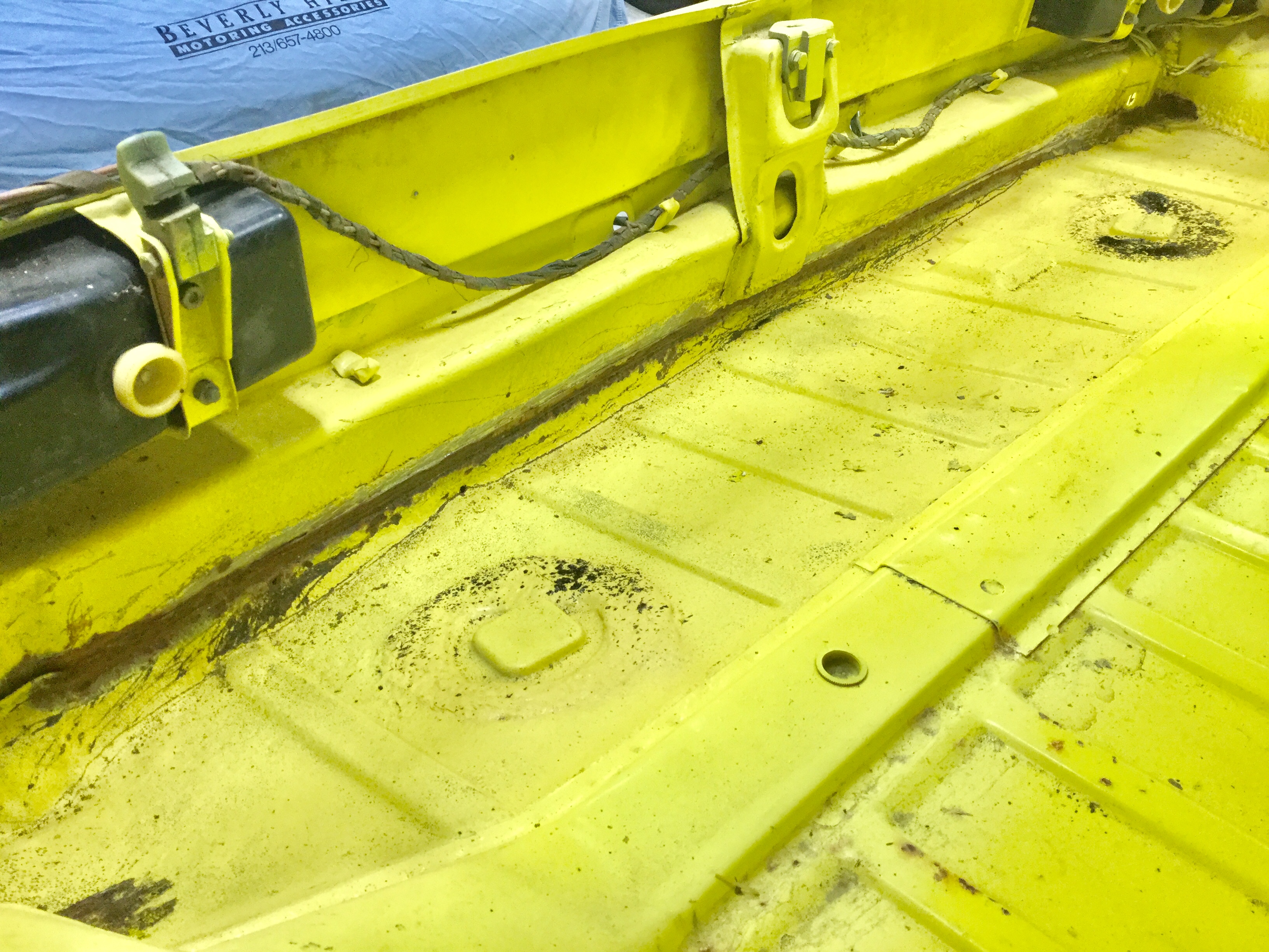

Alain V.   Had typical holes across the rear of the trunk flo...   Jan 2 2022, 03:46 PM
Alain V.   Rear of floor pan looked not too bad.   Jan 2 2022, 03:48 PM

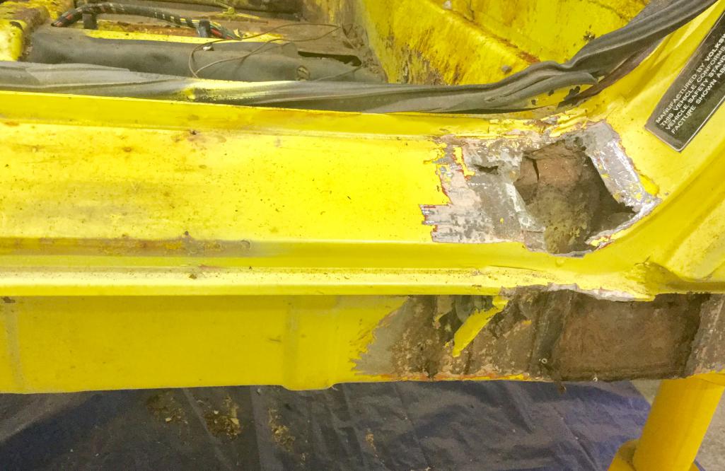

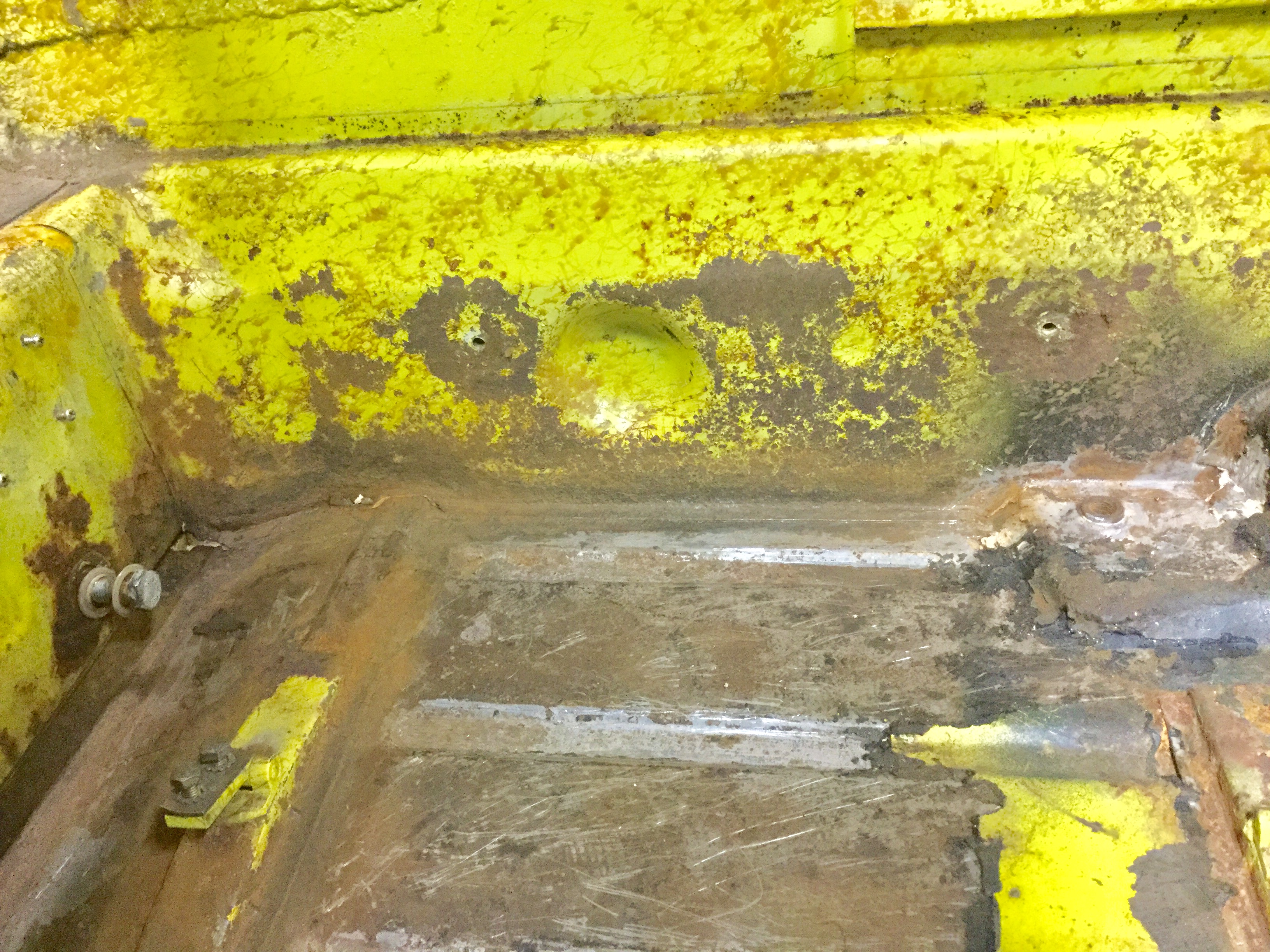

Alain V.   First little surprise was bondo hiding a hole here...   Jan 2 2022, 03:50 PM

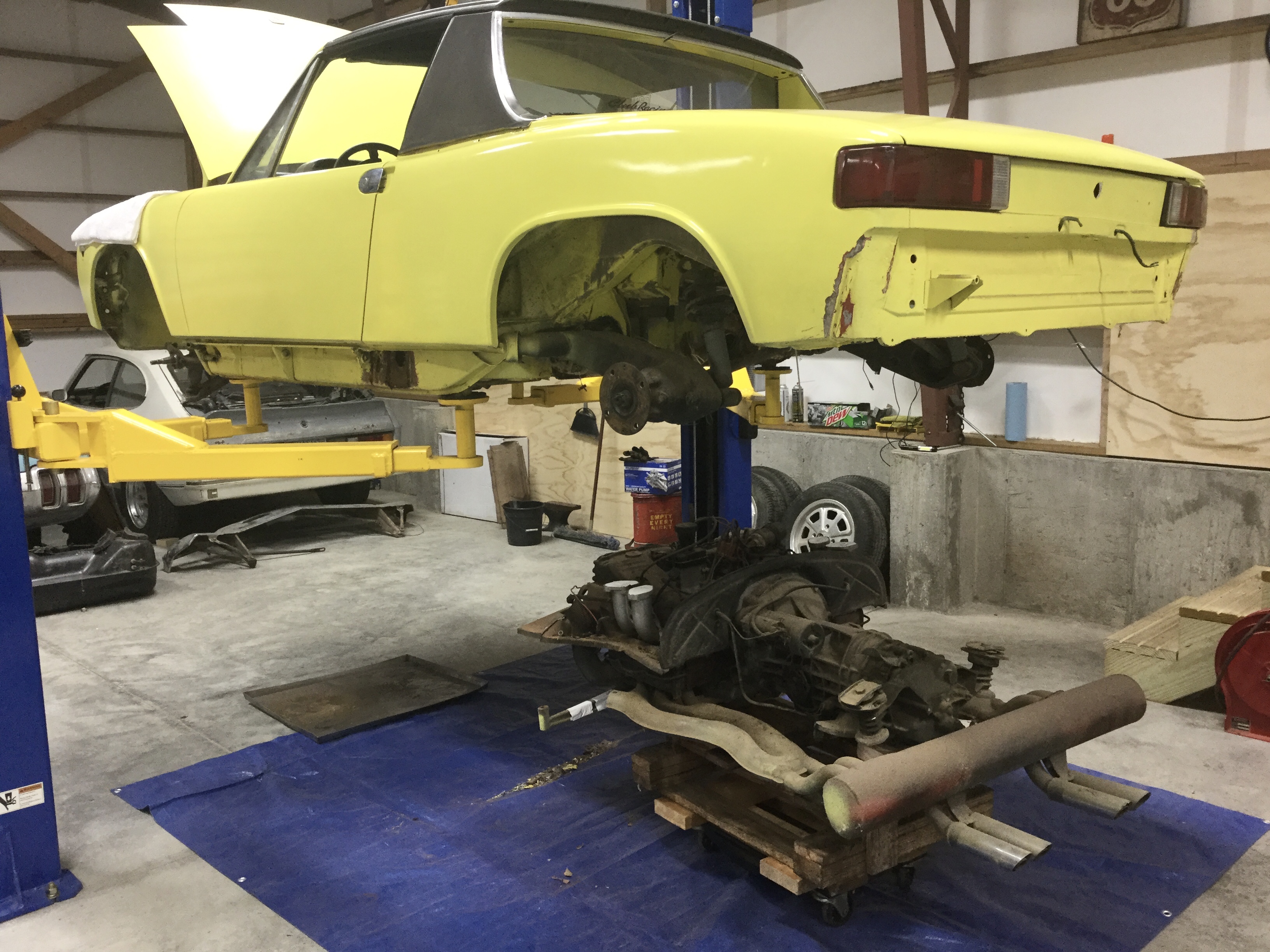

Alain V.   Dropping the drivetrain out.   Jan 2 2022, 03:51 PM

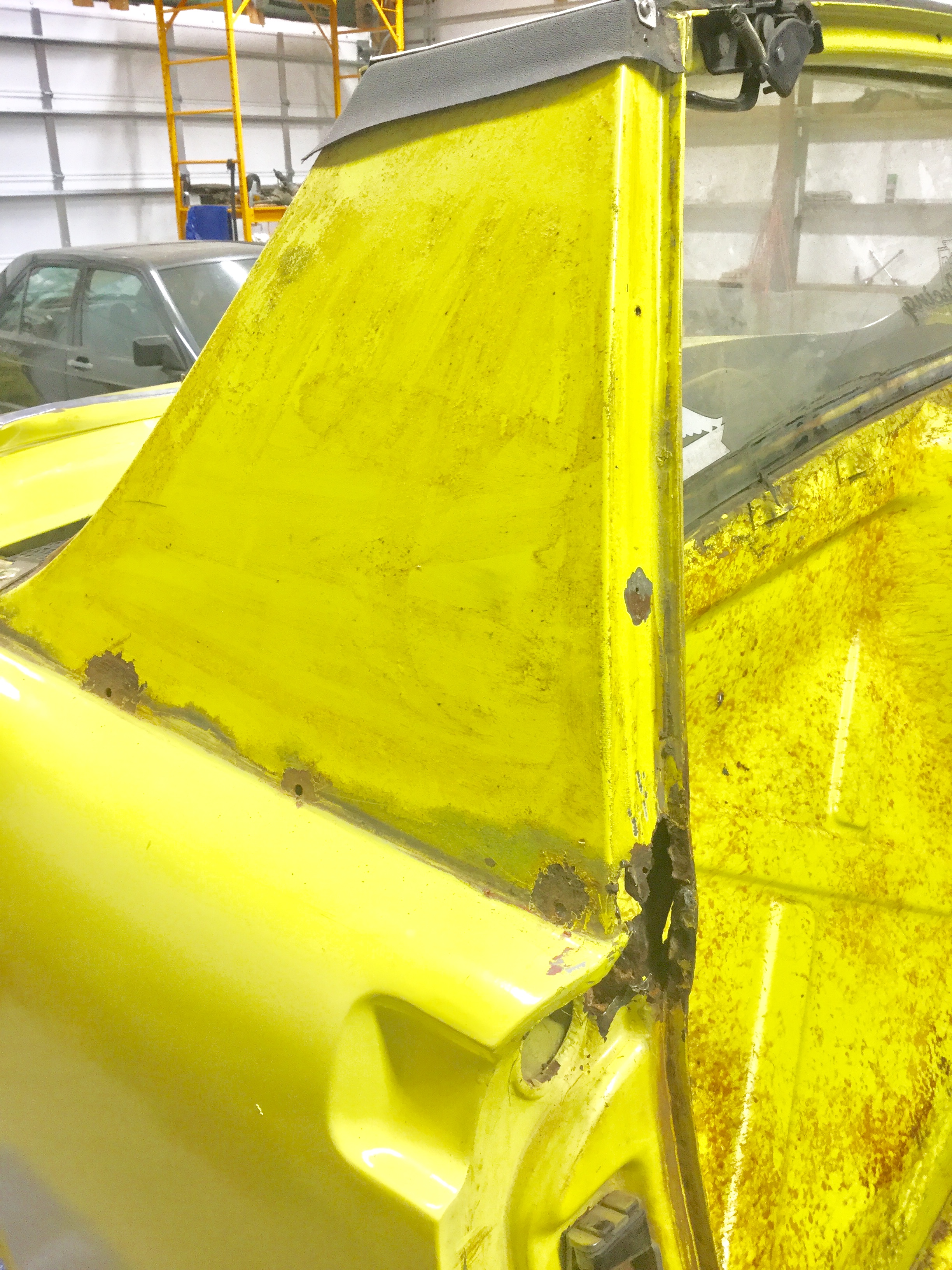

Alain V.   Yup, both sides had little bubbles that just grew ...   Jan 2 2022, 03:54 PM

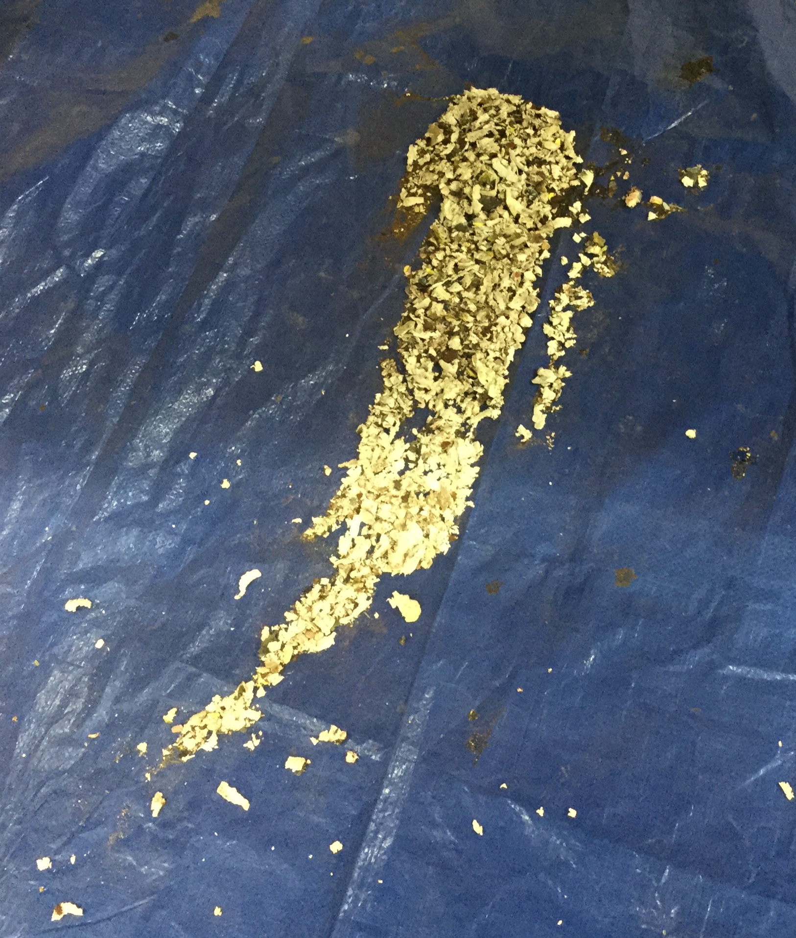

Alain V.   This stuff is “The Devil” boooooo! Eats 91...   Jan 2 2022, 03:57 PM

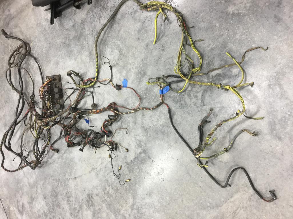

Alain V.   I even yanked out the old crusty wiring harness. I...   Jan 2 2022, 03:59 PM

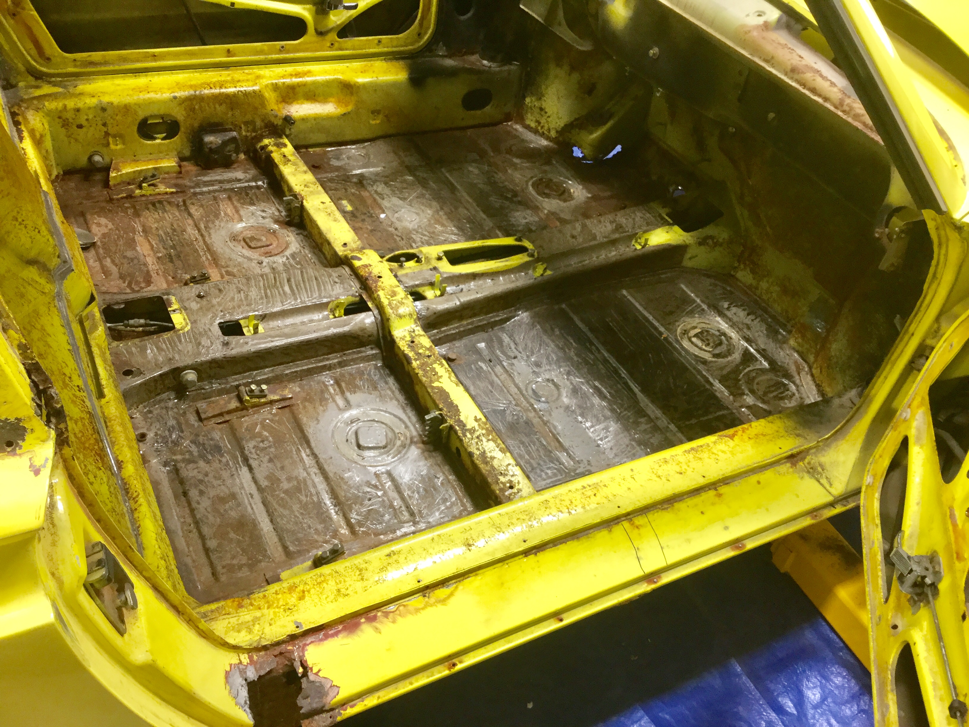

Alain V.   Floor pan actually seems saveable. Just has a bad ...   Jan 2 2022, 04:01 PM
Alain V.   Trunk floor is Swiss cheese   Jan 2 2022, 04:02 PM

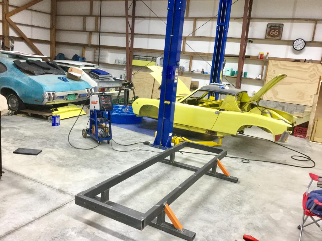

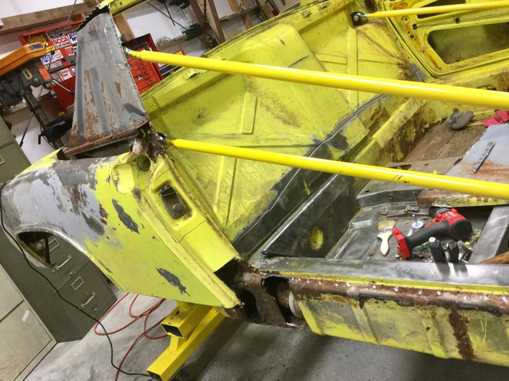

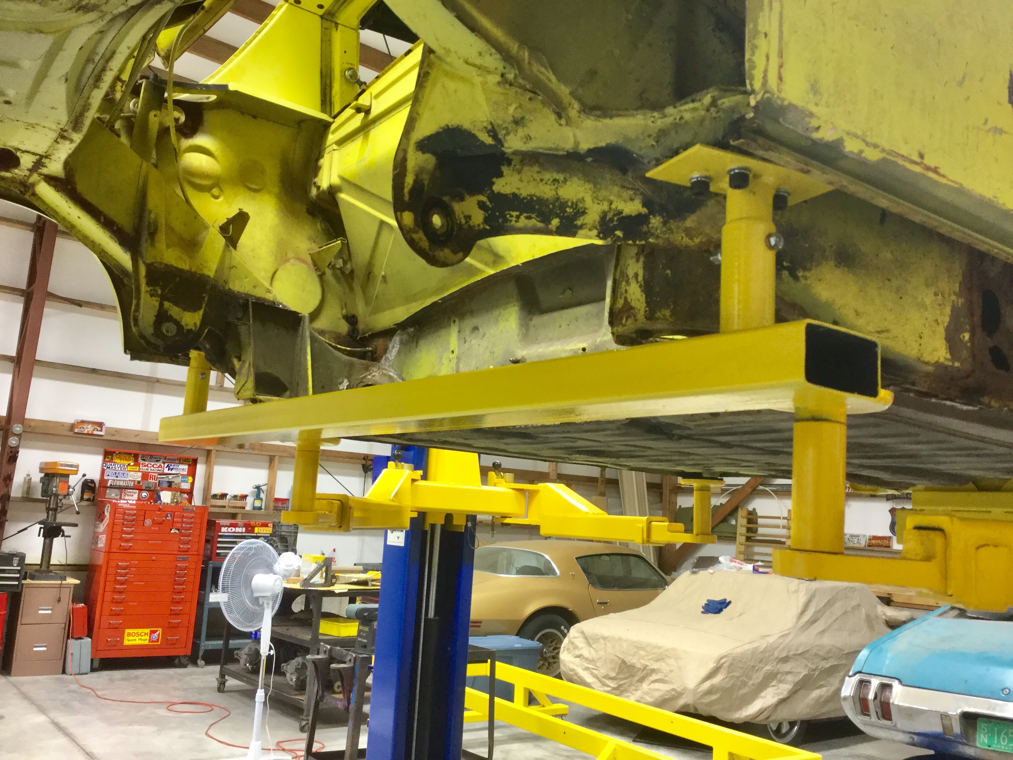

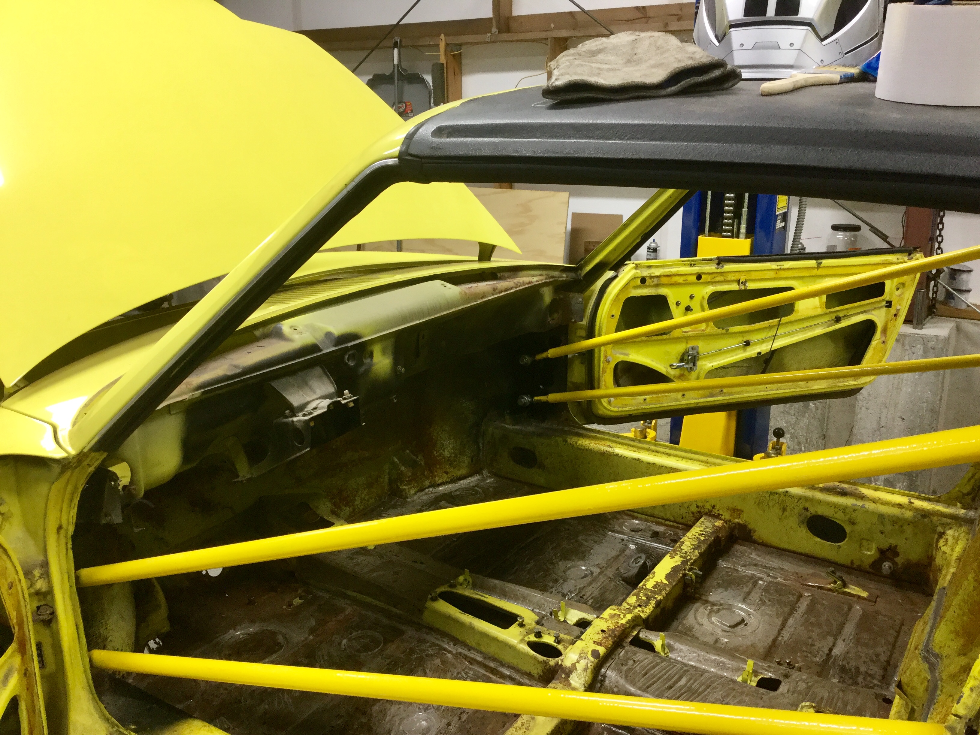

Alain V.   Went ahead and made up some door opening braces. I...   Jan 2 2022, 04:08 PM

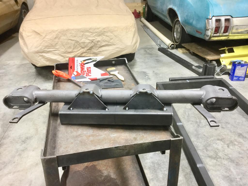

Alain V.   Starting to make cross braces and supports for a c...   Jan 2 2022, 04:11 PM
Alain V.   Cart construction   Jan 2 2022, 04:12 PM
Alain V.   Rear suspension mount. Also added one at the trans...   Jan 2 2022, 04:15 PM

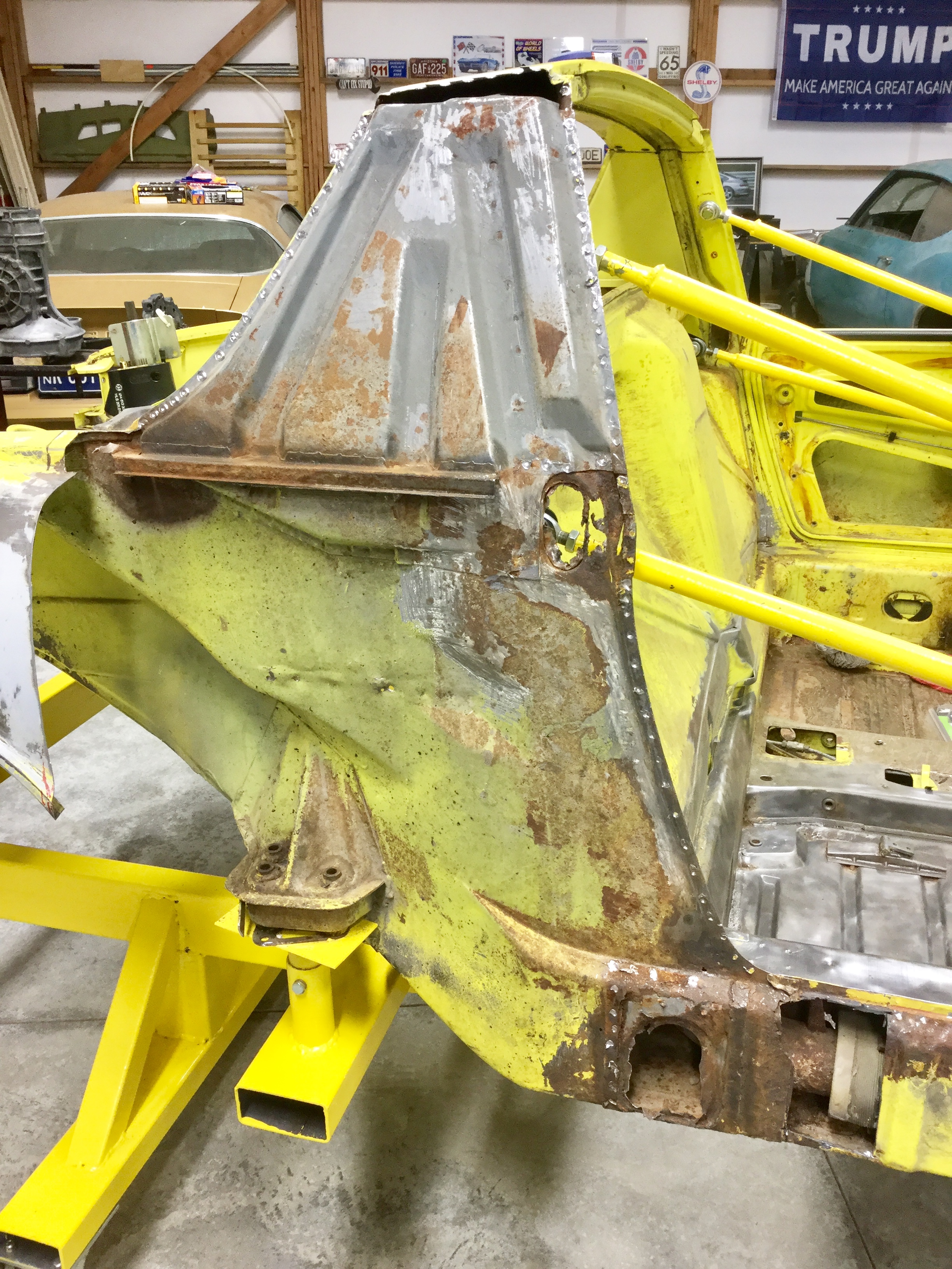

Alain V.   Uh oh, suspension console is toast.   Jan 2 2022, 04:27 PM
Alain V.   Made a simple jig to locate the hole for the contr...   Jan 2 2022, 04:28 PM
Alain V.   Removed old console piece   Jan 2 2022, 04:30 PM
Alain V.   Need to make a small patch for the skin behind the...   Jan 2 2022, 04:31 PM

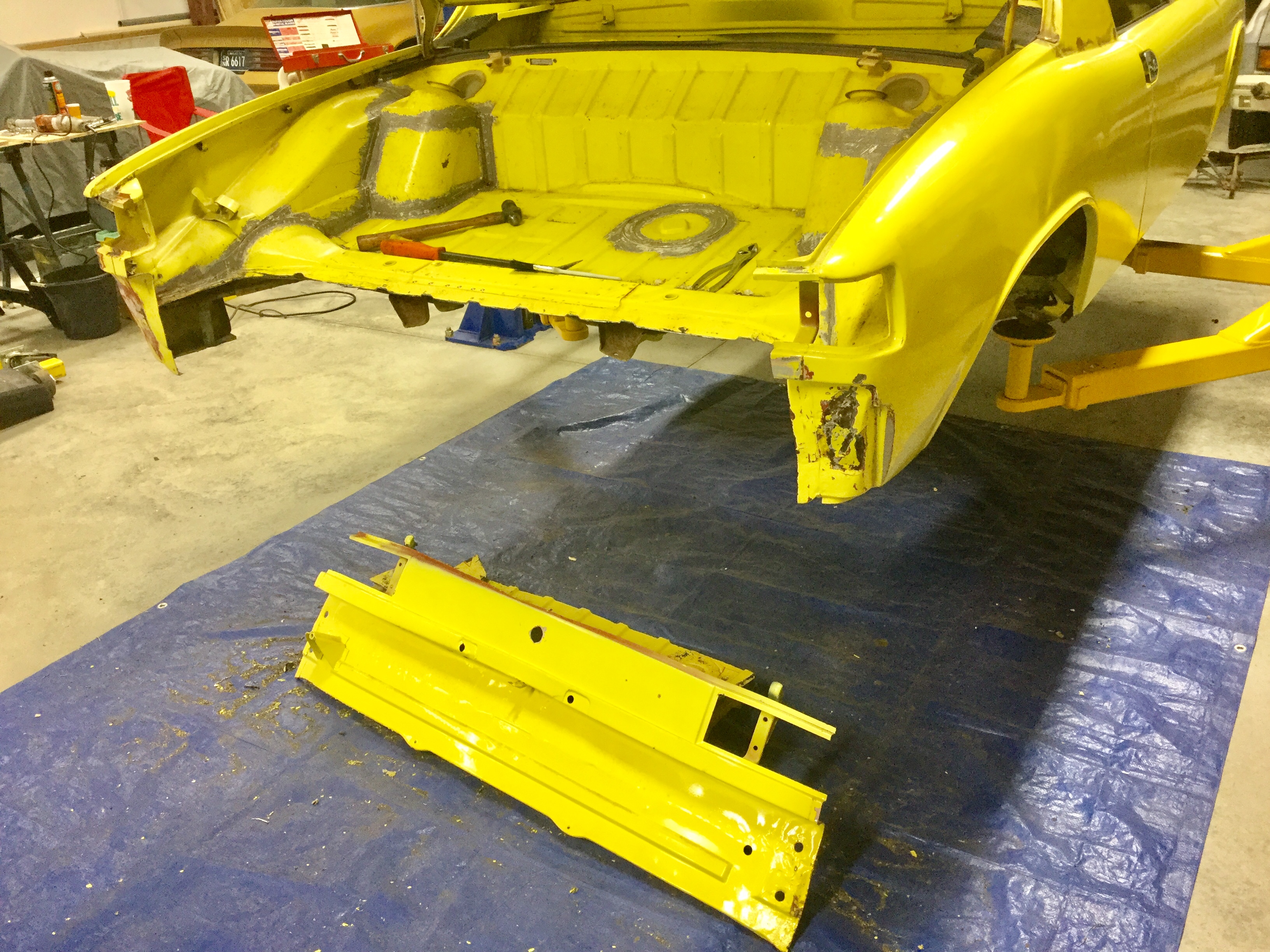

Alain V.   Starting to prep my new trunk panel and donor car ...   Jan 2 2022, 04:43 PM
Alain V.   In additi9on to the original tail panel being full...   Jan 2 2022, 04:46 PM
Alain V.   In order to get a decent fit, I made a “flexible...   Jan 2 2022, 04:52 PM
Alain V.   “Flexible shape pattern” set onto the body wit...   Jan 2 2022, 04:54 PM
