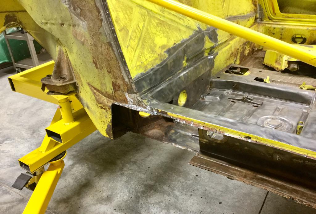

Alain V.   It must have been in a small rear end collision at...   Jan 2 2022, 04:05 PM

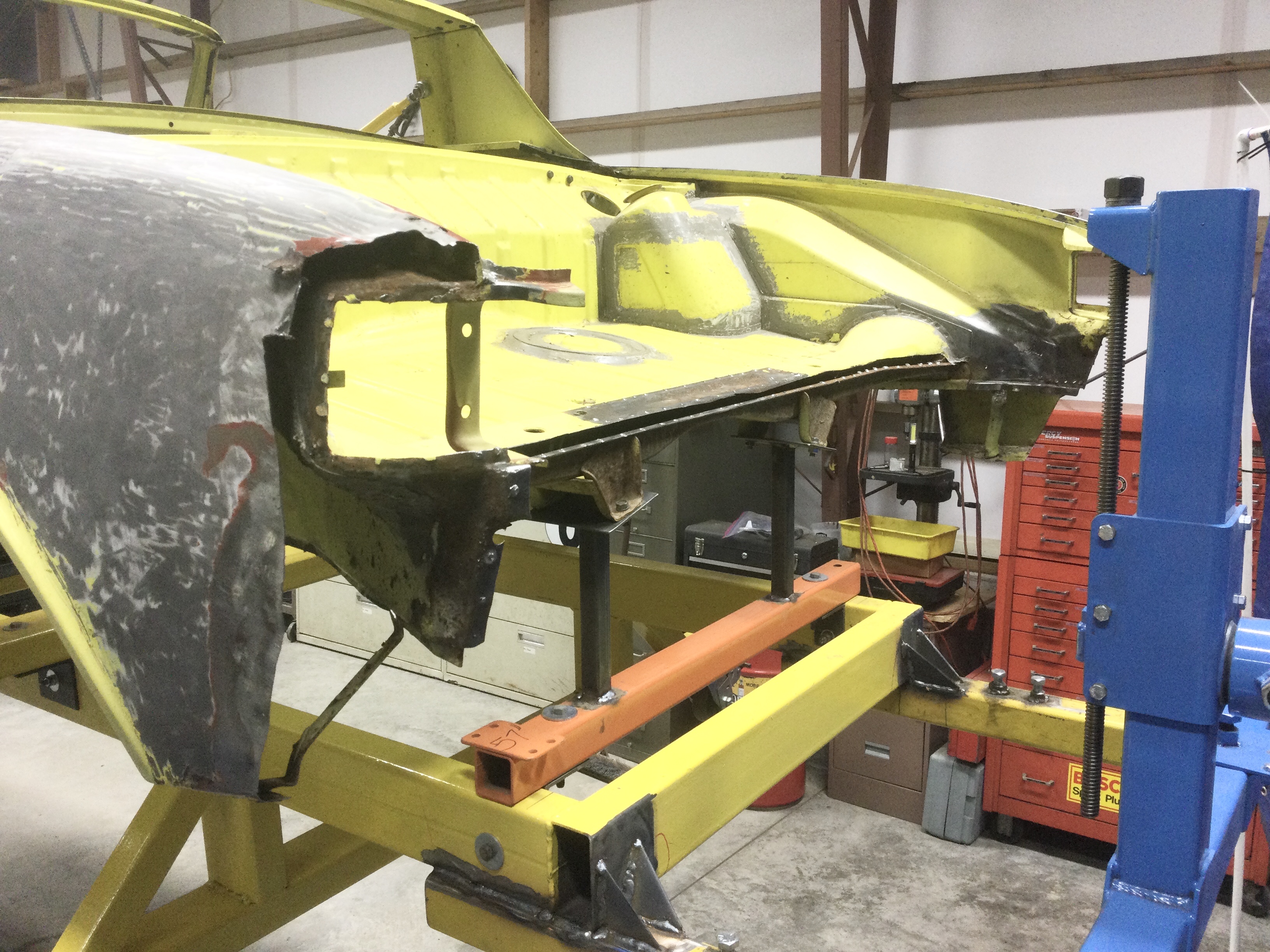

Alain V.   Went ahead and made up some door opening braces. I...   Jan 2 2022, 04:08 PM
Alain V.   Starting to make cross braces and supports for a c...   Jan 2 2022, 04:11 PM
Alain V.   Cart construction   Jan 2 2022, 04:12 PM
Alain V.   Rear suspension mount. Also added one at the trans...   Jan 2 2022, 04:15 PM

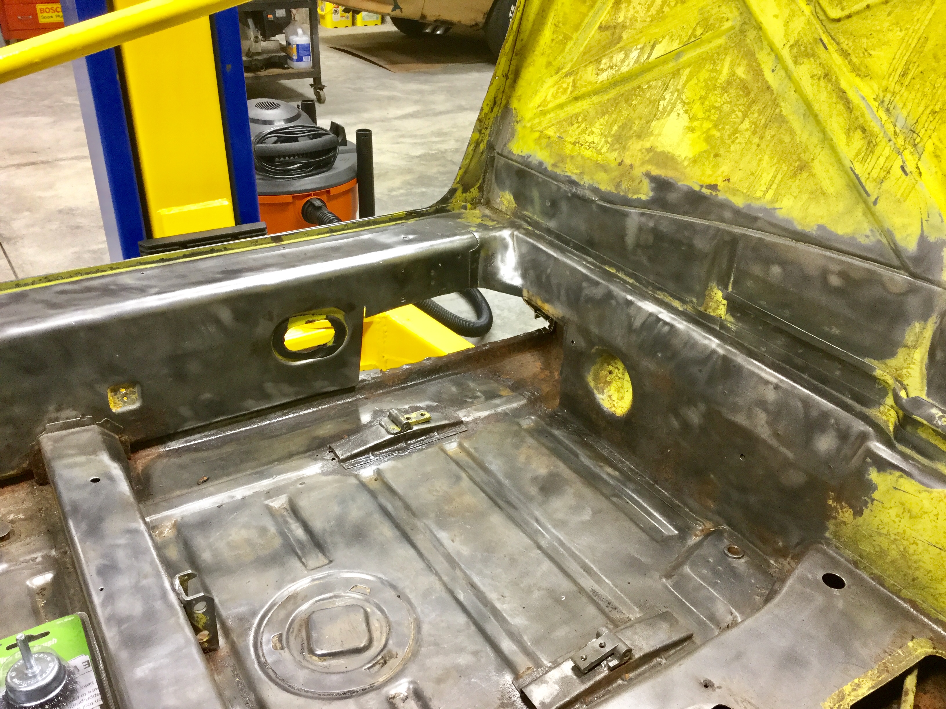

Alain V.   Time to start the rust hunt   Jan 2 2022, 04:17 PM
Alain V.   First “lesson learned”. I should have left the...   Jan 2 2022, 04:19 PM
Alain V.   My first attempt at installing a patch that I cut ...   Jan 2 2022, 04:21 PM

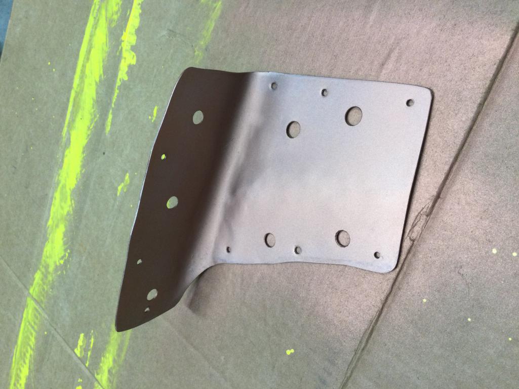

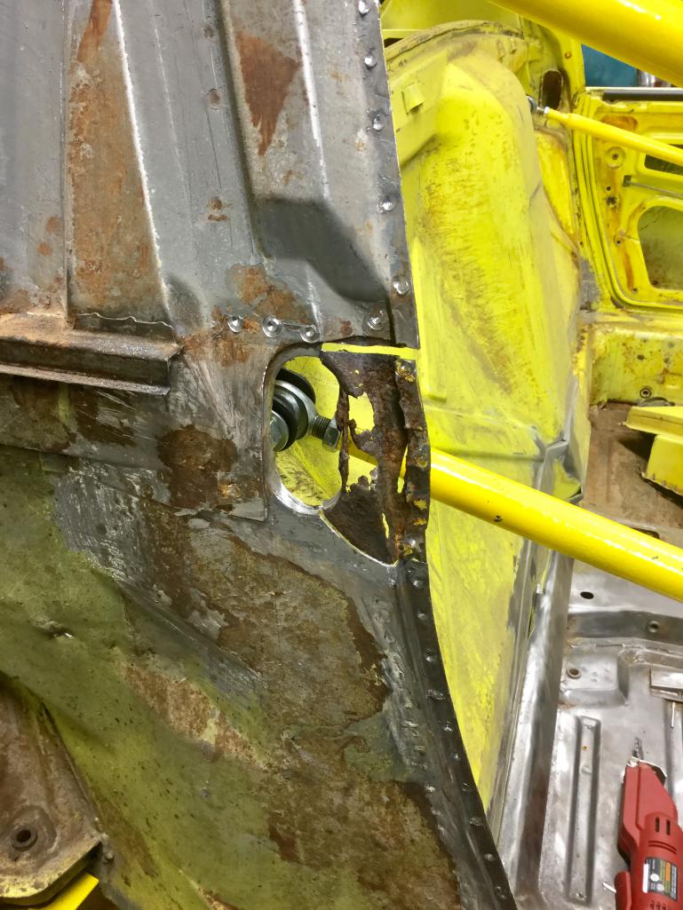

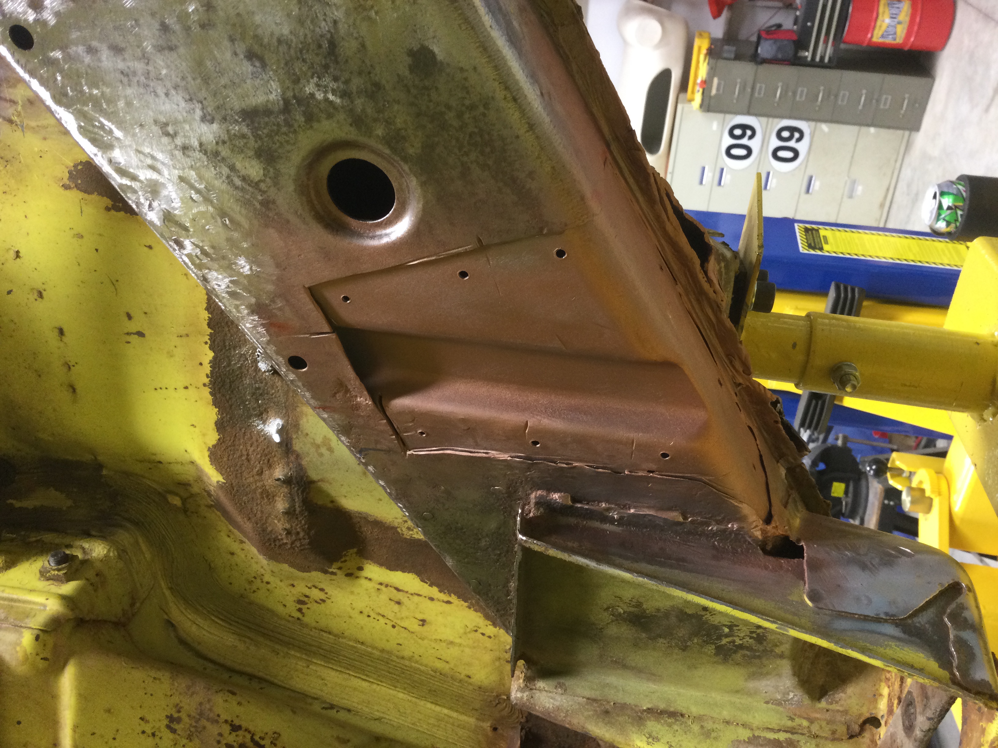

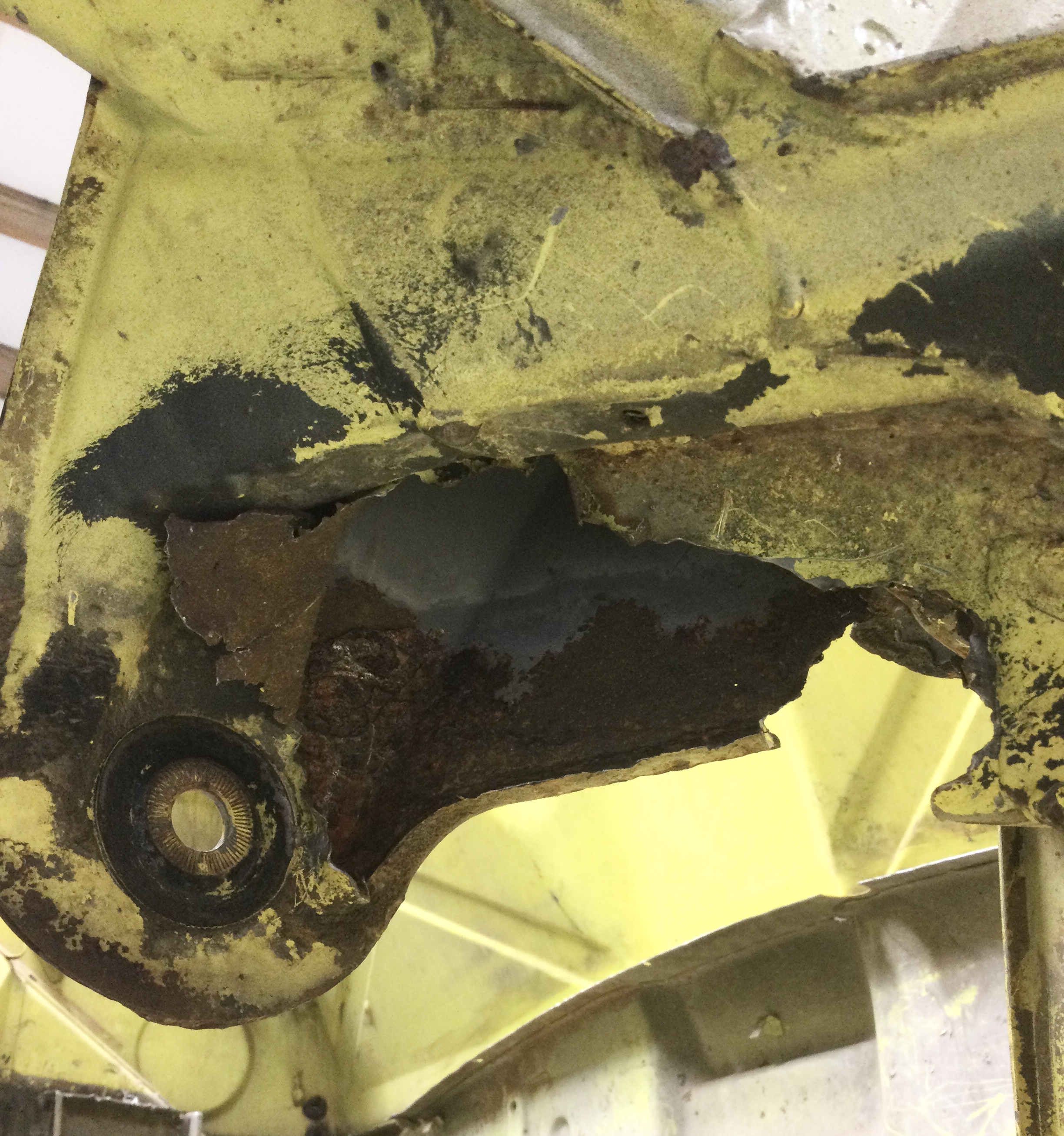

Alain V.   Uh oh, suspension console is toast.   Jan 2 2022, 04:27 PM

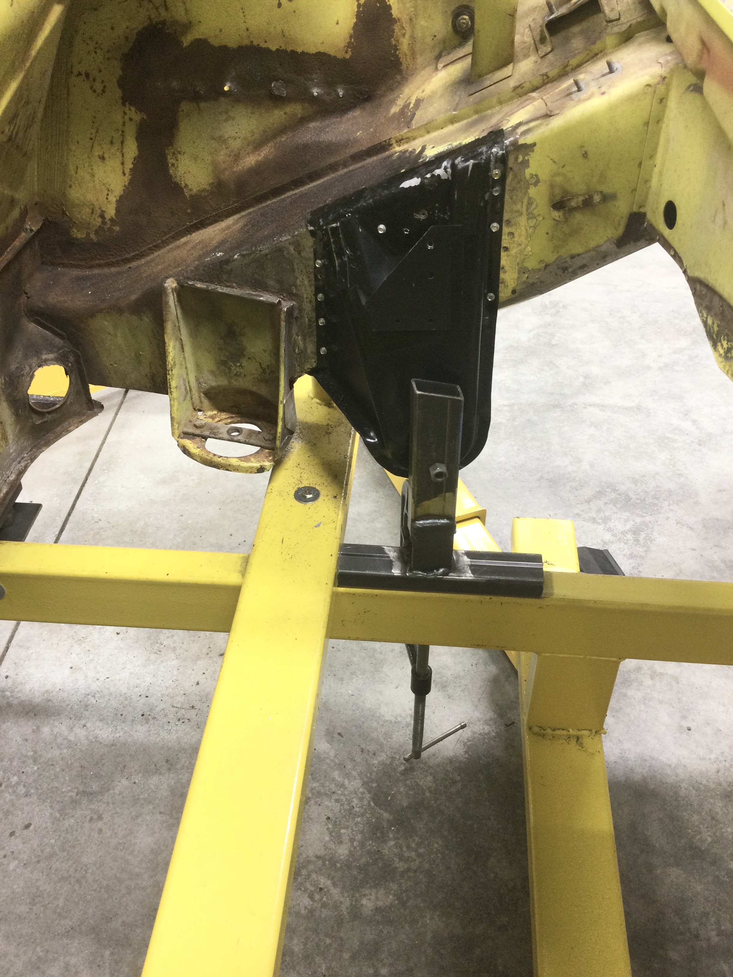

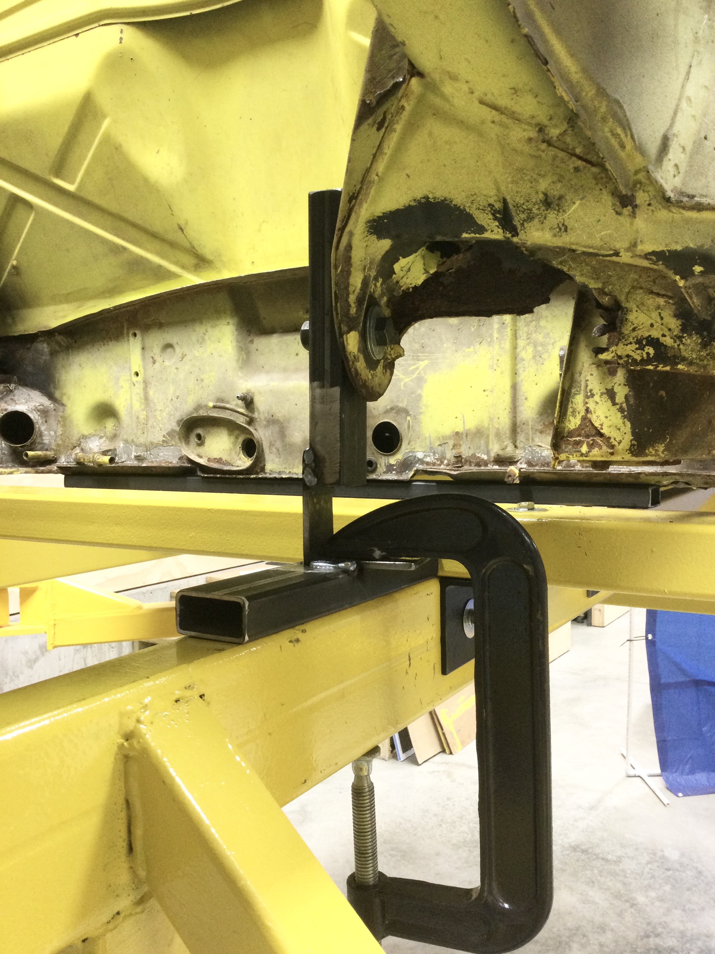

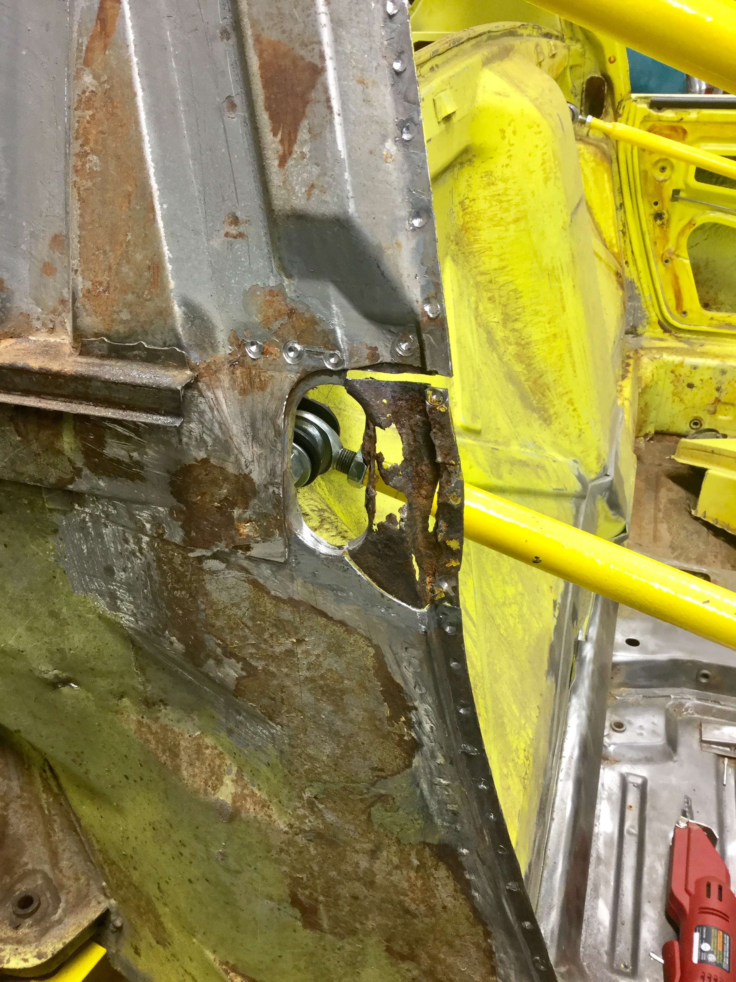

Alain V.   Made a simple jig to locate the hole for the contr...   Jan 2 2022, 04:28 PM

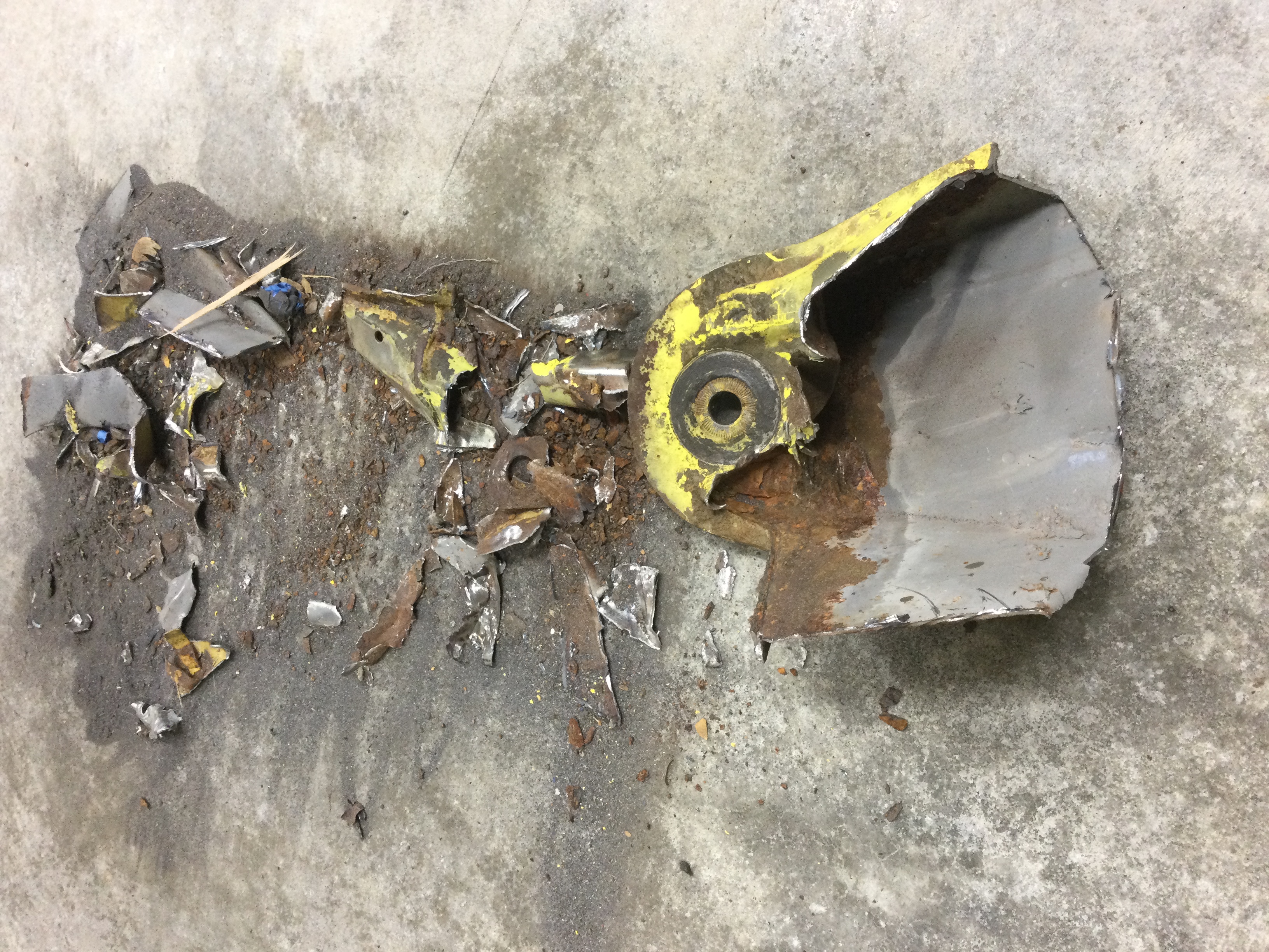

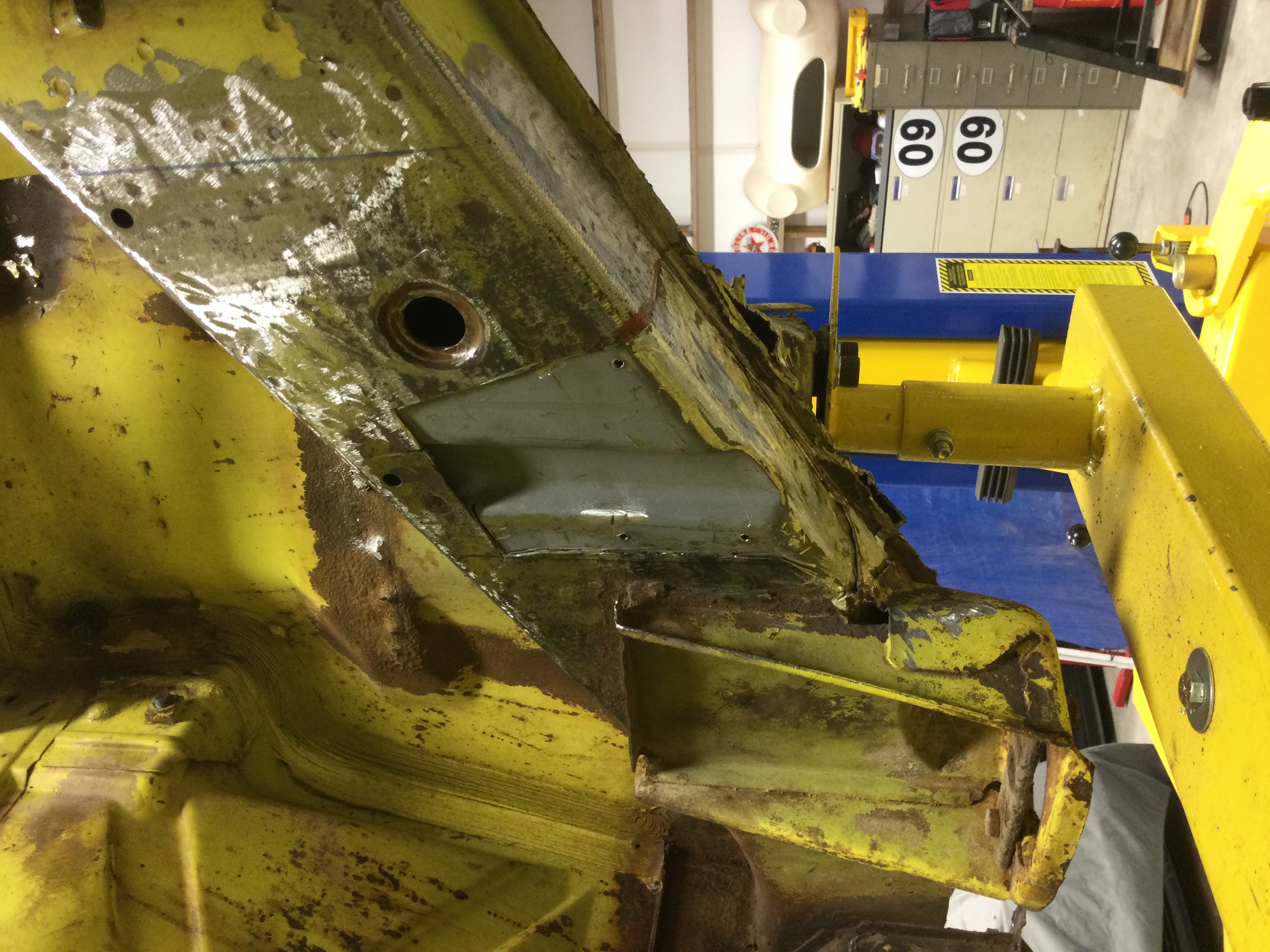

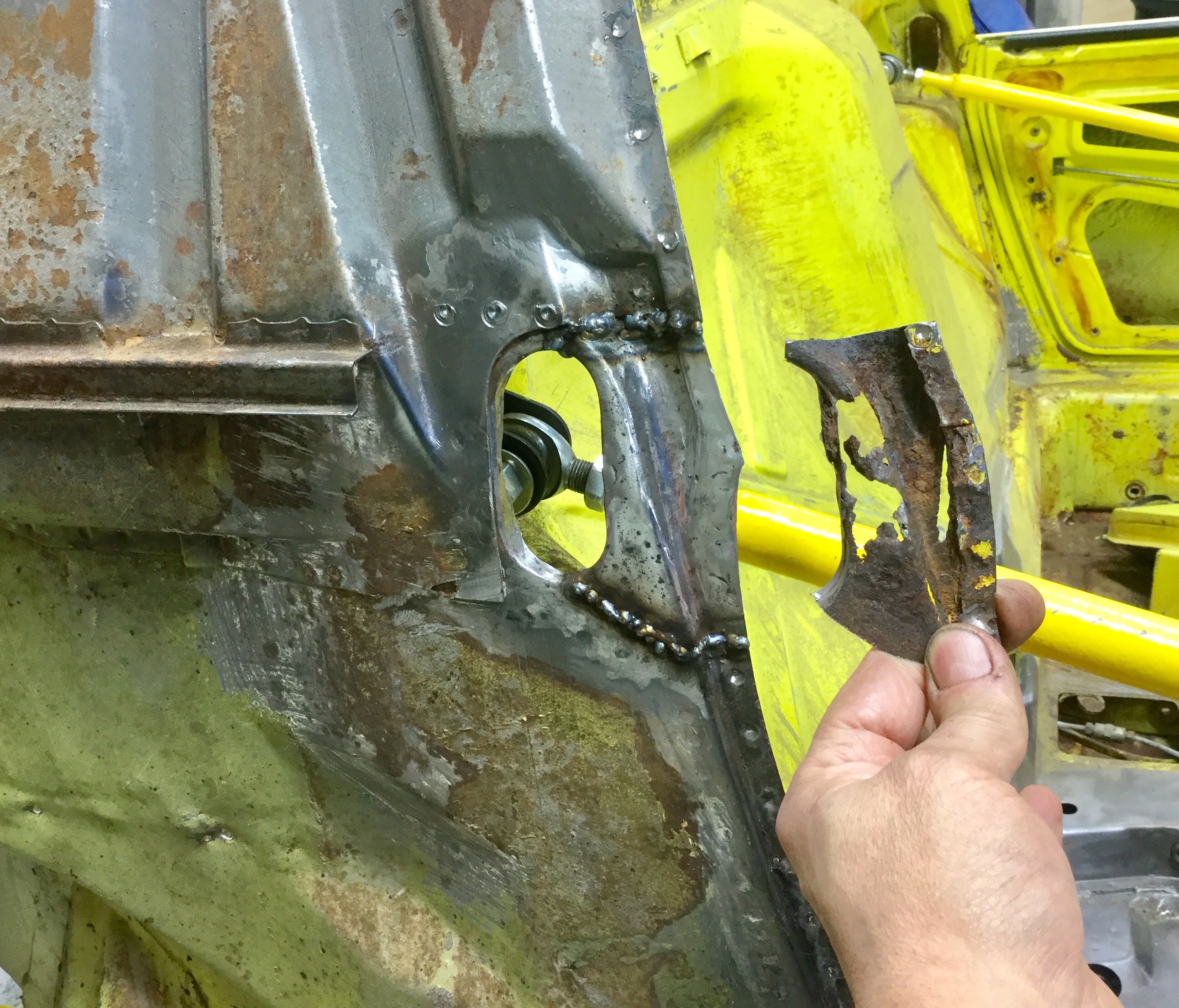

Alain V.   Removed old console piece   Jan 2 2022, 04:30 PM
Alain V.   Need to make a small patch for the skin behind the...   Jan 2 2022, 04:31 PM
Alain V.   RE: 72 rustoration / subaru 6cyl project in Kansas   Jan 2 2022, 04:33 PM
Alain V.   RE: 72 rustoration / subaru 6cyl project in Kansas   Jan 2 2022, 04:34 PM
Alain V.   RE: 72 rustoration / subaru 6cyl project in Kansas   Jan 2 2022, 04:35 PM
Alain V.   RE: 72 rustoration / subaru 6cyl project in Kansas   Jan 2 2022, 04:36 PM

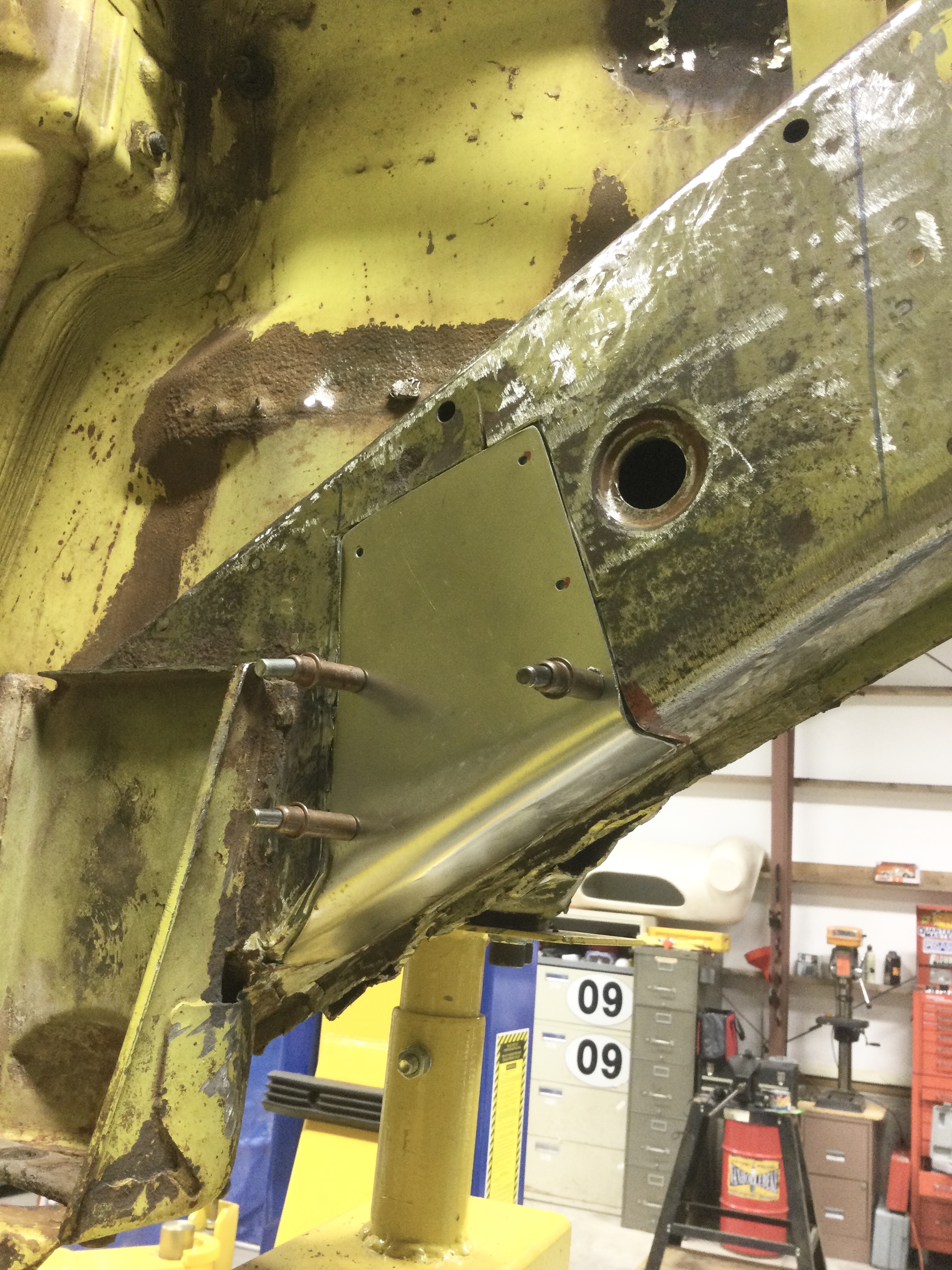

Alain V.   Test fitting new piece   Jan 2 2022, 04:37 PM

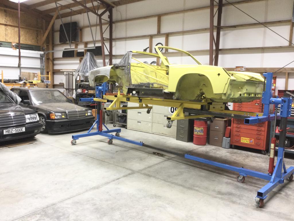

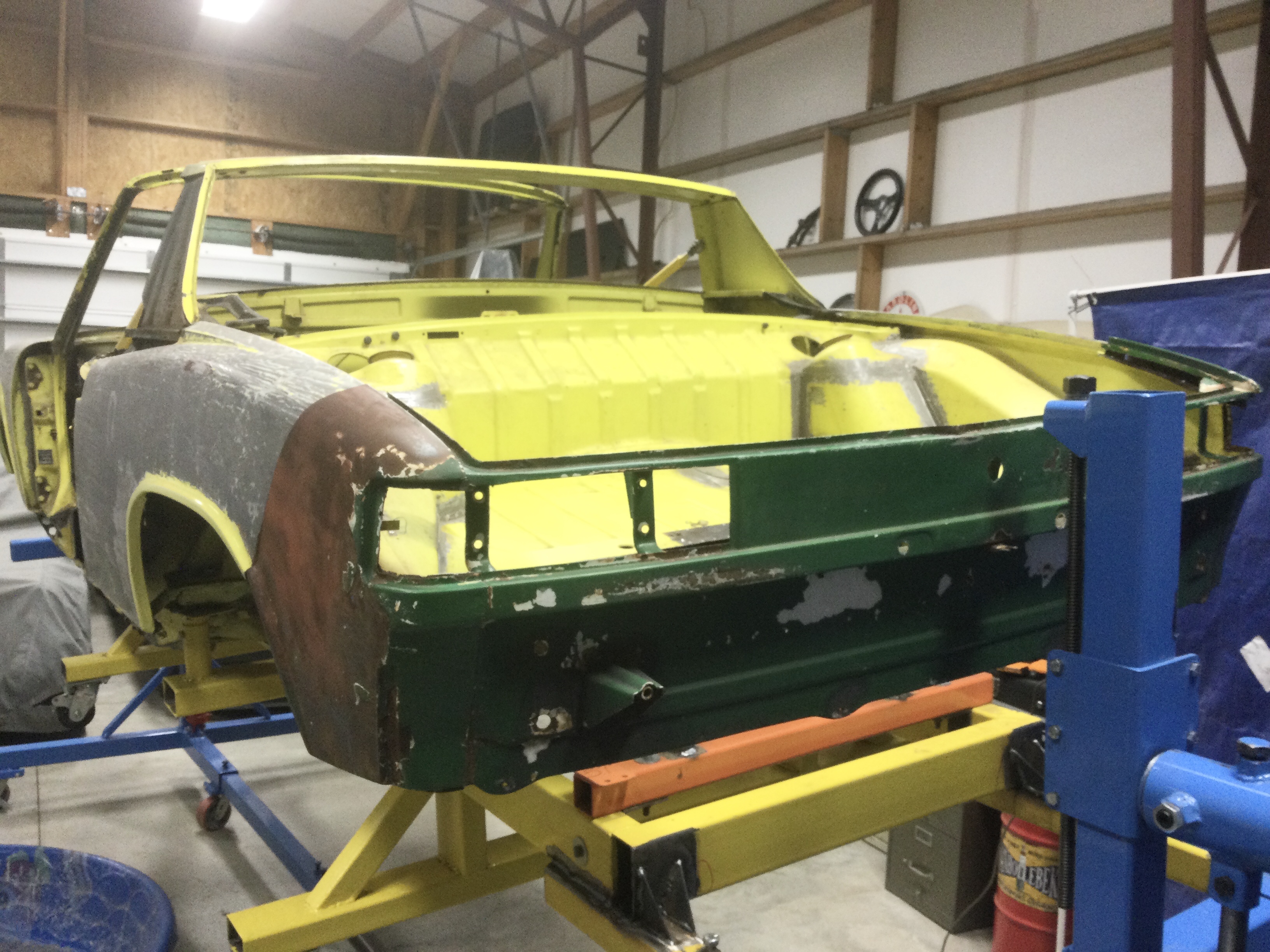

Alain V.   Decided to put the whole thing on an auto twirler ...   Jan 2 2022, 04:41 PM

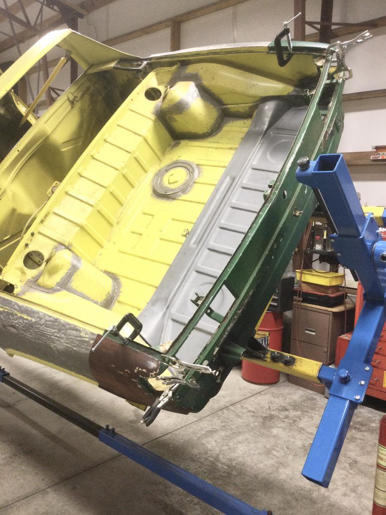

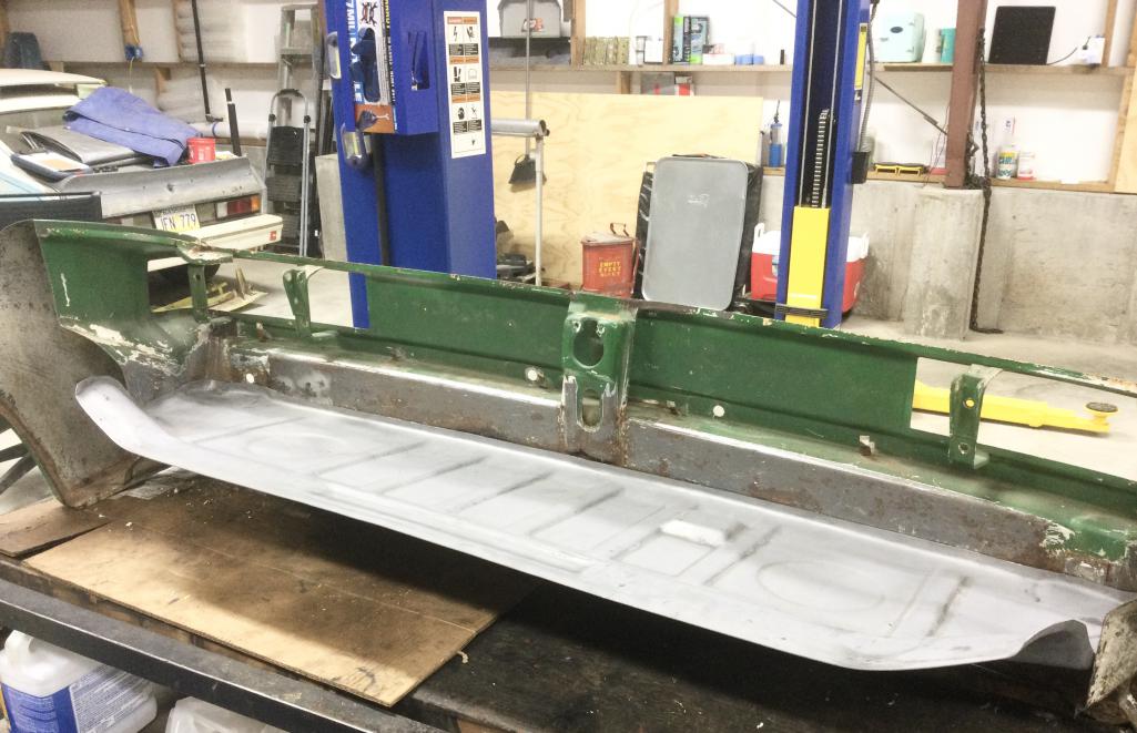

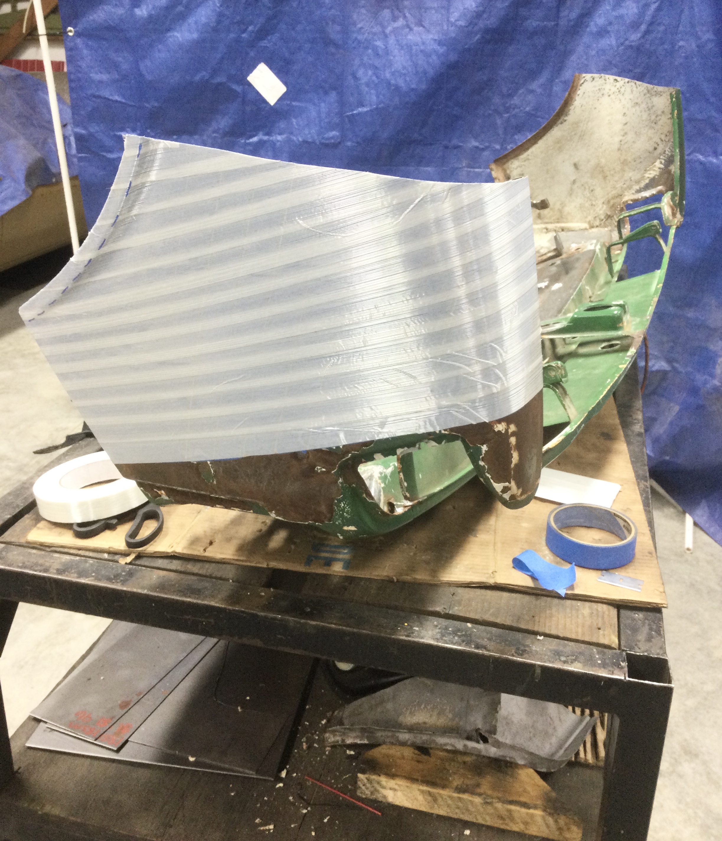

Alain V.   Starting to prep my new trunk panel and donor car ...   Jan 2 2022, 04:43 PM

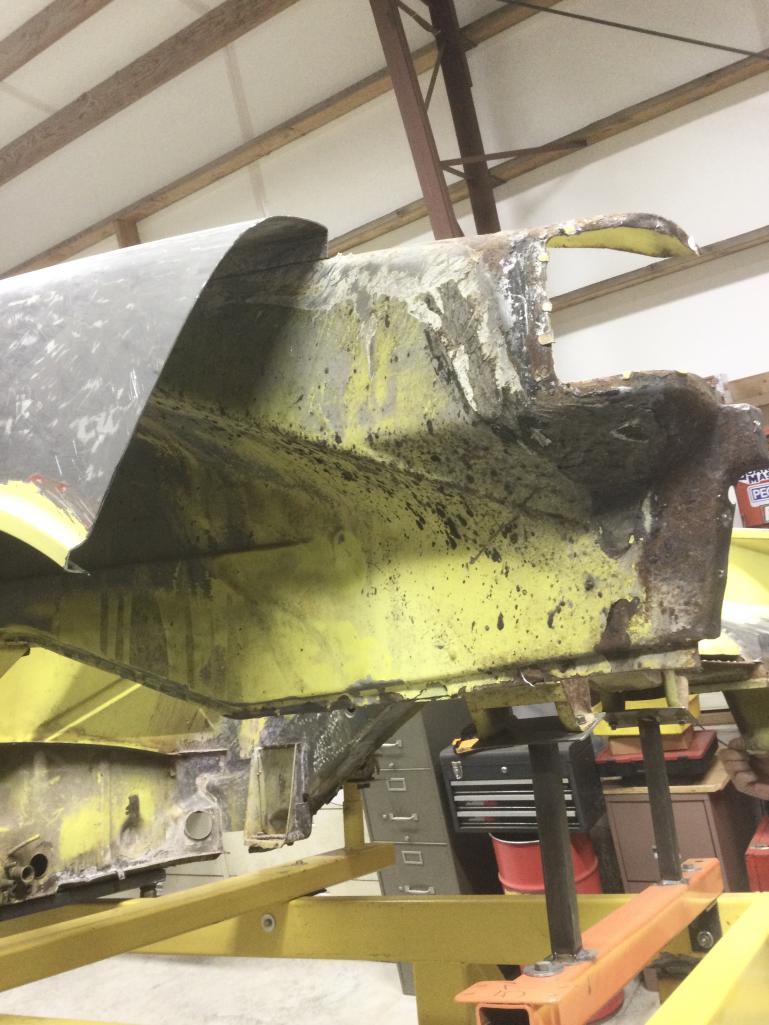

Alain V.   In additi9on to the original tail panel being full...   Jan 2 2022, 04:46 PM

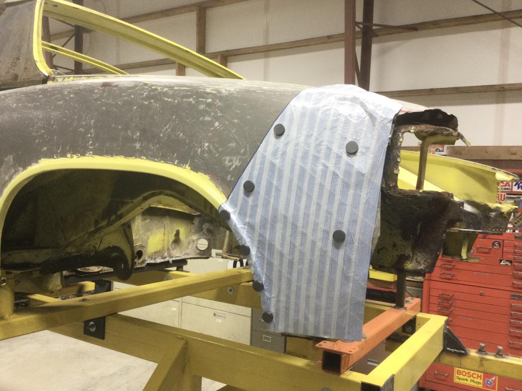

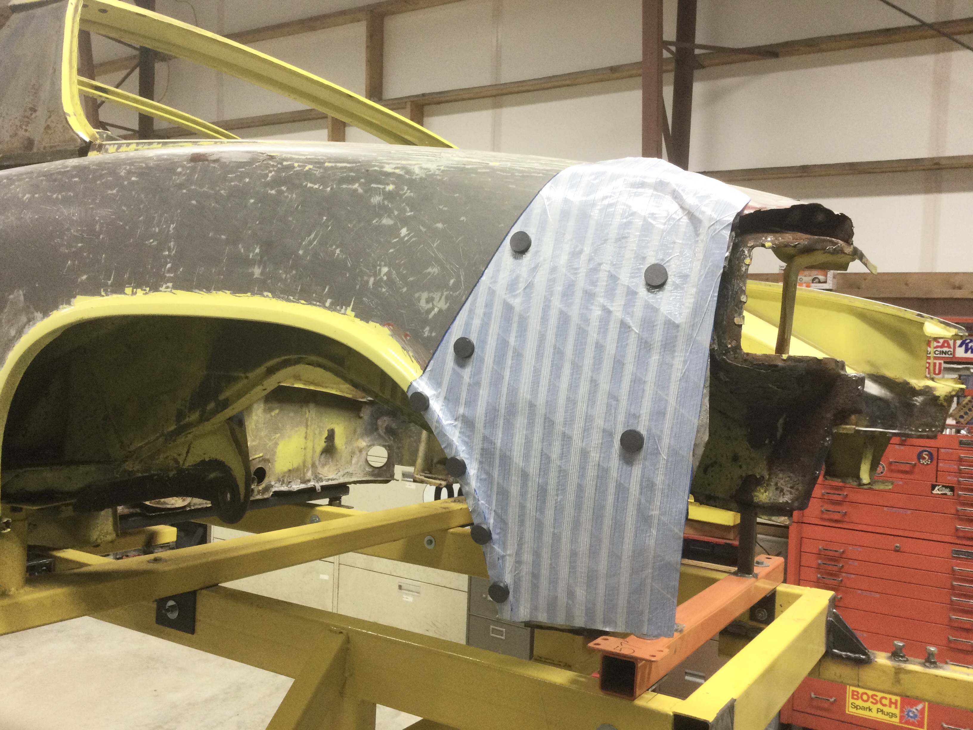

Alain V.   In order to get a decent fit, I made a “flexible...   Jan 2 2022, 04:52 PM
Alain V.   “Flexible shape pattern” set onto the body wit...   Jan 2 2022, 04:54 PM

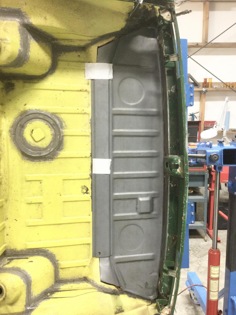

Alain V.   Cuts made. Before I install the rear pieces perman...   Jan 2 2022, 04:56 PM
Alain V.   Aaand, voila! It fits pretty good. Needs sligh...   Jan 2 2022, 04:57 PM

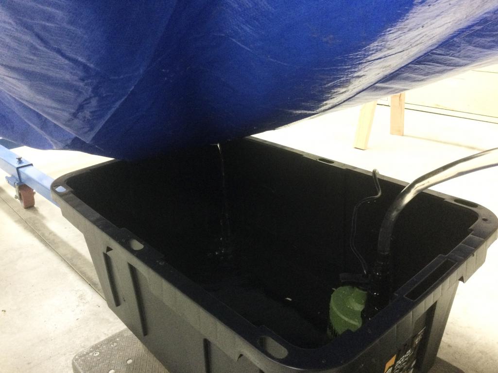

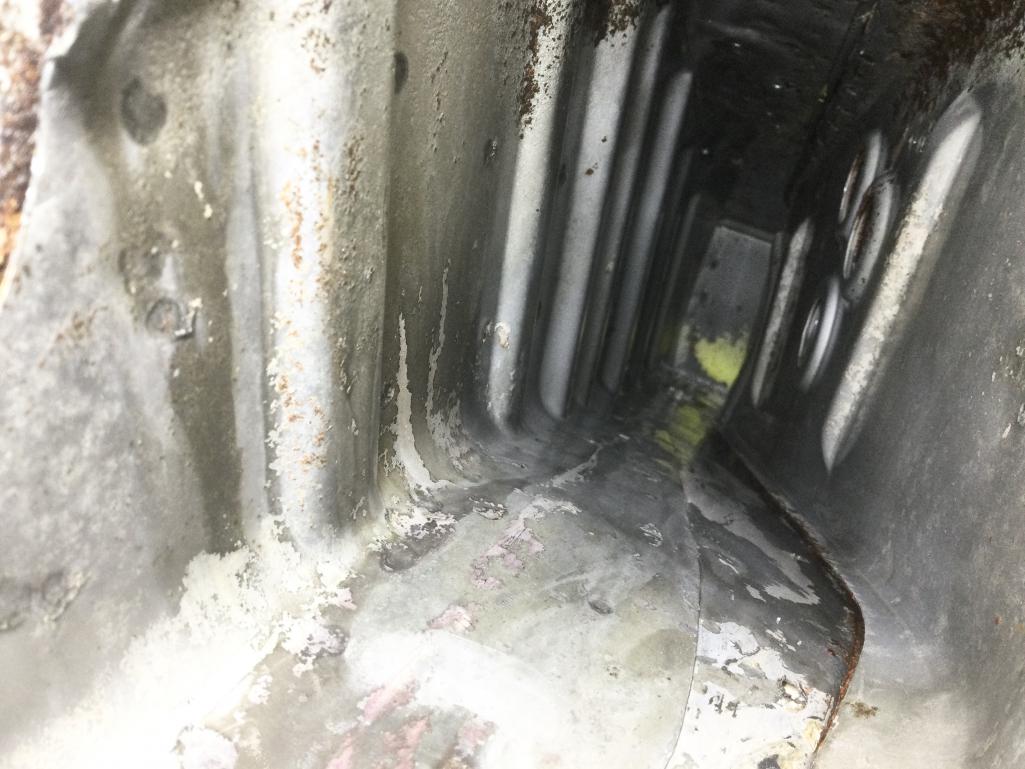

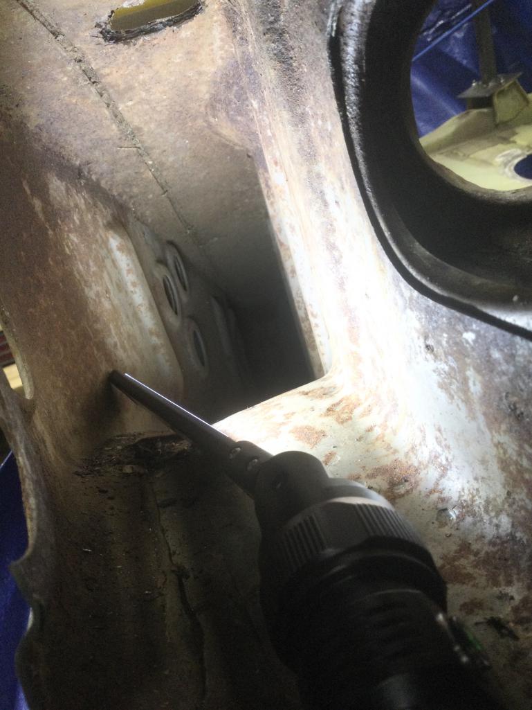

Alain V.   Got an idea for cleaning surface rust out of hard ...   Jan 2 2022, 05:45 PM
Alain V.   I’m going to flush the area with a rust solution...   Jan 2 2022, 05:48 PM

Alain V.   RE: 72 rustoration / subaru 6cyl project in Kansas   Jan 2 2022, 05:49 PM
Alain V.   RE: 72 rustoration / subaru 6cyl project in Kansas   Jan 2 2022, 05:51 PM
Alain V.   After flushing.   Jan 2 2022, 05:52 PM

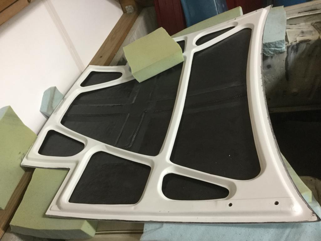

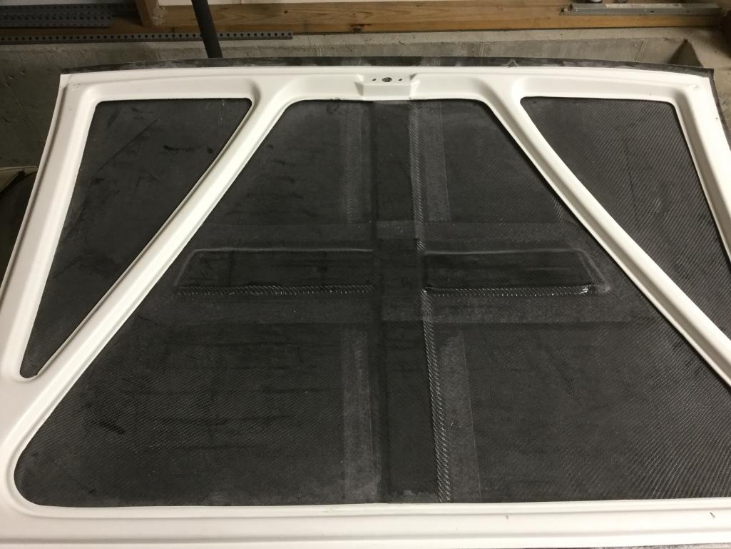

Alain V.   I'm also going to try and come up with a light...   Jan 3 2022, 09:46 PM

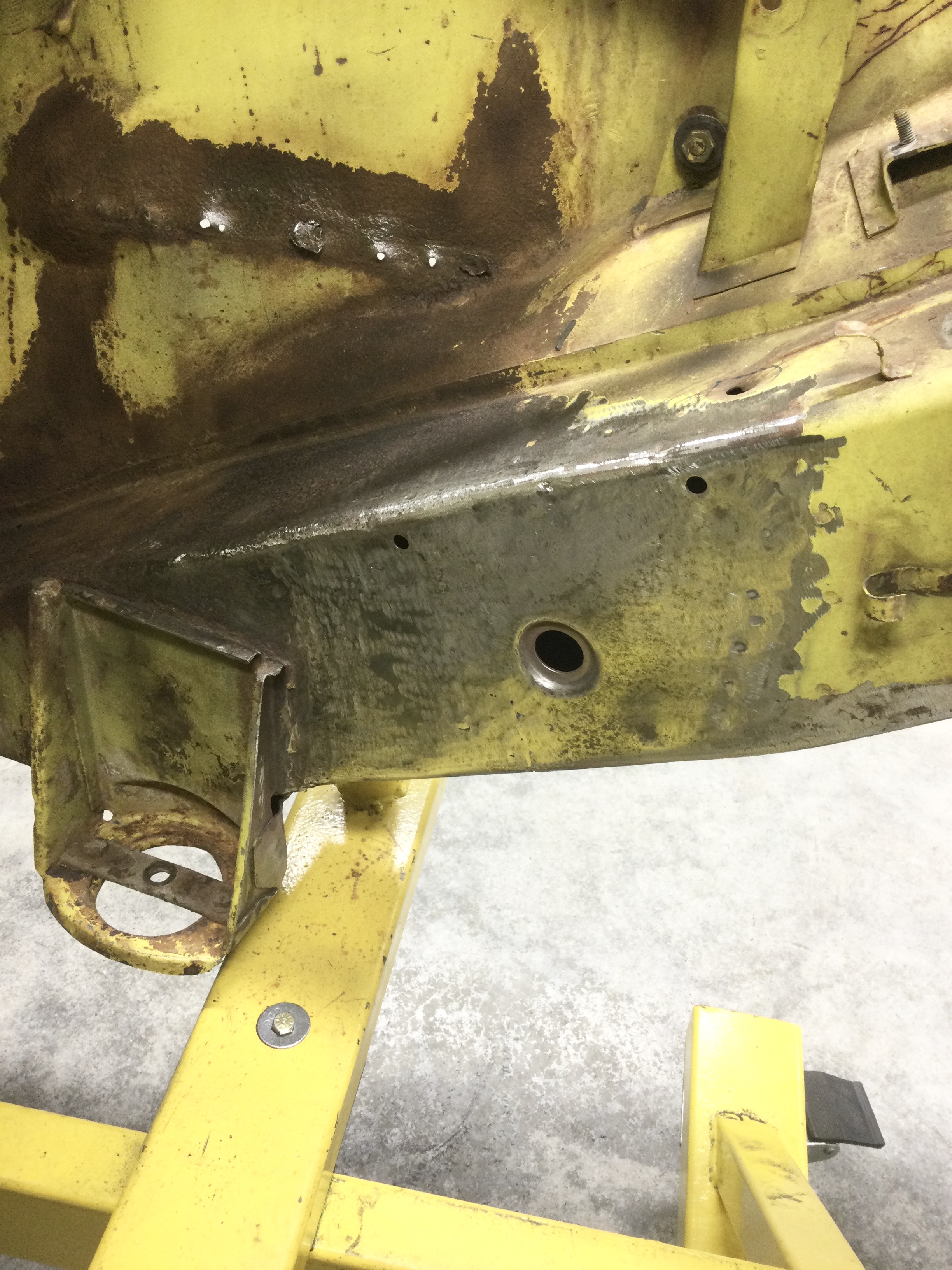

Alain V.   Well, not much progress to report.......... But I ...   Jan 16 2022, 05:30 PM
Alain V.   I also had to wait for a fresh gallon of rust trea...   Jan 16 2022, 05:34 PM

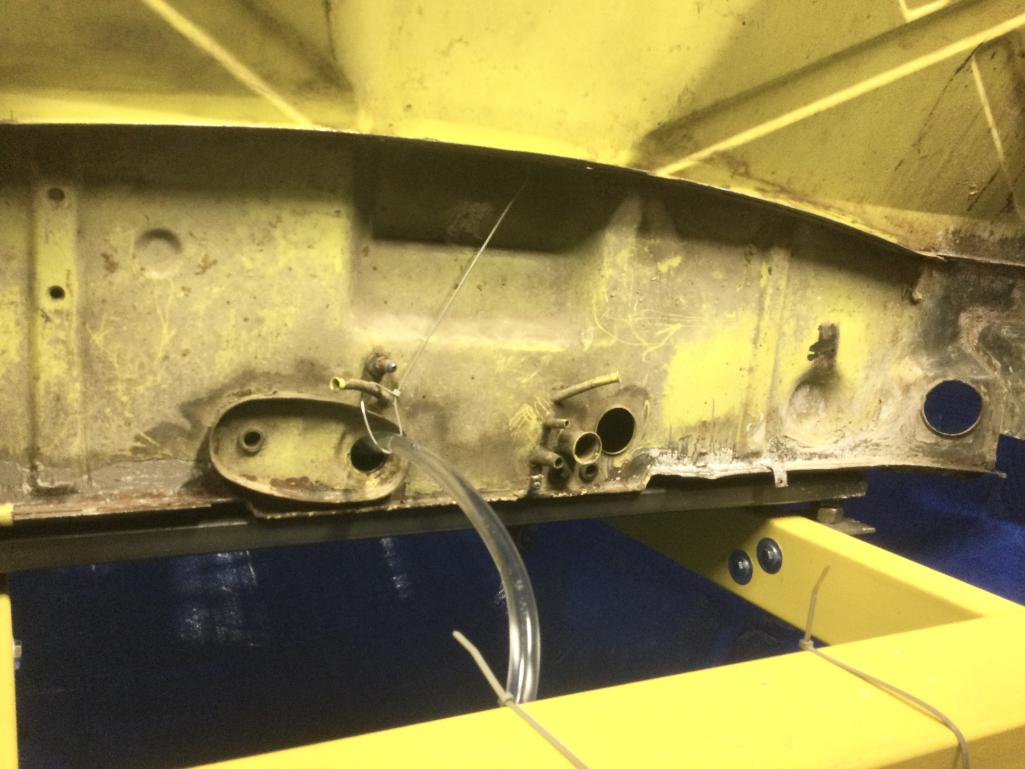

Alain V.   Well, I decided the best way to get the rust out o...   Aug 28 2022, 08:50 PM
Alain V.   Was able to blast the area so I can treat it with ...   Aug 28 2022, 08:52 PM

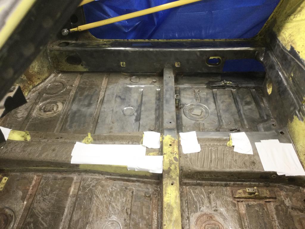

Alain V.   I bought a used spot welder on Facebook marketplac...   Nov 7 2022, 06:52 PM
Alain V.   I did a little “testing” to figure out where t...   Nov 7 2022, 06:54 PM
Alain V.   I used it where the rear floor pan meets the lower...   Nov 7 2022, 06:56 PM
