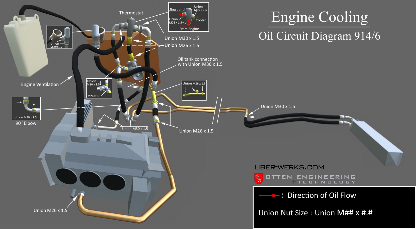

Hi everyone,

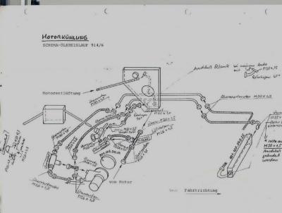

We recently were commissioned to create modern 3D renderings of the 914-6 GT oil cooling system, based upon the original hand sketch renderings. We did this by creating a 3D model, which we could then export renderings. Under the terms of my work, I maintained the right to share these renderings with the online Porsche community.
More renderings can be found on my website at http://www.uber-werks.com/porsche-914-6-gt...ication-system/
Perhaps these can be of use to some.

Not an expert, but it appears to me that the scavenger oil pipe is connected to the bottom of the oil tank with a T connection to the vent and top oil filler pipe, and is not connected first to the thermostat? I look forward to someone clarifying this.

Thomas your diagram provides a much clearer view of the many parts in the OEM
system.
It shows that the standard parts of the 6 system (no front cooler) are virtually intact.
The added features (around the tank) are almost entirely attached to the filter
console.
It's odd that front oil cooler plumbing on 914 6 GT is so complicated compared
to that on a 911
Thank you for posting......beautiful work !

Very nice! there are 2 changes
this is the oil pipe/hose that goes on the engine oil cooler, it is braided stainless with a blue tracer. This braided stainless with a blue tracer is used between the front oil cooler and the brass side oil pipes

One small mistake I made when first building my car is I used AN-12 oil lines everywhere. As your drawing shows, the intake (M30) is larger than the output (M26).
So I'm correcting that now and changing the intake to AN-16. Probably should just use AN-16 everywhere or even AN-20 and AN-16.
-Steve

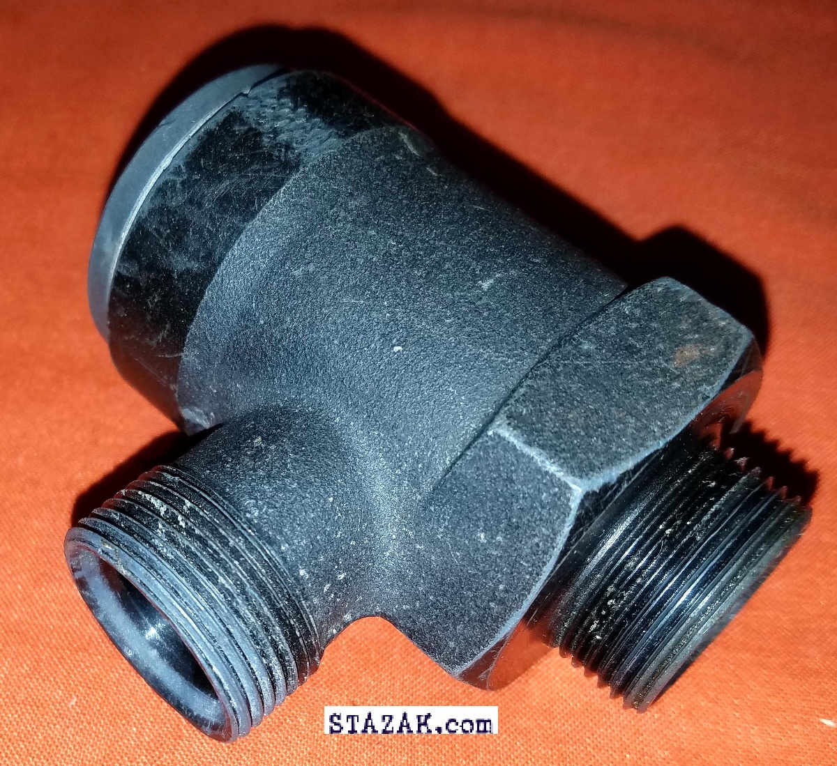

In 1971 Porsche switch to this less expensive valve, repro are available for less the preschona repro.
gms
post Jan 11 2022, 09:27 AM
Posts: 2,746
Joined: 12-March 04
From: Chicagoland
Member No.: 1,785
Pressure Relief Valve

I was familiar with these but still expensive, and are they adjustable?
The reproduction cooler made by FSH can be had with the valve built in for additional $$. Nicely made, BTW.
Readily available Watts adjustable valves are cheap... maybe modifying one and plating it gets the job done. You could even have a cap made to complete the disguise. Thoughts?
