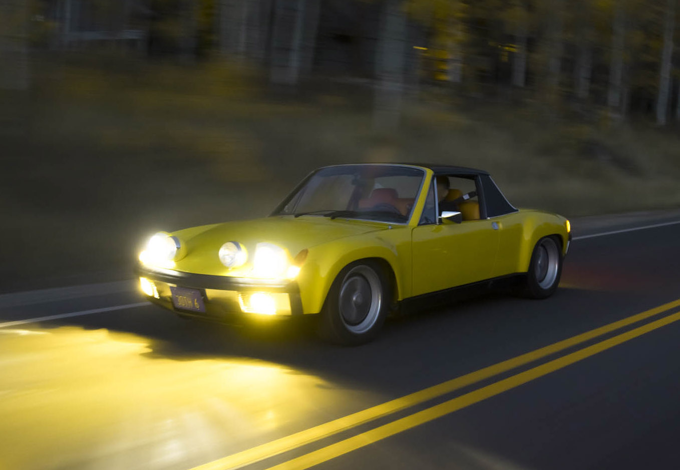

post Nov 28 2022, 10:02 PM
Post #50
Senior member, and old dude
Posts: 3,923
Joined: 2-January 07
From: Los Angeles
Member No.: 7,414
let there be light!
LED done by PMB PERFORMANCE
Bob BAttached Image
porschetub
post Nov 29 2022, 05:49 PM
Post #51
Posts: 4,971
Joined: 25-July 15
From: New Zealand
Member No.: 18,995
QUOTE(burton73 @ Nov 29 2022, 04:02 PM) *
let there be light!
Bob BAttached Image
Wow thats bright (IMG:style_emoticons/default/w00t.gif) ,I have euro h4's and they work pretty well but can't find more powerful lamps @ this stage but want to go to 60/100 ,had led conversion which was very bright however the beam was very wide and scattered so IMO they don't work without the correct housing ,then found out they are non compliant in my country if the car you own never came with them,another crazy law but for once I agree.
