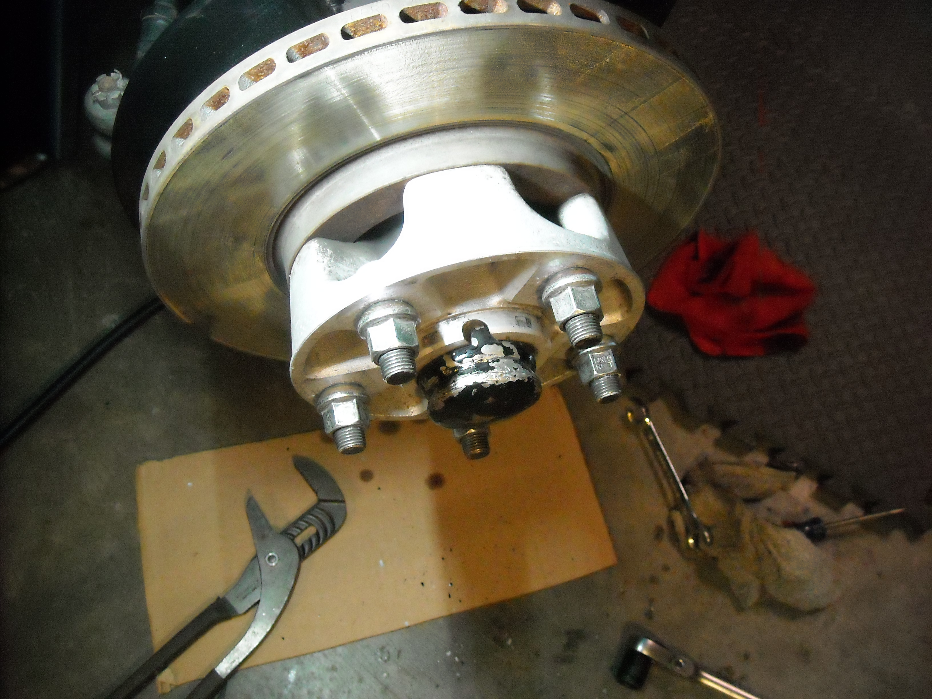

This is how you do it:
(IMG:http://www.914world.com/bbs2/uploads_offsite/i.pinimg.com-1143-1643310934.1.jpg)
Snap on dust cap pliers. They will pull the cap without damaging it.
There are two bumps on either side of the cap. Put the dust cap pliers behind the bumps. Then wiggle and pull on the pliers until the cap comes off.
Works great!
