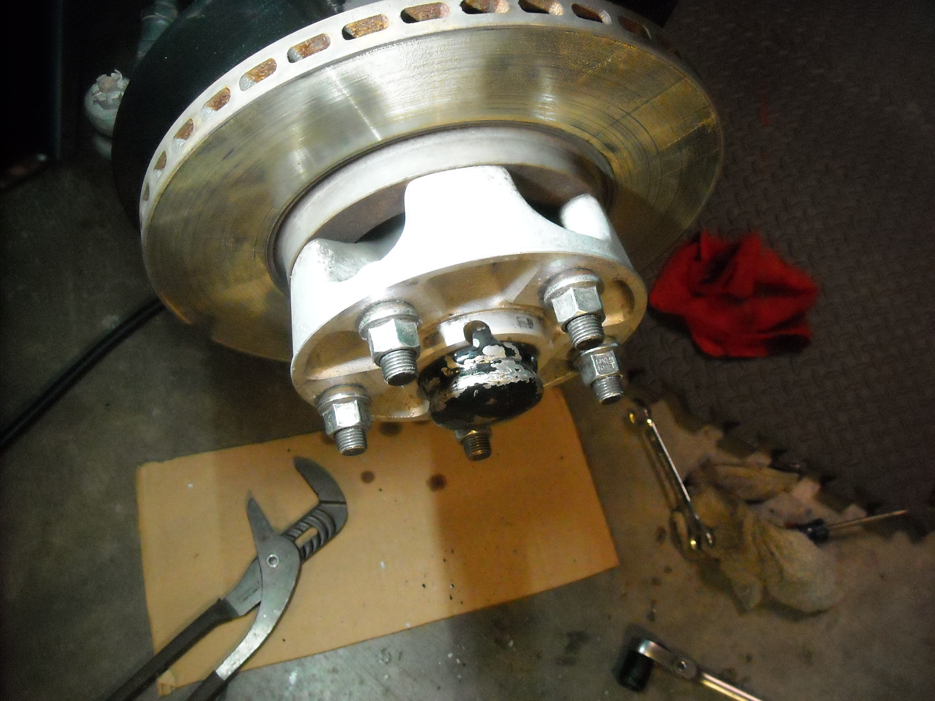

Trying to pull my front hubs off and can't get the dust cap off.
Tried large channel locks and tapping with a hammer, but all I am doing is messing up the dust cap.
Must be an easy way.
I just don't know it.

Olympic 914
Tried knocking it off with a hammer, that didn't work for me.
It just beat up the cap.
Ended up using a long brass drift and hammer, that gave me a little angle on it.
So there isn't a tool for this?
Muffler clamp idea sounds good though.

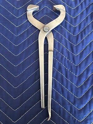

ClayPerrine
This is how you do it:
IPB Image
Snap on dust cap pliers. They will pull the cap without damaging it.
There are two bumps on either side of the cap. Put the dust cap pliers behind the bumps. Then wiggle and pull on the pliers until the cap comes off.
Works great!
