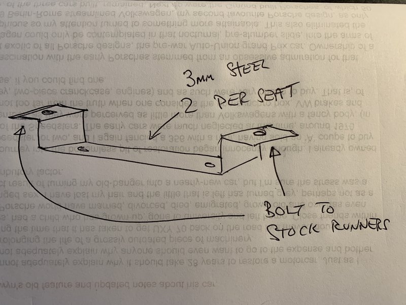

KSCarrera By using a flat bar across the stock runners, the ... Jan 27 2022, 07:59 AM
pek771 Thanks Keith! Jan 27 2022, 01:23 PM![]() ![]() |
