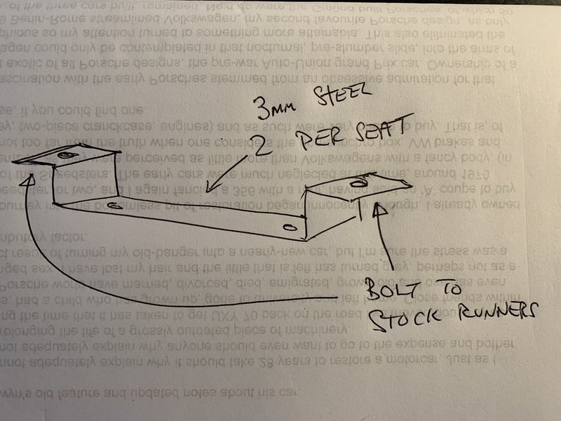

By using a flat bar across the stock runners, the seats sit too high IMHO. To mount the Cobra RSR seats in my car I made cross braces which are 'stepped down' about 20mm and then bolt to the stock runners, which I'd removed from the original seats.

Thanks Keith!
