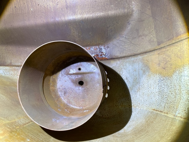

While I'm replacing the fuel lines on the 74 I thought I'd address the inside of the tank while I have it out. It's rusty but not too awful. The screen was pretty dirty though.
I'm leaning towards the POR15 system but have a few questions.
What's the best way to seal the tank while I'm stirring all of the solutions around inside? It's looking like a pretty good upper body workout and I would hate to interrupt the fun with leaking solvent.
Open for suggestions of other products.
Cheers!Attached Image

That is a really clean tank. I would not POR it. Roll with it.

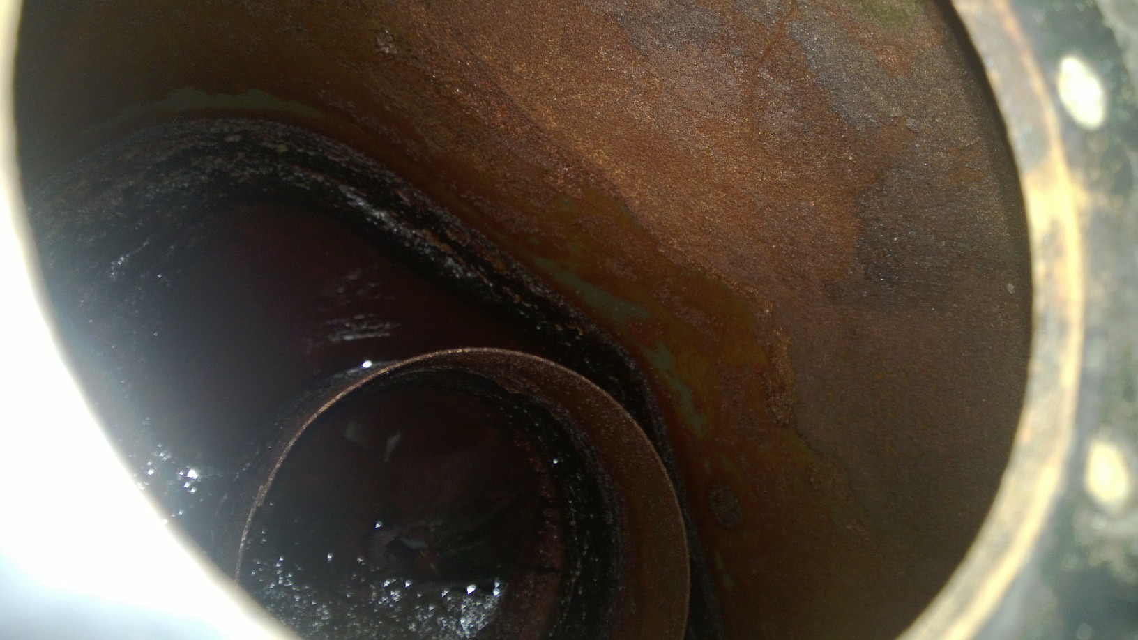

Kevin has a good point. Yours looks good. By comparison here's what mine looked like before treatment (after sitting for like 10 years):
(IMG:style_emoticons/default/barf.gif)

Your tank looks about as clean as they get. Add fuel and enjoy.

Light surface rust is to be expected. As previously stated your tank doesn't look too bad.
