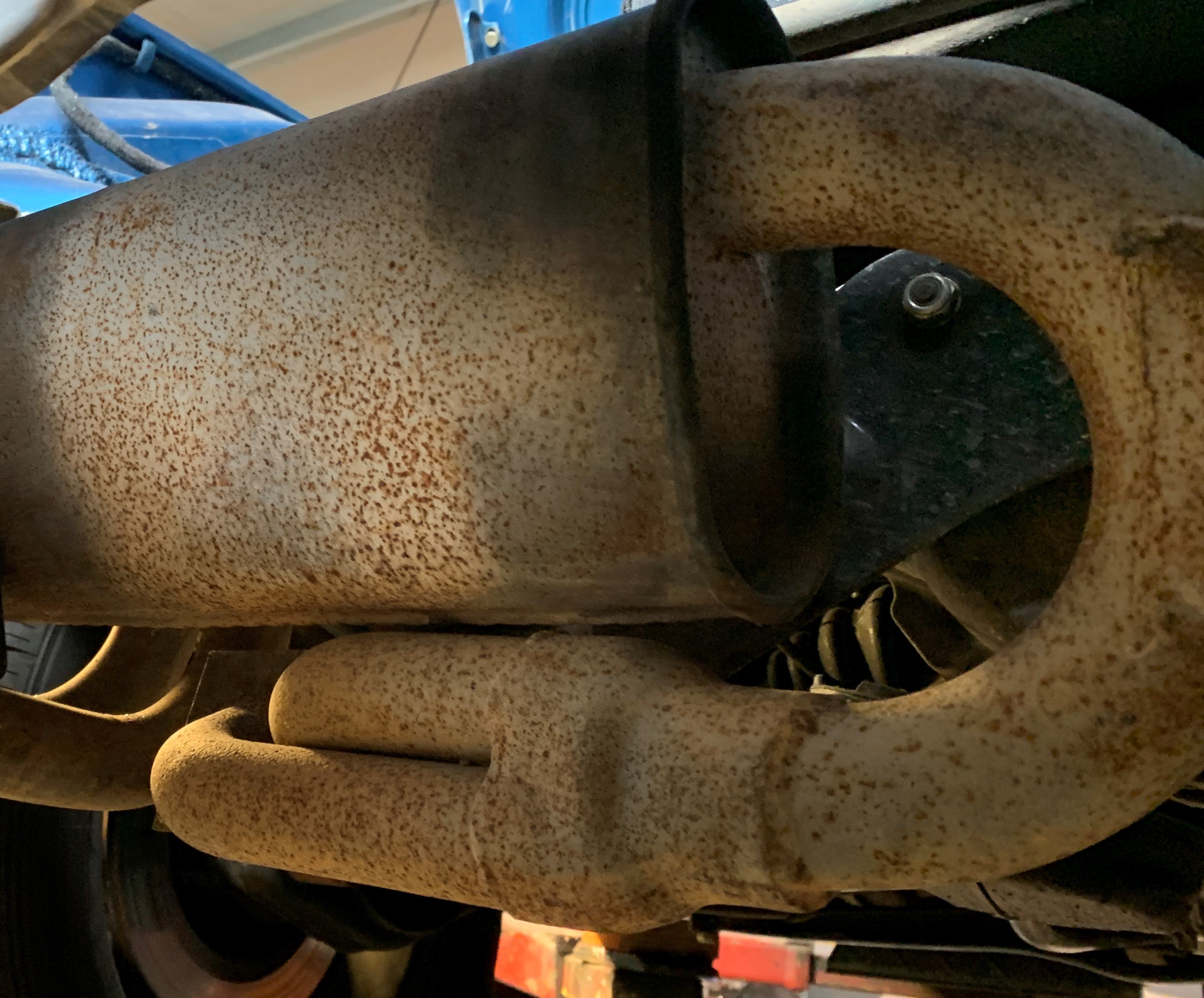

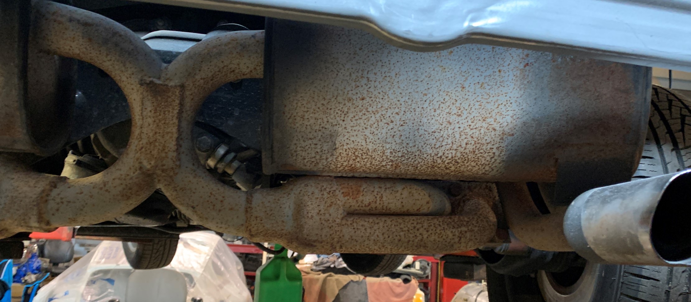

bludden exhaust refinish Jan 31 2022, 08:42 PM
Bullethead DIY, sand and refinish with hi-temp paint.
No agg... Jan 31 2022, 09:11 PM
bludden Do you use a sander, elbow grease, etc.? (Media bl... Jan 31 2022, 09:32 PM
mepstein Get it glass bead blasted and high temp paint or c... Jan 31 2022, 09:41 PM
Jett +1 on ceramic coating, looks good and lasts long. Jan 31 2022, 10:10 PM
Cairo94507 I second the cerikoat or ceramic coating for a no ... Jan 31 2022, 10:19 PM
RARE 6
I second the cerikoat or ceramic coating for a no... Jan 31 2022, 10:41 PM
I second the cerikoat or ceramic coating for a n... Jan 31 2022, 10:48 PM
BeatNavy I had a set of stock heat exchangers ceramic coate... Feb 1 2022, 06:56 AM
rgalla9146 I've often blasted and then heat painted my HE... Feb 1 2022, 07:59 AM
I've often blasted and then heat painted my H... Feb 1 2022, 08:11 AM
rhodyguy Does Cerikote bake at PC temps? Feb 1 2022, 08:17 AM
Mitox Cerakote now has some high temp finishes around th... Feb 2 2022, 10:02 AM![]() ![]() |
