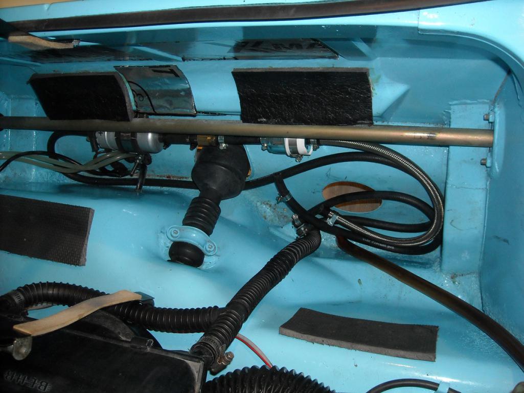

Not under the steering rack, But another choice.
Removing the tank isn't that hard to do.

QUOTE(Olympic 914 @ Feb 9 2022, 03:51 PM) *
Very similar to what I did, except my pump and filter are reversed from yours.

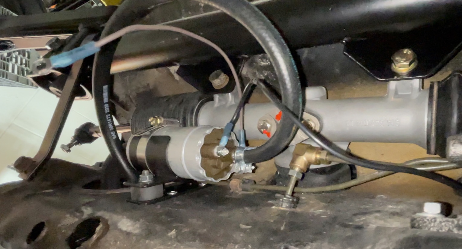

Quick frame grab. This was in-process. The hoses and wires are properly routed now. The angle makes it look like the pump hits the steering bellows, but it doesn't...

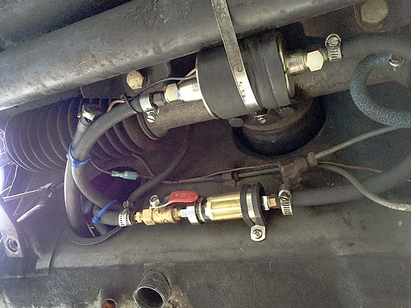

I eliminated all the possible kinks in the fuel line loops by forming U's from metal fuel line. Was easy to construct and eliminated potential future rubber line aging and collapse. Added filter between tank and pump to eliminate troublesome sock in tank, and another filter after pump to tunnel line, and they are readily serviceable in this location without need to remove tank.
