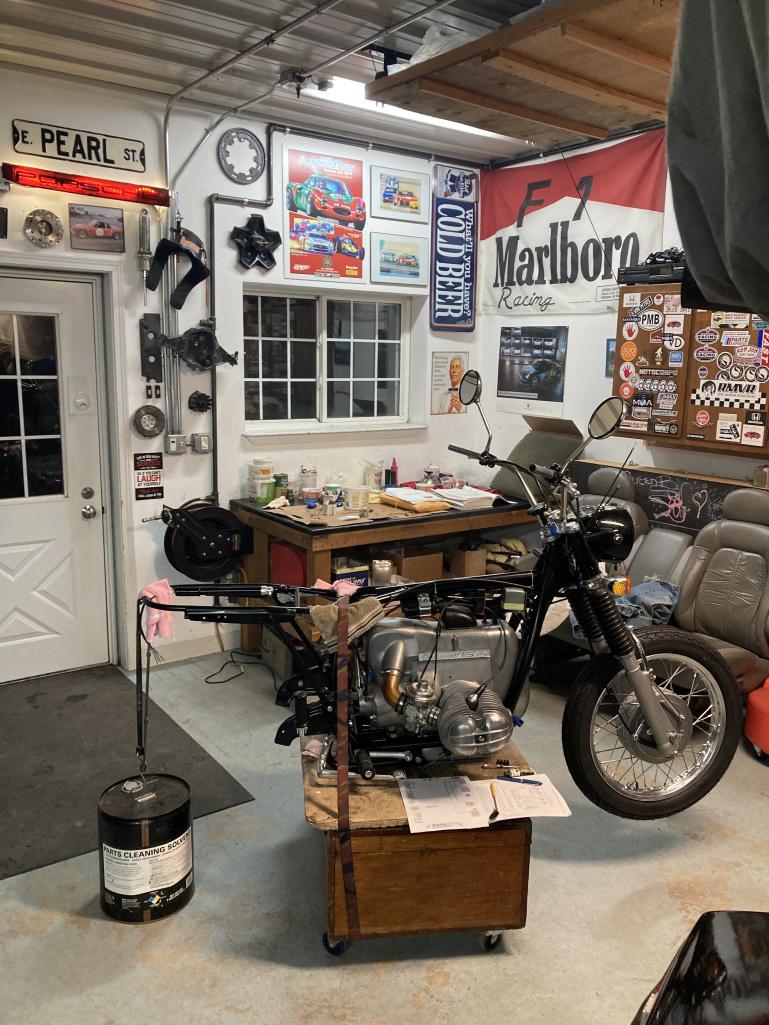

brant   A wooden box with casters can come in handy for lo...   Feb 13 2022, 10:55 AM
mlindner   brant, I like your shop, very cool.   Feb 13 2022, 10:57 AM
brant   brant, I like your shop, very cool. Thank you...   Feb 13 2022, 05:37 PM
