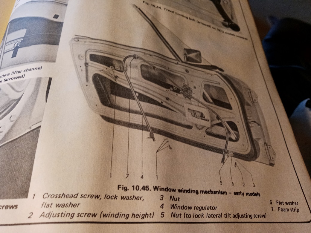

I’m installing all the glass and new seals into my drivers door and cannot get my window to roll up all the way up to the rubber cap on the triangle window. My passenger window is fine with the all new seals but for some reason the drivers window won’t go all the way up. How can I adjust how much the window rolls up? Early door with early mechanism, correct window and seals. Thank you (IMG:style_emoticons/default/headbang.gif)

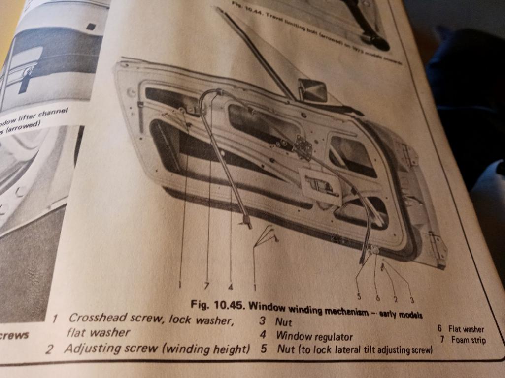

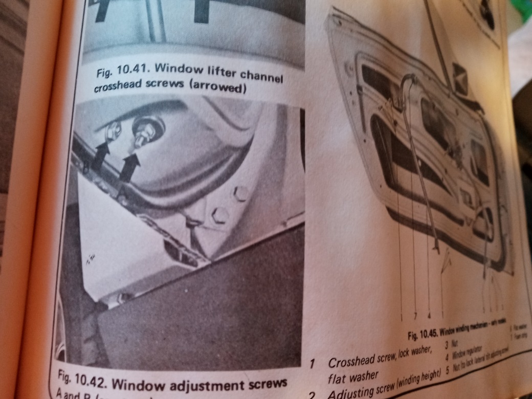

914Mels
post Feb 12 2022, 07:37 PM
Posts: 357
Joined: 20-June 11
From: Santee
Member No.: 13,221
here are some photos from my old manual on window adjustments.Attached Image Attached Image Attached Image

@914Mels thank you so much, you’re a hero! @raynekat without a doubt, my triangle window was perfect on drivers side but window won’t roll up and the other side was opposite so getting these doors adjusted has been the biggest road bump so far. I’ll never take a window rolling up properly for granted again that’s for sure
