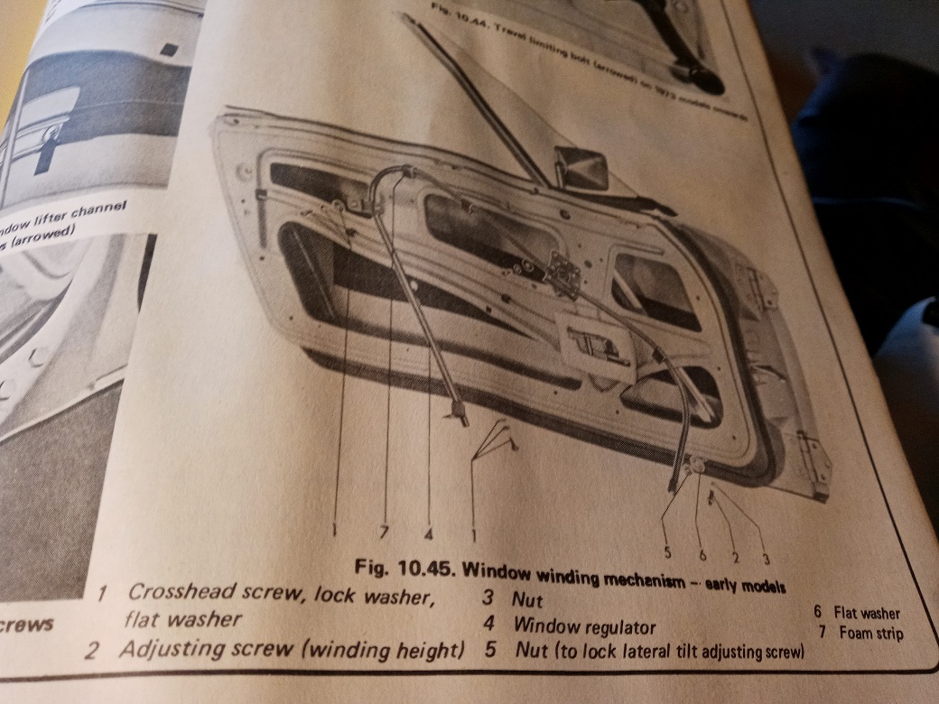

I’m installing all the glass and new seals into my drivers door and cannot get my window to roll up all the way up to the rubber cap on the triangle window. My passenger window is fine with the all new seals but for some reason the drivers window won’t go all the way up. How can I adjust how much the window rolls up? Early door with early mechanism, correct window and seals. Thank you headbang.gif

First think I'd check is make sure the roller is in good shape. Mine was made of plastic and it failed. That left the window down from the top.
iankarr
There's a stop on the mechanism. Maybe it needs adjustment?

@Shivers I got a rebuild door kit and put a new one on and the window was broken before so couldn’t check a before and after unfortunately but it does have a new roller. @iankarr where is the stop on the mechanism and how can I adjust it? Sorry I just can’t find anything on the web for adjustment on the early mechanism

Sometimes all it takes is to loosen the lift mechanism bolts that hold it to the door, lift the whole lift mechanism and tighten the bolts.

@Shivers I was hoping that would be it, loosened it all up, shook it and lifted it, lubed everything and still nothing

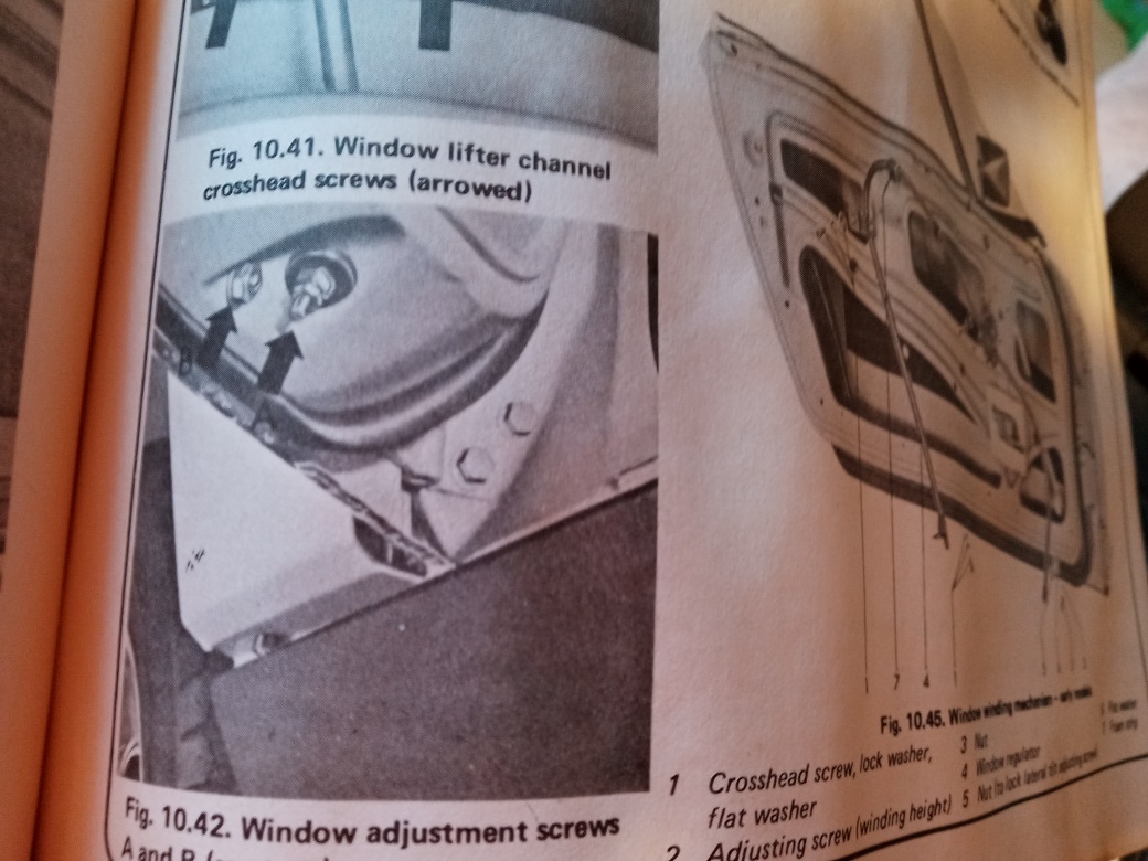

914Mels
here are some photos from my old manual on window adjustments.Click to view attachment Click to view attachment Click to view attachment

@914Mels thank you so much, you’re a hero! @raynekat without a doubt, my triangle window was perfect on drivers side but window won’t roll up and the other side was opposite so getting these doors adjusted has been the biggest road bump so far. I’ll never take a window rolling up properly for granted again that’s for sure
