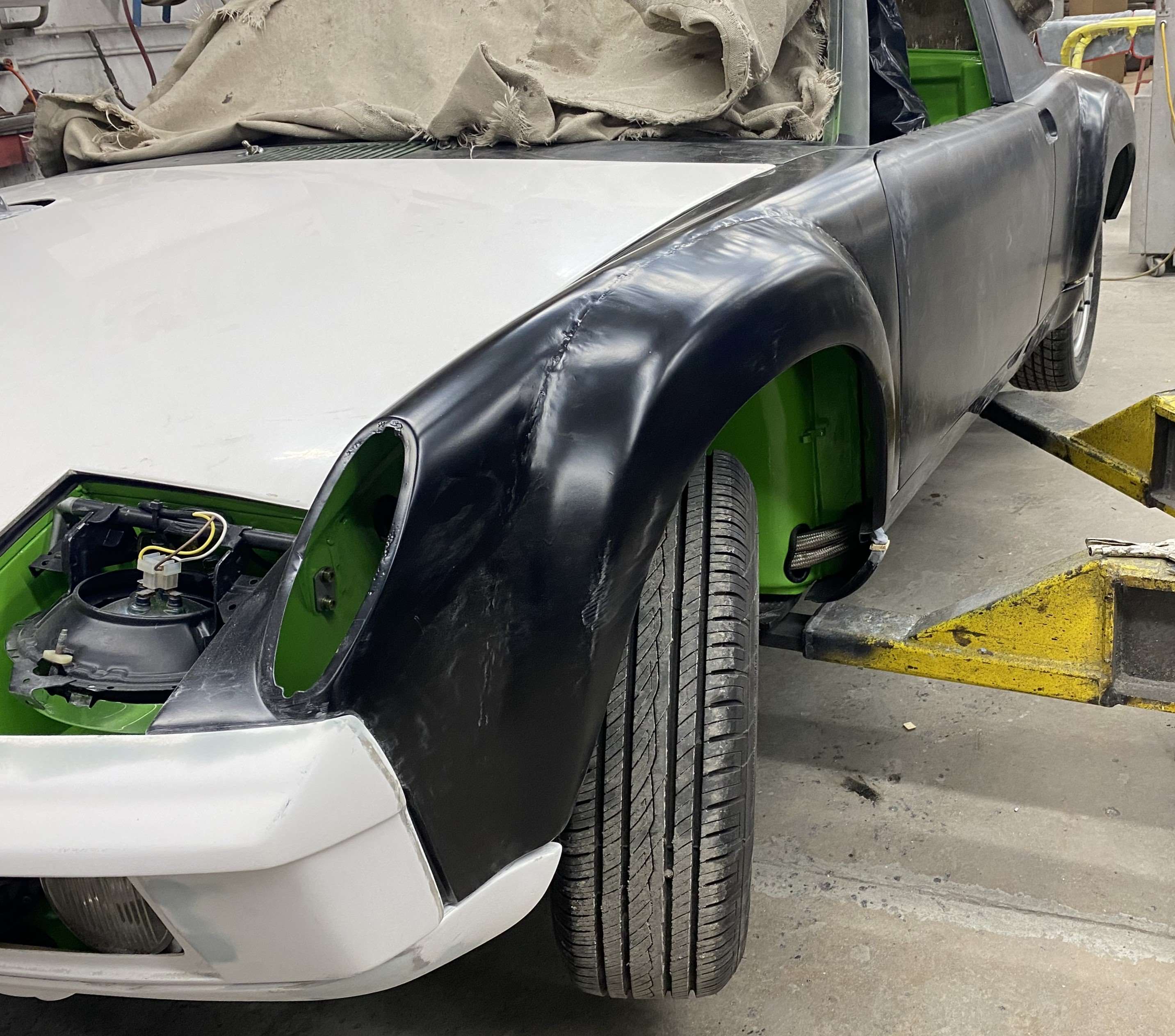

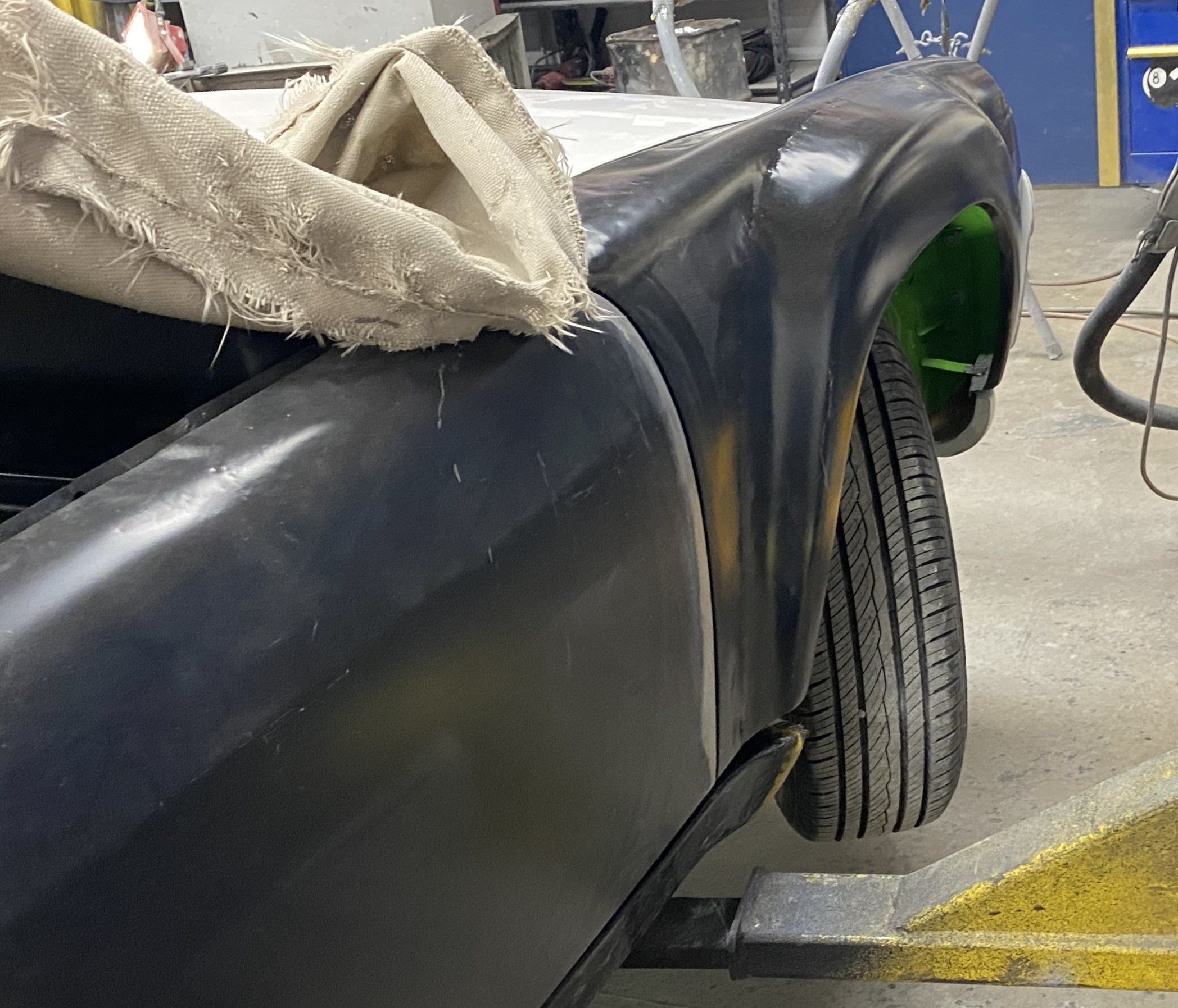

GT flares front and rear. I will likely leave the decision of metal vs FG to Auto Associates. I would like the car to be as light as is practical. I have FG flares on my RSR and they have held up very well over the 15 years since the original restoration. I am also planning to do the lightweight, balsa reinforced front and rear trunk lids. I also would like to do the GT style double grill engine cover. Not sure if anyone makes these or if I will have Auto Associates fabricate one from my existing cover. I will go with the hood pins front and bungees rear for lid closure. Not sure whether to go with the motor operated headlights or if the cable operated system is reliable enough. I do not plan to do a lot of night driving. For wheels, I am thinking Minilites on the rear and Fuchs on the front. I also want to keep the removable top as open air driving is one of my key objectives. I am liking Mexico Blue for the color.

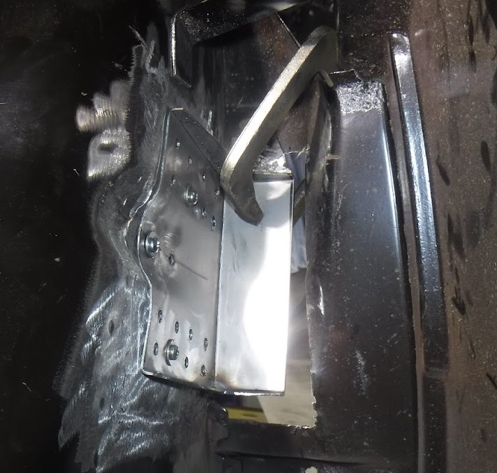

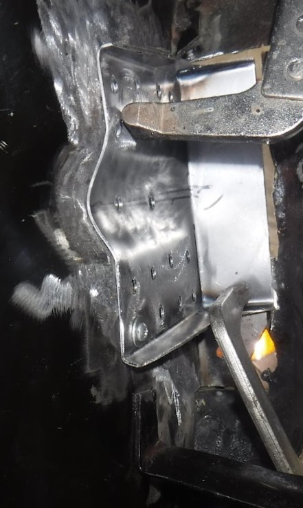

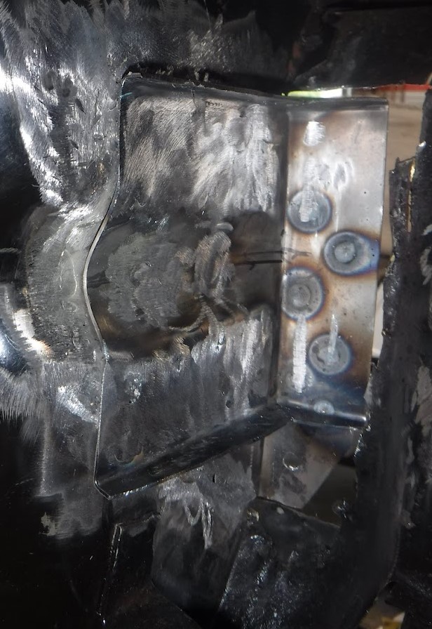

ClayPerrine   Please consider a stiffener kit for the longitudin...   Feb 22 2022, 11:30 AM
Tom1394racing   Please consider a stiffener kit for the longitudi...   Feb 22 2022, 07:08 PM

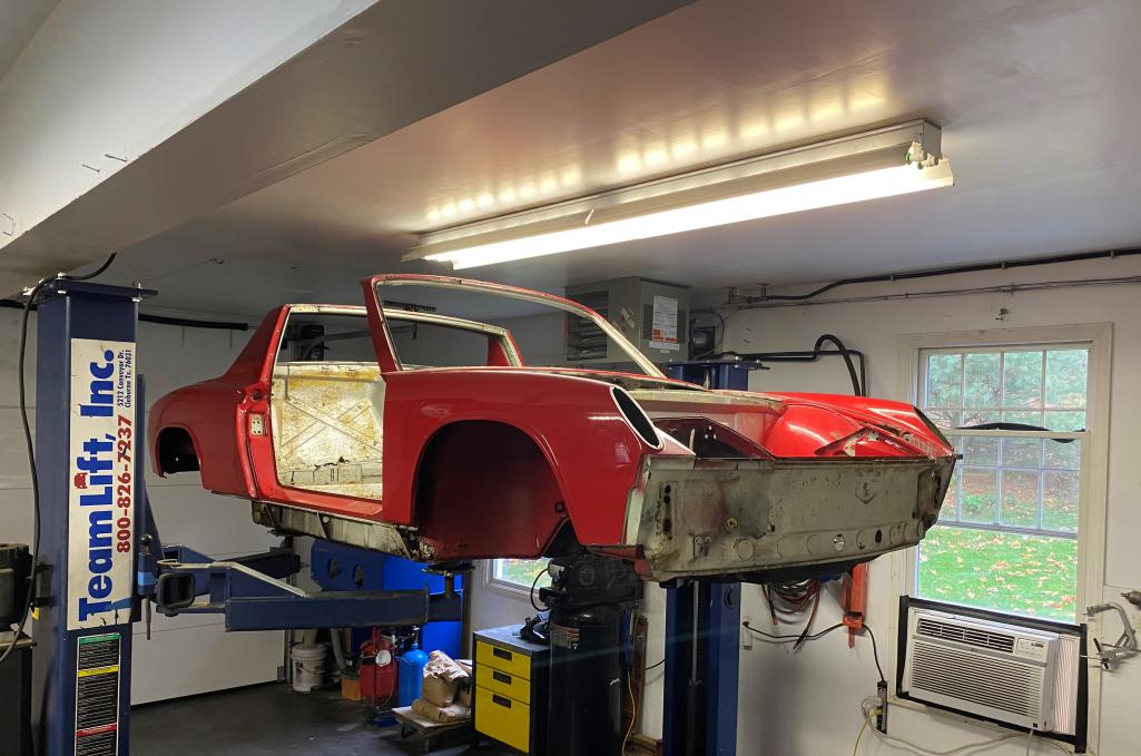

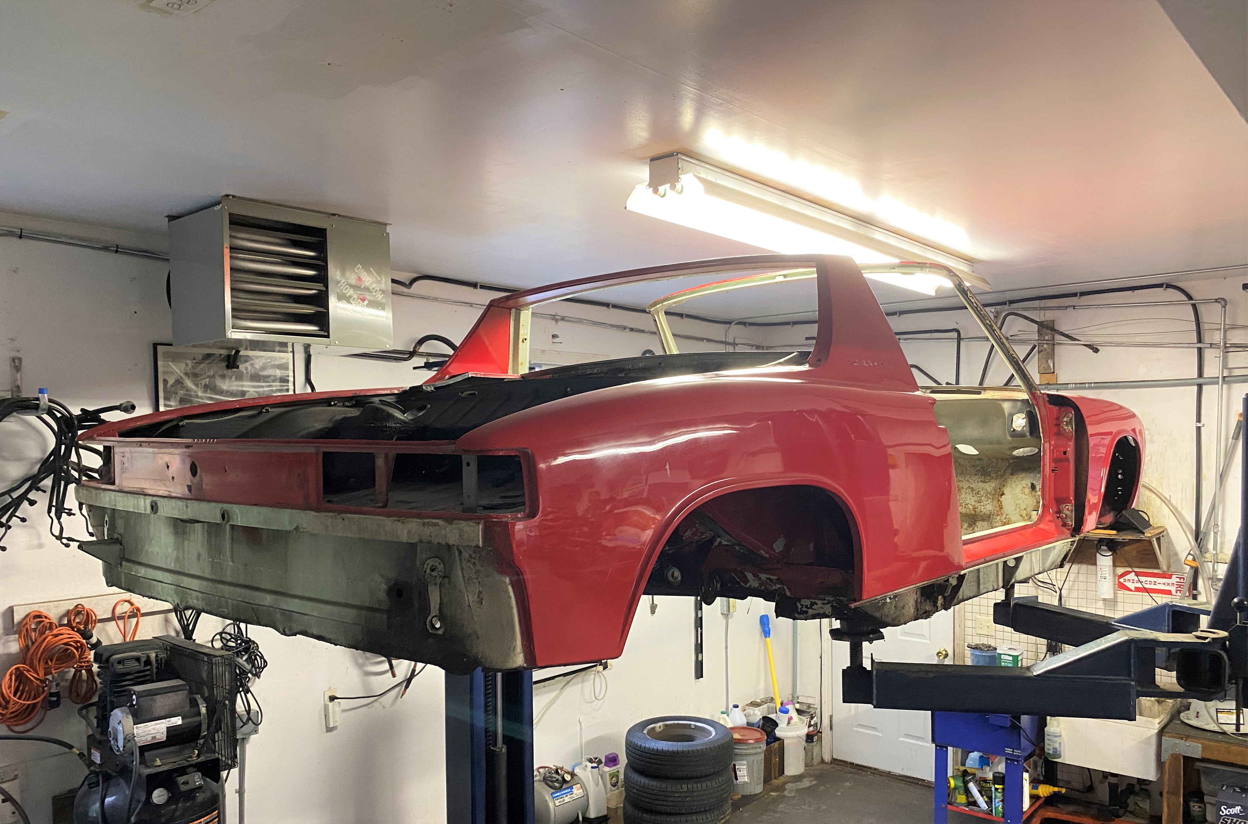

Tom1394racing   Updating his thread.... I had to put the car in t...   Feb 24 2022, 10:16 AM

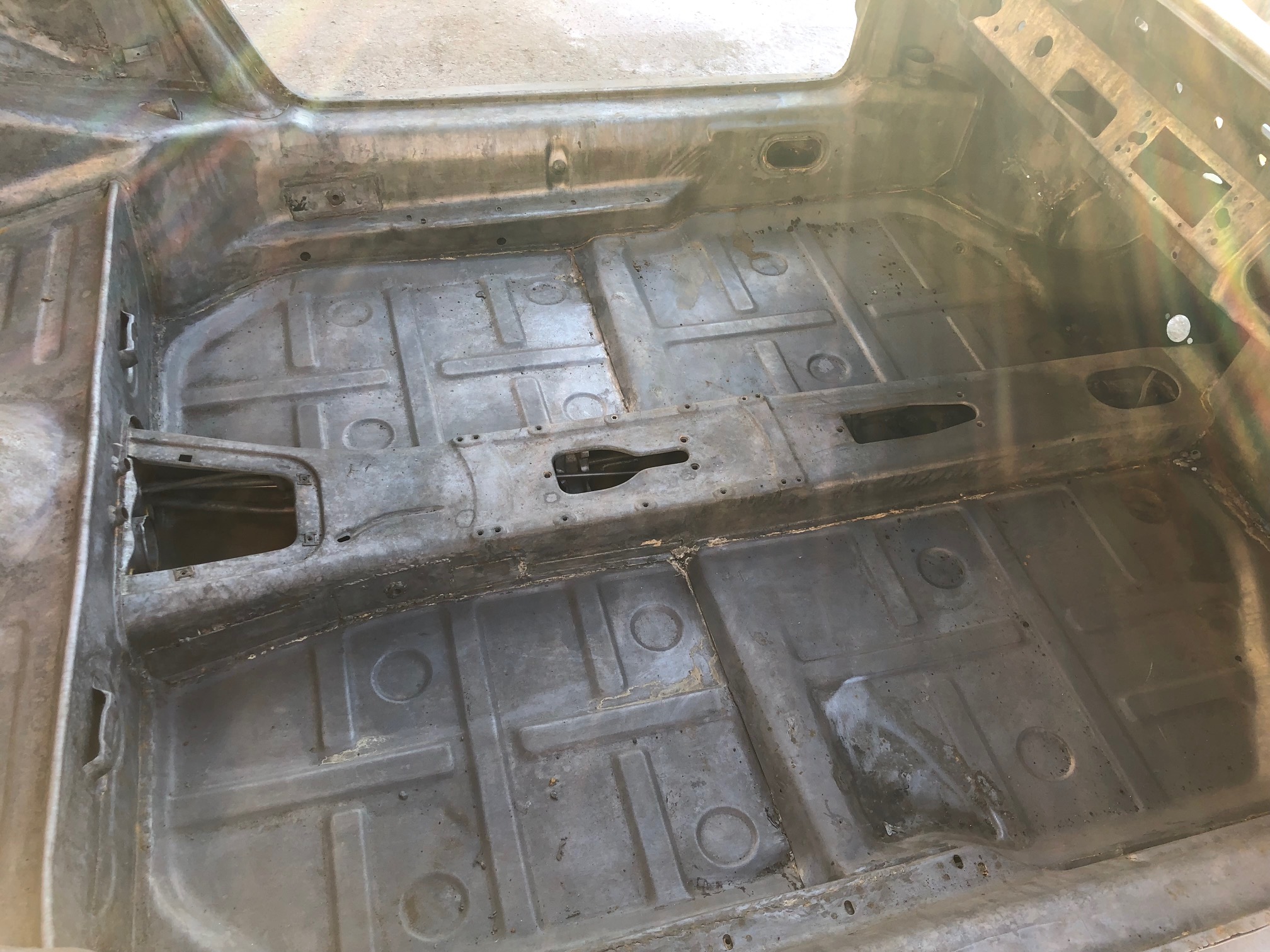

Tom1394racing   Over the past month, I have slowly been stripping ...   Feb 24 2022, 11:54 AM

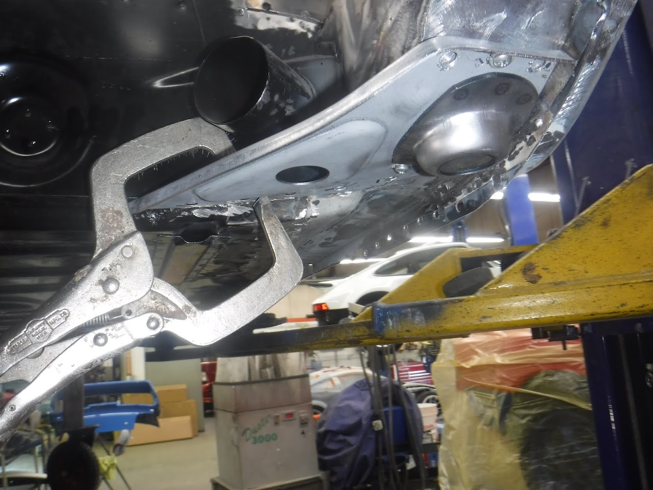

Tom1394racing   More rust I think I have gone about as far as ...   Feb 24 2022, 01:27 PM
ChrisFoley   No surprises there. The CA car on my lift is worse...   Feb 24 2022, 03:37 PM

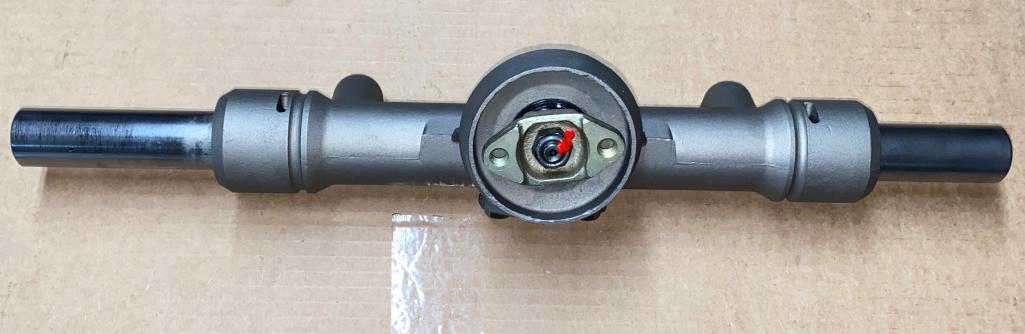

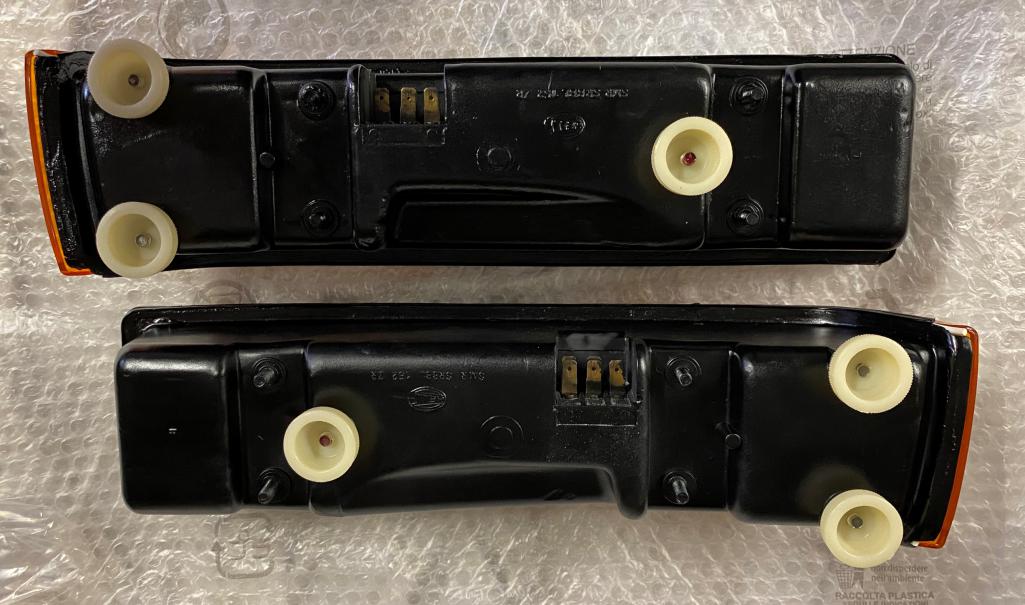

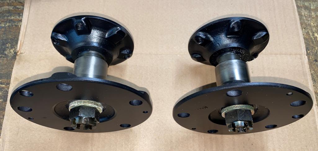

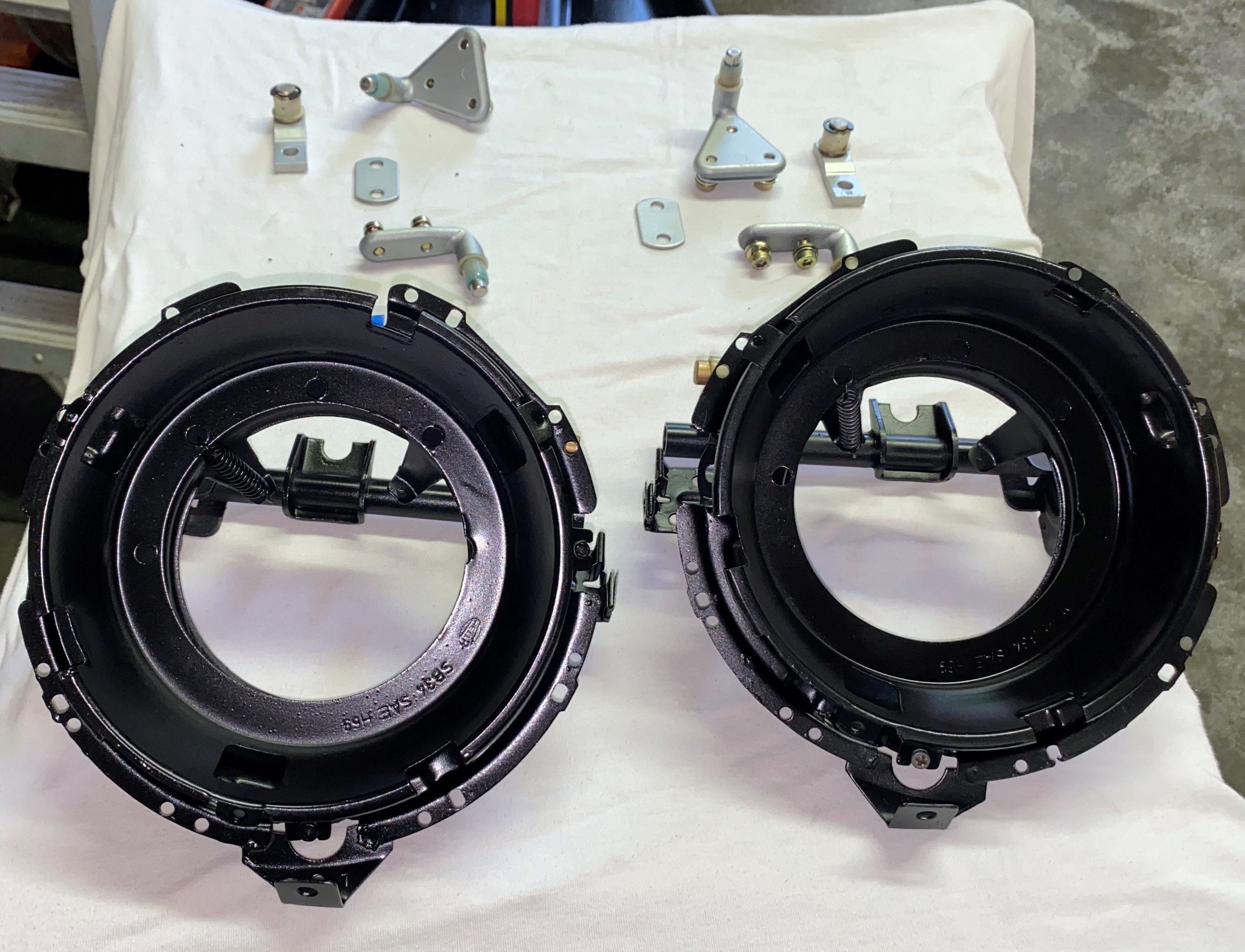

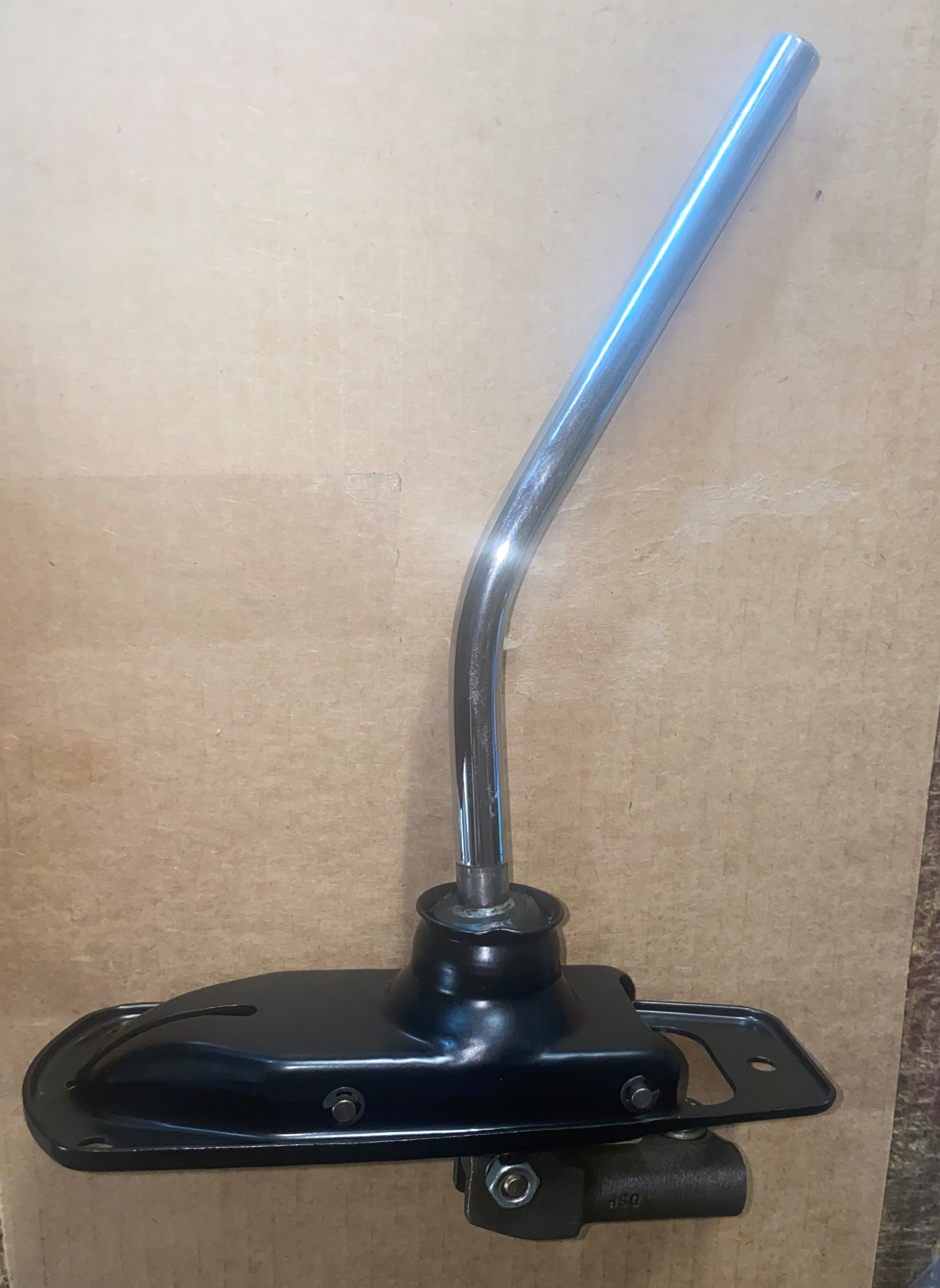

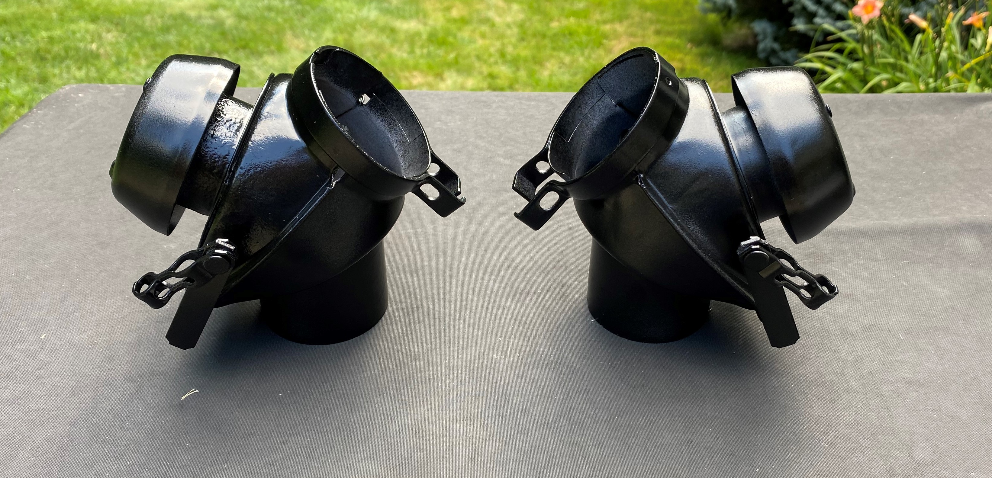

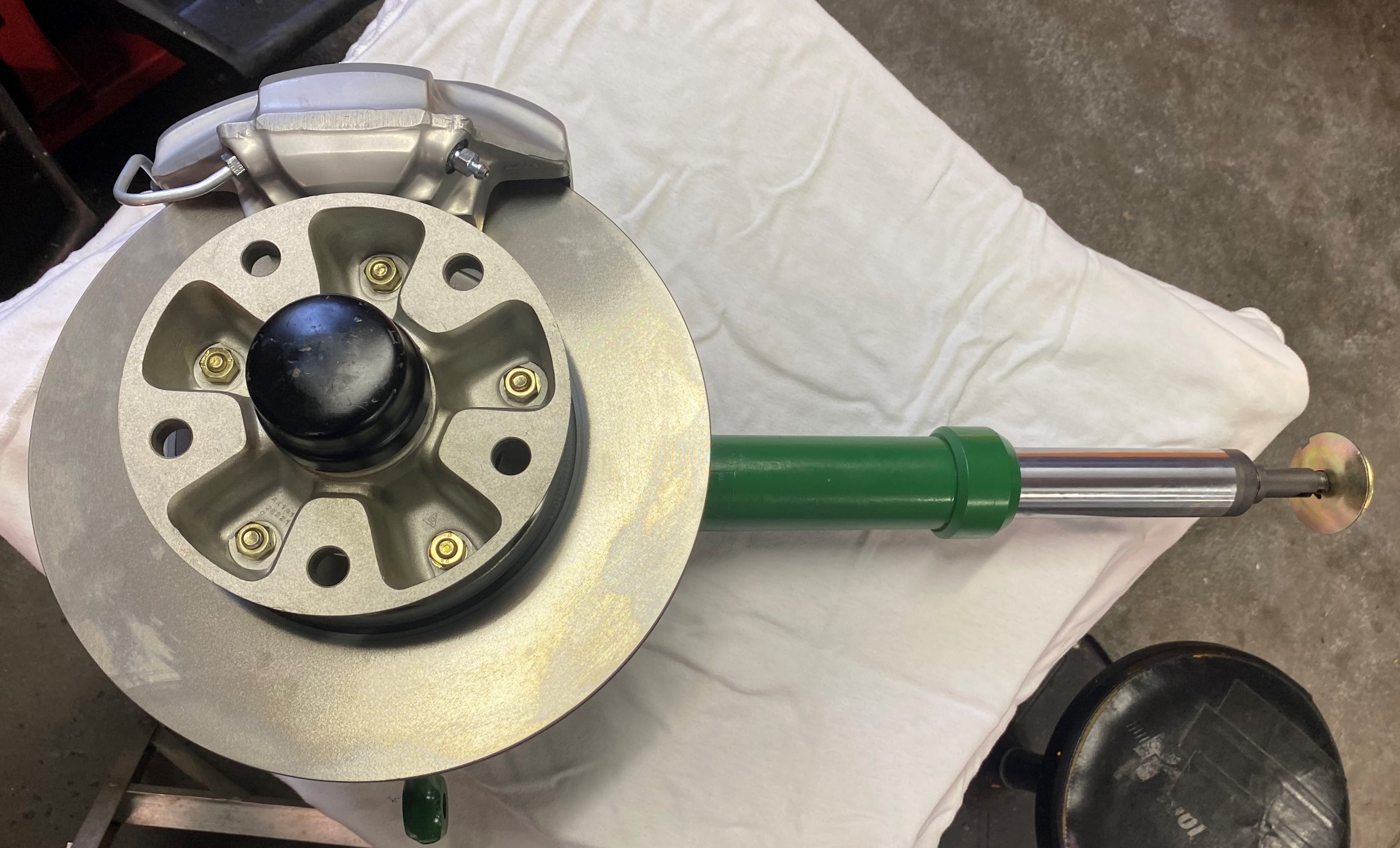

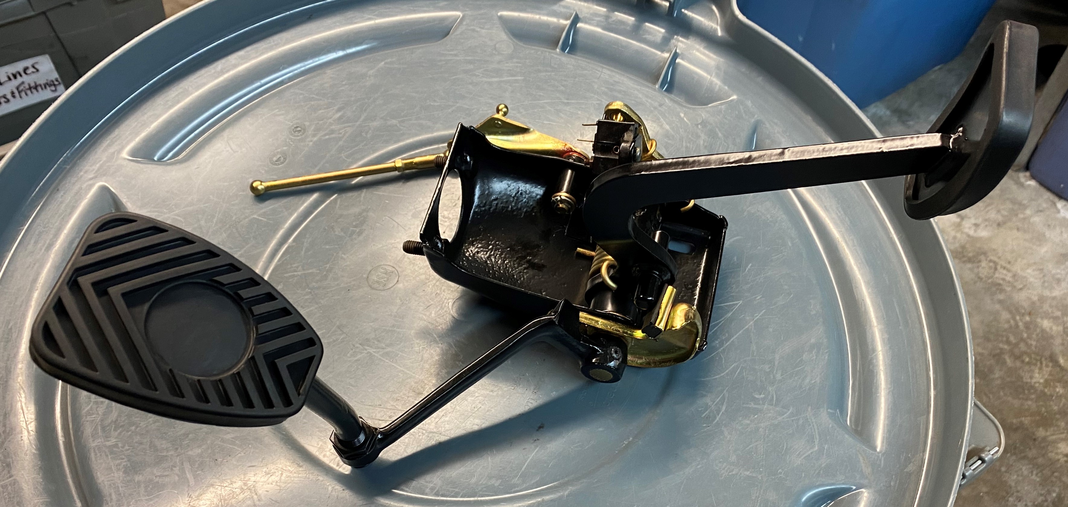

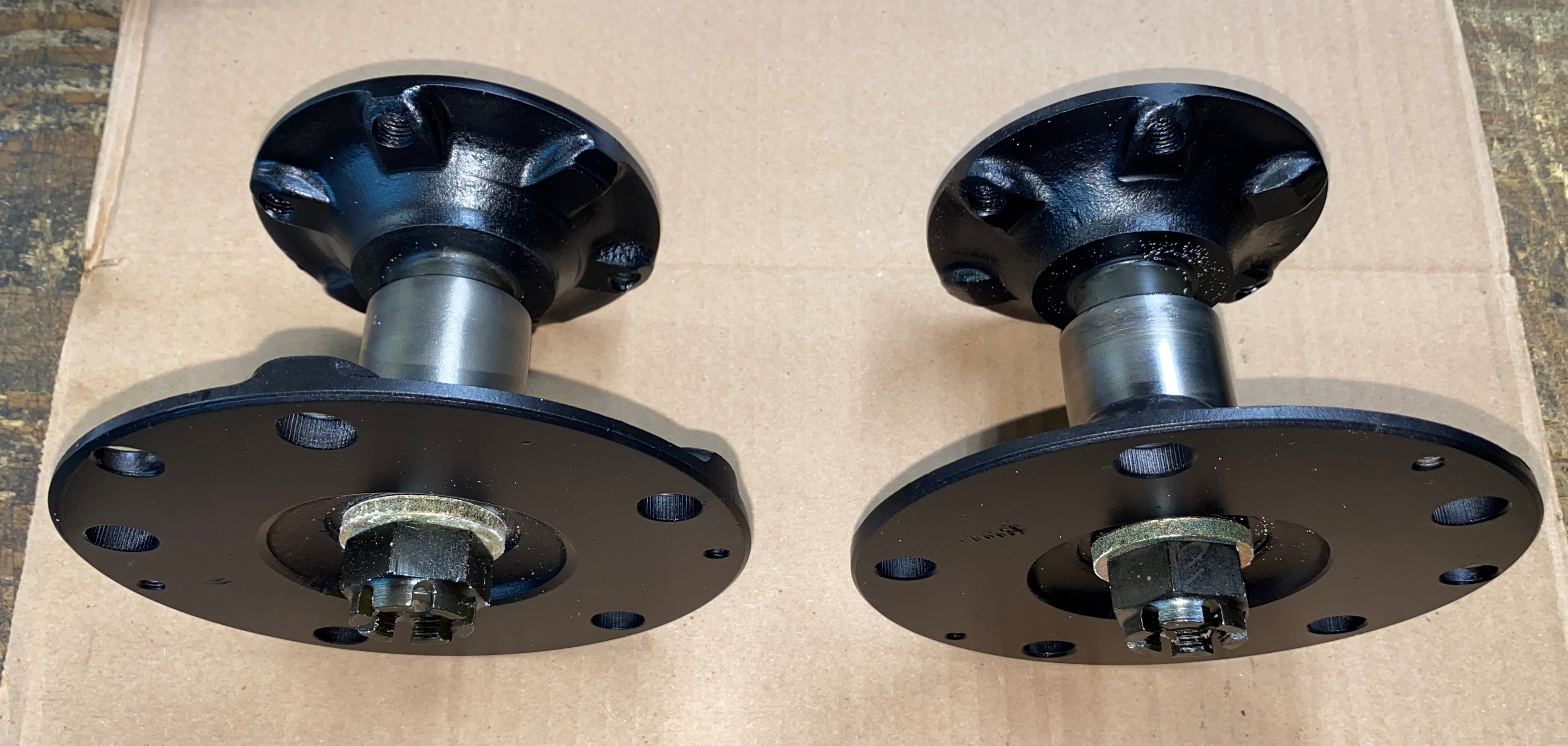

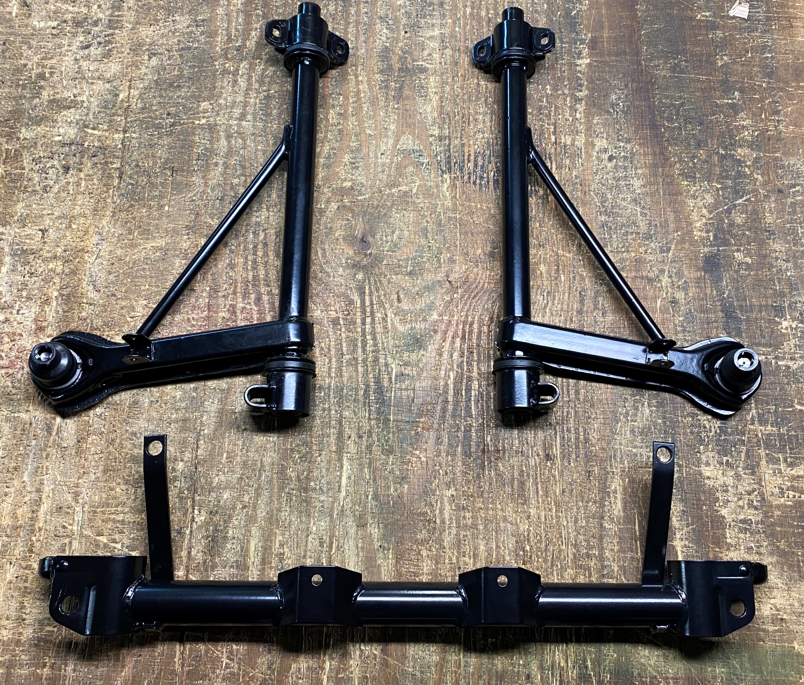

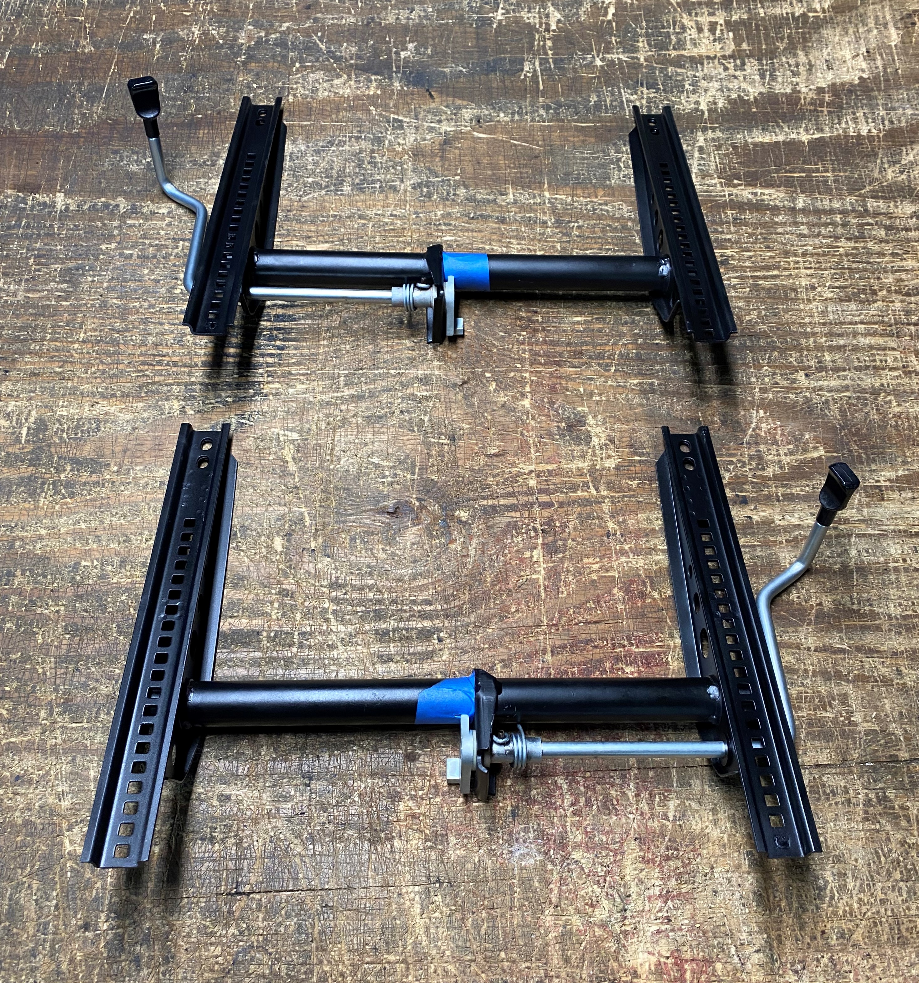

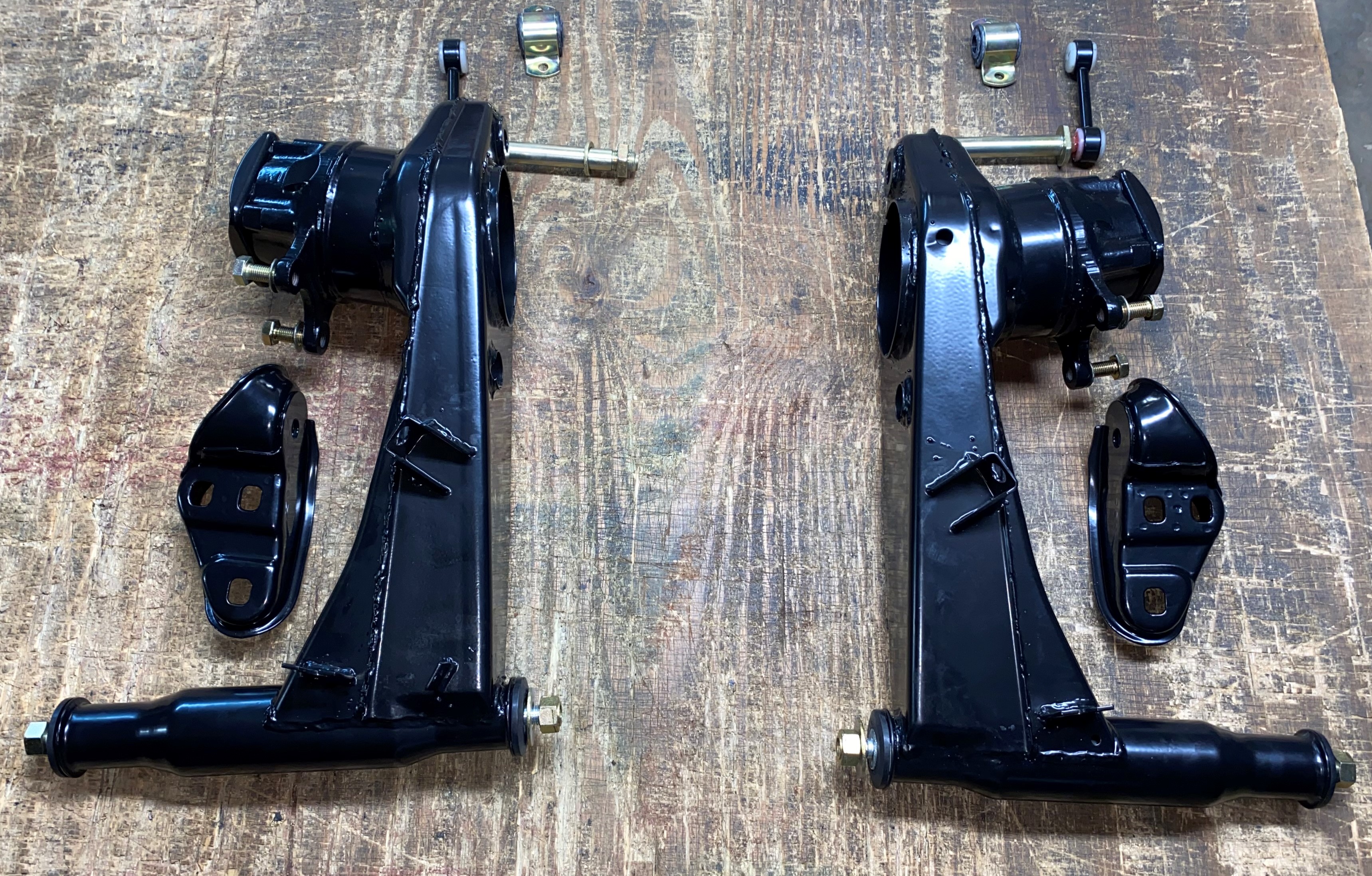

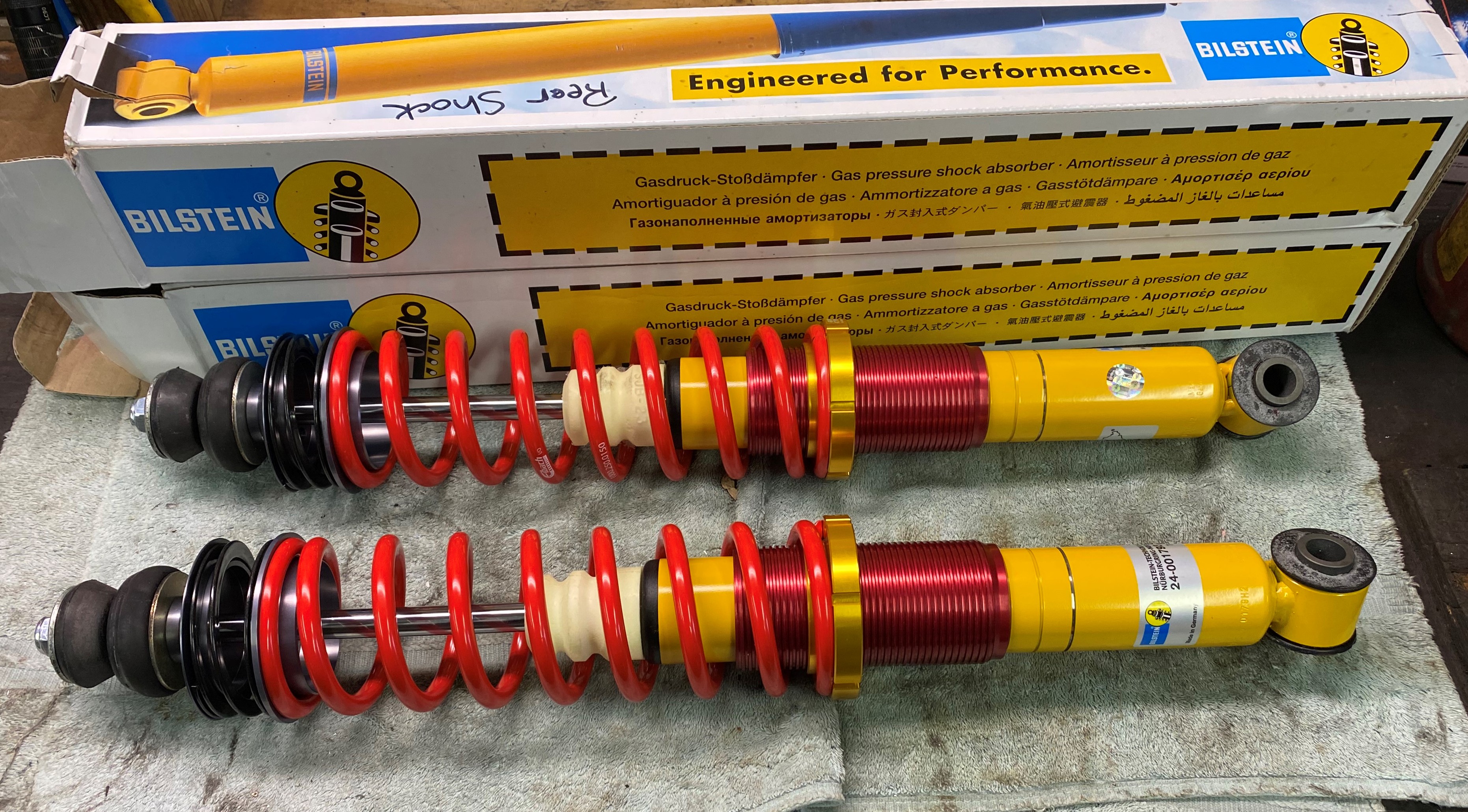

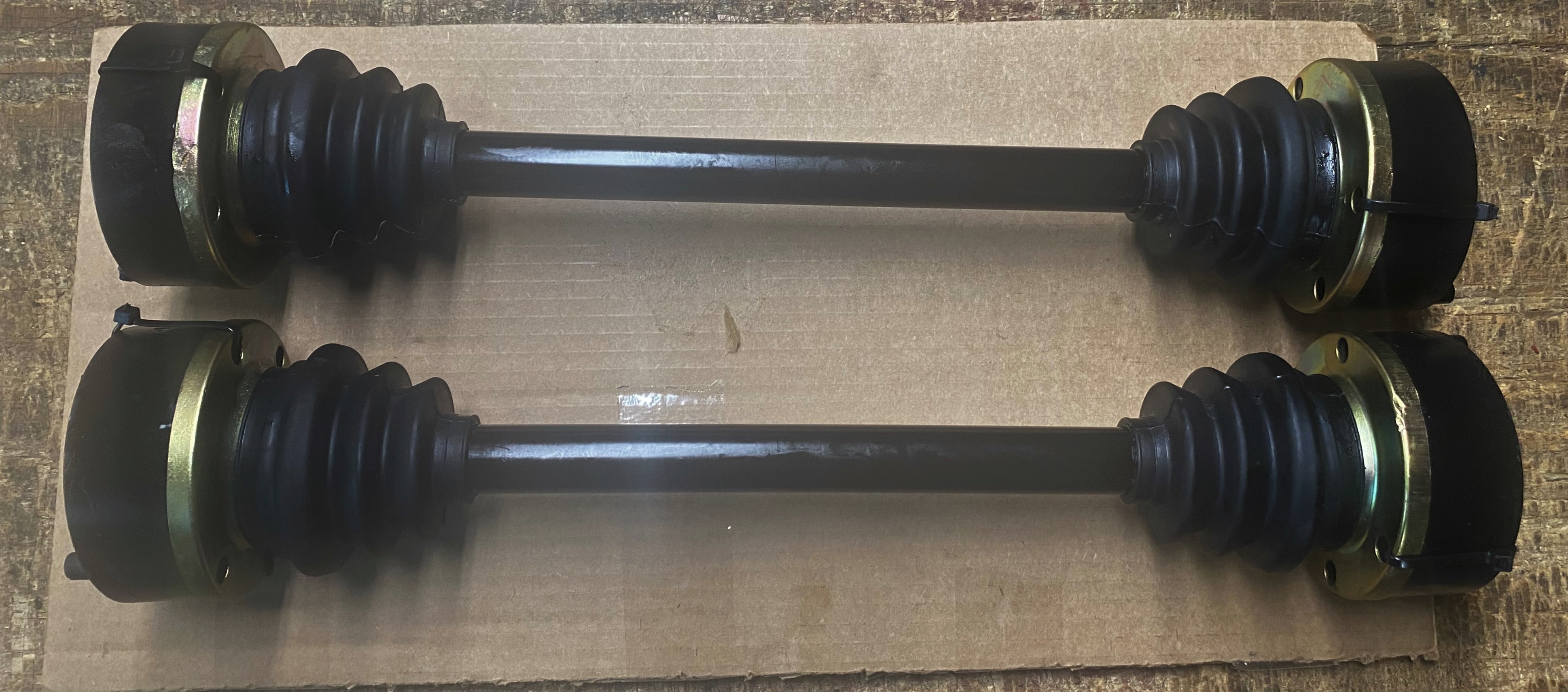

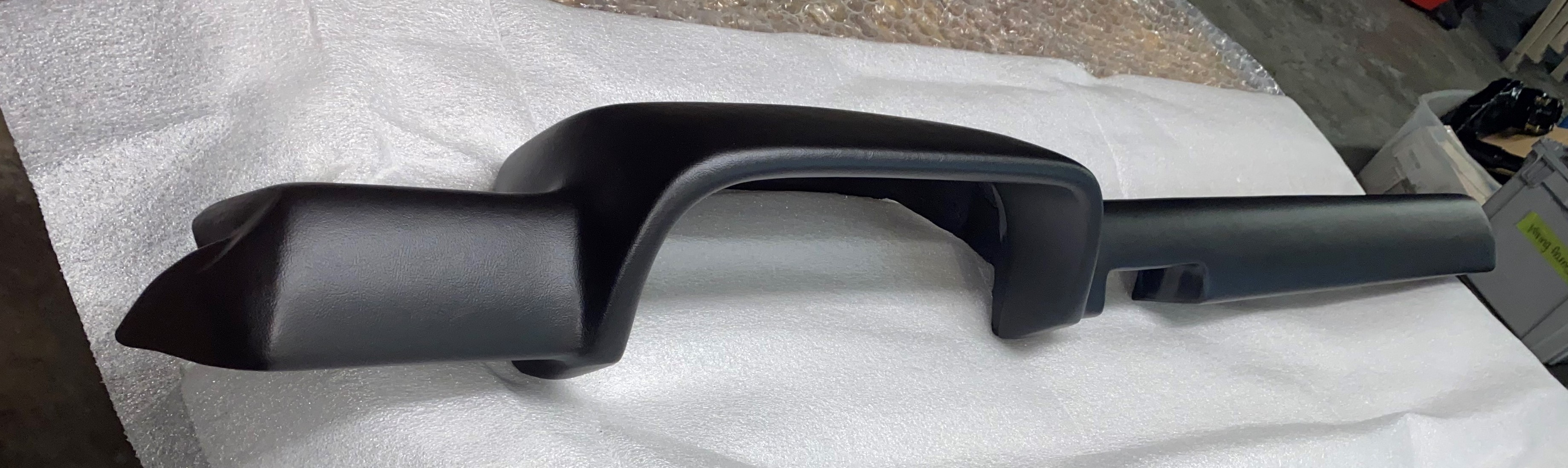

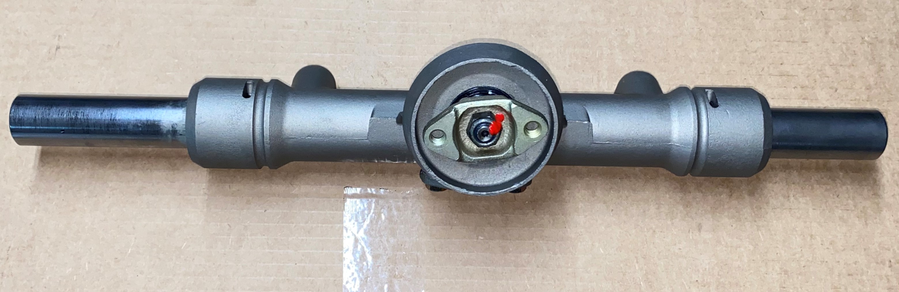

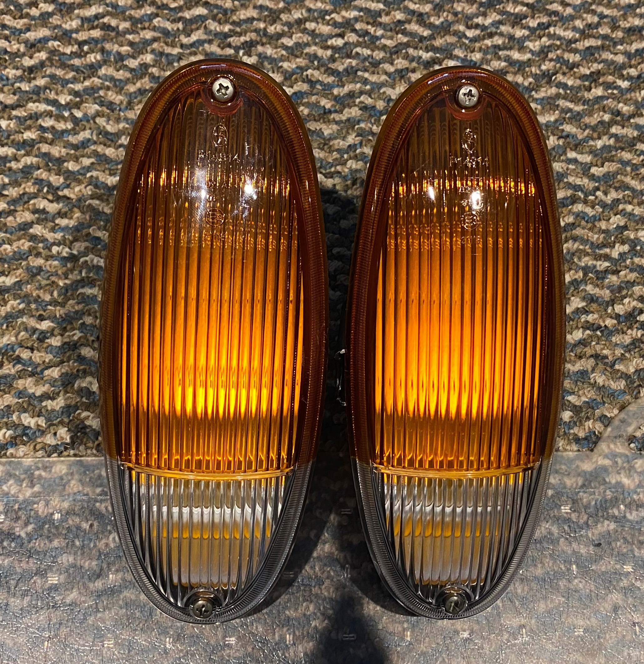

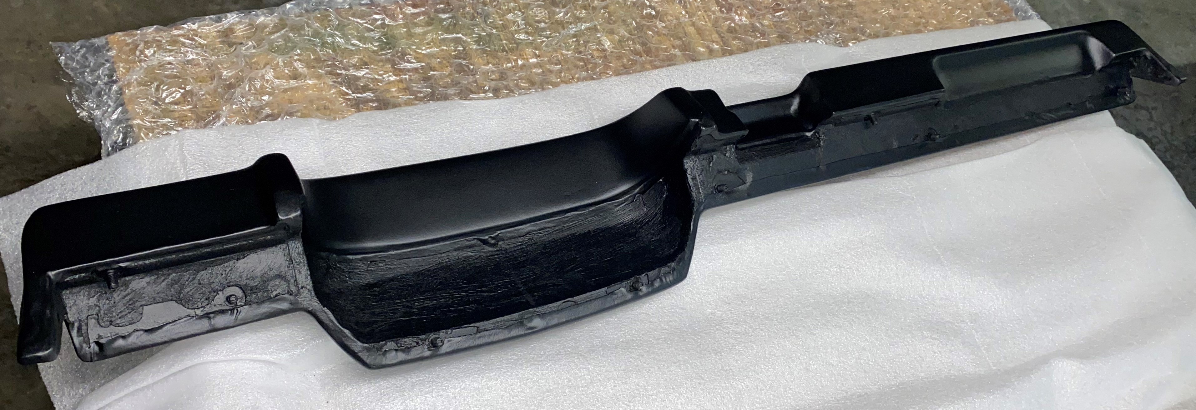

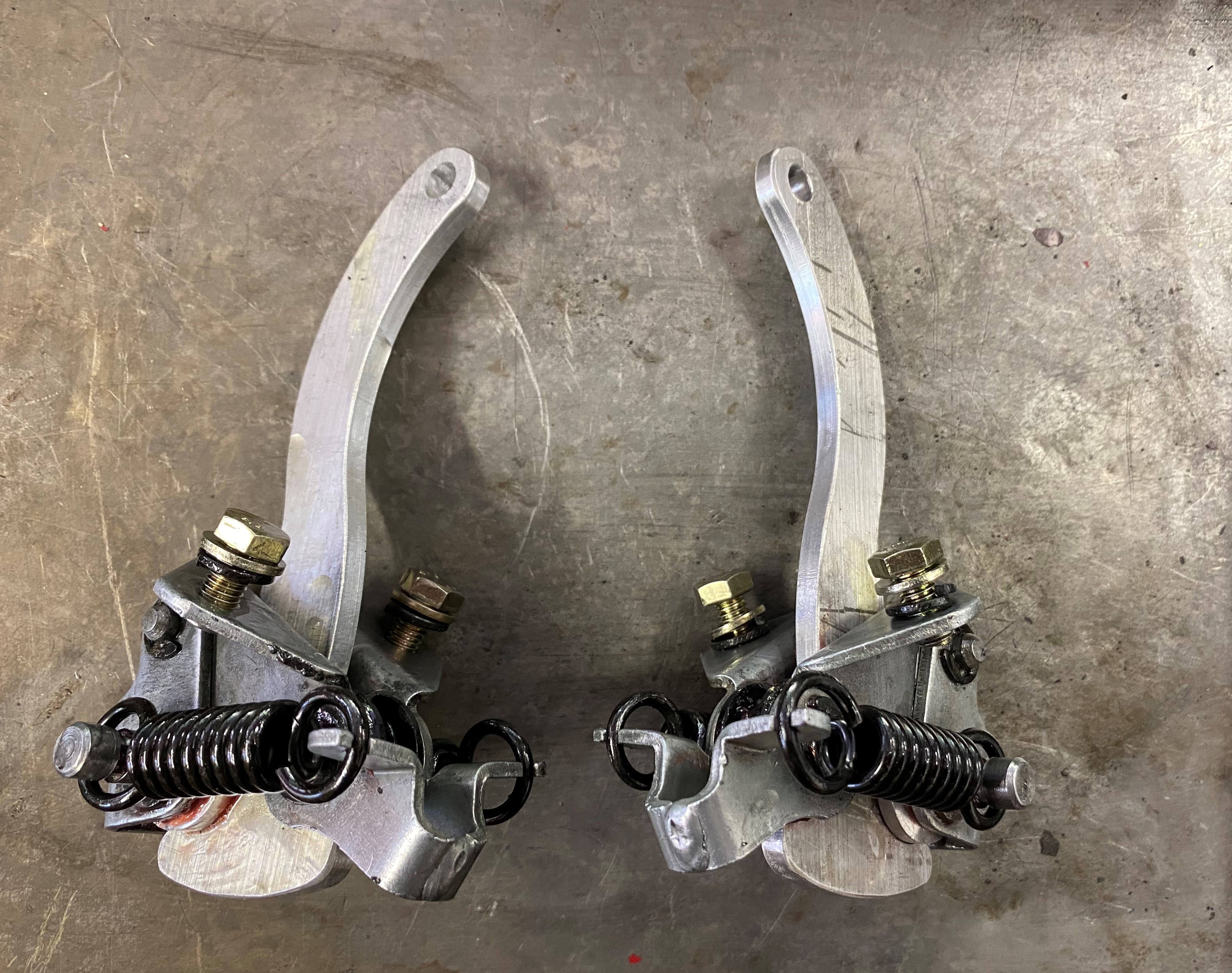

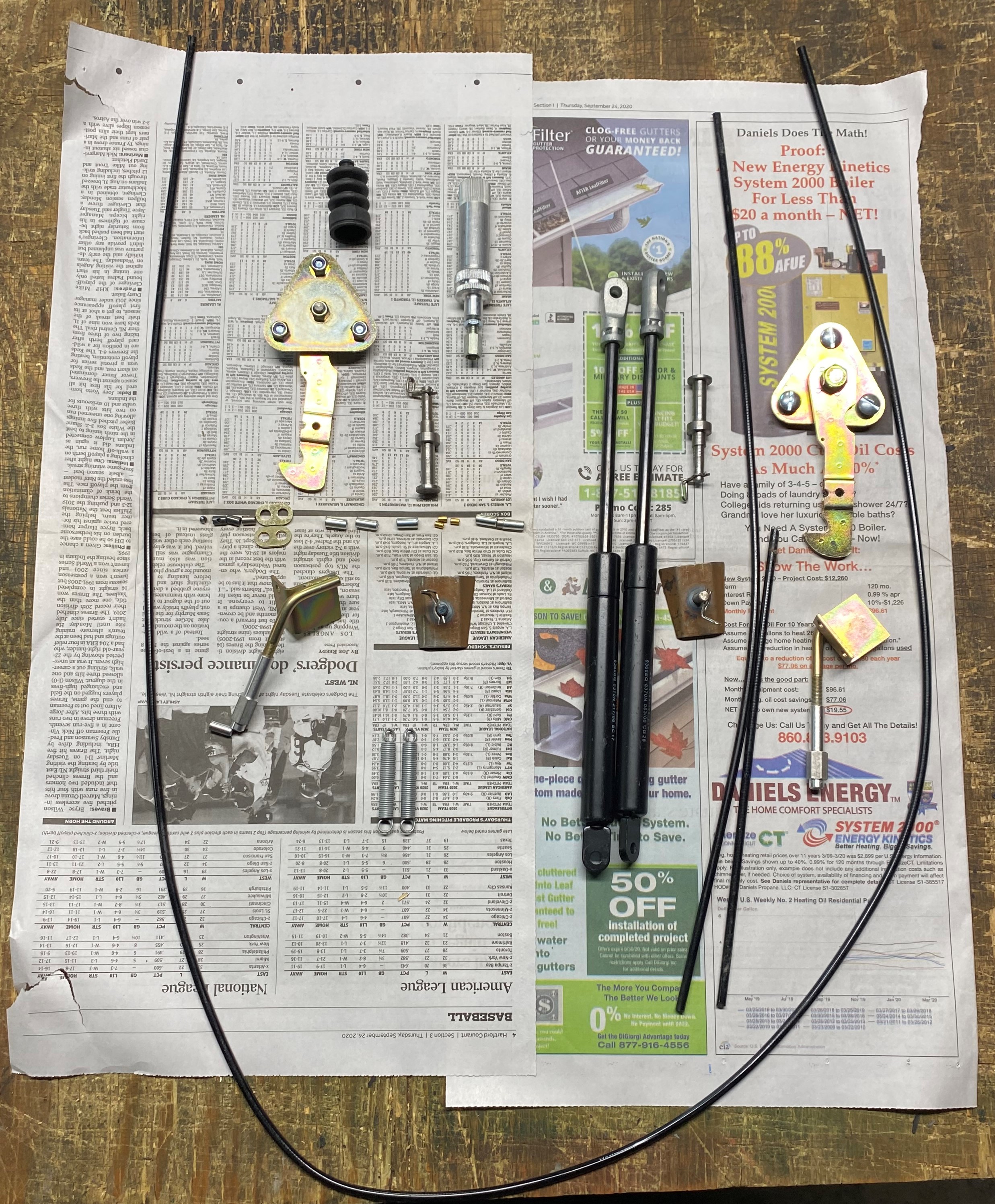

Tom1394racing   I have been able to source some cool parts for thi...   Apr 2 2022, 08:59 AM

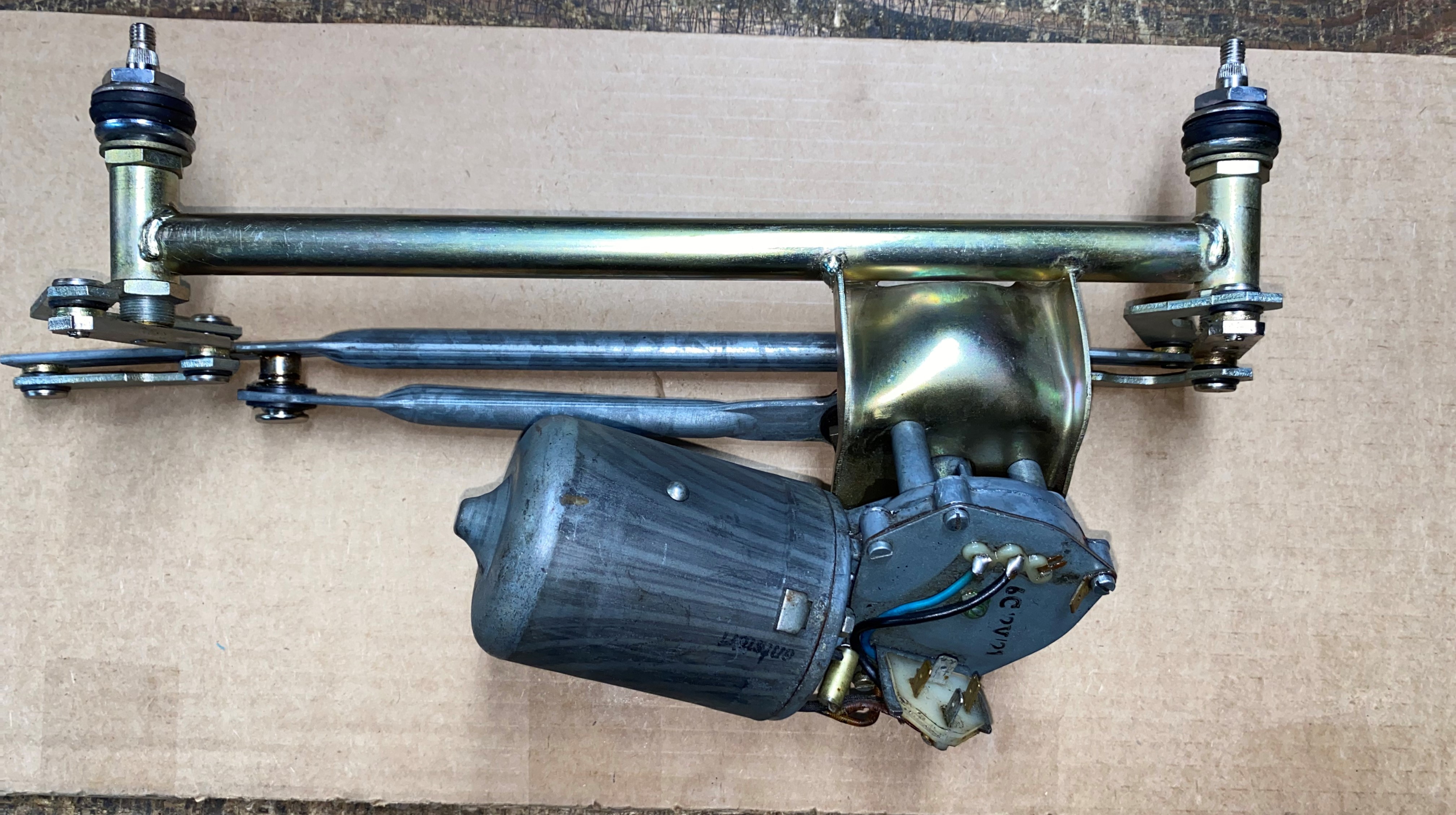

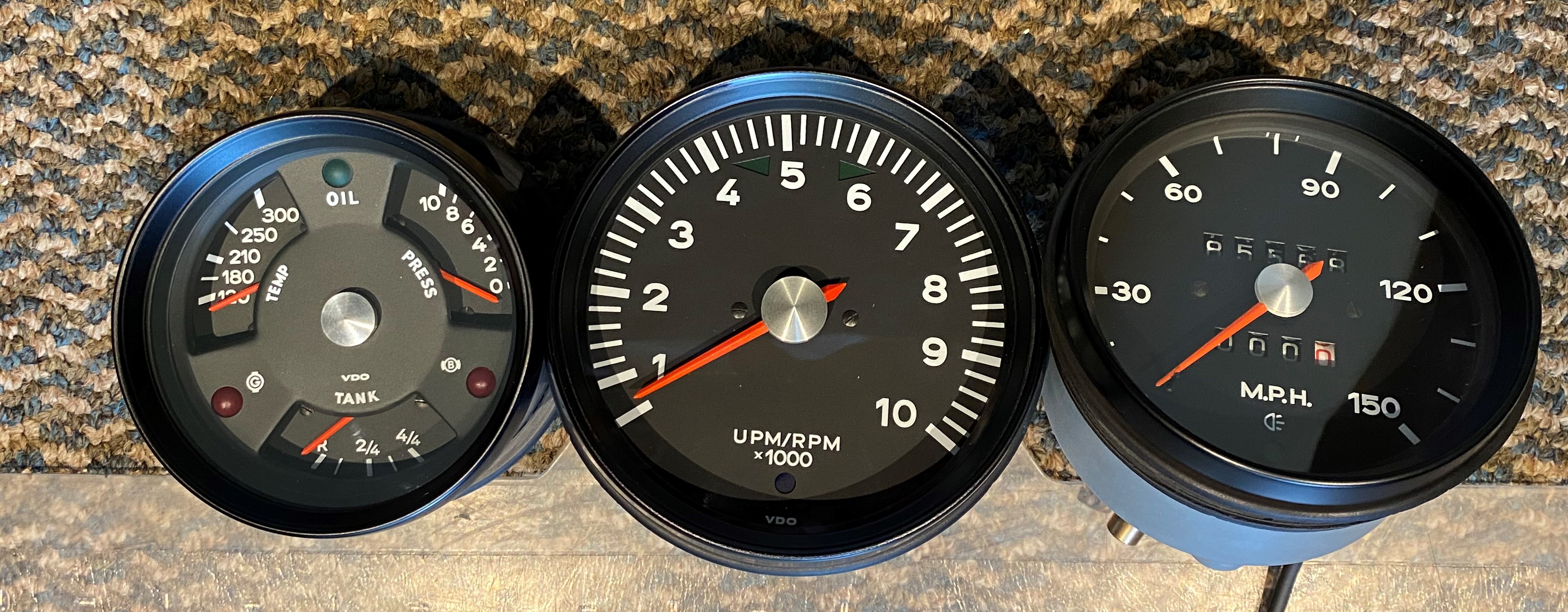

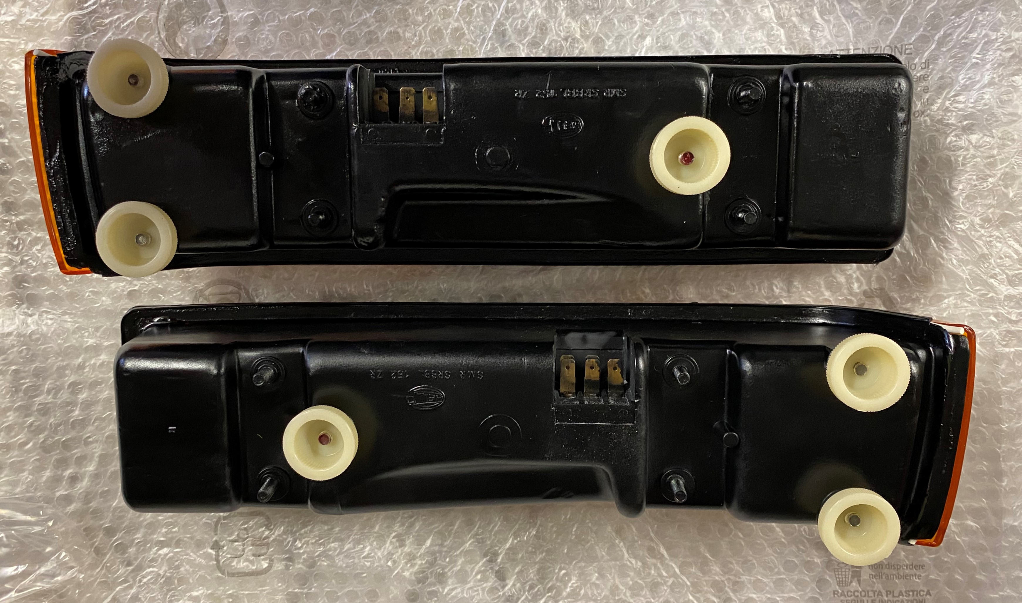

Tom1394racing   Look what showed up today from the UK.   Apr 6 2022, 02:49 PM

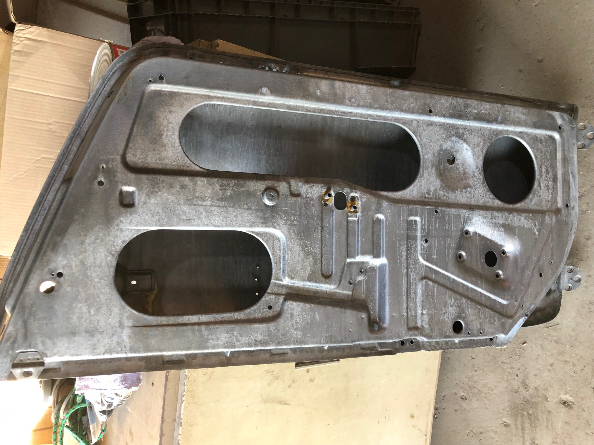

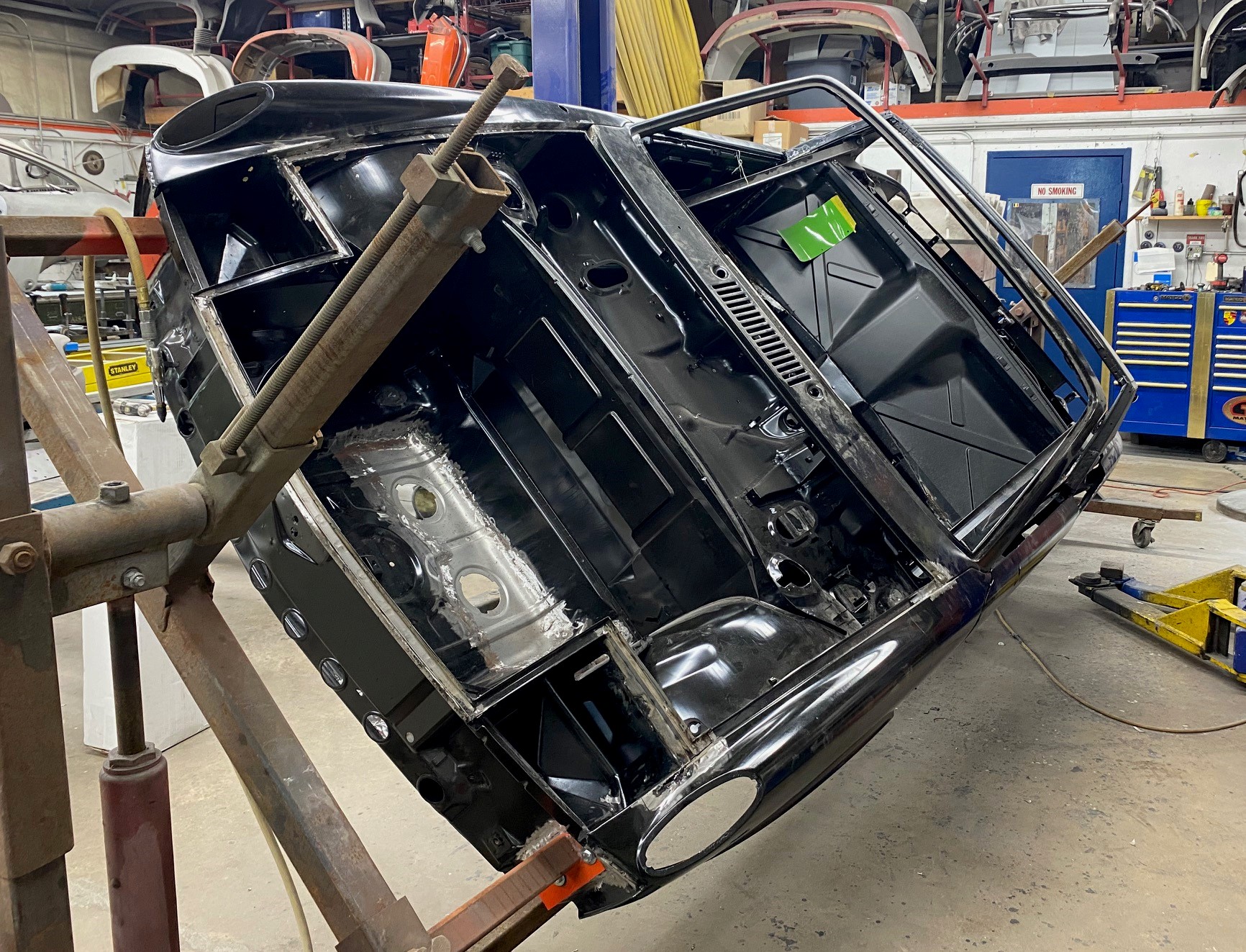

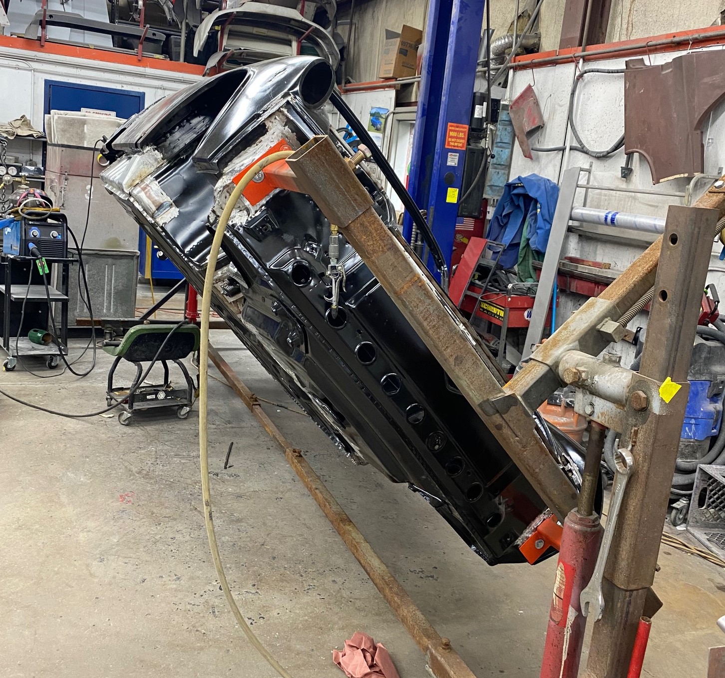

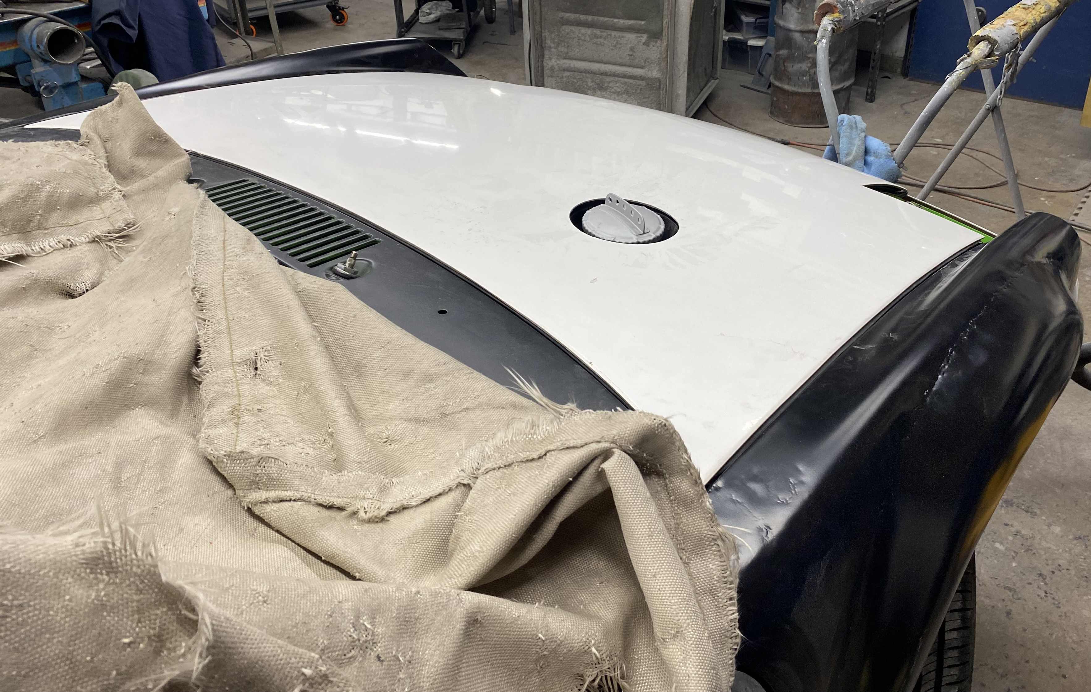

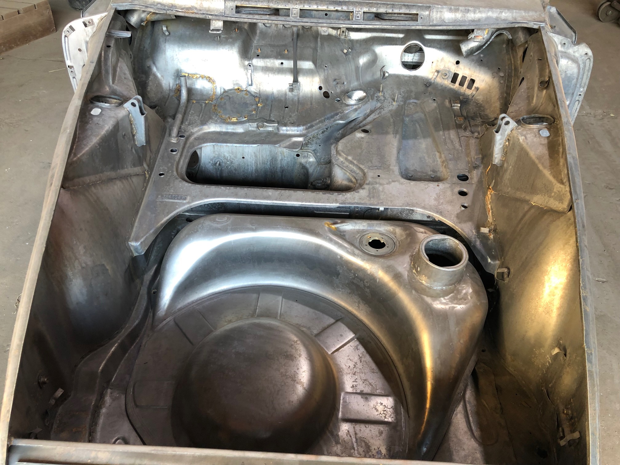

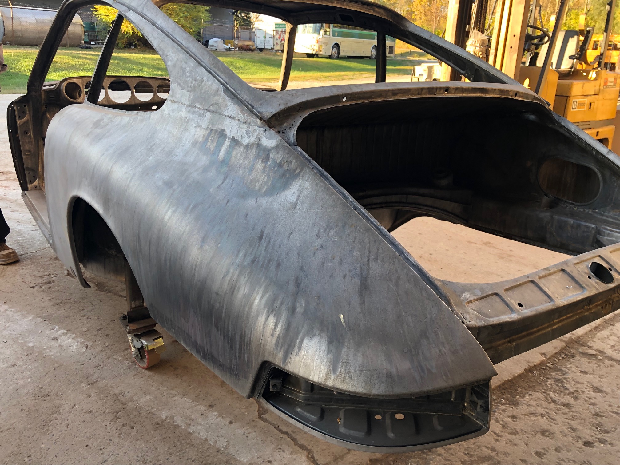

Tom1394racing   The shell has been stripped and mounted on a custo...   Nov 29 2022, 09:01 AM

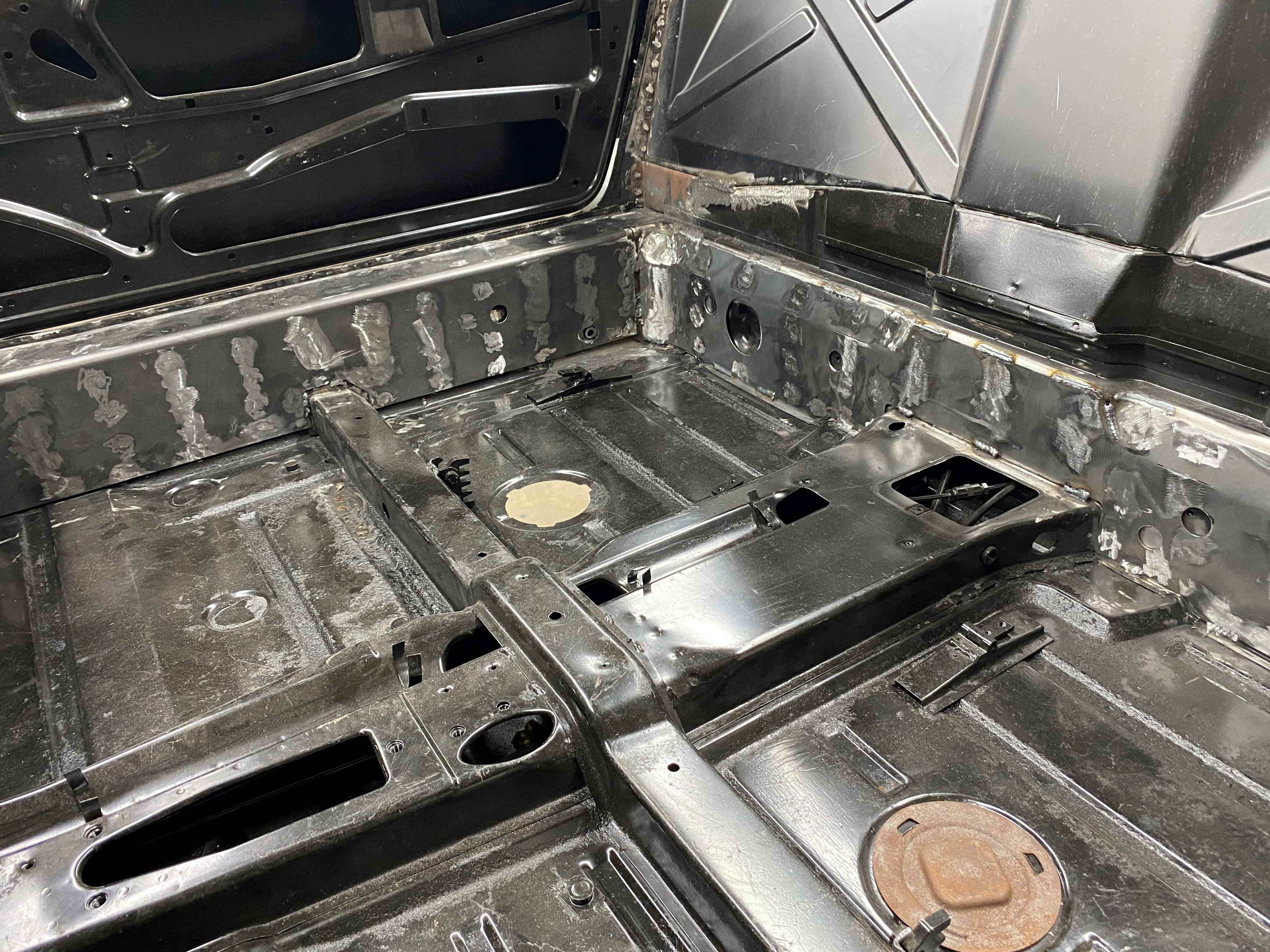

Tom1394racing   Since my last posting, the external longs were ope...   Jan 11 2023, 03:25 PM
Tom1394racing   Inner longs don't look too bad and the heater ...   Jan 11 2023, 03:29 PM

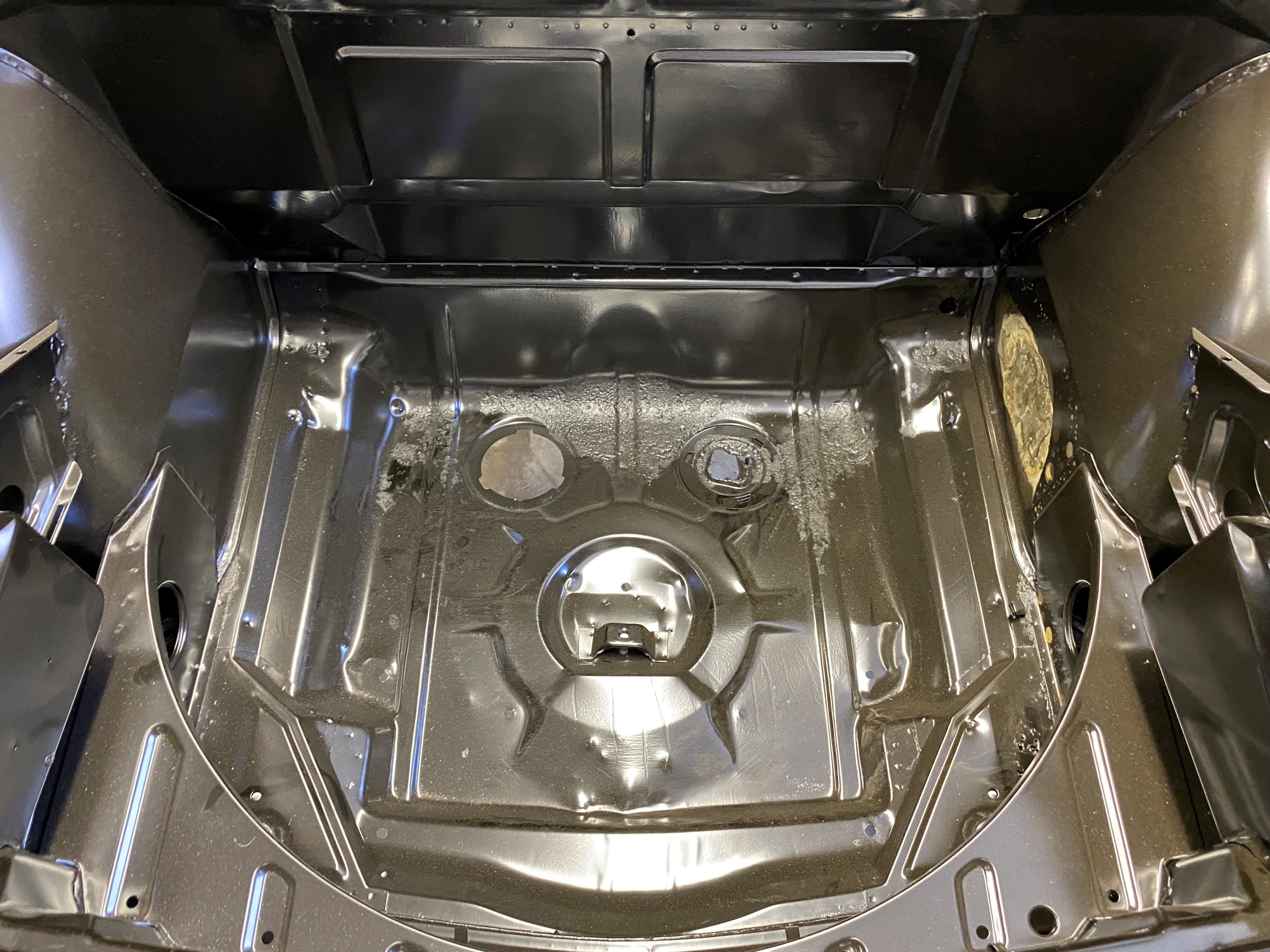

Tom1394racing   The chassis has now completed the dipping/E-coat p...   Jan 27 2023, 01:39 PM

mepstein   We had to take your car off the truck to get to mi...   Feb 26 2023, 07:13 PM
Tom1394racing   Mine is back home as well. I am pretty happy with ...   Feb 28 2023, 03:40 PM

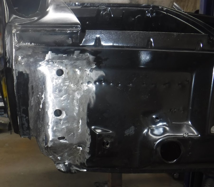

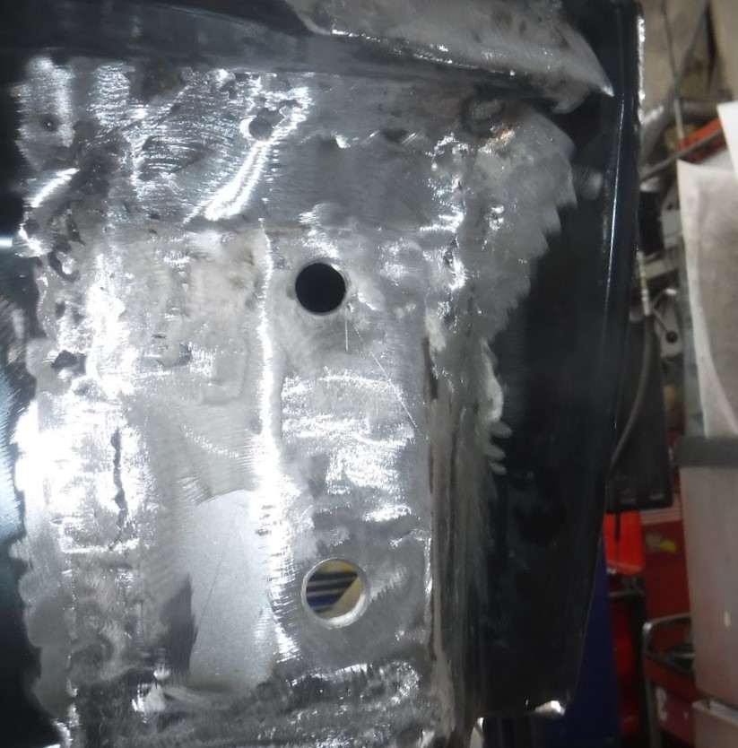

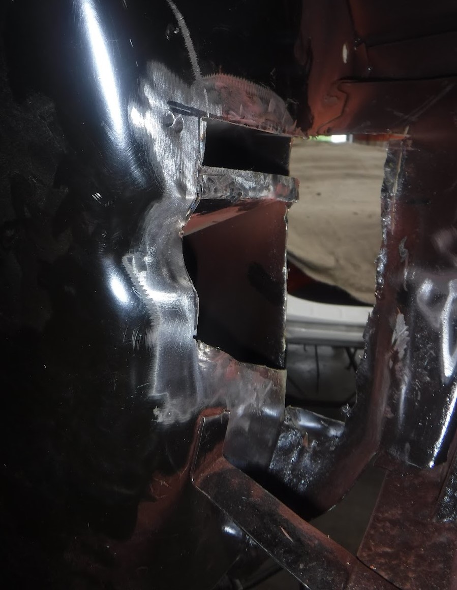

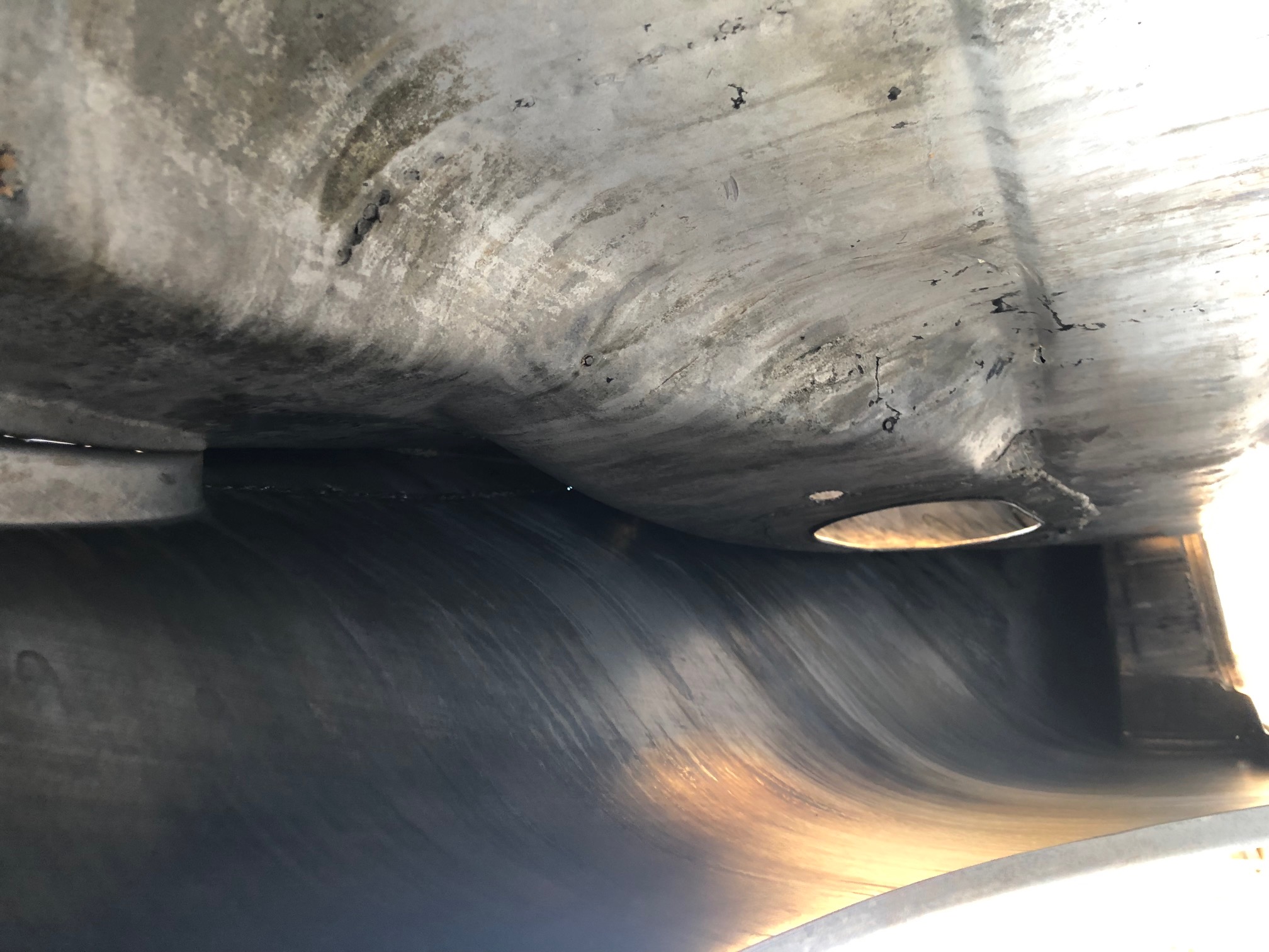

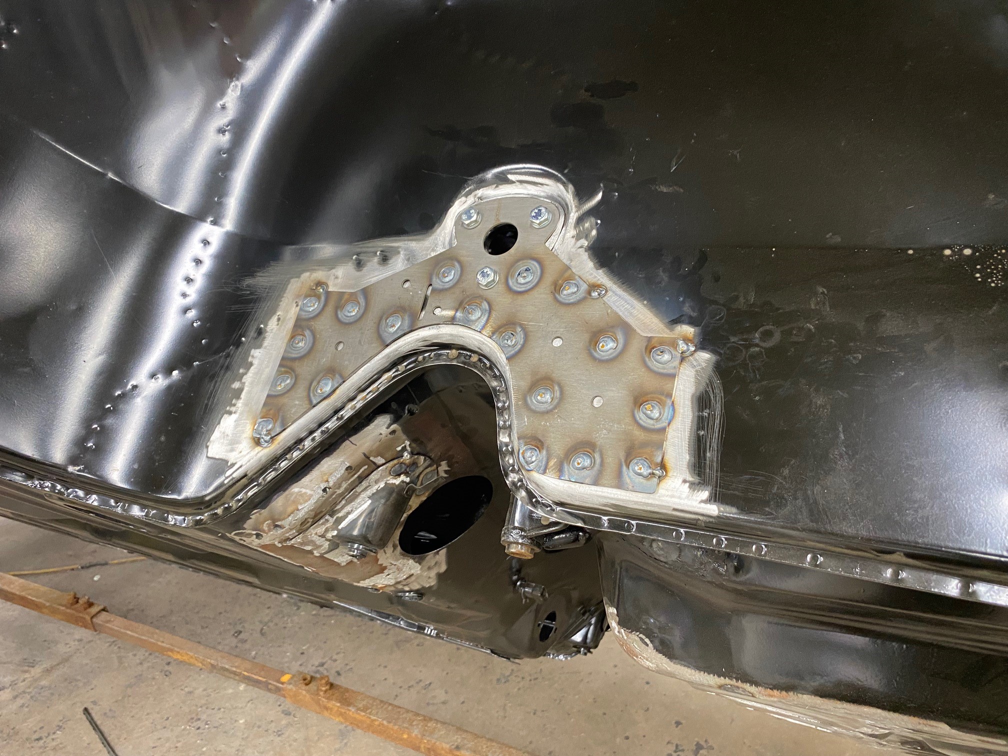

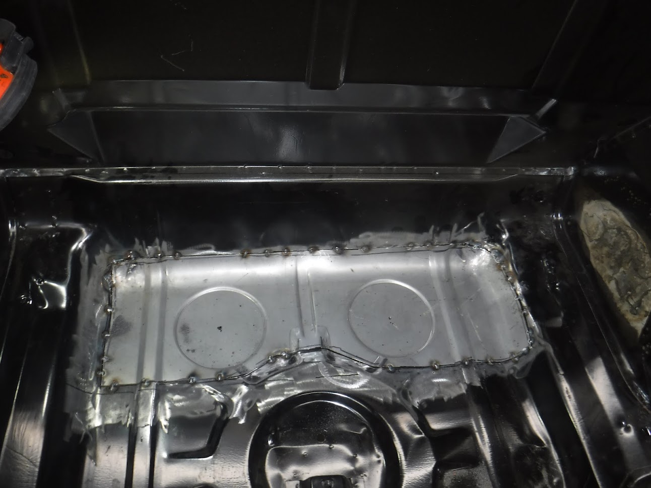

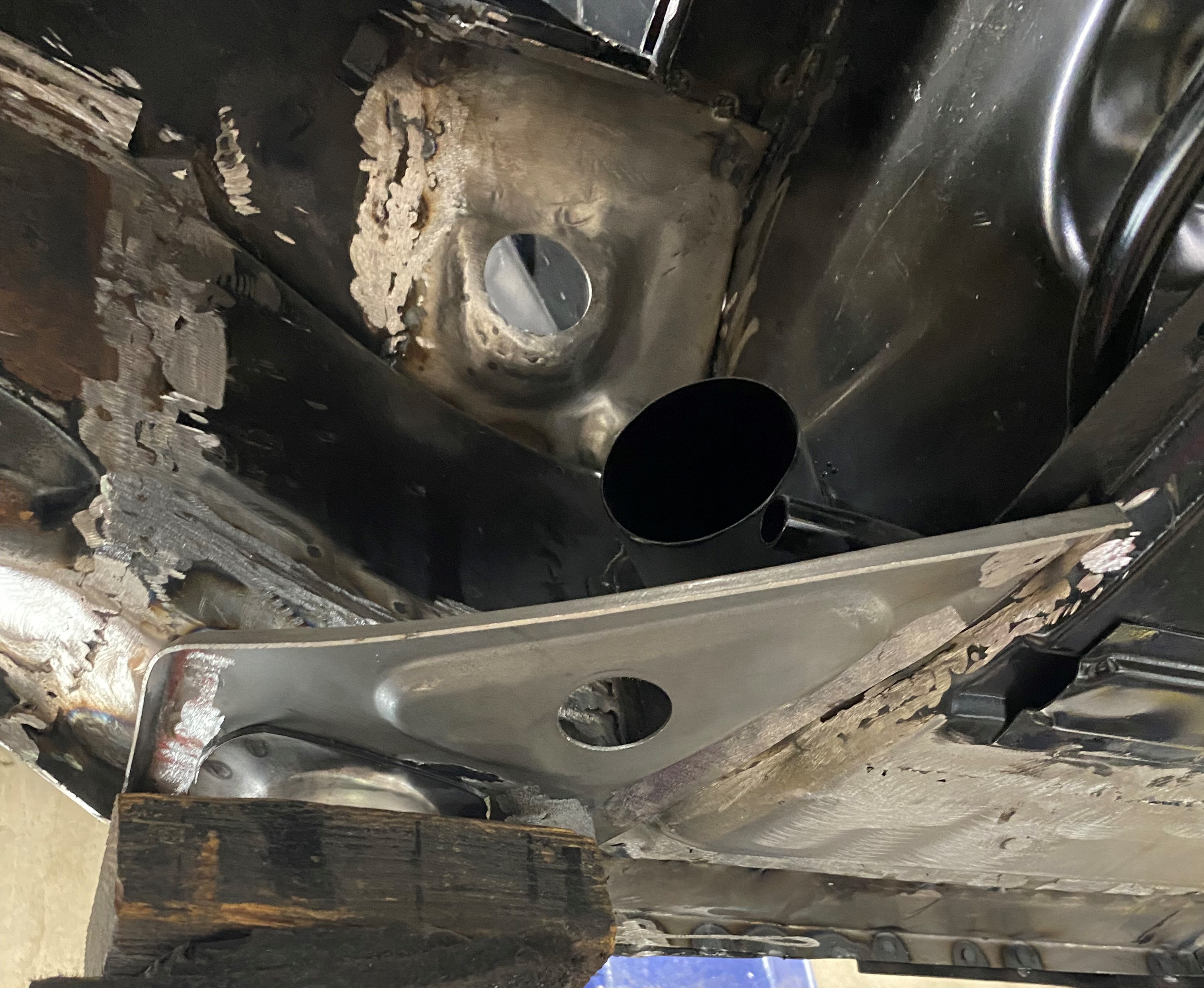

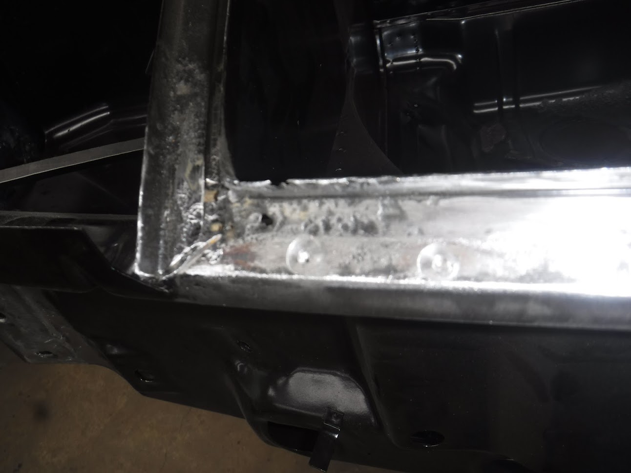

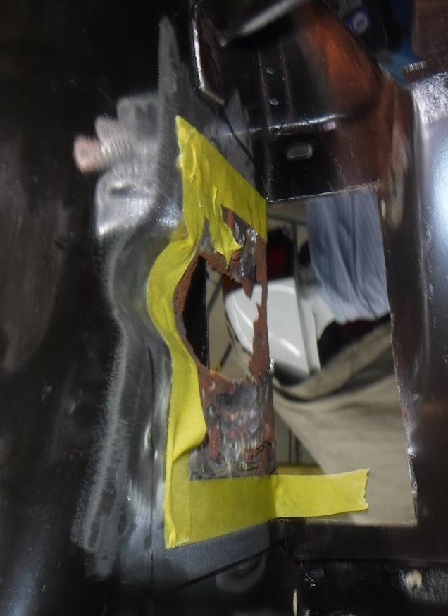

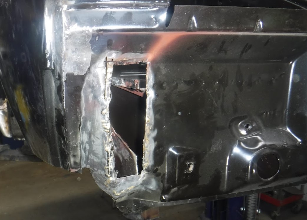

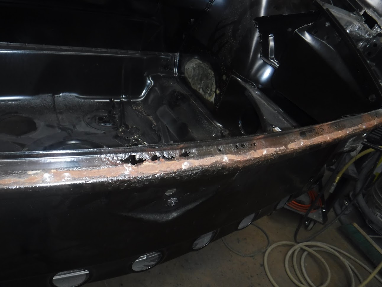

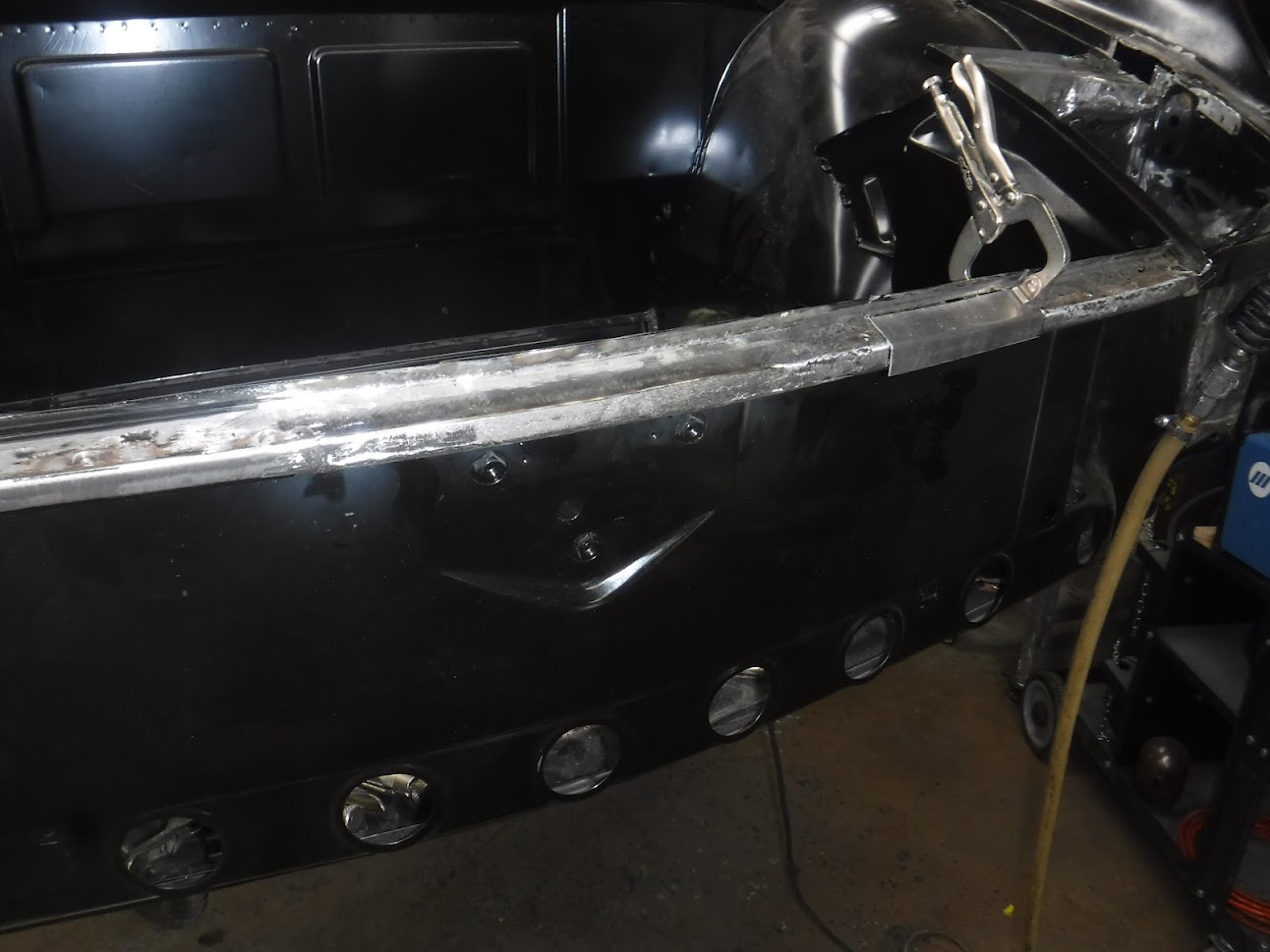

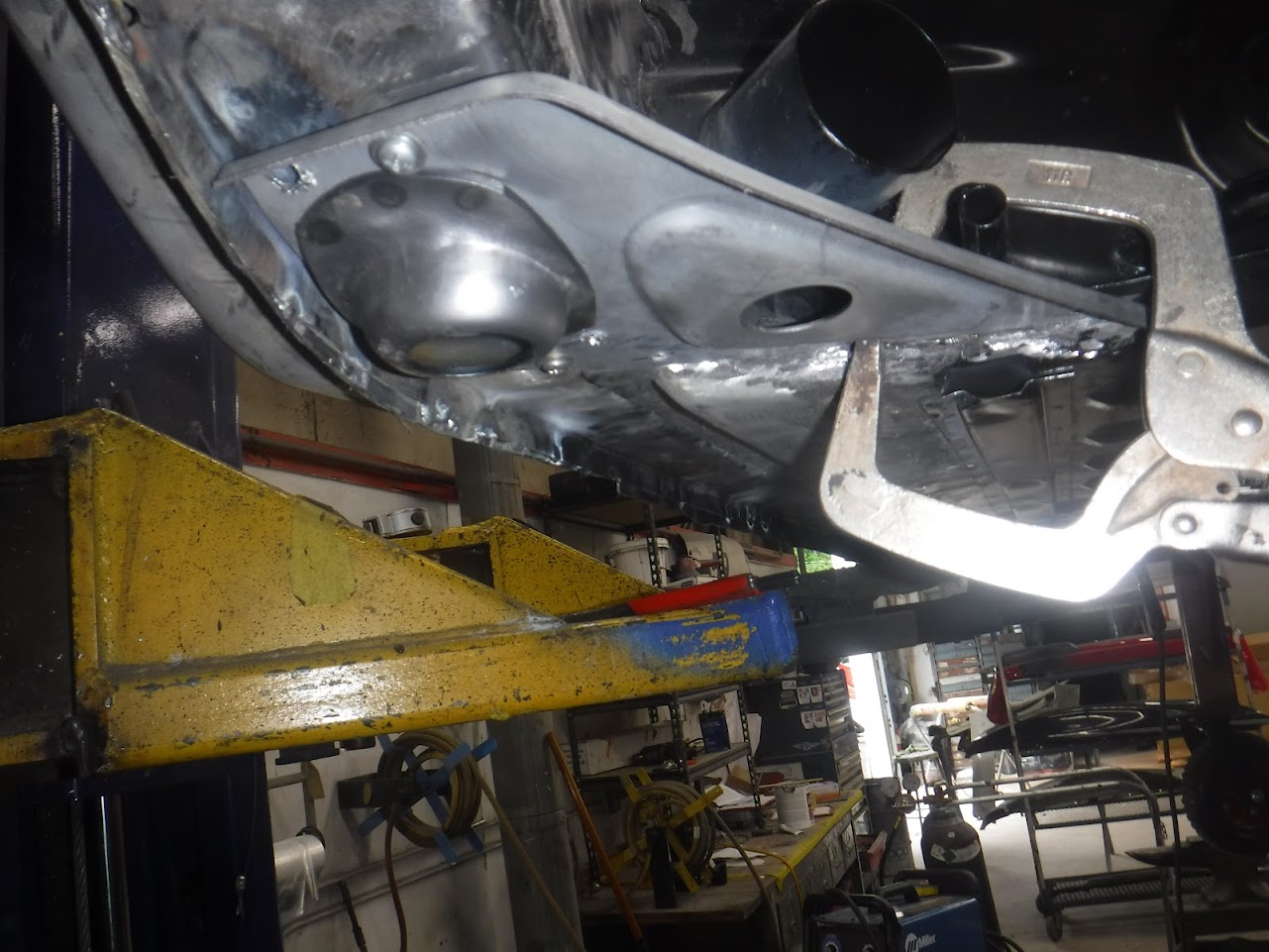

Tom1394racing   Here are some examples of the nasty hidden sins th...   Feb 28 2023, 04:02 PM

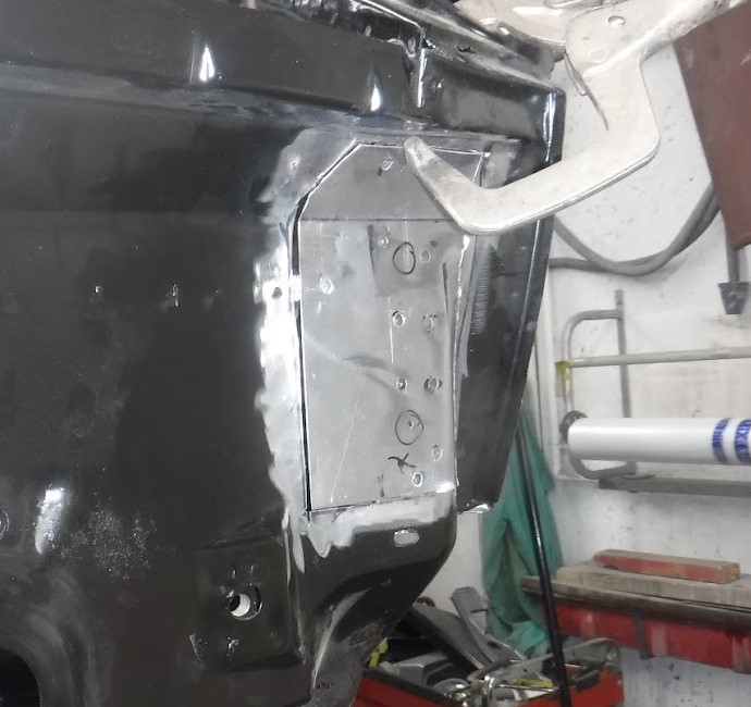

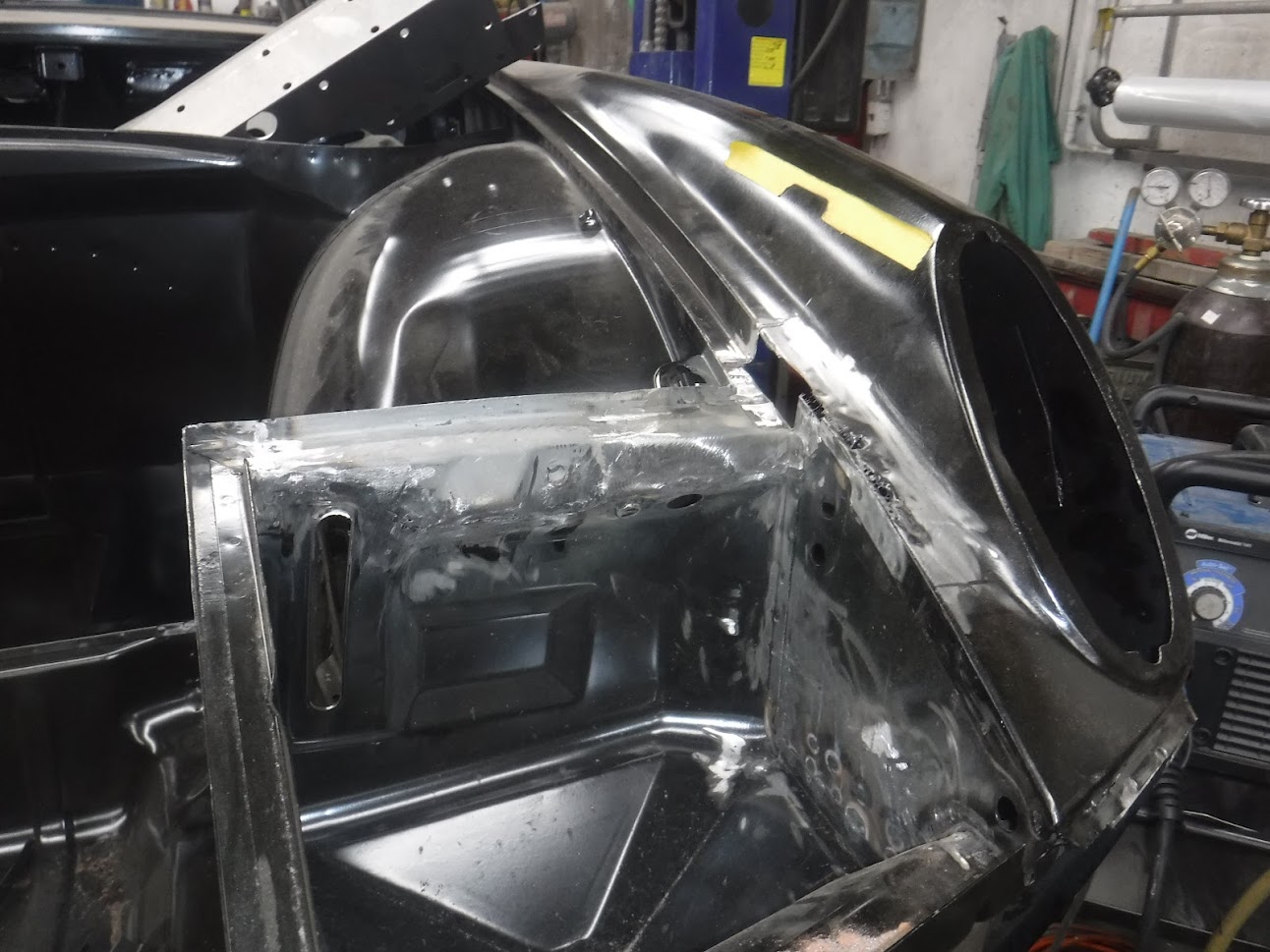

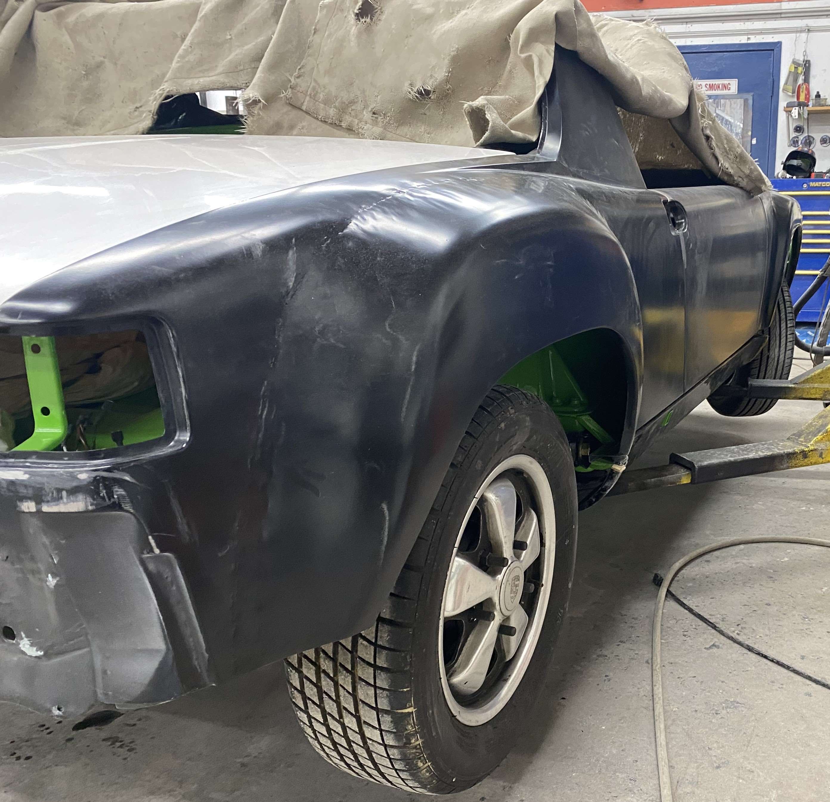

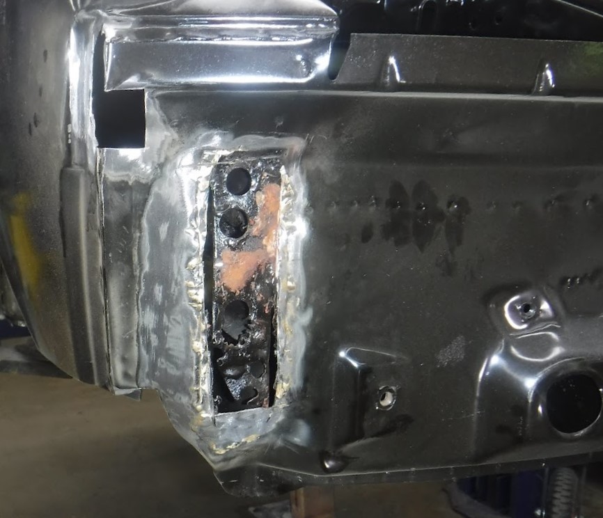

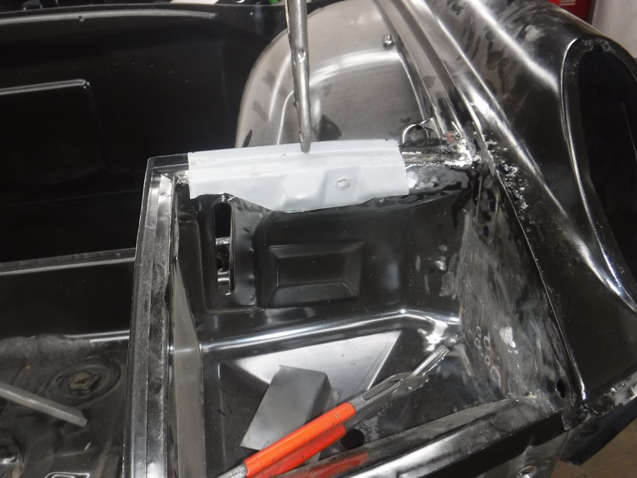

Tom1394racing   After the extensive rust repair, the GT conversion...   Feb 28 2023, 04:09 PM
mepstein   The dip and e-coat make the good metal look really...   Feb 28 2023, 04:56 PM

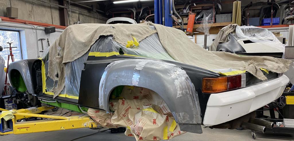

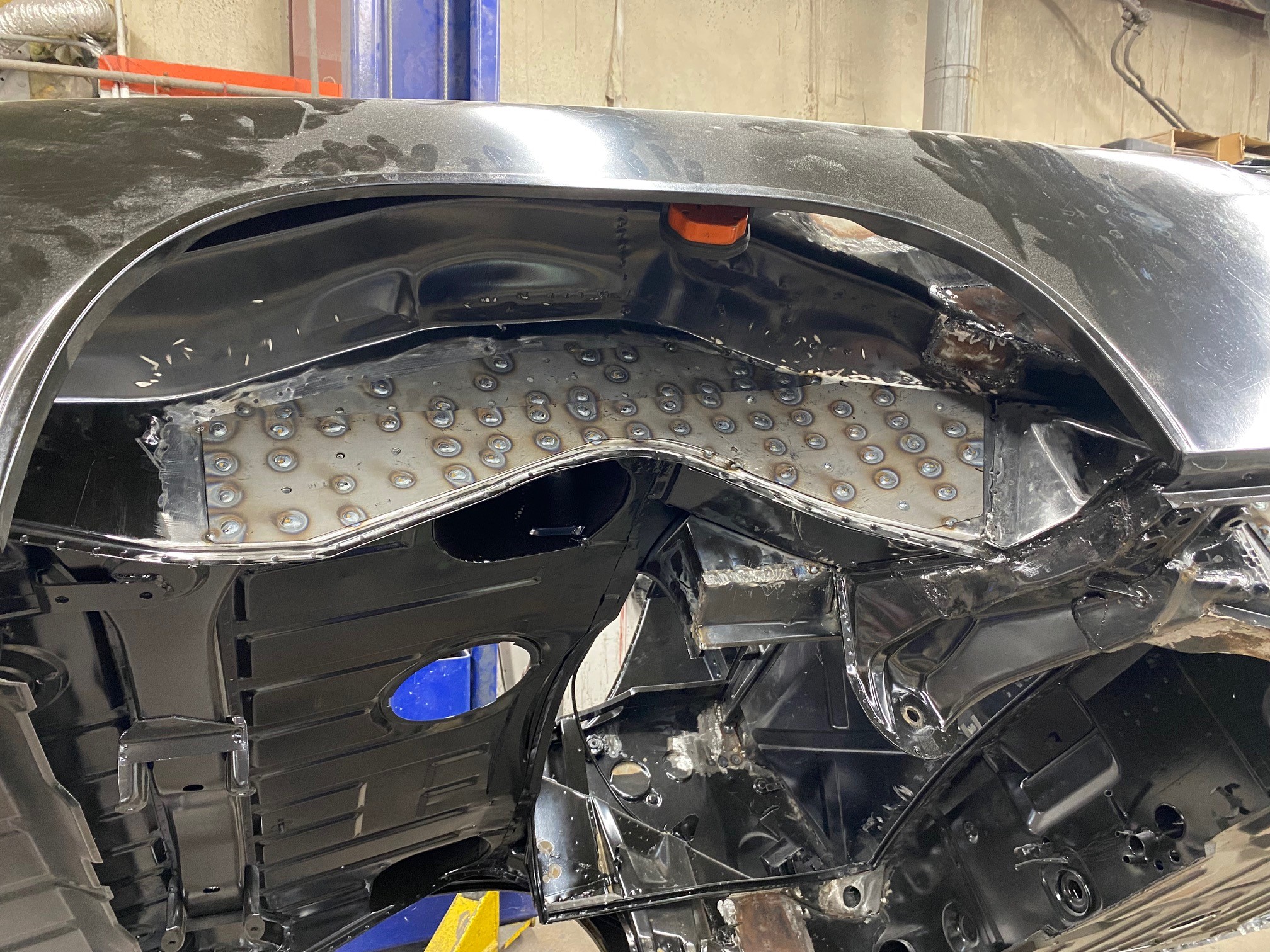

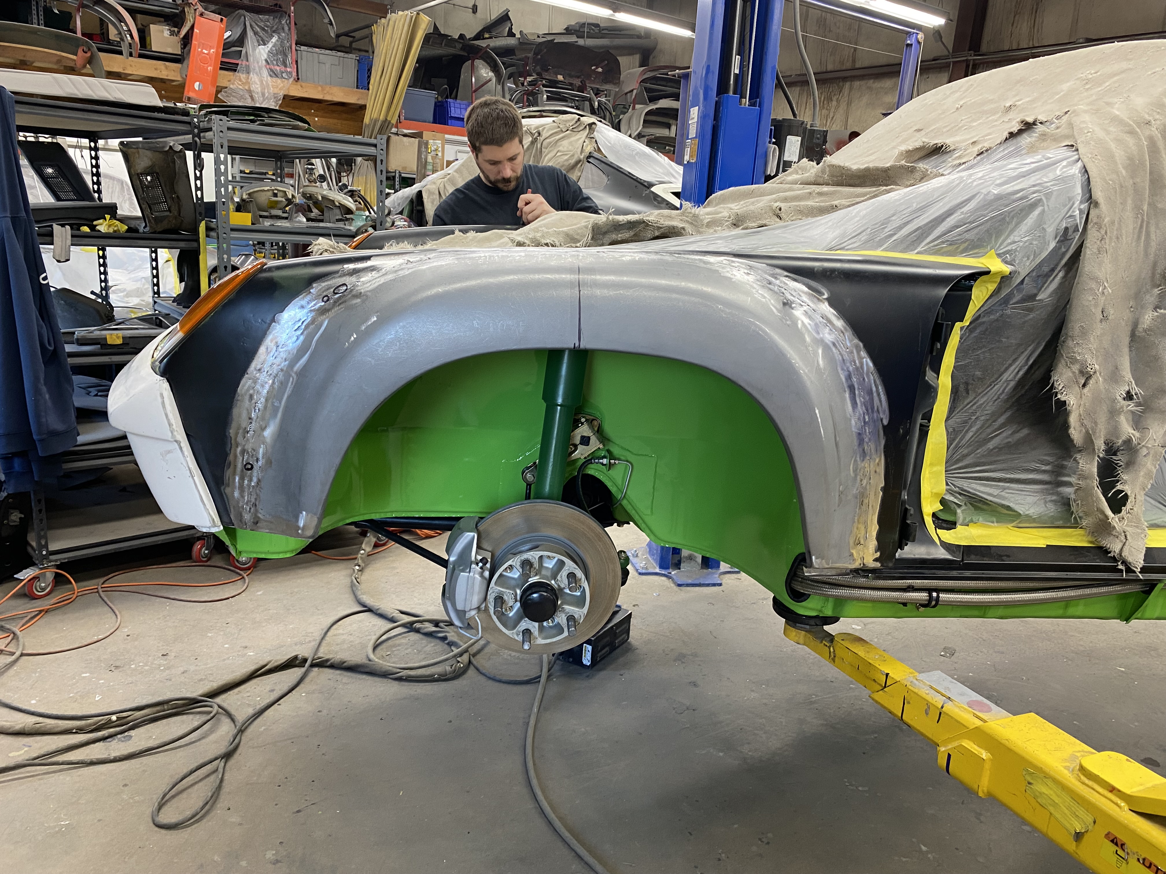

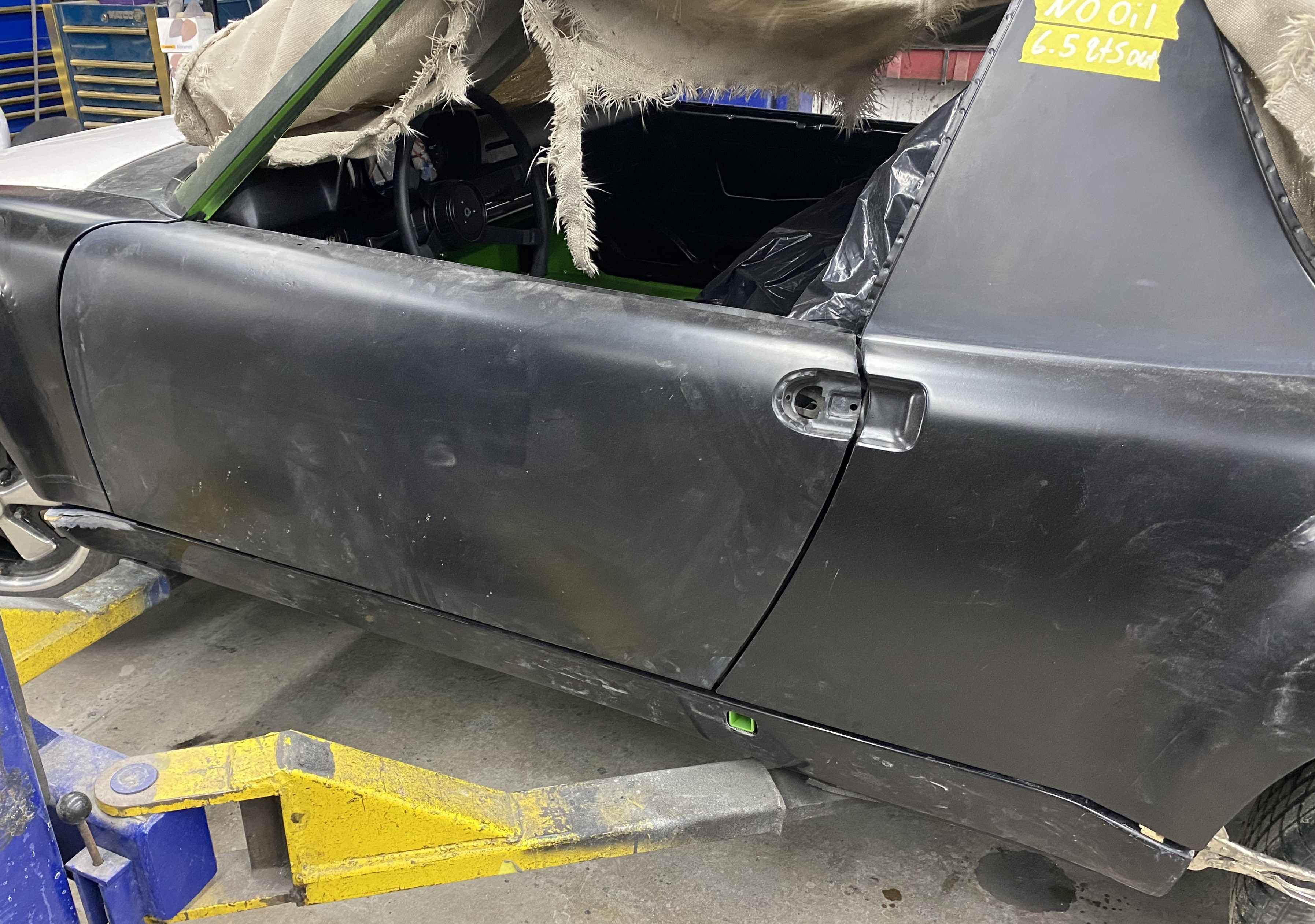

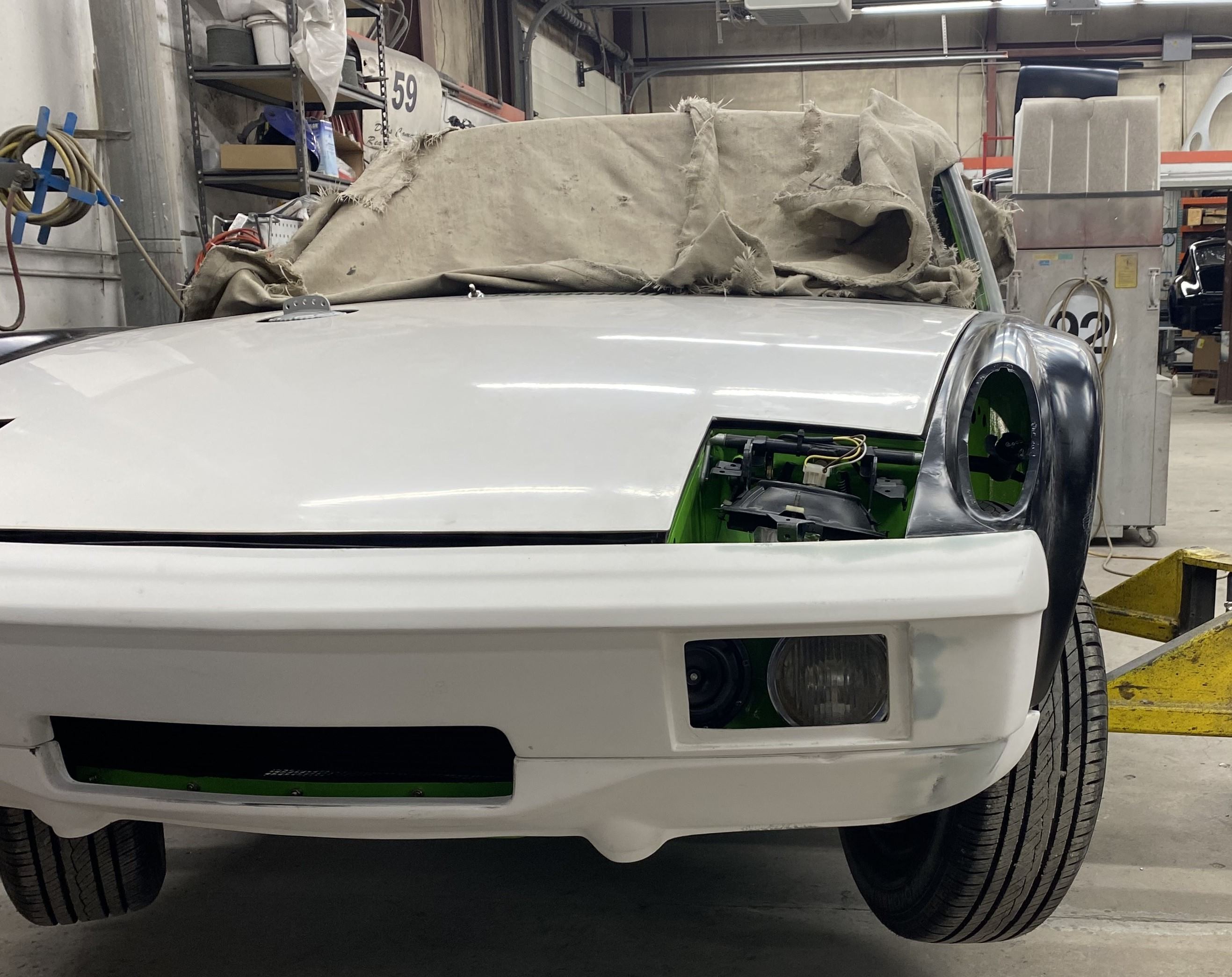

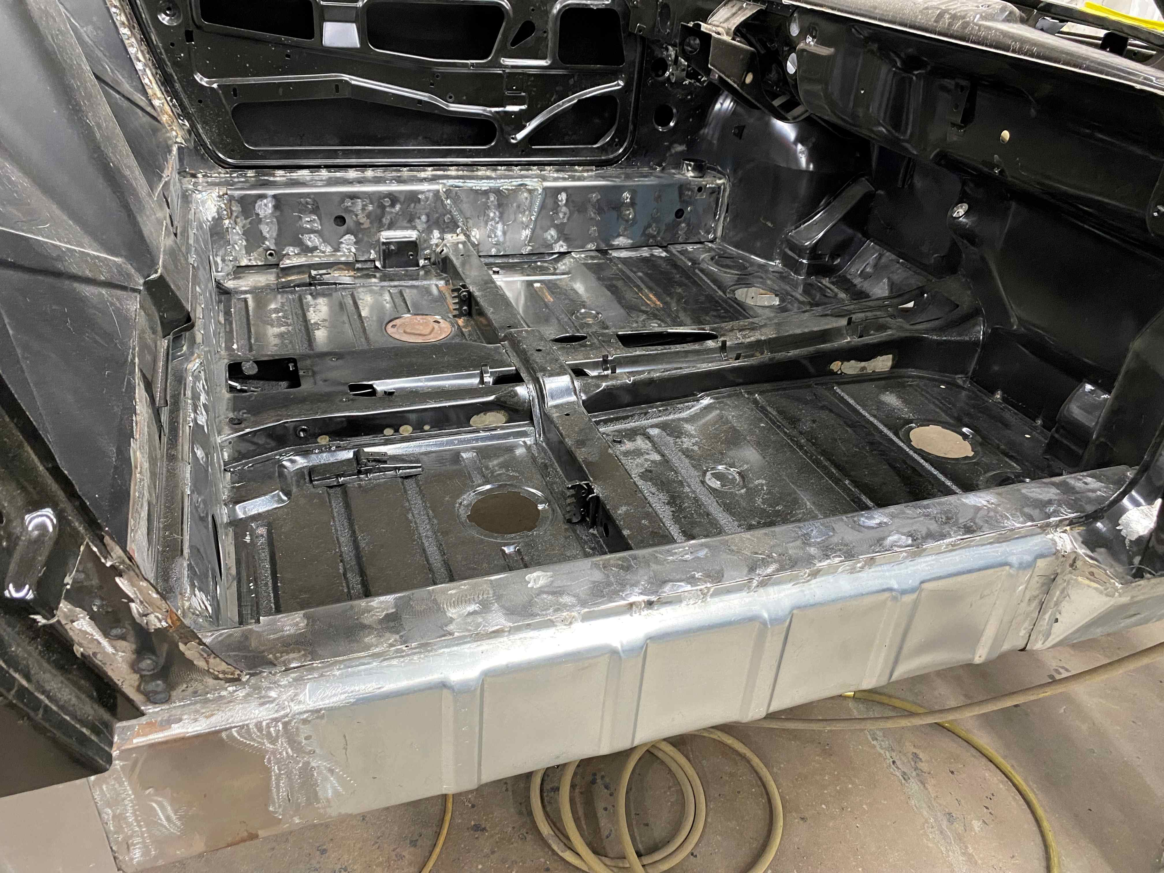

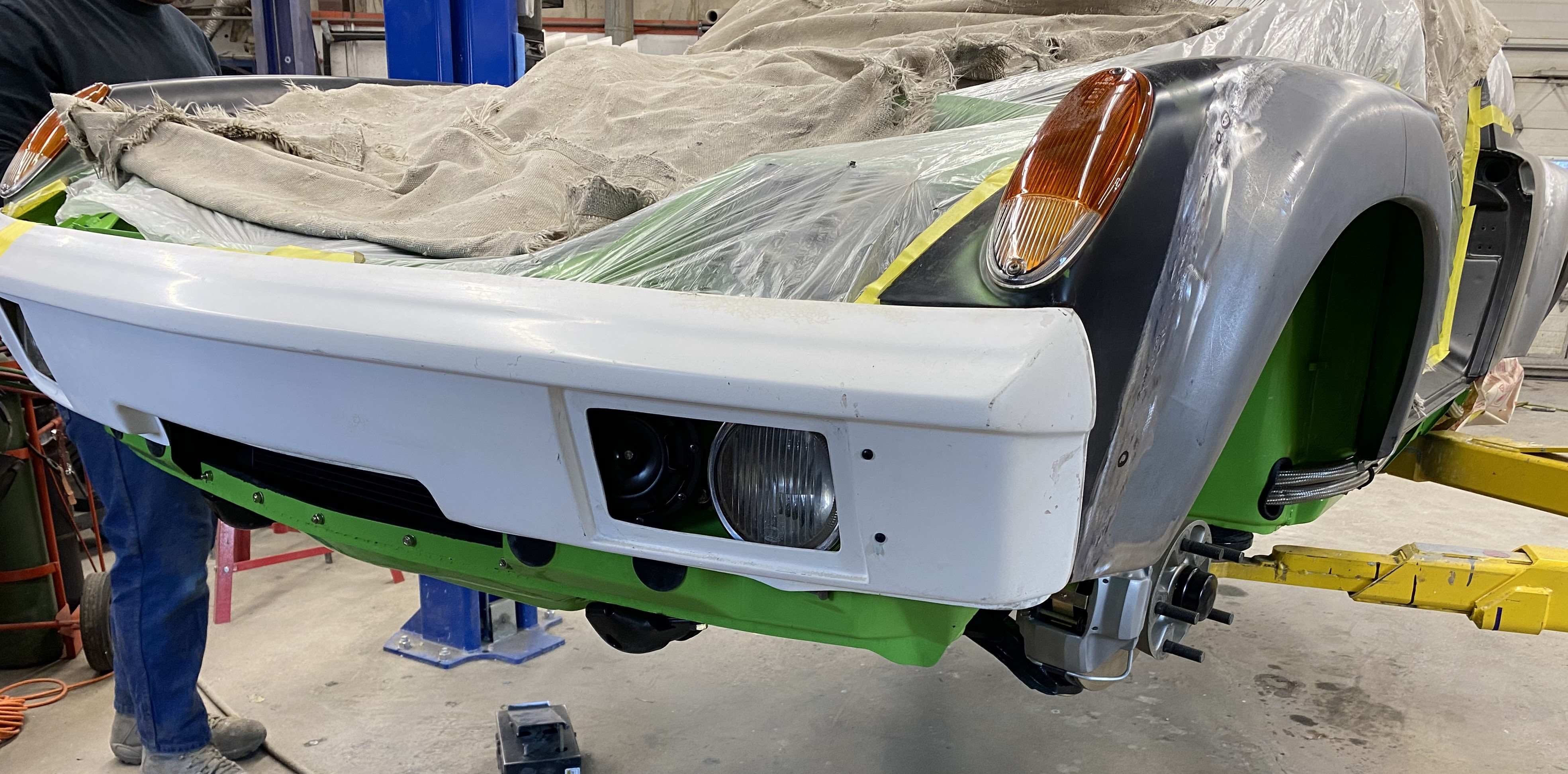

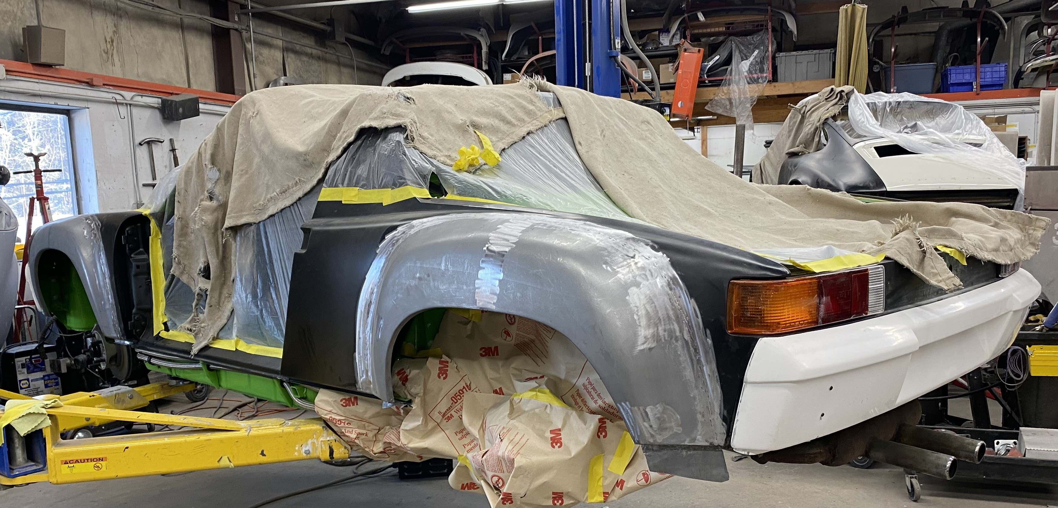

Tom1394racing   Update - The car was delivered to Auto Associates ...   Apr 18 2023, 12:54 PM

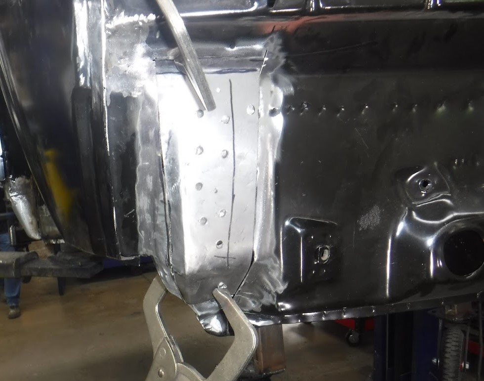

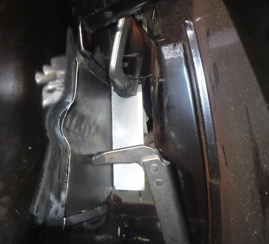

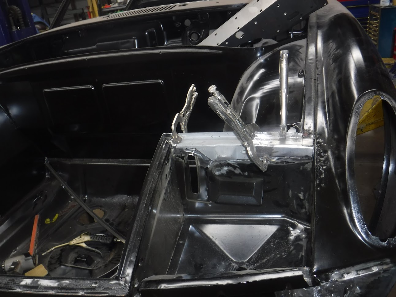

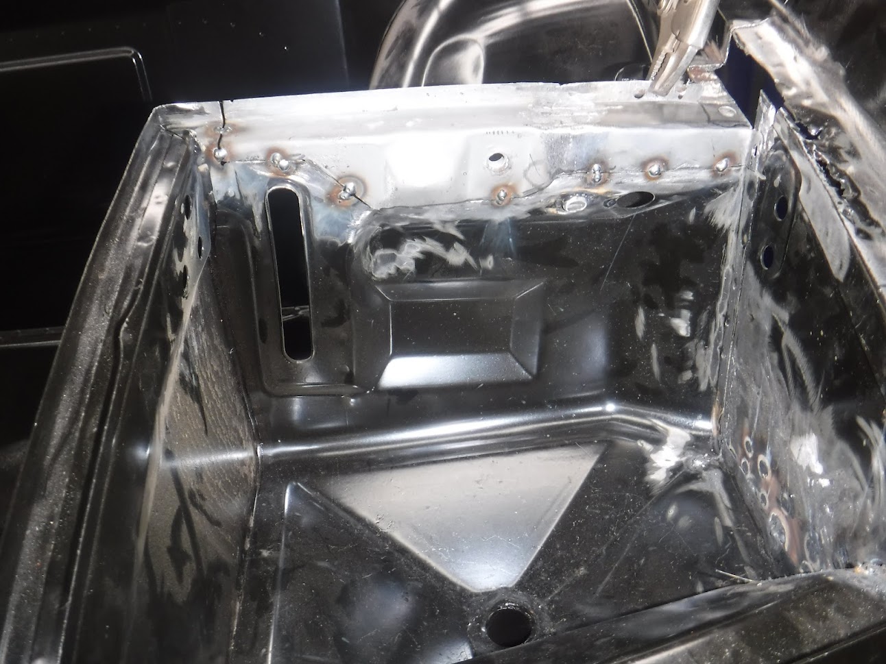

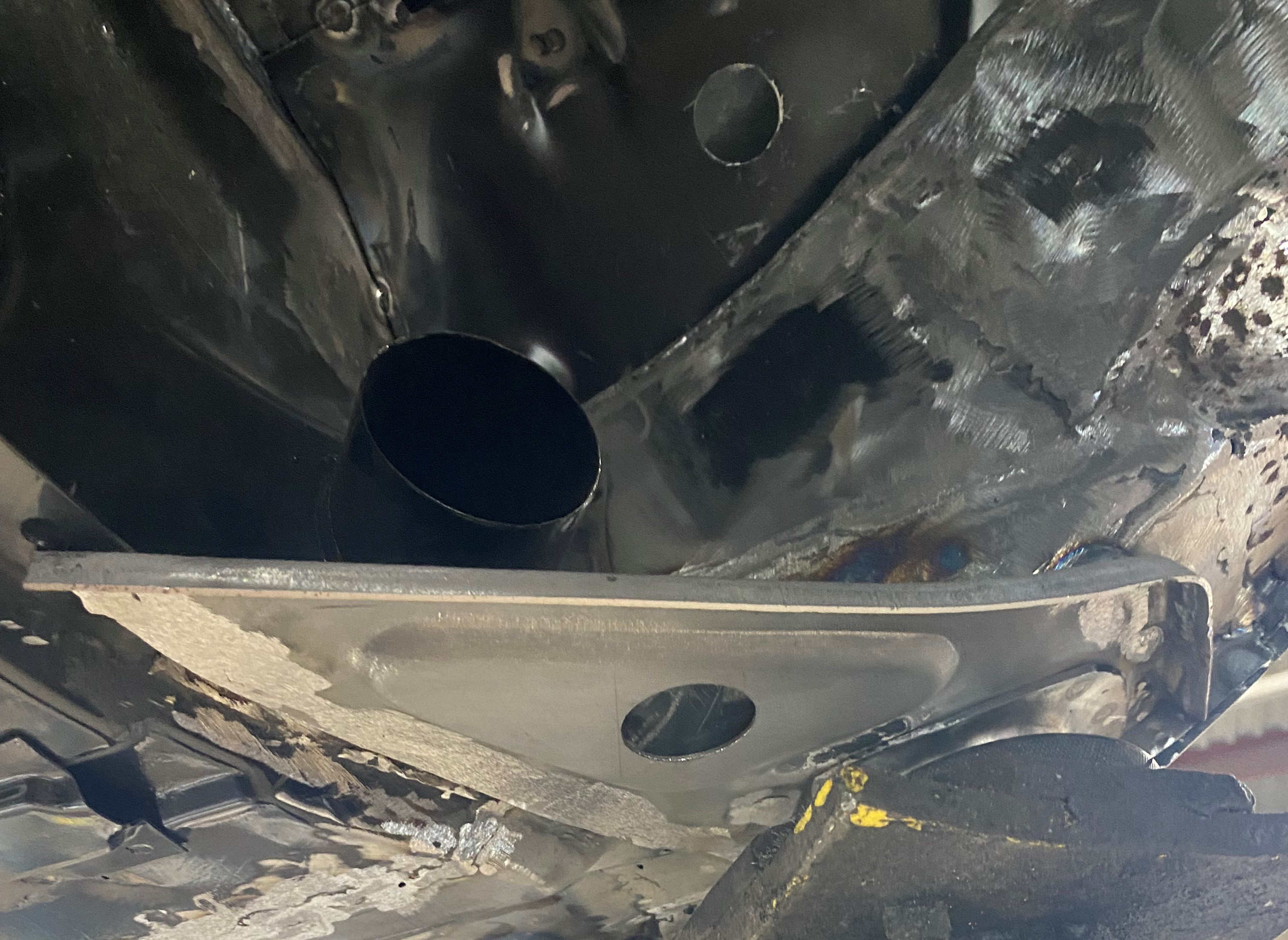

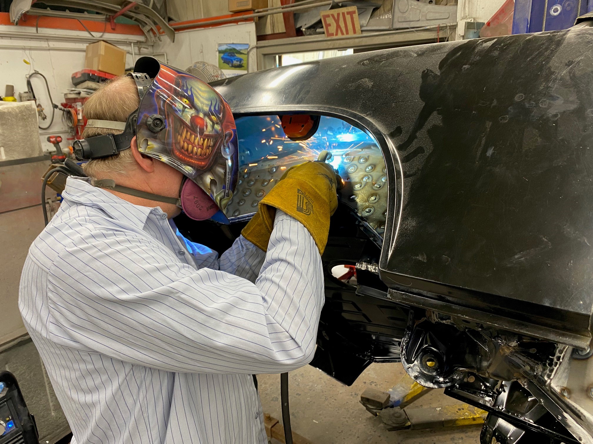

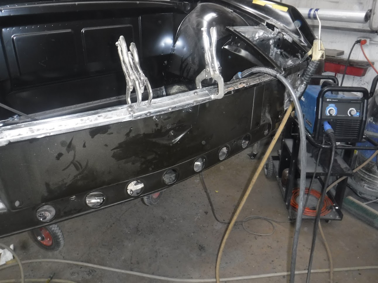

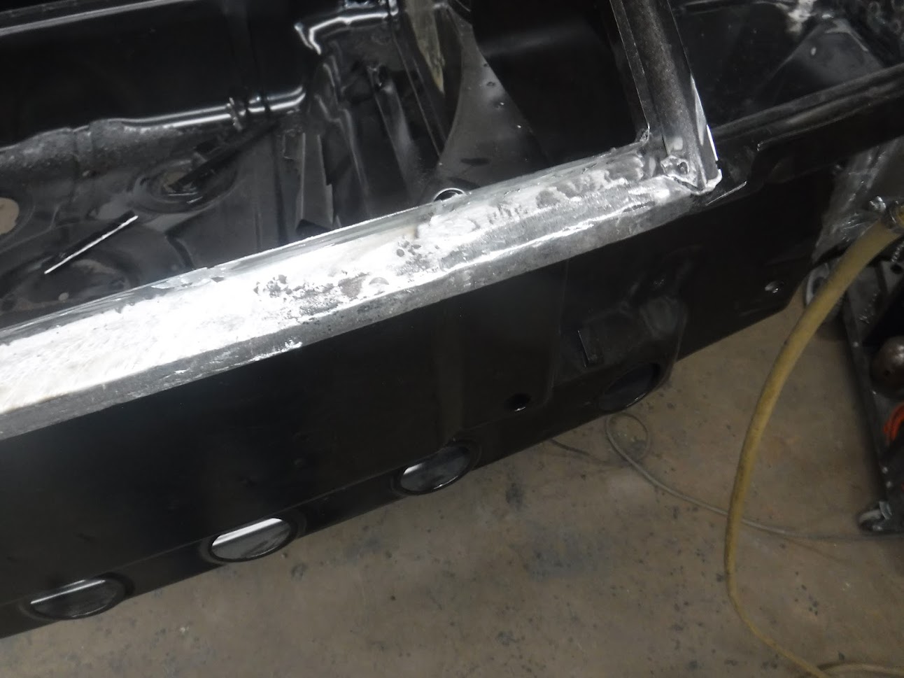

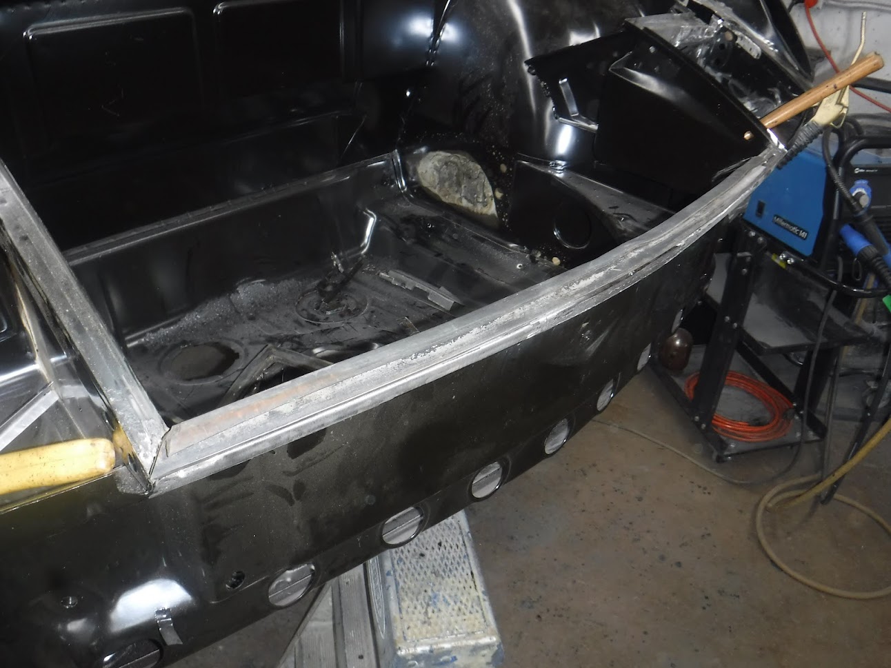

Tom1394racing   The rust repair has started with removal of the ru...   Apr 18 2023, 01:07 PM
