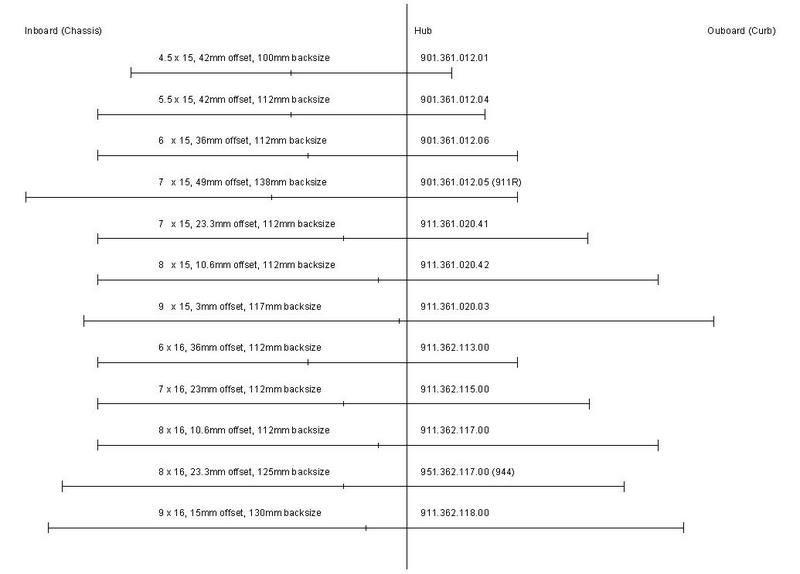

Depends on the offset, I have more clearance on the outside than the inside fender well. Spacers made it even better. But it still keeps a little spot polished.

offset and flair install ...Fuchs offset chart..

Is there a chart like that for a narrow body?

That is not a chart for the body, it’s for the wheel, Fuchs specifically. Measure distance from hub to inside fender, compare to chart by subtracting backspace from wheel width and that’ll give you an idea of how wide of Fuchs you can run.
There is much more to it, but it’s a starting point.

Is there an update to the chart that has the 951 7 x 16s on it? Or are they the same as the 911 7 x 16s?
