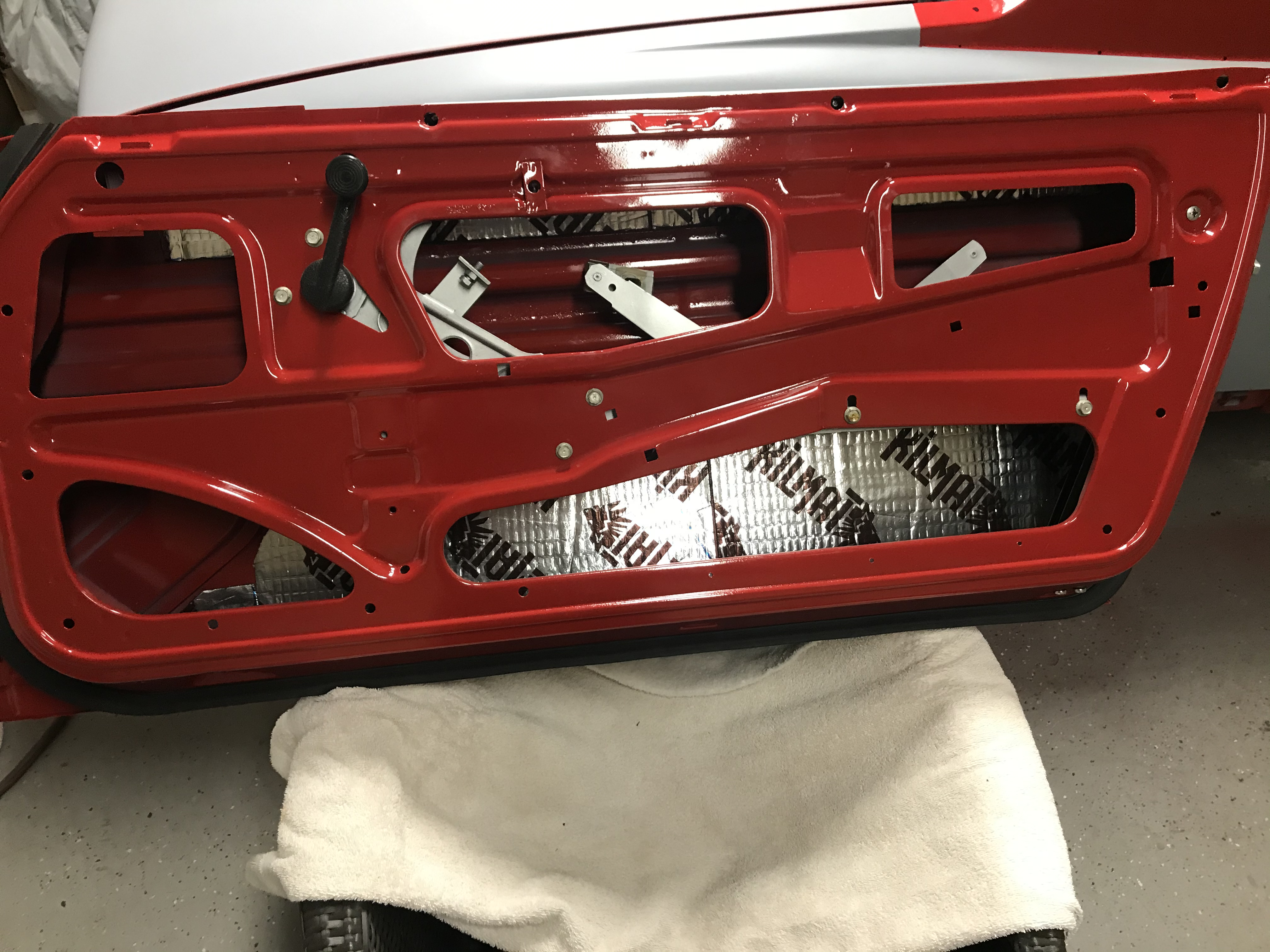

Senior Member ![]() ![]() ![]() Group: Members Posts: 944 Joined: 10-February 19 From: Austin, TX Member No.: 22,863 Region Association: Southwest Region ![]() ![]() |

I used noico it really makes a difference.
