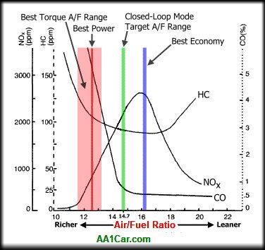

QUOTE(wonkipop @ Apr 2 2022, 08:19 PM) *
@Brian Fuerbach
although that specific chart has the disclaimer "based on a specific fuel formula".
i'm guessing its pretty close for most petrol fuels?
Van B can do a bit more educatin'.
brian are you asking is what is the oxygen line left of the stoichiometric value?
here is where i get corrected by Van - hopefully.
after reading up on your tip on the clear as mud science of the probe/sensor.
when in rich territory the O2 sensor at that point is measuring unburned fuel?
not oxygen? its detecting the amount of unburned fuel via that electrical thing it does.
either side of the ideal point its flipping one way or the other?
there isn't an unburned fuel line on that graph.
but there was in my emission tests in 1990. hydrocarbons at ppm.
But there is unburnt fuel on that graph. That’s what each of those gases are, combustion byproducts from burning hydrocarbons in air. I have no understanding of the chemistry, but I can see that stoichiometric combustion maximizes CO2 and minimizes other gases.
So, when you’re rich, there’s not enough air to burn all the added fuel. What results is incomplete combustion and a not so hot flame. When you’re lean, there’s not enough fuel to consume all the air. What results there is most likely detonation. That’s why O2 climbs in both Directions away from stoichiometric.
Fuel air mix is kinda like setting an oxy-acetylene torch. But with one massive difference, a moving engine. Compression and the act of compression heats the fuel air mixture, and the faster the piston moves, the more aggressively it’s heated. So, the spark can ignite the mixture sooner… further and further before TDC aka maximum compression.
The case I’m making here is that when you ignite the mix matters just as much as the mix you ignite.
Brian says he has an 11.7 AFR at idle, which is decently rich. But can you see how much more rich your AFR would read if you advanced the spark timing even further?
Now that I know what his AFR at idle, I think the AFM needs to be leaned out AND the spark advance curve corrected. Just some regular tuning… but I still think Brian should start with getting the aftermarket distributor to work like OE as much as possible for all round performance and drivability.

Brian Fuerbach
post Apr 3 2022, 12:12 AM
Post #105
Posts: 119
Joined: 1-July 19
From: Orange, Ca
Member No.: 23,266
QUOTE(Van B @ Apr 2 2022, 07:00 PM) *
@Brian Fuerbach
Let me clarify, my engine does not idle at 11.7 I was asking if the 11.7 on the chart correlated with afr on my gauge readings. My engine idles at 13.5 but idles better when richer. Any leaner makes for a rough idle.
The curve I programmed into the 123 was a copy of the proper factory curve with advance but no retard.

yes. i am following all that ok. O2 and fuel get turned into something else.
and the better the combustion the less of that something else is CO and the more of it is CO2. and we approach using all the fuel up and all the O2 up in perfect scenario. and i am staying on the left side of the graph because its the right side i stumble over.
yes fuel and oxygen are like a cross X. where the intersection is the stoichometric point.
and all we can measure after combustion is the upper right of the X for oxygen.
Yes. (why timing is a curve, not linear?).
Yes
i'm stumbling on this bit and need further explanation.
for educational purposes. (IMG:style_emoticons/default/beerchug.gif)
digesting.

i know that chart co-relation i did was a bit rough.
because i just equated CO levels to what i had measured back in 90.
i was just fooling around.
but i was in about the same vicinity as you at idle?
if i used CO2 on the same chart (easy to get off my emission test back then - just subtract CO from the CO + CO2 percentages) it doesn't co-relate to the same AFR i get off the chart as the CO. its a little different. but it is still in that vicinity.
by 11.7 do you mean the 11.17 i quoted from my emission test of 1990for idle CO + CO2? in which case I can find both curves or lines. i have the CO - which was 1.88% (gee i was .12% under the factory manual, not good) and i had the CO +C02% as 11.17%, so i could derive a CO2 % if i wanted to of 11,17 - 1.88 = 9.29%. and then i could go on to Van's graph and look at 9.29% CO2 line and see where that landed me on AFR. which would be 12.0 and under. 11.7? thats richish. thats what i mean. but i'm not sure how you can go directly from those measures i had in 1990 to the graph that Van posted. thats for a certain type of fuel. i was just doing a ball park thing.
they did apparently set them up a little richer as air cooled engines.
geez, i don't know if i want to go into this O2 territory with mine and probes!
but i am counting on Van to make the mud settle to the bottom of the pond for me.
(IMG:style_emoticons/default/beerchug.gif) .....i am an old bastard. trying to keep up. waste of time?
i'll leave Van to comment on not incorporating retard.

Brian, good to know. To be clear, I don’t have high confidence on how great AFRs would be on a prolonged decel. My interest in this topic is because as a mediocre superbike racer many years ago, I learned the value of a good off-on throttle transition.
What we would tune for was a little richer on decel for added cylinder cooling, but not so much that it would load up/bog at the first touch of the throttle. You also didn’t want it so lean that temps were high and you would get that detonation pop as soon as you dumped more fuel and air in.
I’m getting off topic here, it what I’m driving at is, without knowing what other L-Jets work like or what the factory intended, I can only assume that the engine should run mildly rich on a closed throttle decel.
And, I’m not sure if retarding the timing on closed throttle will get you all the way there, but it will get you closer.
@wonkipop for your educational purposes question. Retarding the timing means the spark is delivered closer to TDC, but always before TDC. To paint two ends of the spectrum, if your engine is running 5000RPM at WOT, you are sucking in all the air possible, the fuel injectors are working at full steam to add a matching amount of fuel, and the pistons are smashing that mixture into a hot cylinder as aggressively as it can. In this scenario you need to advance the spark considerably so that you can ignite the mix at the right time to get a smooth even combustion burn.
Conversely, if you are closed throttle at 5000RPM, there is very little air coming in, and accordingly, much less fuel. So, there is less to compress, which means less heating of the fuel air mix from compression. But there is still a very high piston speed to account for. So, you ignite that closed throttle mix sooner than at idle but not as soon as you would a WOT mix of the same RPM.

QUOTE(Van B @ Apr 3 2022, 08:09 AM) *
ok, now i see what you are driving at. i was down there at idle. but now i am up with you at high speed back off, but a f r is down at idle level. got you.
and of course that is what our standard distributors do.
immediately offer that retarding of the pure mechanical position.
to an ideal spot for that.
so i was understanding you. i was just somehow stuck on your advancing at idle analogy. but i get it now what you were saying.
have you ever been able to determine what the vac retard amount is in the literature.
it would be maximum retard at higher revs back off too in mine. no decel valve.
different with the decel valve as its breaking the vacuum and reducing it.
assuming that is at idle that the vac level isn't enough to fully move the retard position and only goes a part of the way of its travel.

QUOTE(emerygt350 @ Apr 2 2022, 07:54 PM) *
I am not entirely sure the retard was just for emissions. I suspect it was also for a nice idle. It basically creates a second curve for the distributor. You can start the car nice and easy with no throttle input and as soon as you start to accelerate the timing jumps to a point where your idle would have been obnoxiously high at closed throttle. Advanced ignition with extra air at start isn't the best start scenario. It works but it isn't exactly refined.
the easiest way to know that it is for emissions in L jet is the tune up procedure emery. time it with the hoses off the distributor and plugged. get it sweet.
then plug them back on. and do a final tweak of idle speed.
kind of tells you that you then turn yourself over to faith in the vac system of the distributor doing a distortion of that best state of tune according to its own devices.
with the pure intent of altering the NOX and HC popping out the tail pipe.
i can get it slowly bit by bit as i go along now after studying this graph.
part of what VW were doing was idle tuning/timing with the hoses off somewhere near where the NOX line and the CO line cross. the HC is also nearby as a minimumish level.
as to the precise chemistry of what then happens if you "artificially" shift that best state of tune with a vacuum induced retard i need to know more than perhaps i care to.
Van is more eloquent.
the result is even lower NOX than you would get at the tune with the hoses off and HC still gets burned, but less in combustion moment and remainder in the upper reaches of exhaust system and exhaust port of head. which is where the engine temp goes up. in those areas. hence the engine running hot at idle characteristic. the EPA was fixated on NOX to begin with. along with hydrocarbons.

i inspected our 80s vintage gizmo analyser, tuner with a screen etc the size of a doctor who dalek that sits in the corner.
the screen bit is kaput, needs some vintage expert to fix that bit up.
some kind of oscilliscipe sci fi thing.
but the exhaust gas analyzer bit still works.
does 4 types of gases and ingredients.
CO
CO2
HC
i think it does NOx, i think that is what mike said.
has no scope for oxygen because thats something you breathe?
and bosch were holding the patent for those probes close to their chest even in the 80s.
i'm going to fire it up on the next tune up.
going old school. i'm an old man so its legit.
be catching up on technology just using the machine?
i used to static time my square back with a light bulb. (quick duck a peradactyle is swooping us).
onward into the space age after its already gone.
