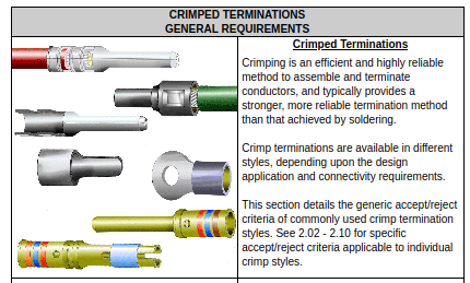

With respect to terminations, the data is very clear that for terminations (i.e. at terminals, ring connectors, pins, etc.) that a crimped connection is superior. This has been proven out in laboratory testing with cyclic fatigue on shaker tables. In the same manner here is NASA's own word on the robustness of crimped terminations.
https://workmanship.nasa.gov/lib/insp/2%20b...quirements.html
I do admit that I'm a bit black and white on this and prefer crimped connectors all around. This is based on years of experience seeing where and how often soldered connections (especially at terminations) failed in the field.
