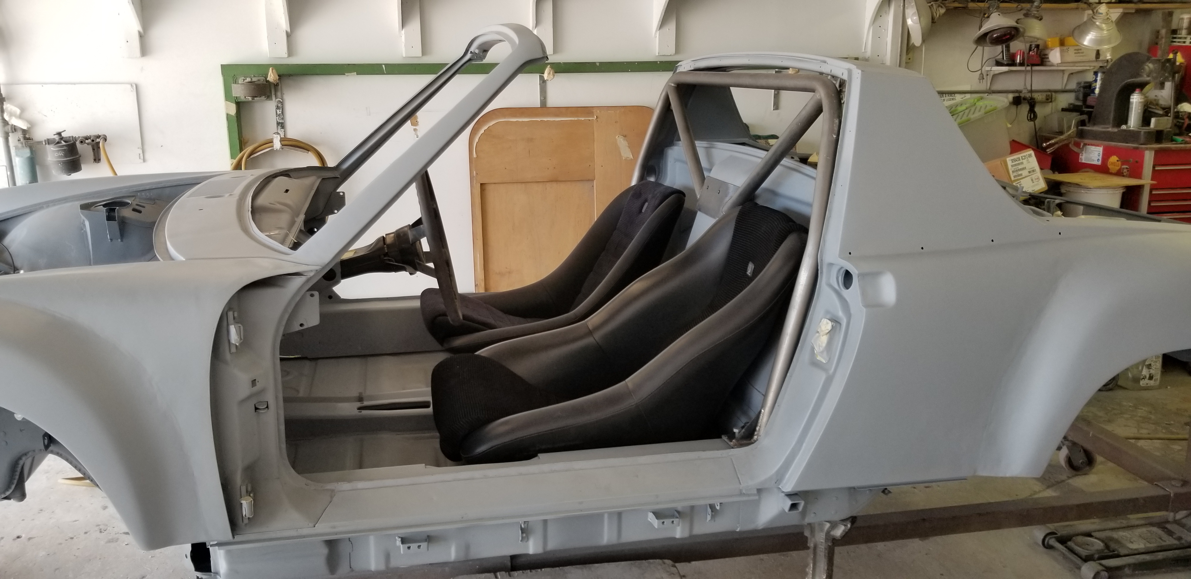

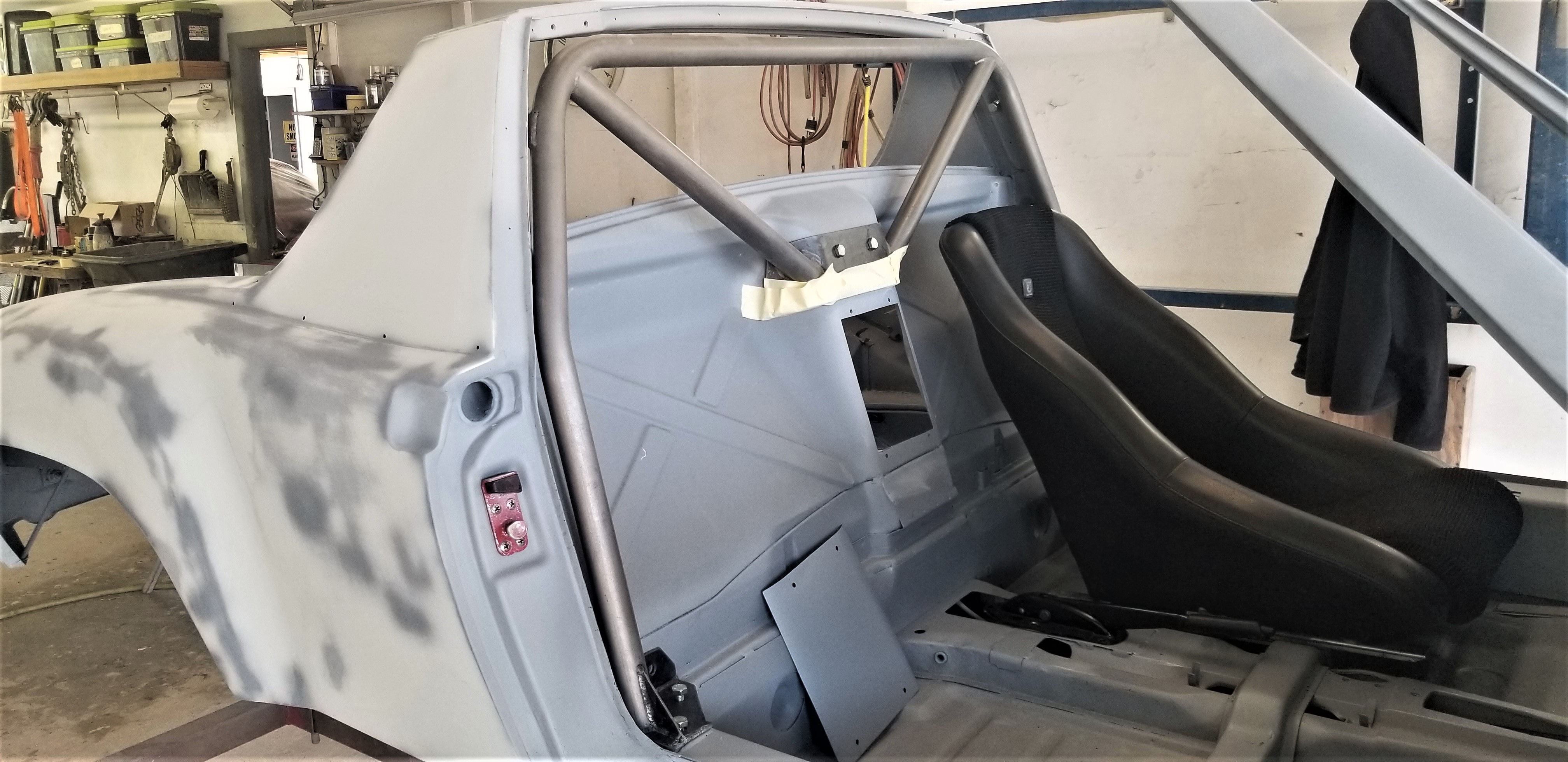

As of yesterday, determined seat locations with the bar installed. Some adjustments to do... also fitted the manual headlight kit from Mittlemotor. Cables are too short! Grrrr.

Your roll bar looks way too short - too close to the helmet in tech inspection.
See this: https://pbase.com/9146gt/image/113481744
This will still fit under the targa top

No worries. The bar is an exact reproduction of the factory piece fabricated by one of the best-known Porsche race car restorers in the world (who sold me the car in the first place).
I'm building an accurate replica, not a track car so we're not concerned with the current rule book. It will be a streetable GT for rallye use mainly.
Biggest difference from a period GT is the engine; I'm using a twin-plug 2.8 RS motor with Webers.

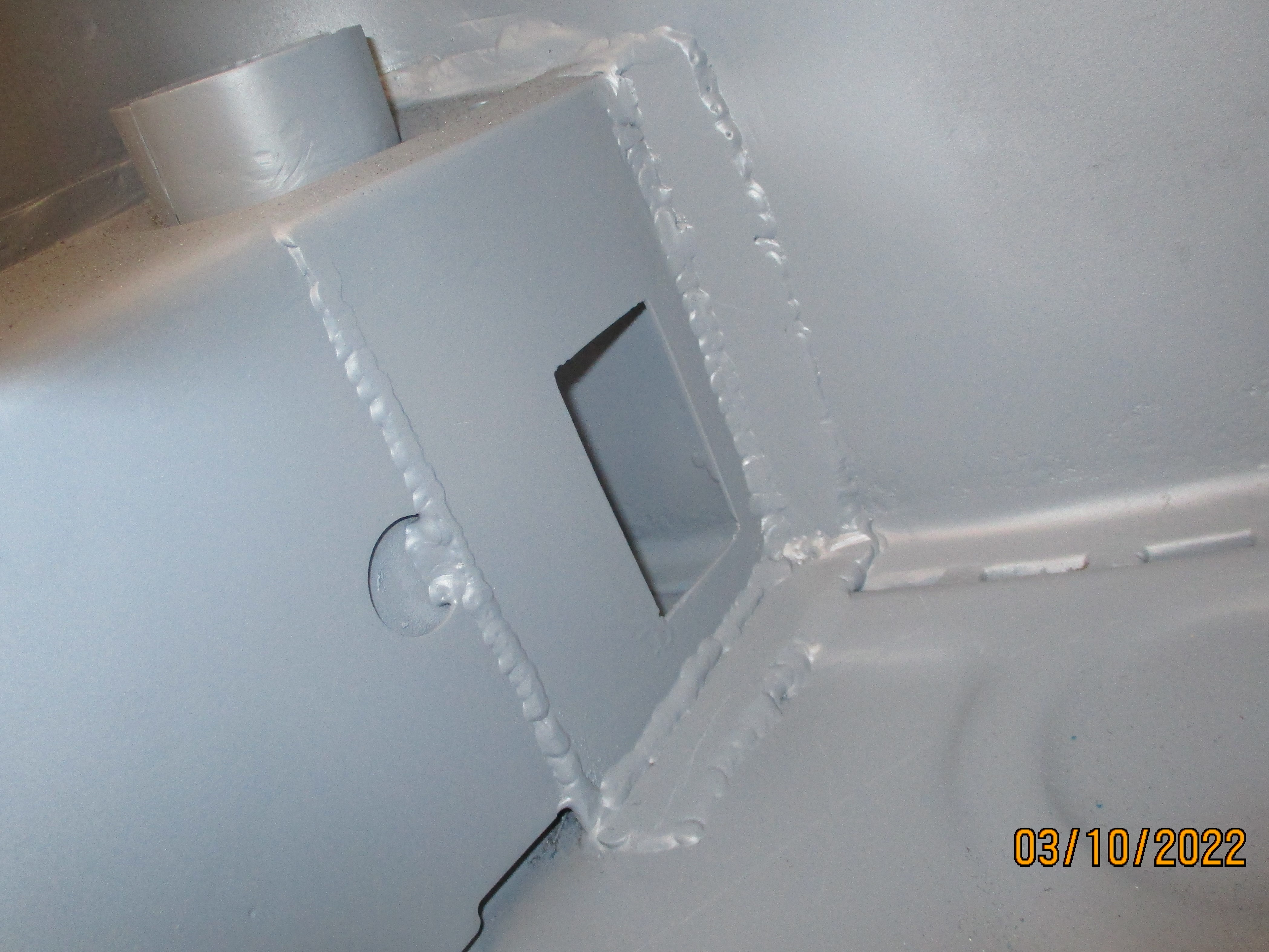

A few more detail shots of the oil line cockpit routing.

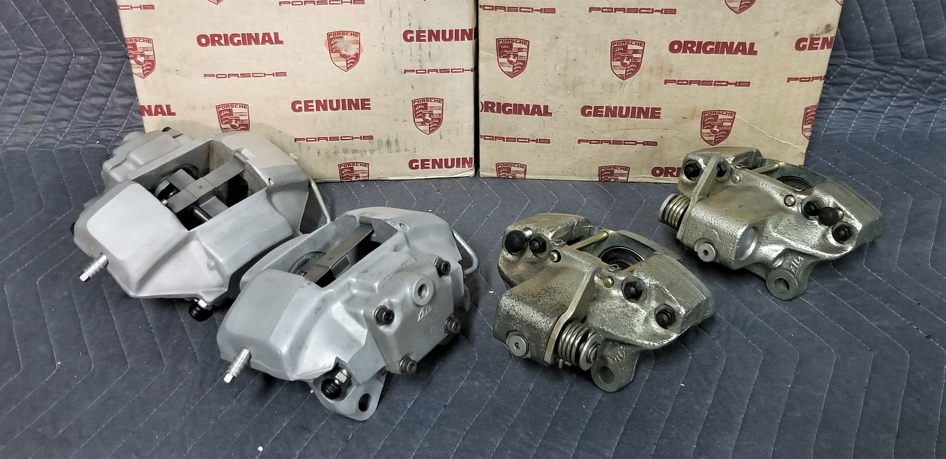

How about some brake porn? NOS vented GT rears plus calipers... lucky to get them and the 908s. Thanks Bernie!

OMG! (IMG:style_emoticons/default/smilie_pokal.gif)
Shivers

QUOTE(Bullethead @ Apr 4 2022, 01:48 PM) *
(IMG:style_emoticons/default/drooley.gif) Very nice.

908’s!!! LeMans here we come. Quick change time, That is sweet! (IMG:style_emoticons/default/beerchug.gif)
