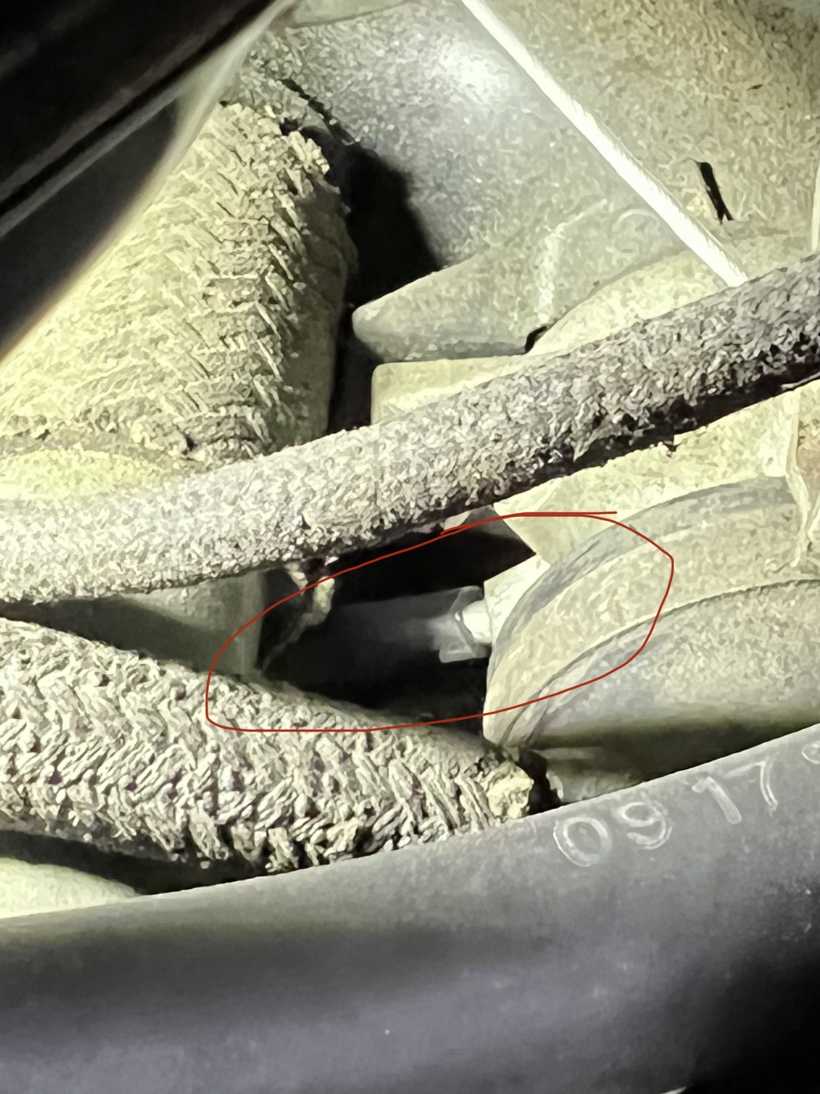

Hi wonkipop. My '74 2.0 with FI is having the same symptoms boxster914 and you have described. You're reminding me that I've observed very small bubbles in my fuel line. Here's what happened: I replaced the fuel filter which of course drained the line to the engine, so I wanted to purge the fuel line of trapped air. I separated the fuel line at the cold start valve and attached a clear tygon line which I put it into a clear jar, then bumped the fuel pump (by turning ignition on and off). I could see bubbles traveling through the tygon tubing, which I expected. Thing is, I repeatedly turned the fuel pump on and off and I continued to get very fine bubbles in the line.
I'm in California where the ambient temp is around 75. The car has a 2 port fuel pump installed below the fuel tank. The missing happens when the car is warming up so I don't think this is a fuel heating up issue. I'm wondering if I have some sort of leak in the fuel line, something that's letting air in but no fuel out as far as I can tell?
By the way, the tank is near full and I verified fuel pressure is correct and does not fluctuate when the missing occurs.

So I monitored the fuel pressure when the engine is running and the missing issue is happening. It's rock steady at 29 PSI. So doesn't that rule out the problem being related to a clogged fuel filter (which I replaced anyway) or crud in the fuel line/tank?

OK so I have some results to report on.
I changed the fuel filter.
After the filter change the car had 3 instances of minor bucking (much less than the original problem) early on in a 20 minute drive and then it ran fine for the rest of the time with no bucking.
Although after I got home there was some idling dropouts as captured on this video:
https://youtu.be/u-ttZXnvmOk
Notice the drop out at 0:02 and 0:10.
I figured the problem was not solved so I moved on to thinking it is caused by a vacuum leak.
I consulted the excellent vacuum hose diagram at bowlsby.net
https://bowlsby.net/914/Classic/zTN_FI_Hose....7L_1970-71.jpg
I changed the 4mm line (yellow in the diagram) after the fuel filter change and took the car out for a 10 minite run and there was no bucking at all.
Here is a picture of the new line:
At the throttle body
At the vacuum can
I welcome your feedback.
What is the function of the 4mm vacuum line that I changed? I don't know what it does. Could this have been the problem?
Thank you for all of your help.

if its anything like a L jet, its the vac retard line from the distributor to the throttle body.
not sure exactly how they work with D Jet but know in L jet its to retard the ignition at idle mostly. it retards timing when there is engine vac, in L jet its on the manifold plenum side of the throttle body so its functioning when the throttle plate is closed at idle. mostly there to assist with emissions on L jet.
D jet guys would be able to tell you exactly how it works on your car.
but aside from it possibly affecting the retard which i don't think is significant in terms of sitting there idling it would have been an air leak into the system.
combine that with your fuel pressure or fuel restriction problem and your mixture leaned right out. why it wouldn't idle, hard to start and was bucking.
you have probably been driving around the minor air leak (and it does look minor) for a while and not even noticing it. i think your main problem might have been fuel restriction. the air leak would have exaggerated it, perhaps not a lot.
good work solving it.
EDIT
ps
when i think about things back two years ago the problem i had was very similar.
even though i have L jet.
a combo of fuel and air leak.
i found the air leak first. it was the throttle body gasket had done hard.
as soon as the engine really warmed up thermal expansion difference between the throttle body and the plenum caused the leak. it wasn't much of a leak i thought but it was around probably 1./2 the perimeter of the throttle body. new throttle body gasket and the problem seemed to go away. a bit like yours subsided after the filter change. ....that was until i ran the gas down to a 1/4 of a tank.
see my posts earlier in this thread. i am glad your fuel problem was a little easier to solve. my own fault for "butchering" the car to convert it to rhd 30 years ago. (IMG:style_emoticons/default/smile.gif)
