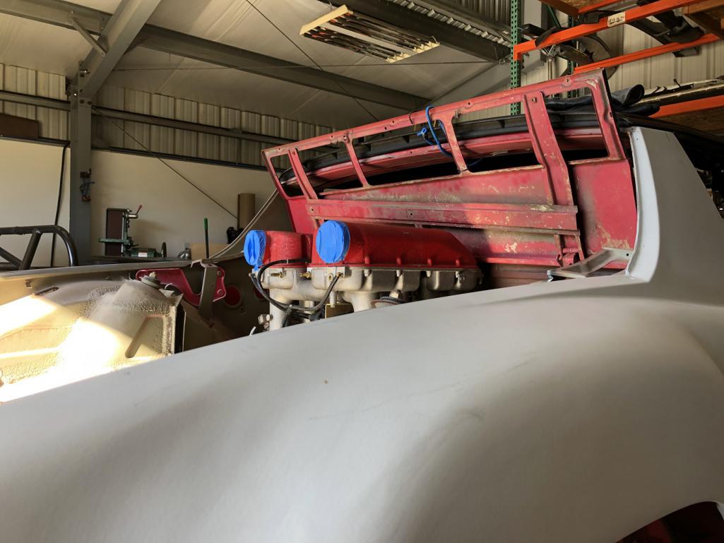

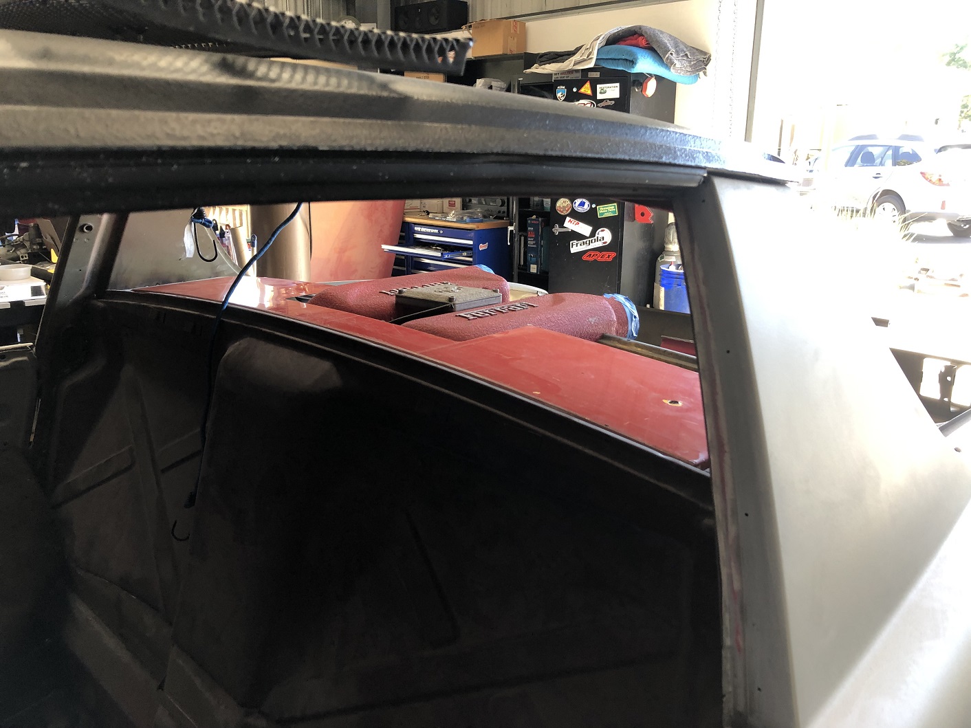

Quick poll: Yikes! or Oh, YEAH!
Just look where that plenum is going to be!
I'm voting "Oh, Yeah!
I have an old engine lid I'm going to cut it so we'll know exactly what this thing will look like.

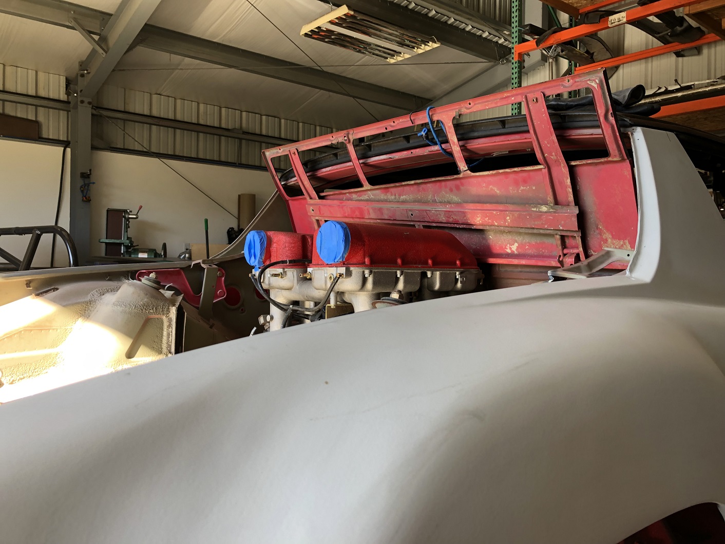

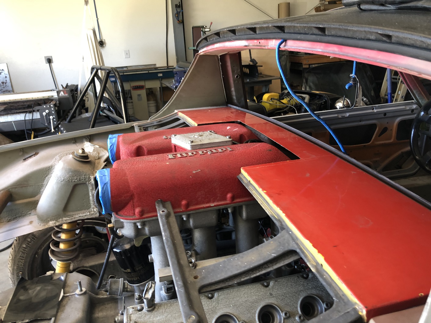

And before you get all excited and think you've done all the needed clearancing...
As Max said: "Missed it by THAT much!"

What's the angle on the drive shafts? I'd rather reshape the firewall a bit to make the front covers fit than moving everything even further back.
The less angle on a drive shaft, the better.

@SirAndy The angle is WAY better than on my LS car. Nothing is finalized and forward is better for fitment of that trans mount, too. Still work to do, for sure.

Cut engine lid would look pretty rad. That idea gives me another. Have you settled on a name for the project? If not, might I suggest Roter Kopf as an homage to another car sharing similar attributes? I think it translates right, but @SirAndy may have a better translation on that one.

Thanks to Robert @buddyv , I had this spare engine lid. A bit of measuring and cutting and... BAM! There it is! Not even going to obstruct rearward vision! As expected, the trunk is going to need some surgery but that'll wait until the rest of the intake is worked out.
But holy jeebus, this thing is going to be so cool. (IMG:style_emoticons/default/drooley.gif)
If you voted "Yikes" earlier, well, I'm sorry. You're wrong! (IMG:style_emoticons/default/happy11.gif) (IMG:style_emoticons/default/poke.gif) (IMG:style_emoticons/default/laugh.gif)

Oh God that is going to look good with the engine peaking out like that (IMG:style_emoticons/default/wub.gif)

You know that cutting the lid doesn’t exactly solve the problem. In the same way that you cannot quite look past that cool supercharger up front in the hot rods. Which you need to add. Couldn’t be in better hands. Rock on.

Gotta say…as much as I loved the idea of lowering the plenum to make this a sleeper, this is gonna look great—and people are going to trip out.
"Yeah but the engine in those—hey, waitaminute…what?!"
I've been a longtime fan of engine swaps, but this one may just take the cake... (IMG:style_emoticons/default/wub.gif)

At this point I think I would seriously consider making the trunk lid shorter and engine lid longer.
For the inlets I'd make a slip fit down turn instead of cutting/welding the intake. It's going to be visible so make it pretty.
I'd also keep the factory oil/water cooler. They chose to do it that way for a reason plus it works fine.

^^ Interesting points.
But engine lid longer, with its seam moved further back, will violate a key 914 graphic established by the ends of its targa bar—as will, of course, a Ferrari engine…though that kinda gets a pass. (IMG:style_emoticons/default/biggrin.gif)
I wonder about some of Porsche's early attempts to make a single-piece, rear-engined decklid and engine cover for the 914…something Chris is certainly aware of. Then it's "just" one hole in the middle-ish for that red intake plenum. Just thinking out loud…

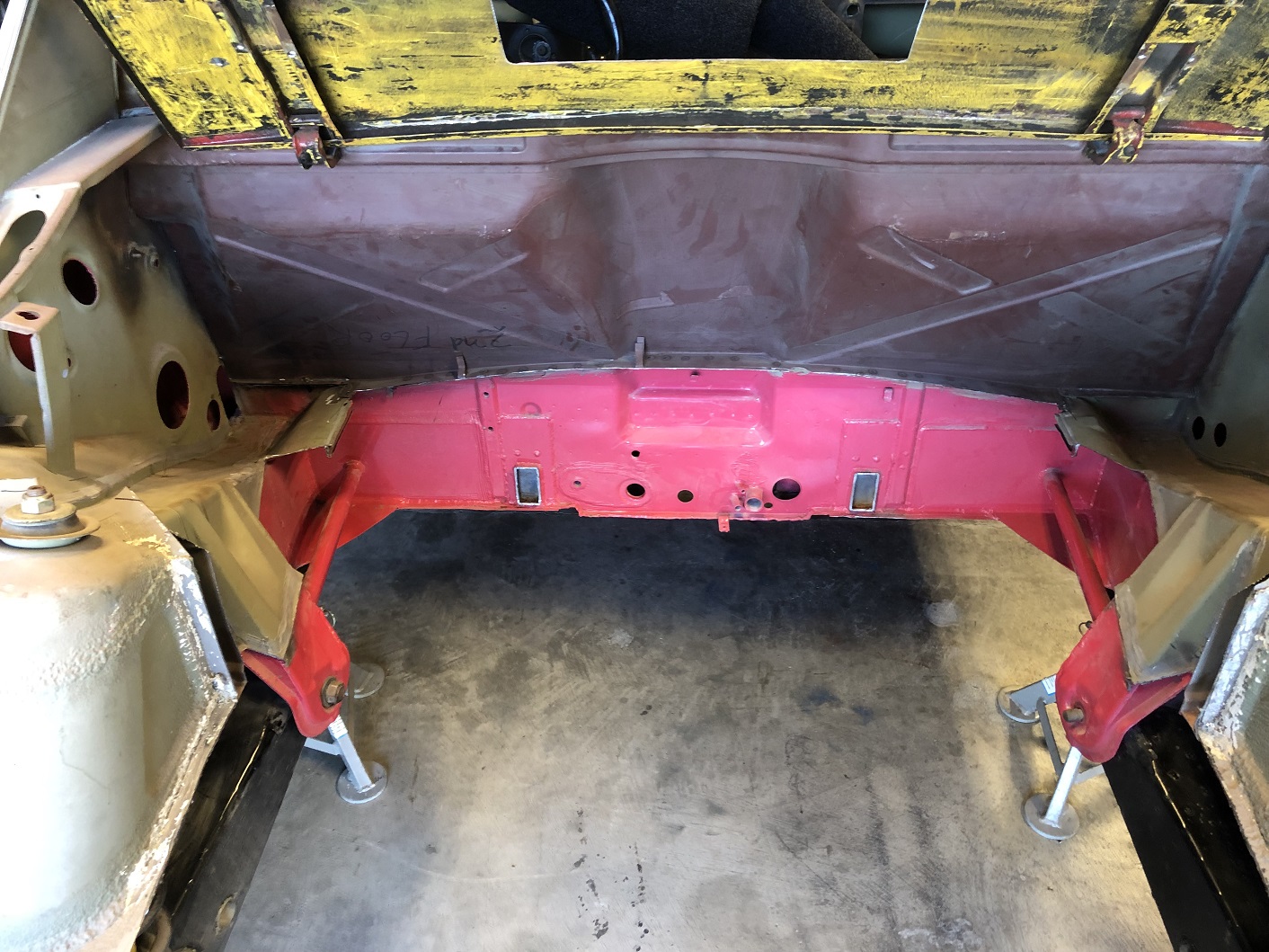

Anyway, once the always important social stuff wrapped up, I was able to do a rough cut of removing the engine tray tin and the /6 mounts - and remember, those mounts interferred with things like the alternator so they simply weren't going to work. Removal of all this allows me to get a complete understanding of the room I have for things like exhaust and what I'm thinking will be a cradle-style engine/trans mount. Just a bit more clearancing and I'll be able to start in on fabbing the mounts!

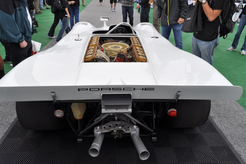

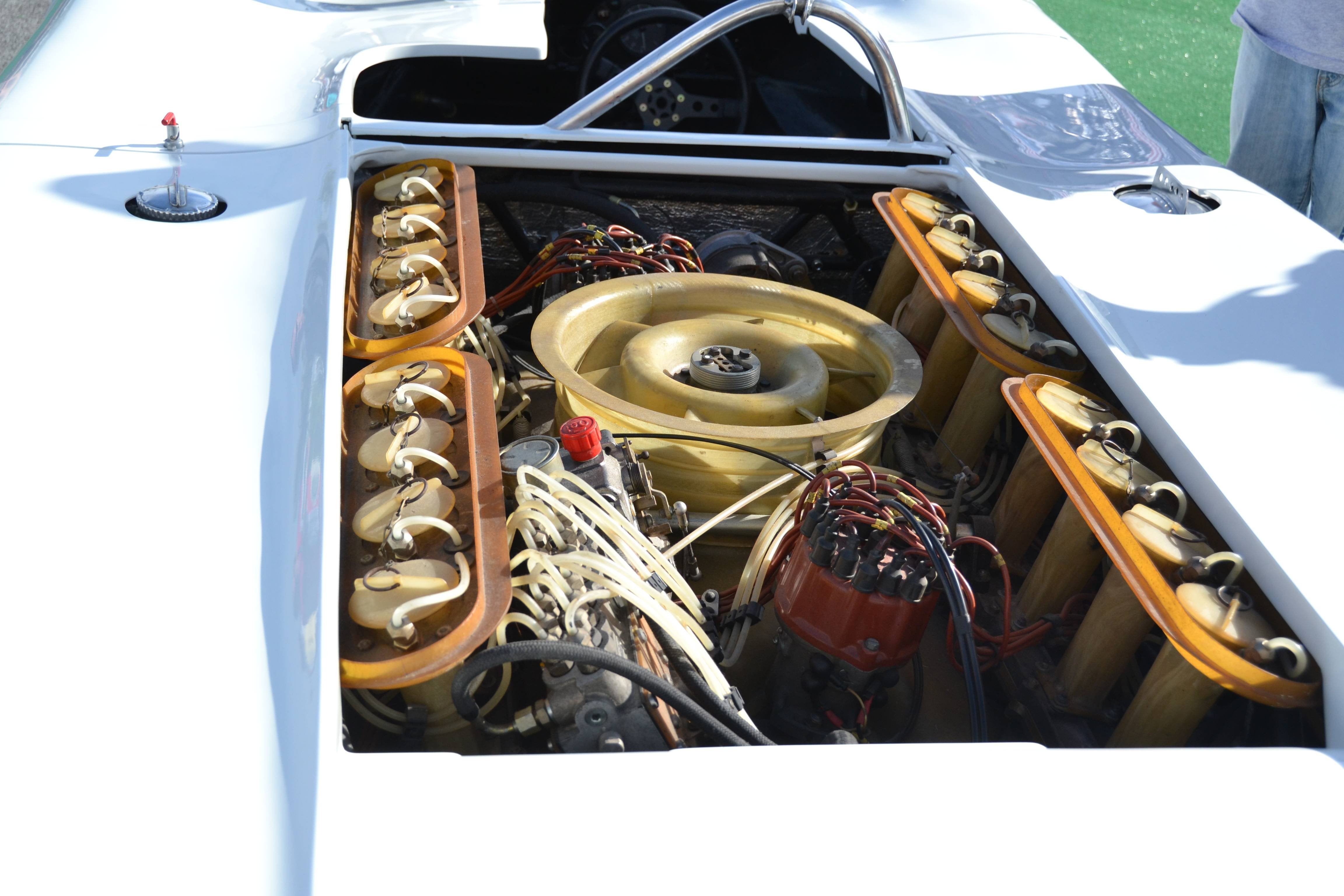

That induction system peeking out of the bodywork reminds me of the 917.
