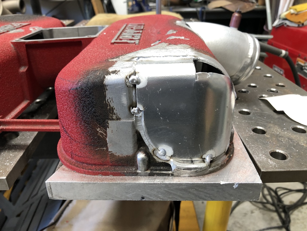

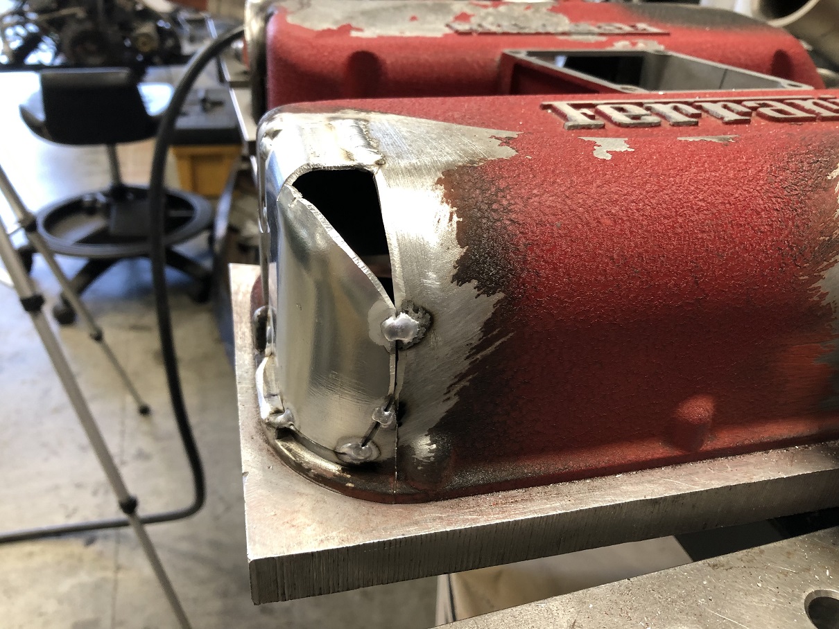

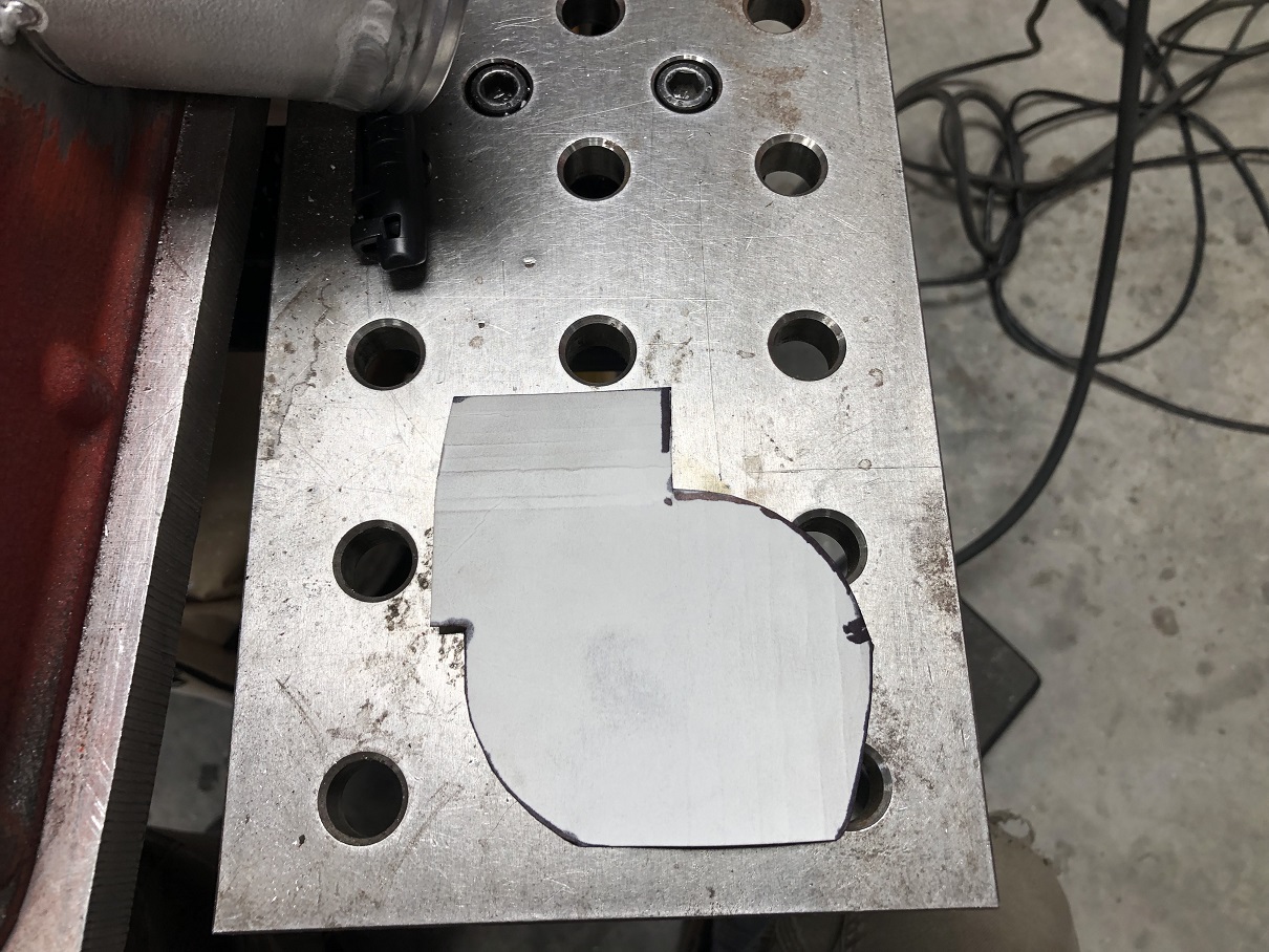

Martin and I spent the afternoon working on closing the original TB openings. I cut the plenum to the desired shape, Martin worked up the paper template and cut the aluminum blank then we took turns working it into shape. Martin's aluminum welding is far better than mine so I happily videoed while he worked his magic. Super happy with how it's coming along.
One tricky piece left to do then repeat on the other side.

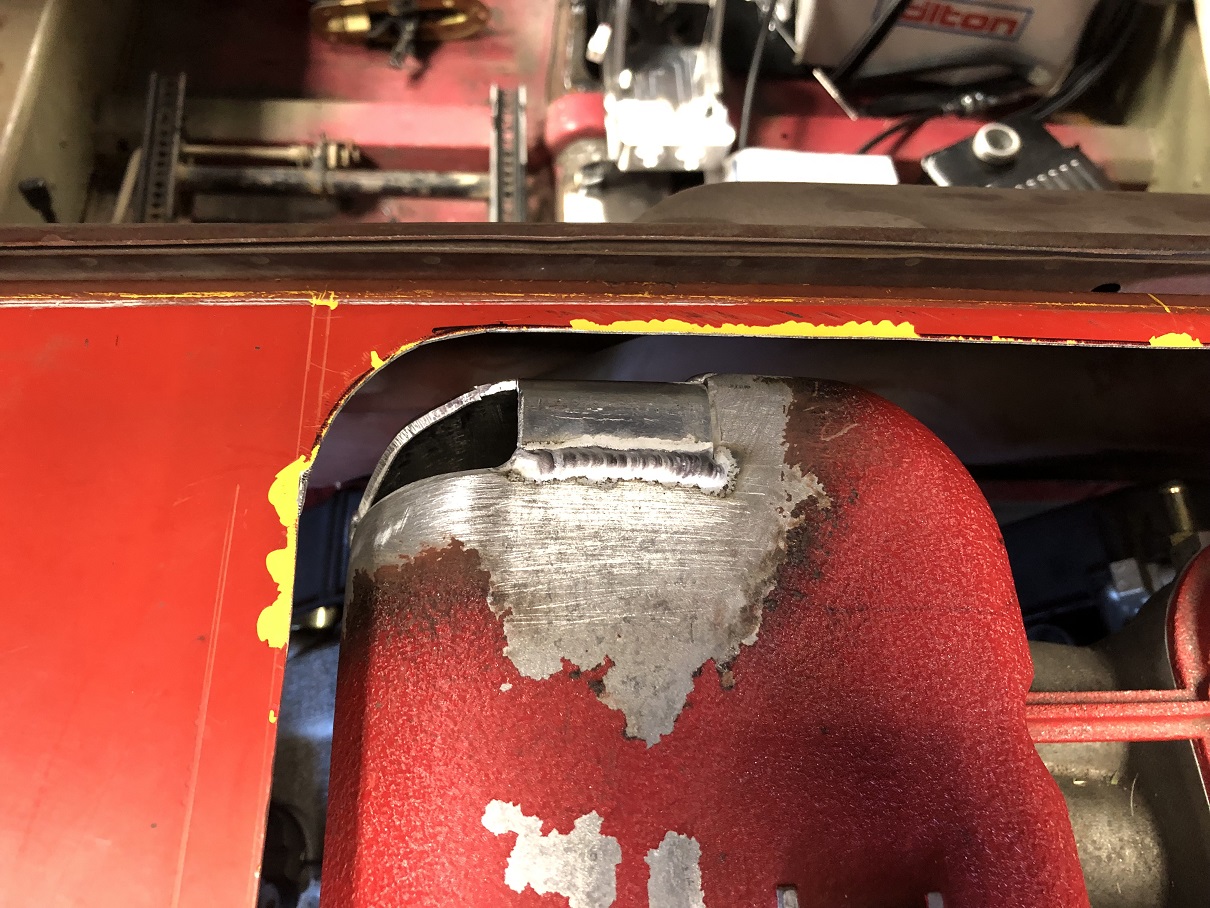

Member No.: 19,241
The best part is how nice it's going to look in the car. Did I get lucky guestimating the radius I cut in the lid or what? (IMG:style_emoticons/default/w00t.gif)
