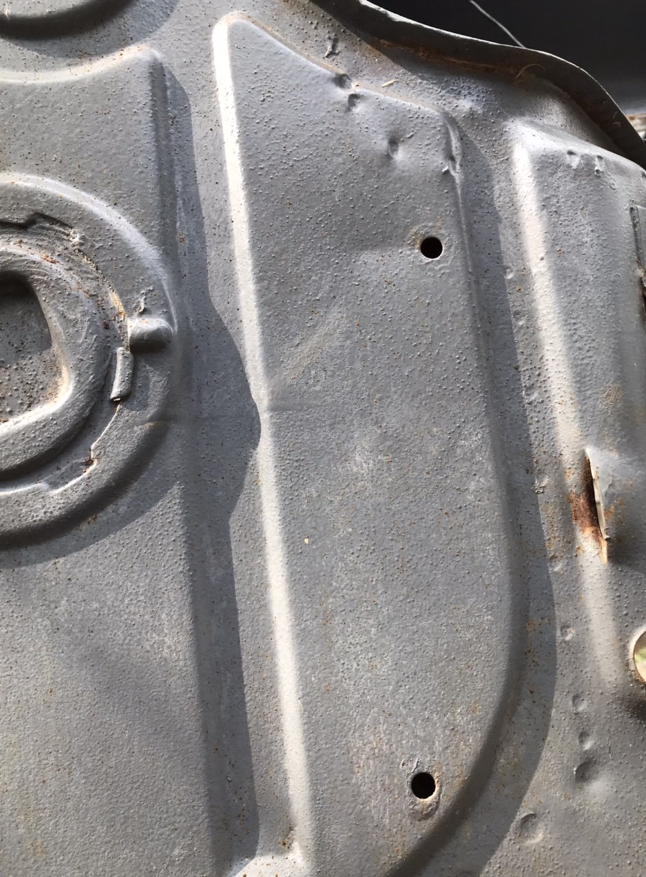

My ‘72 has two small holes, at the front part of the passenger’s side floor… they look factory and are approx 3/8” or so & spaced approx 8-9” apart.
I can not figure out what these are for and was hoping someone could shed light on it, before I weld them shut - and end up wishing I hadn’t.

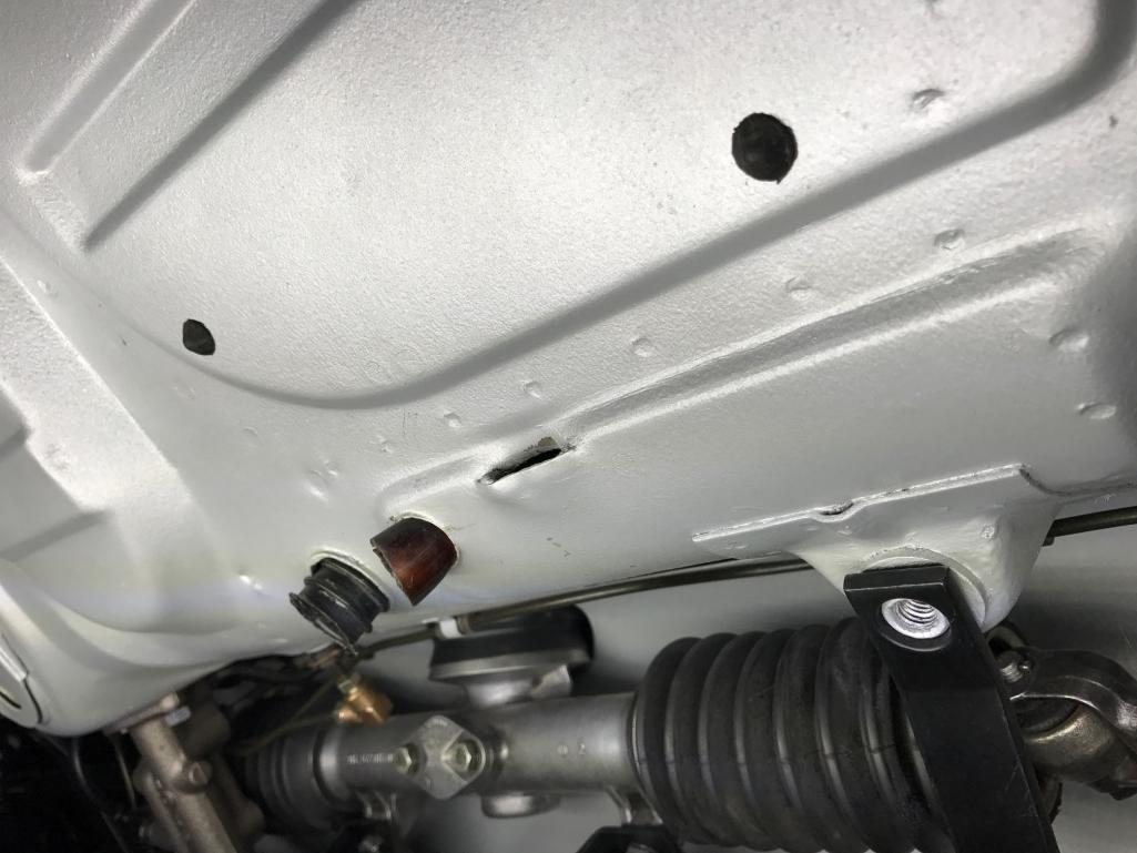

I went out and unloaded the right side of my other ‘72 (using it to store parts for the moment)… and it too has these holes and they are plugged with a small rubber ..plug. The plugs are flat on the interior side and a wide short point on the outside. I’m sure My original plugs are gone now.. I’ll double check, but I may need a couple. Here’s a pic:

My 72 has them as well. They were covered by the tar and there was no plug or anything similar.

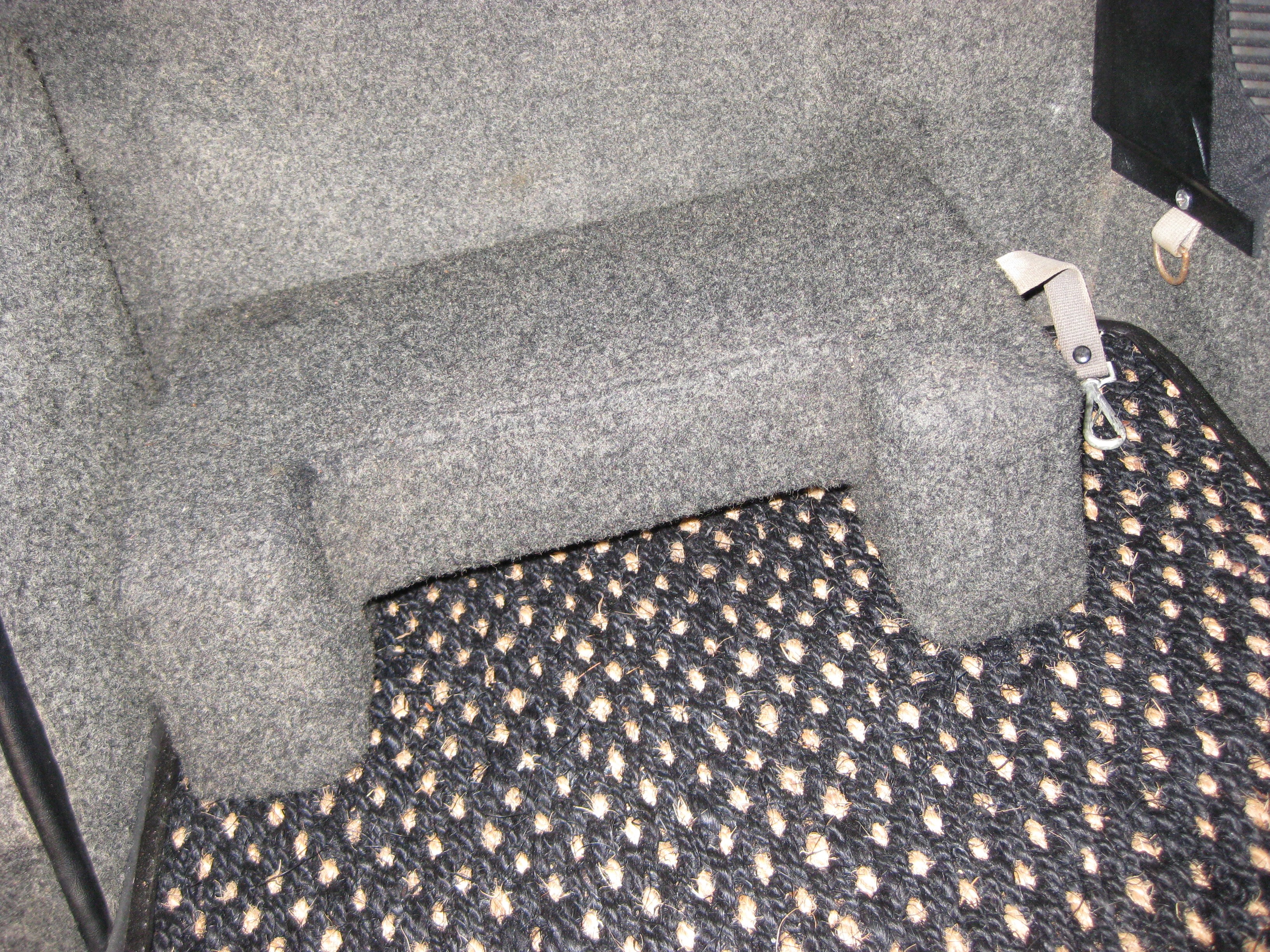

Early cars with fixed passenger seats had adjustable foot rests, didn't they?
I've never seen one, but were they bolted to the floor? Perhaps the stamping tooling was not changed until later?

No adjustable footrest I have ever seen in any 914 unless you are talking about the "dog bone" that just sat on the floor for the passenger to use if they chose. (IMG:style_emoticons/default/beerchug.gif)

The early foot rest/dog bone was kept from moving too far by a strap that had a clip that snapped into a D-ring that was attached via the speaker cover bottom screw.
