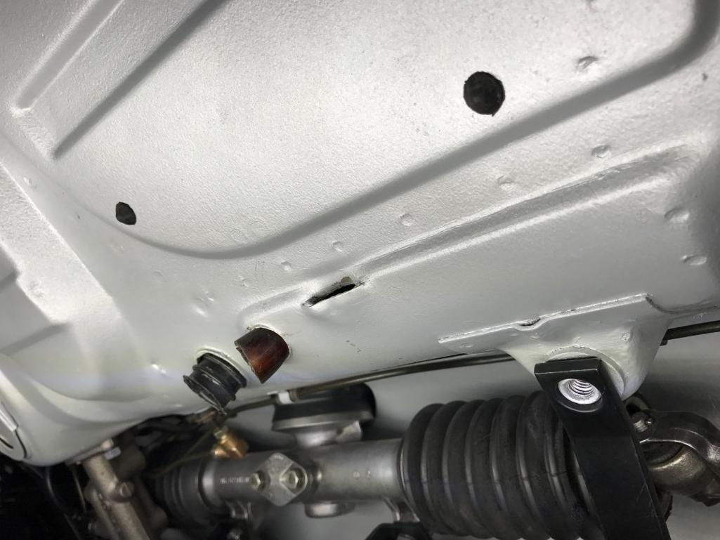

I went out and unloaded the right side of my other ‘72 (using it to store parts for the moment)… and it too has these holes and they are plugged with a small rubber ..plug. The plugs are flat on the interior side and a wide short point on the outside. I’m sure My original plugs are gone now.. I’ll double check, but I may need a couple. Here’s a pic:

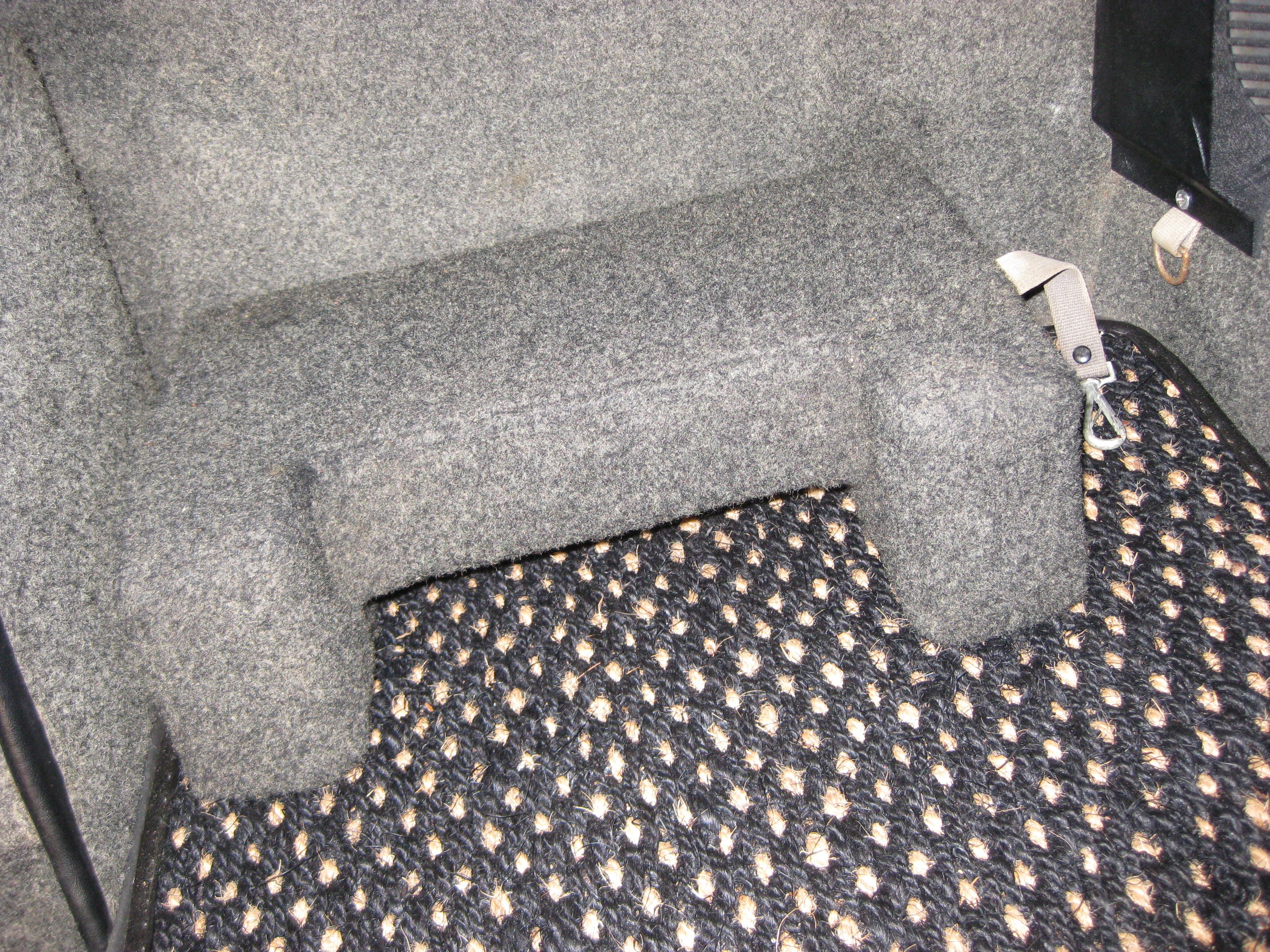

The early foot rest/dog bone was kept from moving too far by a strap that had a clip that snapped into a D-ring that was attached via the speaker cover bottom screw.
