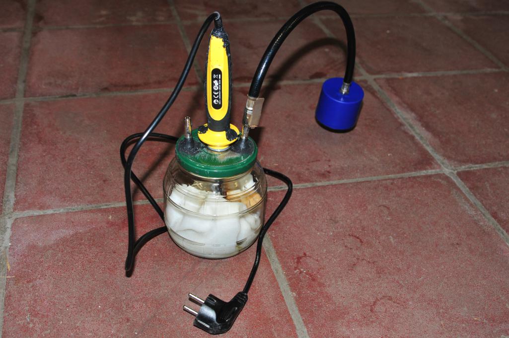

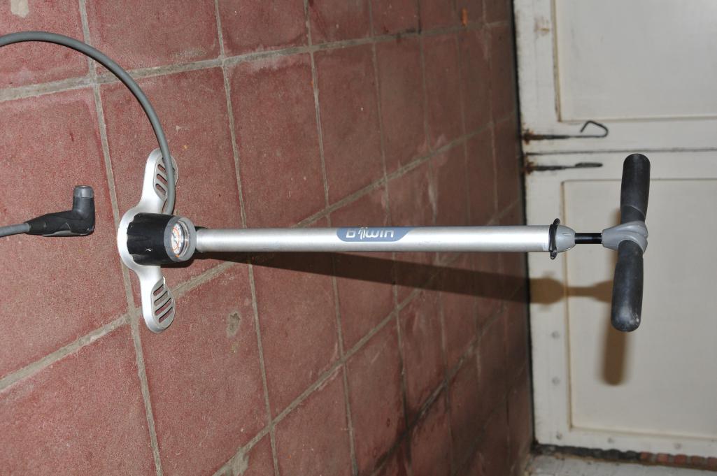

Now that I'm retired, I've finally found the time to finish the smoke machine. I used a pickle jar, 2 car valves, an old bicycle pump, a 10€ soldering iron and an old tube from a tire pressure pump. I had to seal the car valves and the soldering iron with Tec-7 because too much smoke escaped there. I mounted a lid from an aerosol can on the tube of the tire pressure pump. It fits exactly on the throttle body. (IMG:style_emoticons/default/smilie_pokal.gif) Yesterday we did the test and a little smoke is escaping along the axle of the throttle valve. So I will have to look for a better throttle body or find someone to repair it. All the vacuum lines were tight.

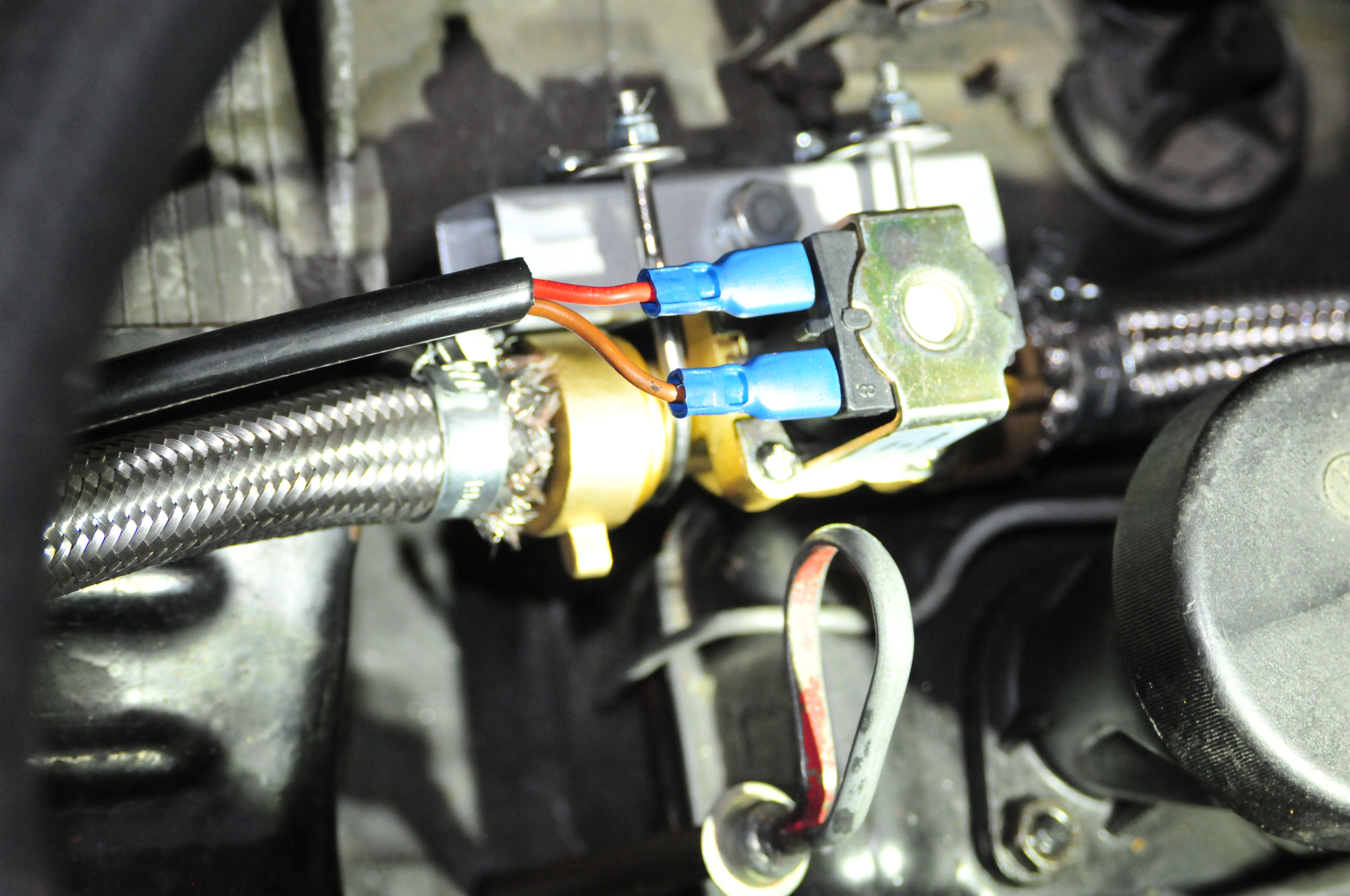

slotty008
post Mar 24 2024, 09:23 AM
Post #37
Posts: 192
Joined: 11-November 15
From: Belgium
Member No.: 19,349

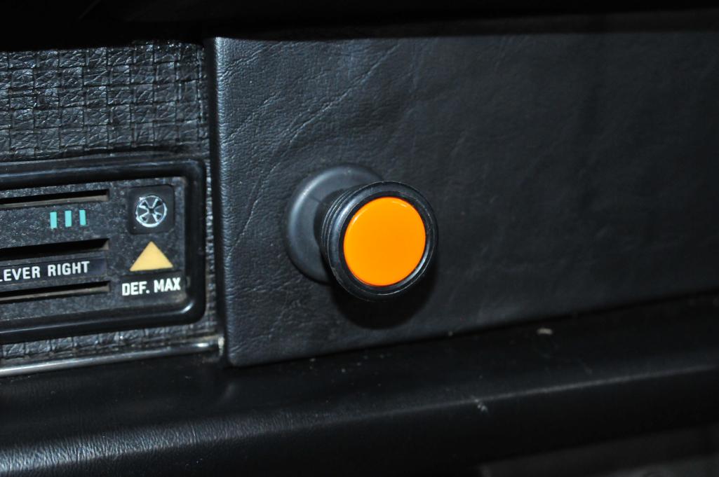

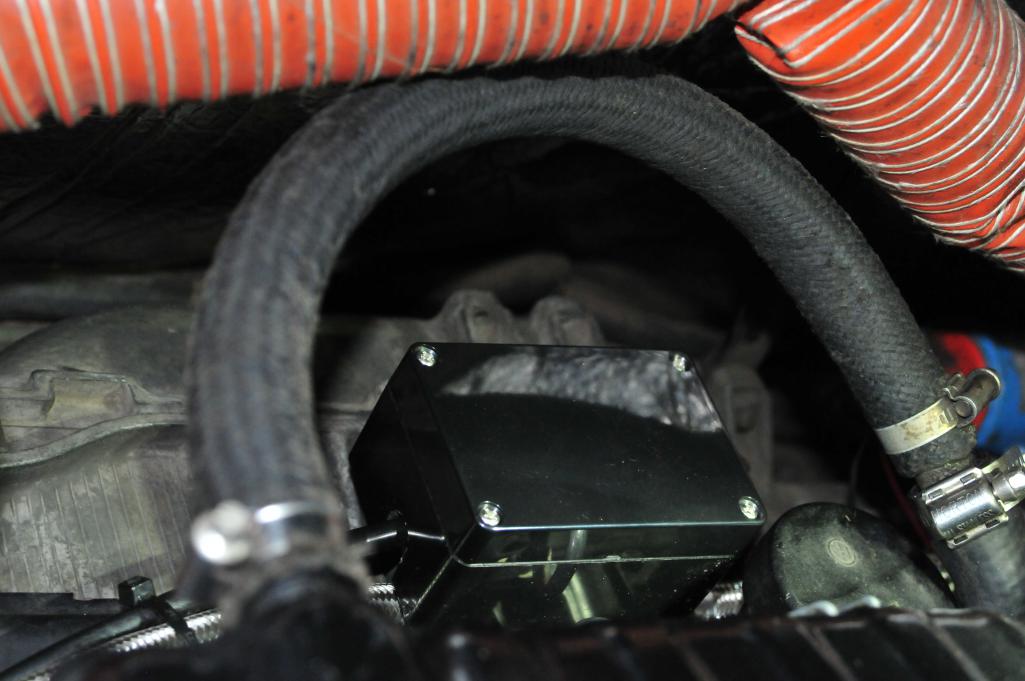

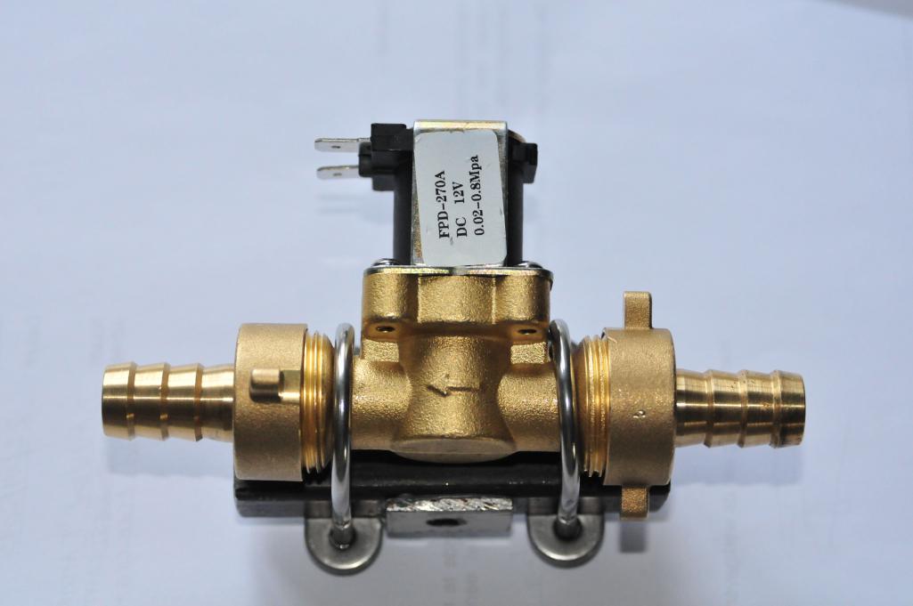

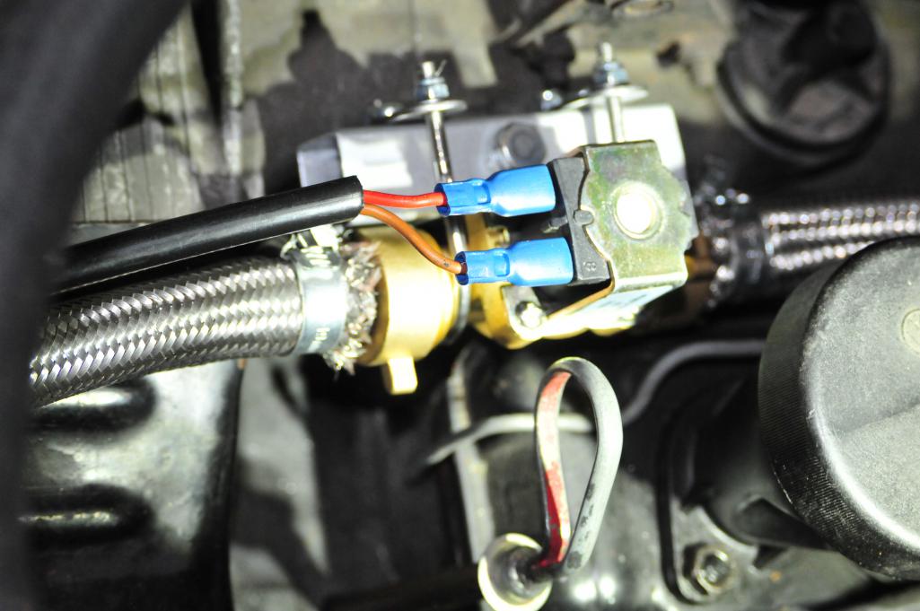

After disassembling the AAR several times, I gave up. Once installed , everything went fine until the next day and then it jammed again. So I constructed a system with a solenoid valve instead of the AAR that I can open or close from the cockpit. I open it when I start the car and after two minutes I close and I have a 1000rpm idle. It's not perfect because it's all or nothing but certainly better than an unreliable AAR.
slotty008
post Mar 24 2024, 09:25 AM
Post #38
Posts: 192
From: Belgium
Member No.: 19,349
Here it is installed.

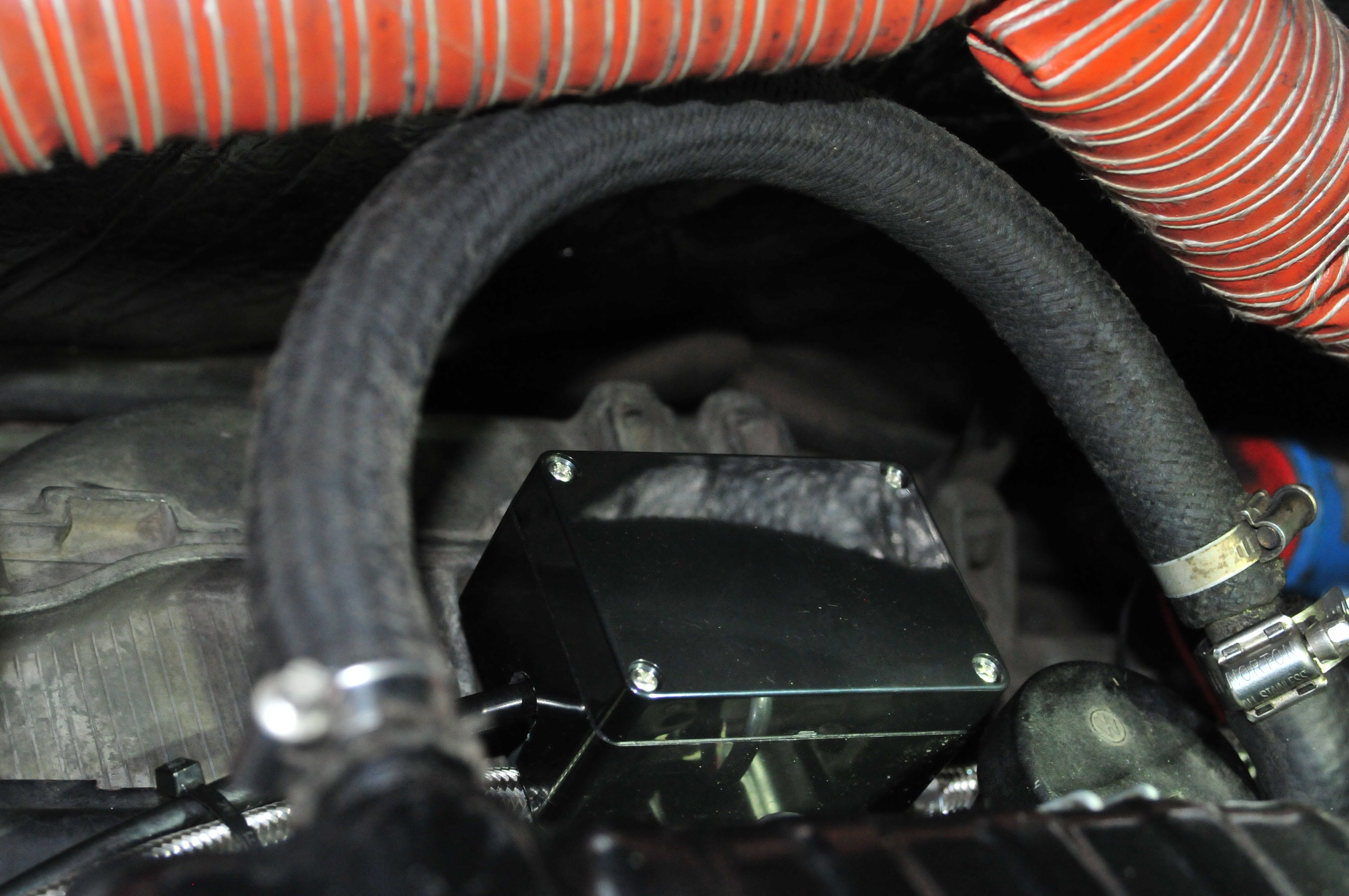

slotty008
post Mar 24 2024, 09:28 AM
Post #39
Posts: 192
From: Belgium
Member No.: 19,349
I've put a box on it to protect it. The bottom of the box has been cut out.

And this is the knob in the cockpit.
