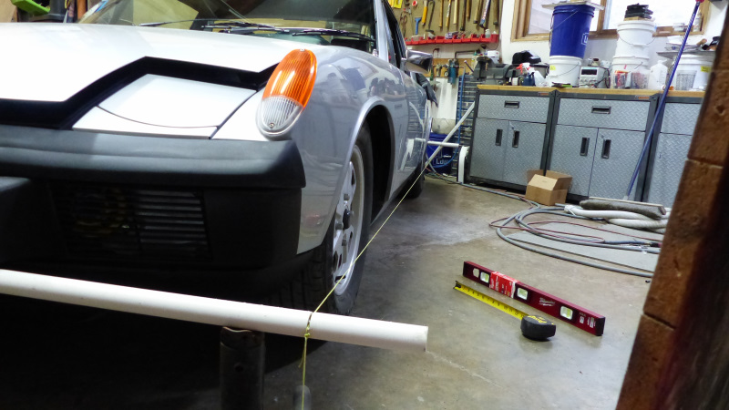

bbrock
post Jul 25 2022, 10:31 PM
Posts: 5,269
Joined: 17-February 17
From: Montana
Member No.: 20,845
I used the string method on mine. Here is the direct link to my post on it that contains the mostly helpful links and a video I found.
(IMG:http://www.914world.com/bbs2/uploads/post-20845-1622301535.jpg)
