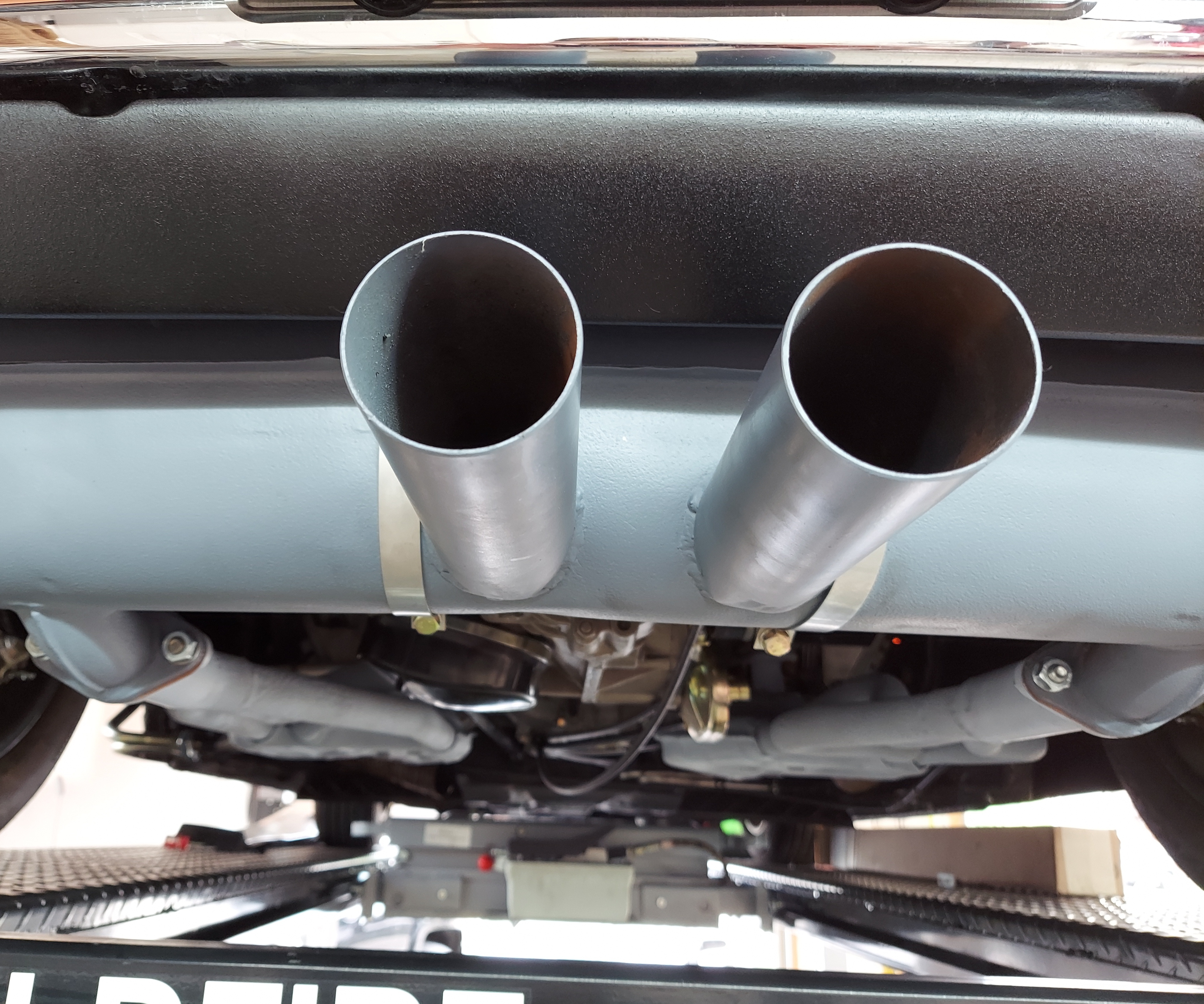

This is all Hi heat primerAttached Image
