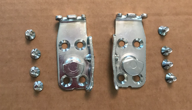

I used blue chromate on my latch plates. I think this is either the same or close to what Eric mentioned.
Also, I think the rear trunk latch (receiver) is something else. I plated mine with zinc-nickel as an experiment. Worked great, IMHO.

Pot metal/Alloy casting. We glass bead those.

Don’t throw them in with the zinc plating. They will dissolve. Same with the pull knob for the front trunk. Ask me how I know - lol!
Door stays are silver.
LOL! yeah, so don't plate the bottom latch. Maybe the nickel saved them from damage? Good to know for next time, though.
