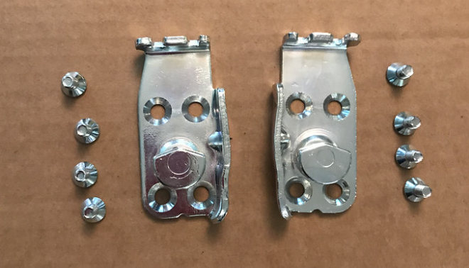

Some exceptions are the triangle headlight armature mounting plates that show on the side of the headlight buckets and their counterparts in the fender. Also the door latches and latch plates. These are clear zinc.

I used blue chromate on my latch plates. I think this is either the same or close to what Eric mentioned.
Also, I think the rear trunk latch (receiver) is something else. I plated mine with zinc-nickel as an experiment. Worked great, IMHO.
