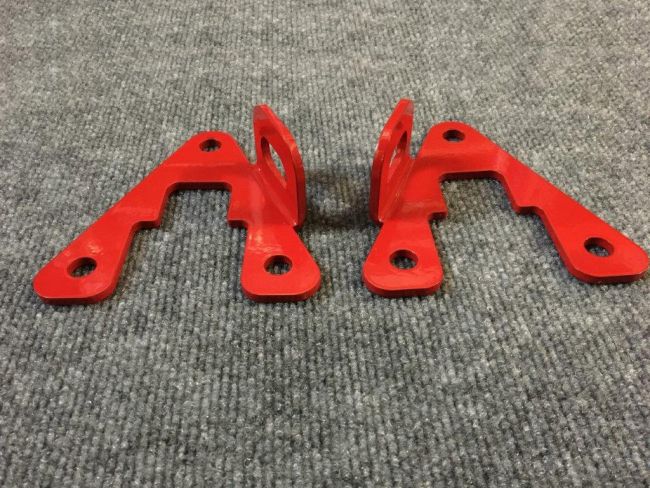

My car has dealership installed AC so the front tow point is gone. I got it with a bent drop link I’m sure was the result of a past tow. I’m trying to figure out what my options are and found these tie downs from Jman. Has anyone used these or something similar? If so I would really appreciate a picture of one installed.

Yes, those are 911 type and will fit. But, not with the front valance on without cutting holes in it. Mark

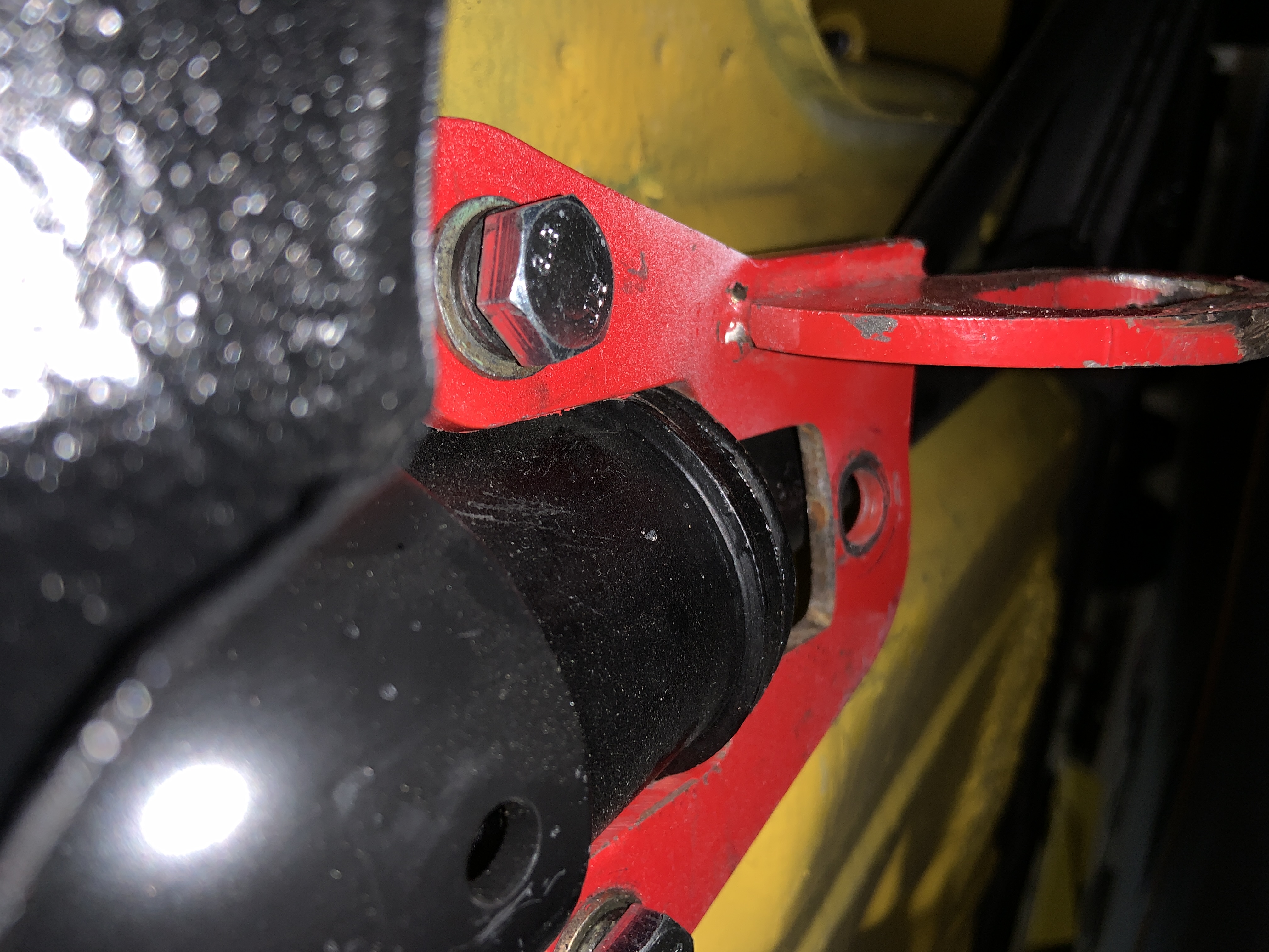

I actually reversed them and only use the two bolt holes on the side...use Grade 8 bolts.Attached Image Attached ImageAttached ImageAttached Image[attachmentid=850

QUOTE(AzGuy238 @ Sep 5 2022, 11:44 AM) *
315]
Thanks. That was the info I needed. I just ordered. Hopefully I will never need to use it but if I do it will be there.

By turning those around and eliminating the 3rd fastener you are likey going to find that they fold up when you need them.
Two fasteners creates a hinge point where they will bend when loaded.
Also front suspension fasteners should be Grade 10.9 not 8.8.
Metric grade 8.8 is basically equivalent to SAE grade 5.

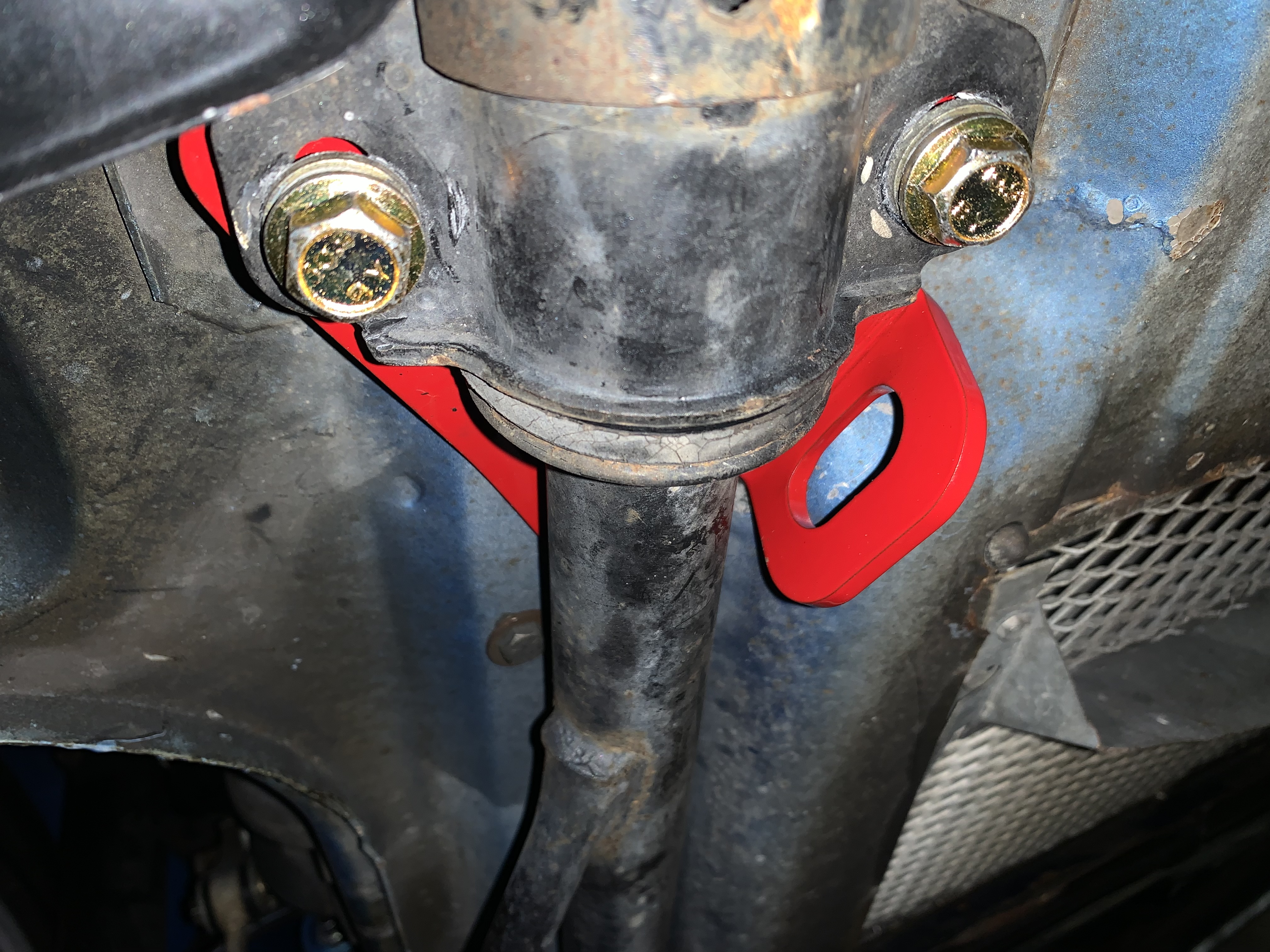

Here is how I ended up mounting the Jman loop.

It really shouldn't be between the a-arm carrier and the body.

QUOTE(ChrisFoley @ Sep 17 2022, 05:55 PM) *
I was concerned about that but saw lots of photos on line of people mounting them between. What is it I should be worried about? I don’t want to create a problem for a tow loop.

QUOTE(jdamiano @ Sep 17 2022, 09:16 PM) *
You’ve now changed the geometry of the suspension.
The most obvious is that the torsion bar will no longer be co-axially centered in the LCA. The rear end of torsion bar is fixed at the cross member. The front of the LCA is now shimmed down by the thickness of the material used (1/8” I’m guessing).
At best - premature wear of the bushings. Worst - torsion bar begins rubbing inside the LCA, wears the bar and the LCA, leads to torsion bar failure.
You will also have changed the anti dive characteristic of the front suspension to some degree.

Agree with previous comments, you really need that front bolt as it's the only that penetrates & is seam welded to the tub, & for fitment you have to remove the covers.

I’m trying to add a good place to hook a tow cable to in case I need to drag it up my trailer or a tow truck. I haven’t found one 914 specific that doesn’t stick out the front. This one was listed for a 914 but that front bolt no way matches the location on a 914. Also if I install it with the third bolt hole facing forward I can’t reinstall the torsion bar protector. Right now I’m thinking I’m going to keep it pointing the same way but move it below the mount bracket. The loop on this one is closer to the two bolts and shorter than the ones posted earlier in this thread so I think it will be strong enough. If someone has a better solution I’m all ears!
