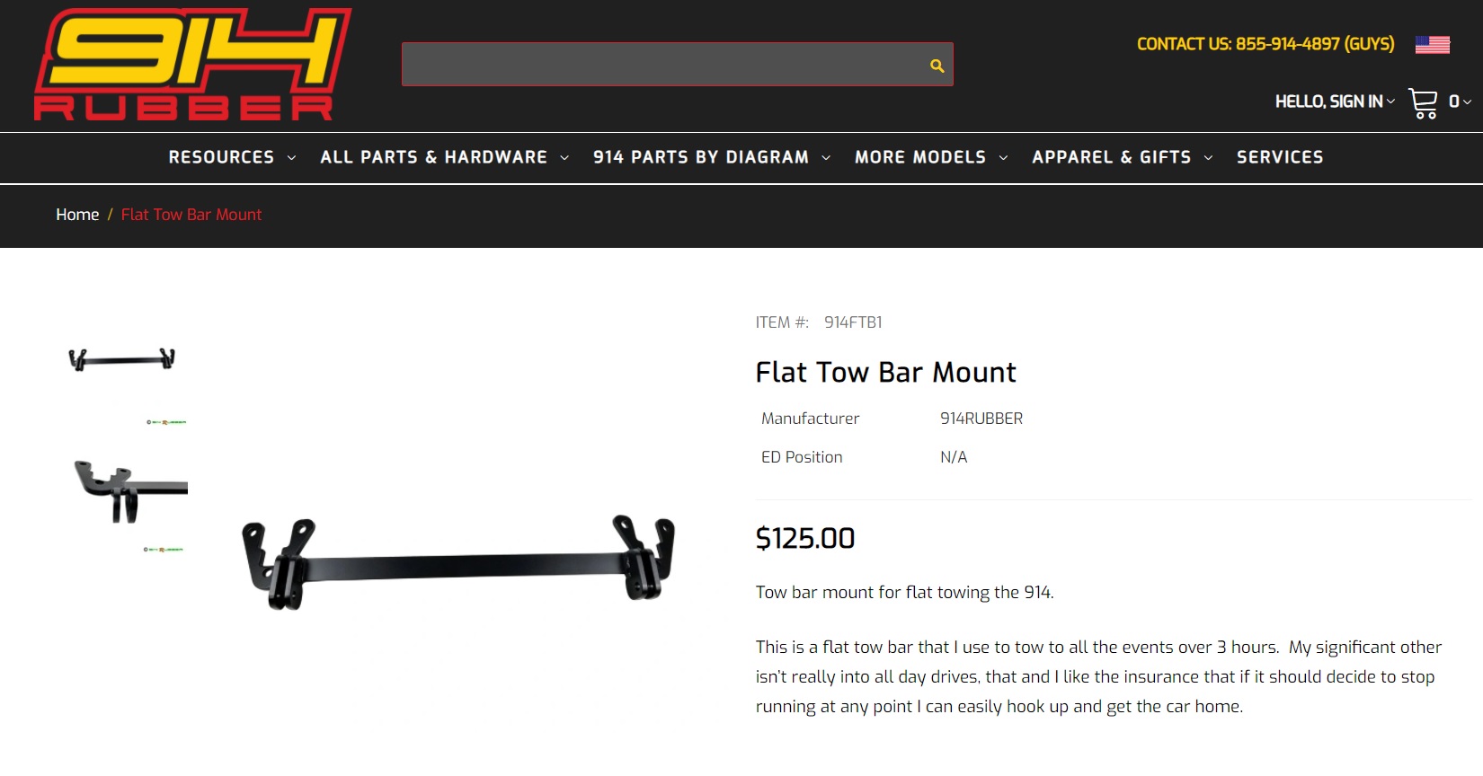

We have a tow bar may help. It will offer more lateral support and more area to hook onto.
$125 comes with mounting hardware
We made it to work with the LE air dam
Made from 3/8" steel plate
