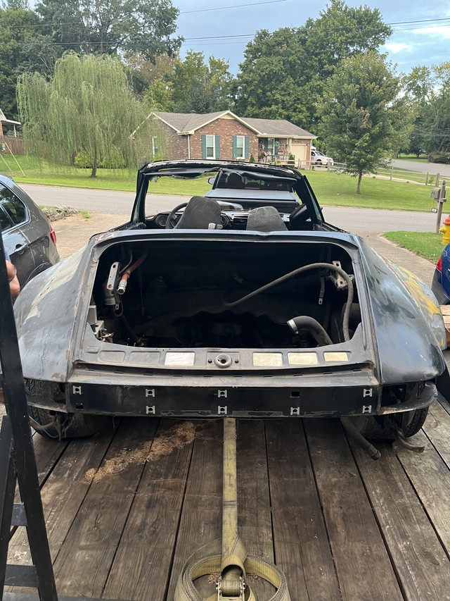

So I previously posted looking for advice on building a type 4 or trying for a -6 conversation. In general people advised a mild type 4 build and just enjoy the drive. I decided to keep an eye out for a 6 but plan on just using the type 4 I had.

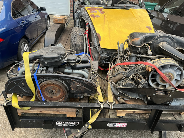

Then I got a few weeks leave from Iraq and happened to come across a no reserve eBay auction for a storage unit not far from home. I got a 2.0 MFI 911E engine, a complete 1.7 type 4, and a destroyed targa 911 for about $6k. Both engines turn over easily and look fairly complete (have not had time for a detailed inventory yet though). Pretty excited, need to offload or strip the 911 before I head back to Iraq but I’m looking forward to trying to get this 6 conversation going! If this ends up needing a rebuild I will probably run a 4 while I acquire parts/save money but it should be a fun long term goal!
I will post some pictures in a bit…the 911 is comically bad.

Should have a gold mine of parts on the 911 IF they are not trash.

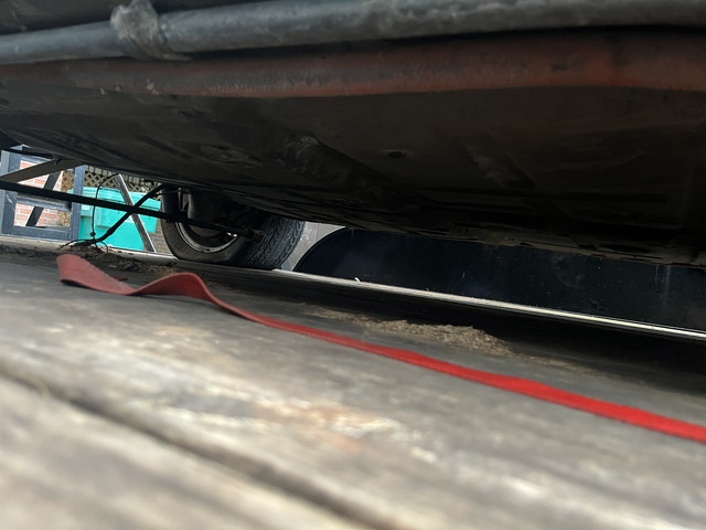

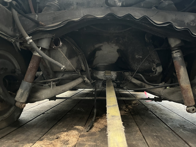

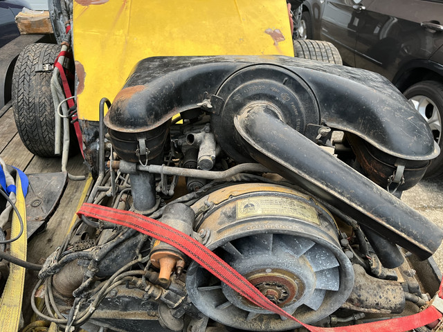

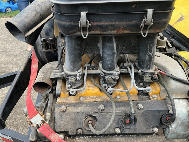

(IMG:http://www.914world.com/bbs2/uploads_offsite/i.ibb.co-25879-1662861740.1.jpg)
(IMG:http://www.914world.com/bbs2/uploads_offsite/i.ibb.co-25879-1662861741.2.jpg)
(IMG:http://www.914world.com/bbs2/uploads_offsite/i.ibb.co-25879-1662861742.3.jpg)
(IMG:http://www.914world.com/bbs2/uploads_offsite/i.ibb.co-25879-1662861743.4.jpg)
(IMG:http://www.914world.com/bbs2/uploads_offsite/i.ibb.co-25879-1662861743.5.jpg)
(IMG:http://www.914world.com/bbs2/uploads_offsite/i.ibb.co-25879-1662861744.6.jpg)
(IMG:http://www.914world.com/bbs2/uploads_offsite/i.ibb.co-25879-1662861744.7.jpg)
(IMG:http://www.914world.com/bbs2/uploads_offsite/i.ibb.co-25879-1662861745.8.jpg)
(IMG:http://www.914world.com/bbs2/uploads_offsite/i.ibb.co-25879-1662861745.9.jpg)
(IMG:http://www.914world.com/bbs2/uploads_offsite/i.ibb.co-25879-1662861746.10.jpg)
(IMG:http://www.914world.com/bbs2/uploads_offsite/i.ibb.co-25879-1662861746.11.jpg)
B3owulf
post Sep 10 2022, 08:08 PM
Posts: 45
Joined: 4-September 21
From: Clarksville TN
Member No.: 25,879

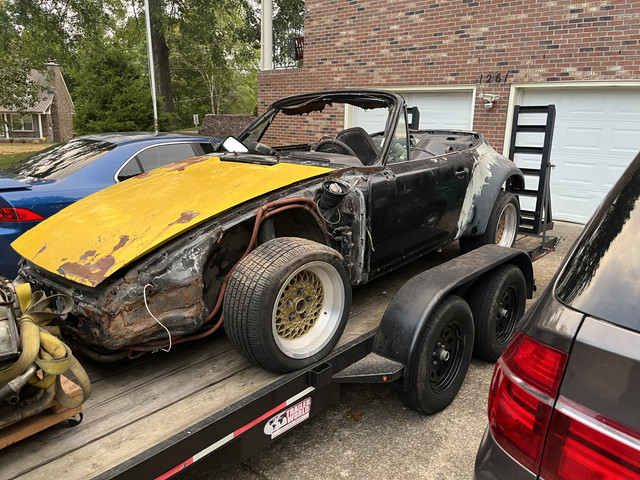

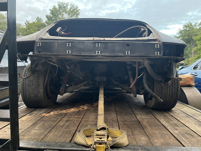

I dont know the year on the targa, the data plate is damaged. I will try figuring it out from the VIN tomorrow.
I would describe it as not economically repairable but the suspension and brakes are there, it rolls freely, and the floor pan looks solid so it could be a good parts car.
Really I just wanted the 911 engine.

Great find and the E motor is worth a lot more than you paid (IMG:style_emoticons/default/smile.gif)!
A full engine and MFI system rebuild is staggering, but the starting price helps.
…guessing a 76 or 77

The deal was worth it for the mfi engine alone. I haven’t sold one recently but a non running E should be worth double what you paid. More if it runs and the numbers are good.
Edit - looking at pics, it might also need a complete rebuild and that’s $20-30k with mfi

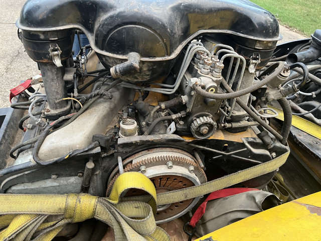

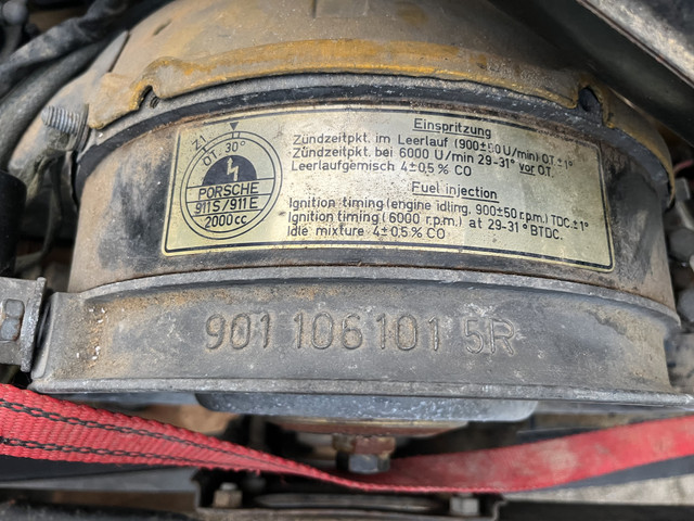

The gold foil on the fan strap would make it a 1969 2.0 E with the yellow fiberglass.
The pull type clutch says 2.2 or newer. Or installed with a newer trans.
Look on the casting upright at 5oclock on the fan support and at the horizontal
surface just below.
You'll find the engine type stamped there.

Those aluminum trailing arms and taillight features are much more recent than the engine.

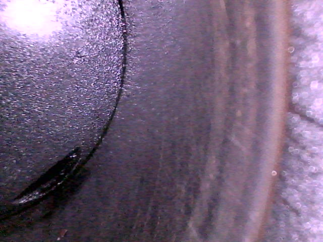

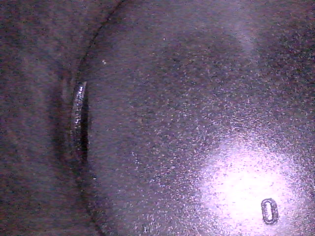

Had some time to tinker, so far nothing hugely alarming on the engine. The pump spins freely, plunger on the back compresses and resets smoothly, and nothing seems bound up. I am missing a throttle linkage and most of the hoses probably should be replaced but overall not bad.
Took some pictures down the bores, no corrosion but certainly a bit of wear and carbon. Also all the pistons have a 0 on the face. It is not something I am familiar with. Did some googling but no answers yet.
Unfortunately I will have to pause the work for a while but can move forward by looking for parts and building some knowledge on this MFI madness.
