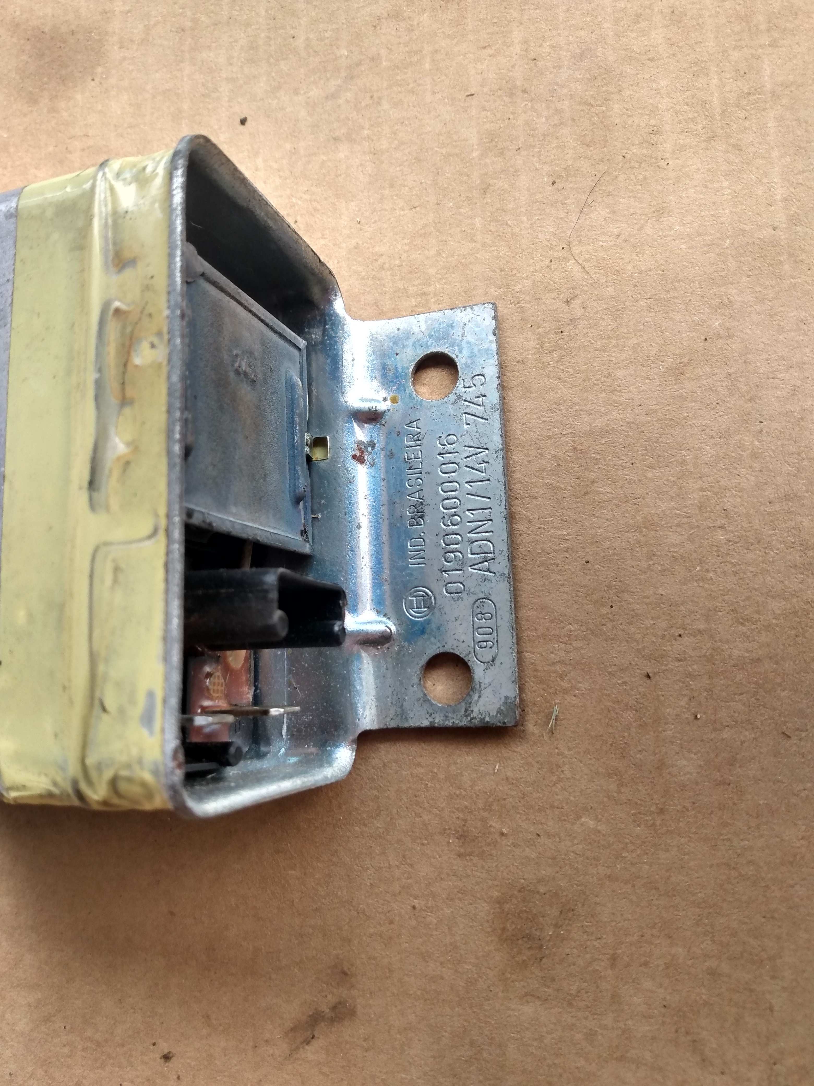

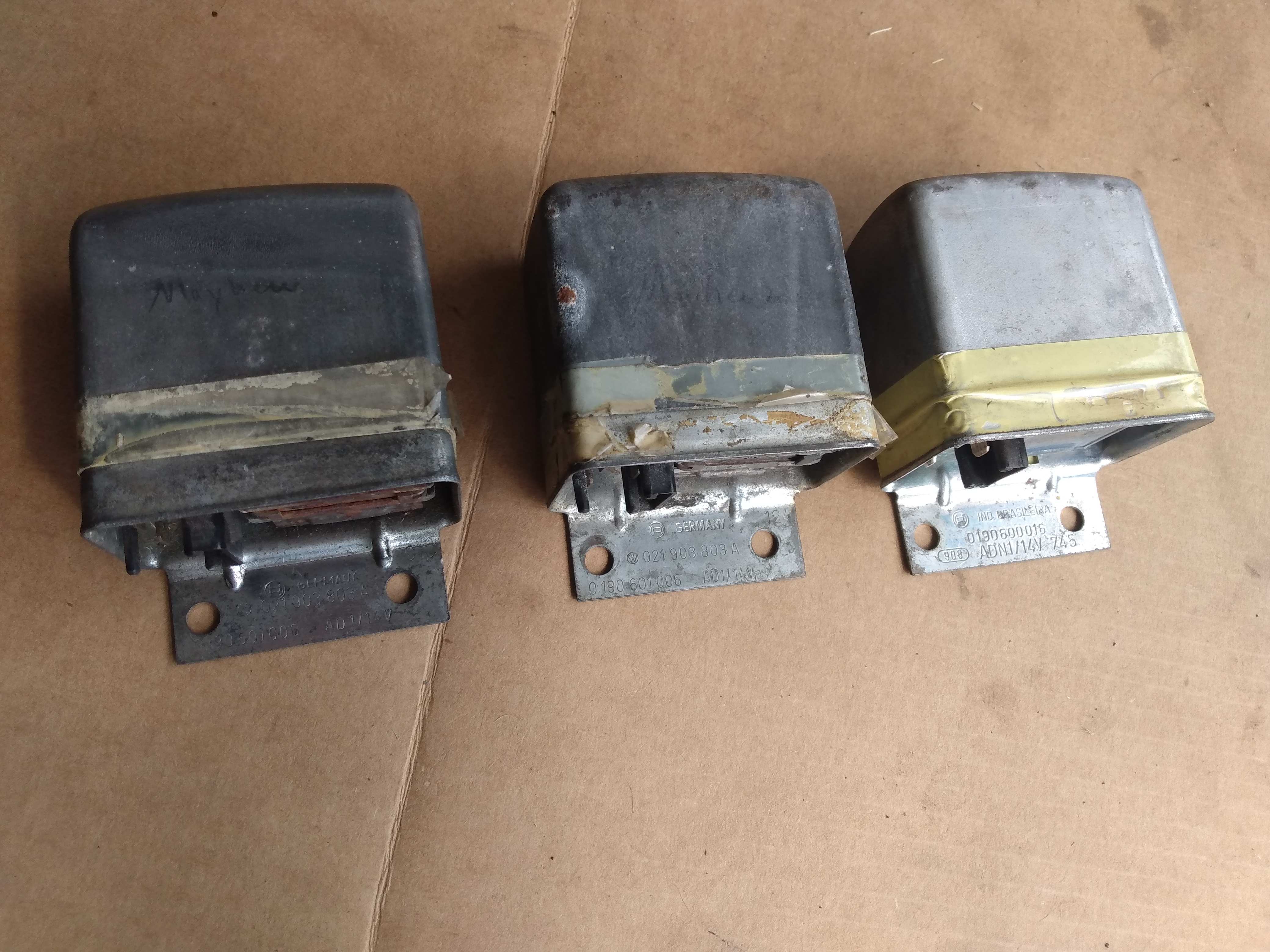

I bought the last solid state regulator Mark had hoping to solve my charging issues or at least eliminate it as the problem (can't get more than about 13v while running). I have 3 regulators that have been in the car over the years, but the last/newest one has been there for at least 20 yrs. I don't know if these are bad, good, or somewhere in between and I have no way of testing them. So no idea what they may be worth, if anything. Opinions?
