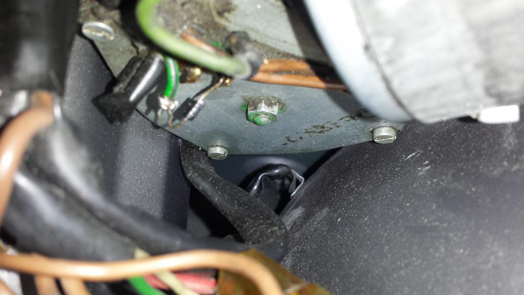

Check the connection on those little diodes. Look for a green wire going into a “black wrapped piece”
There’s a thread with pics ……I see if I can find

See: http://www.914world.com/bbs2/index.php?sho...85&hl=diode
