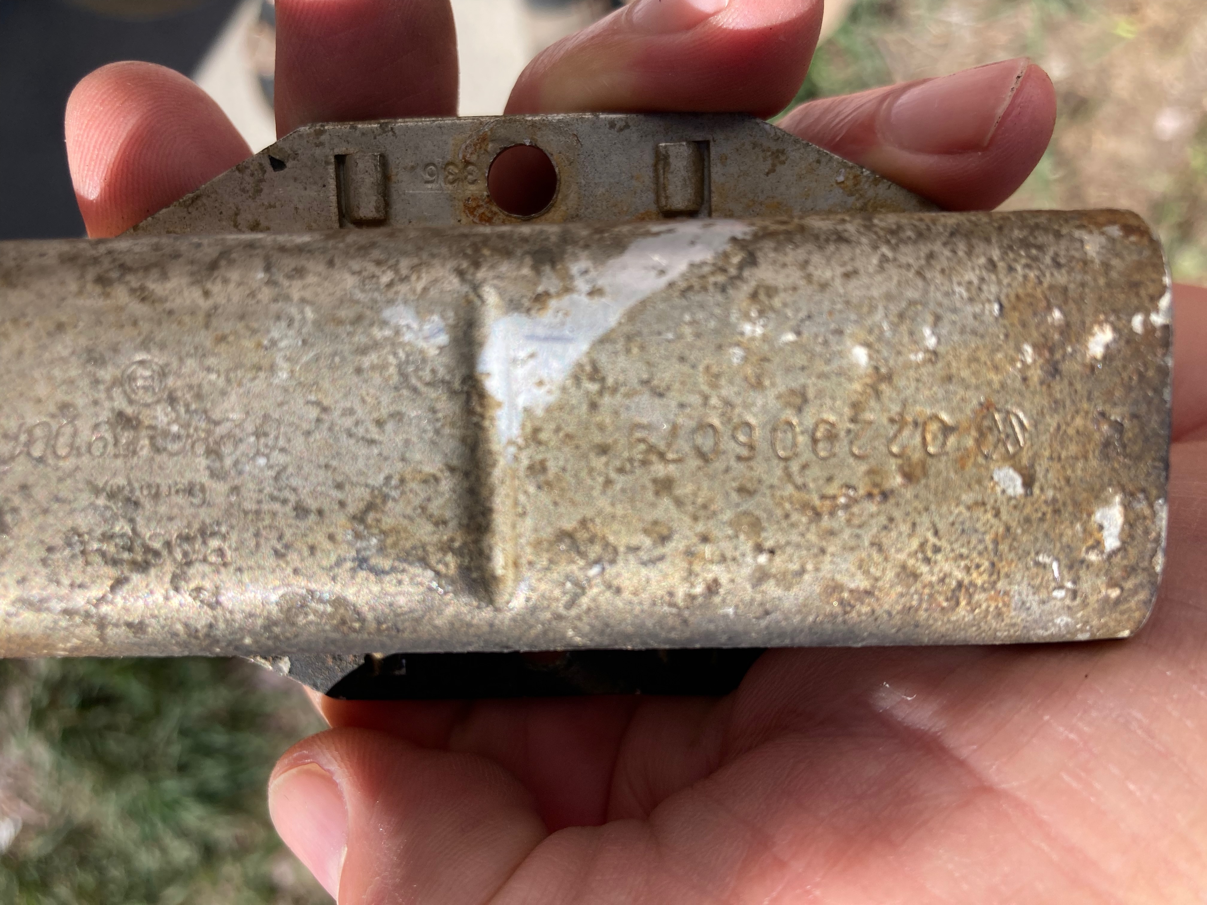

So im trying to diagnose a stuttering issue that seems to occur after about 15 min. of drive time. She starts cutting out at low RPM and then will climb erratically if I mash the throttle. I have installed a new flame thrower coil which does seem to give her more pep but still having this stuttering issue after warm/hot.
I unplugged this resistor (I think thats the name) and the engine stopped so it must be important but the wires are very brittle and look to be about to pull out from the ceramic tubes/cylinders.
Pelican says No Longer Available
https://www.pelicanparts.com/More_Info/0229...mp;KeepHeader=Y
Thanks for any insights as I have tried all the other diagnosis familiar to me.
John

Part 8a in the diagram. Ballast resistor for the FI on the 1.8l L-jet. May have luck posting a want to buy in the classifieds if you're looking for a replacement.

the resistor block is not the problem, it only fails when one of the wires disattaches itself causing one cylinder not to fire. Try points condenser dwell timing firsts. Resistor blocks are totally available by the way
