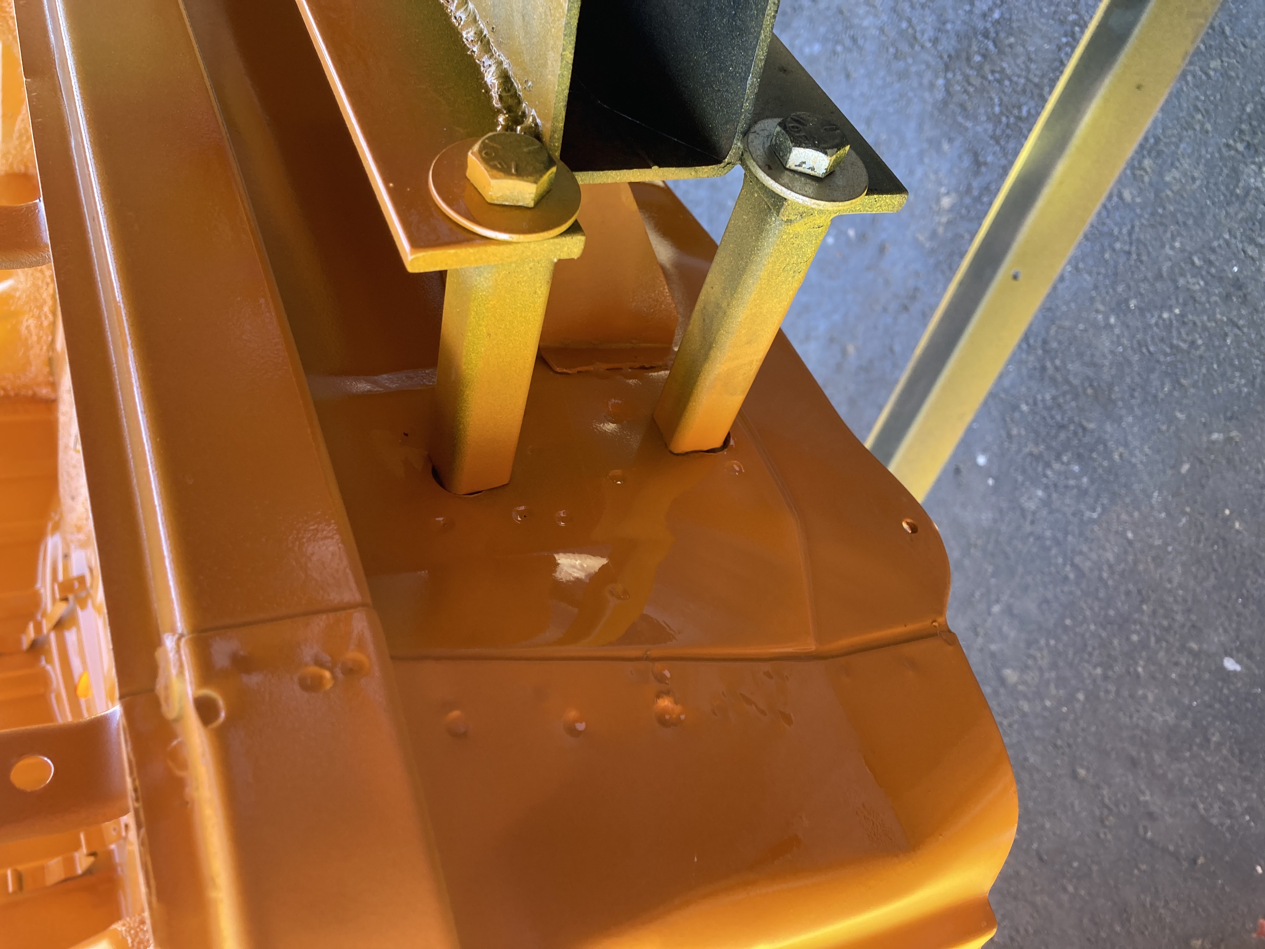

Good day, My car has been on the rotisserie for ten plus years and I finally got it media blasted, epoxied and some base coat done. Now I can start to build it. I want to install the front suspension (less hubs and rotors), rear suspension (less rotors) rear sway bar pedal cluster and brake lines, wiring harness, dashboard and steering rack. Then I’ll take of the rotisserie for the rest. My rotisserie use the bumper holes for mounting.What do you guys think? Would it be to heavy?
