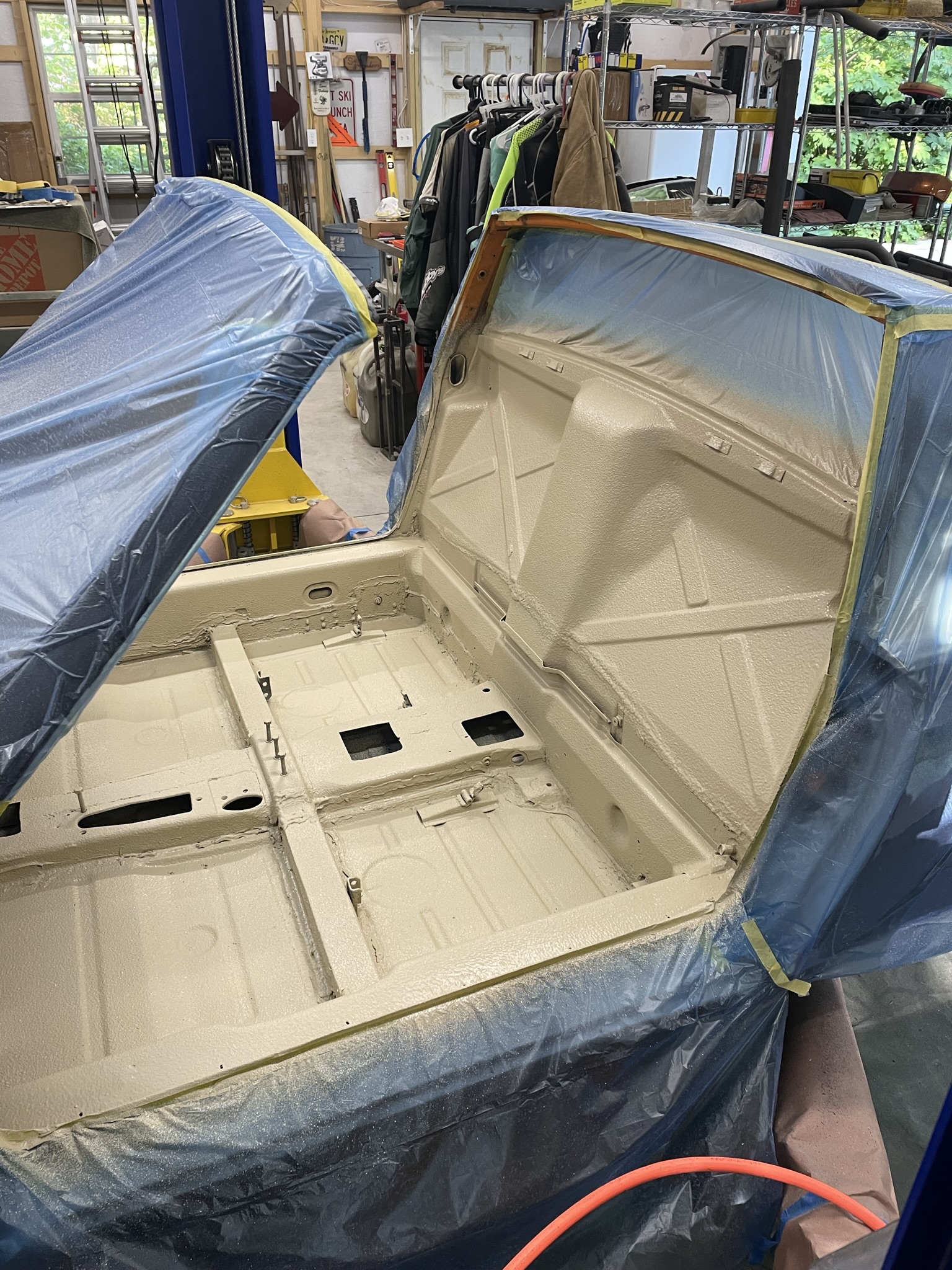

Finally got some color on its bones! I’m doing paint tint bedliner in the trunks, interior, and engine compartment. Front trunk done.

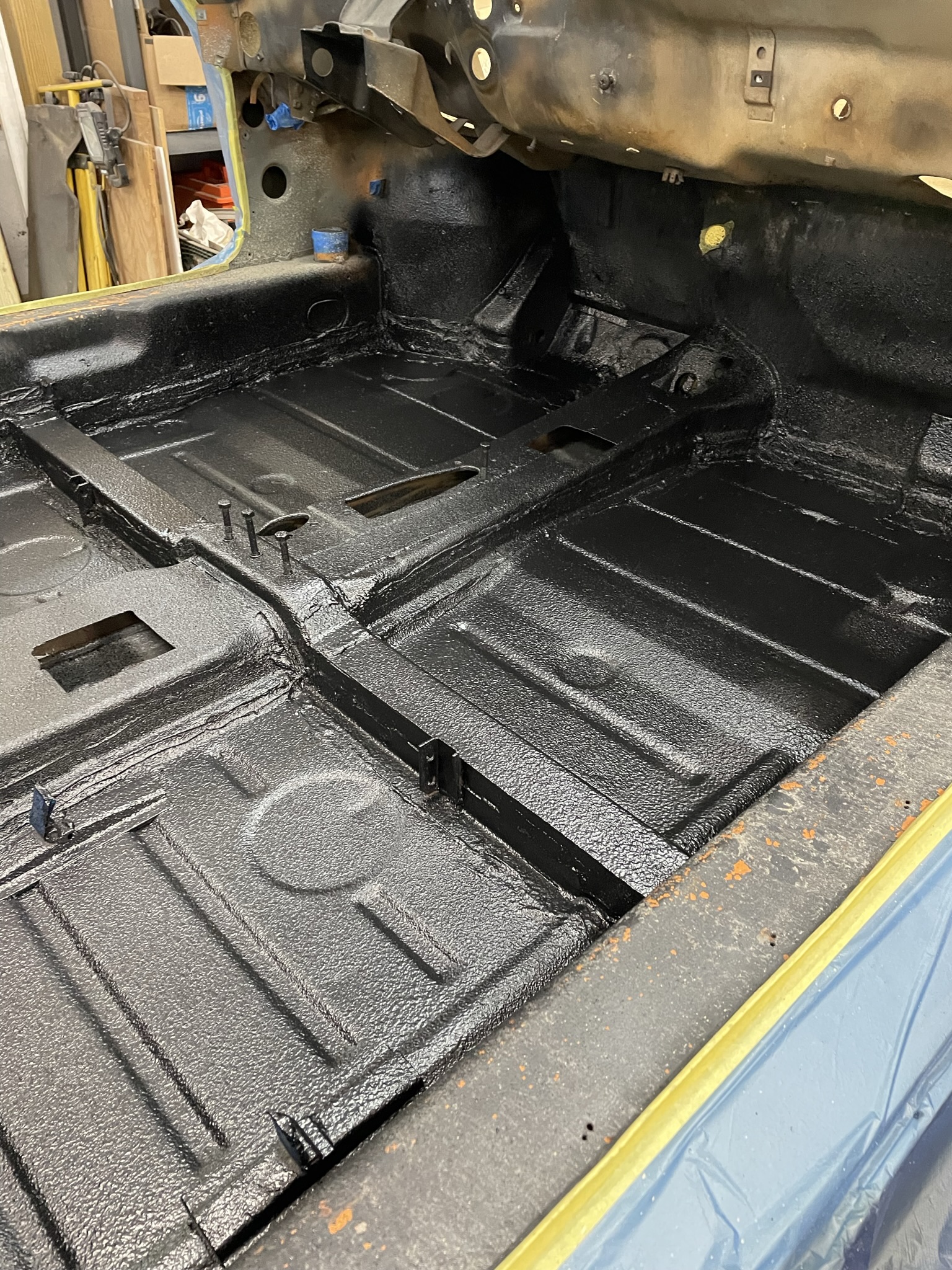

And a couple coats of black bedliner for sound deadening. It will get a couple coats of tinted bedliner next.

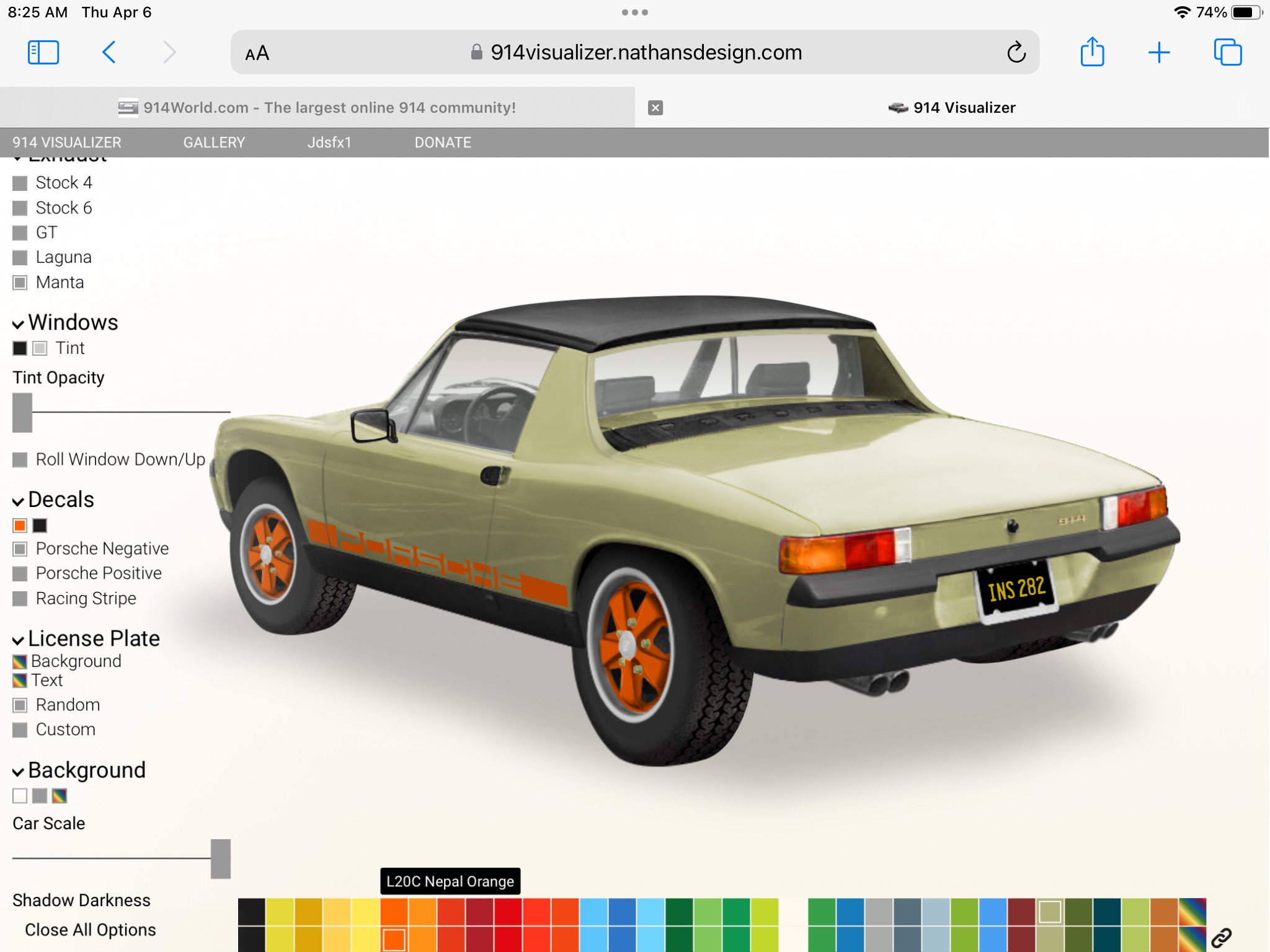

Endstate scheme…

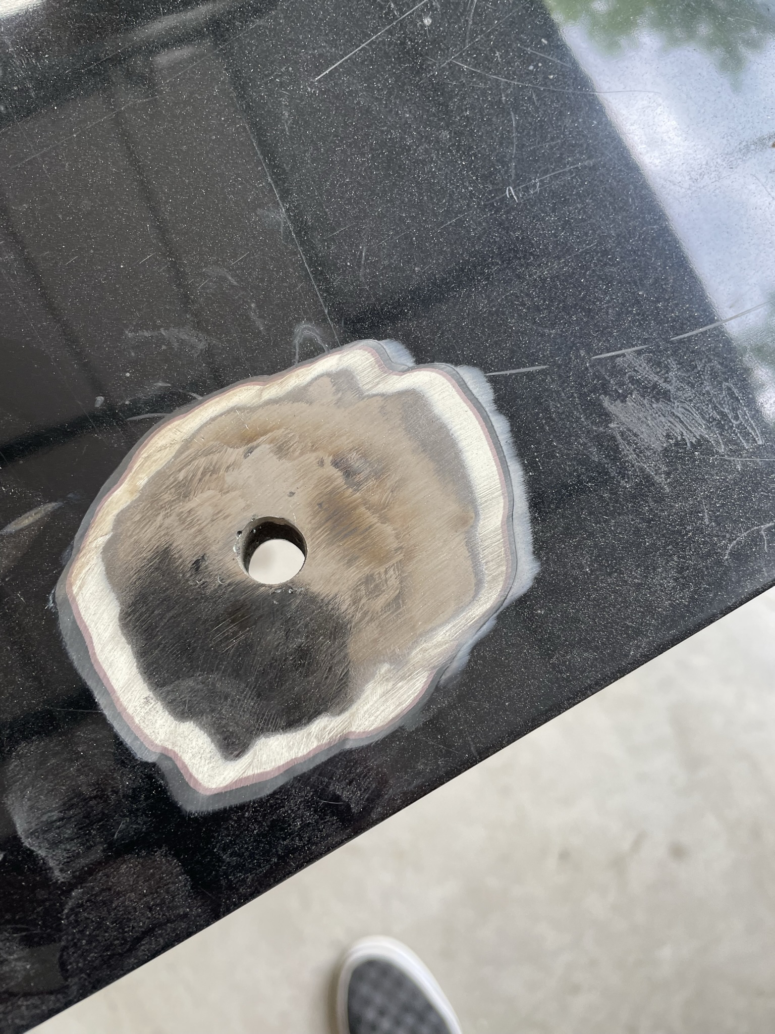

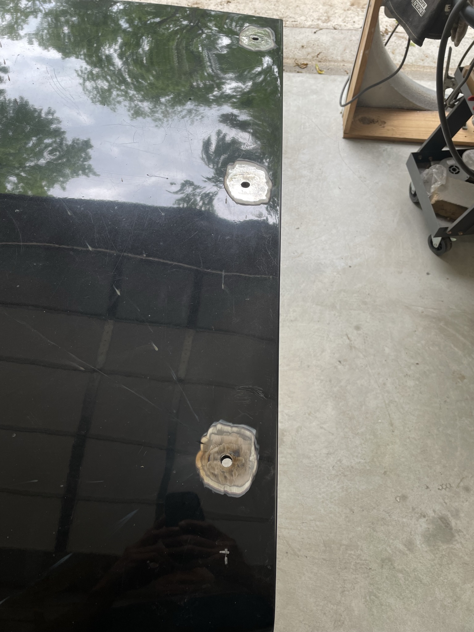

Got a little micro project done yesterday. Welded pass-thru tubes into the mounting holes for the Safari rack on the rear trunk lid. Without these the panel will distort when tightening the mounting bolts. The tubes are welded to the ribs on the bottom and surface at the top. Just another little thing checked off the list in prep for paint.

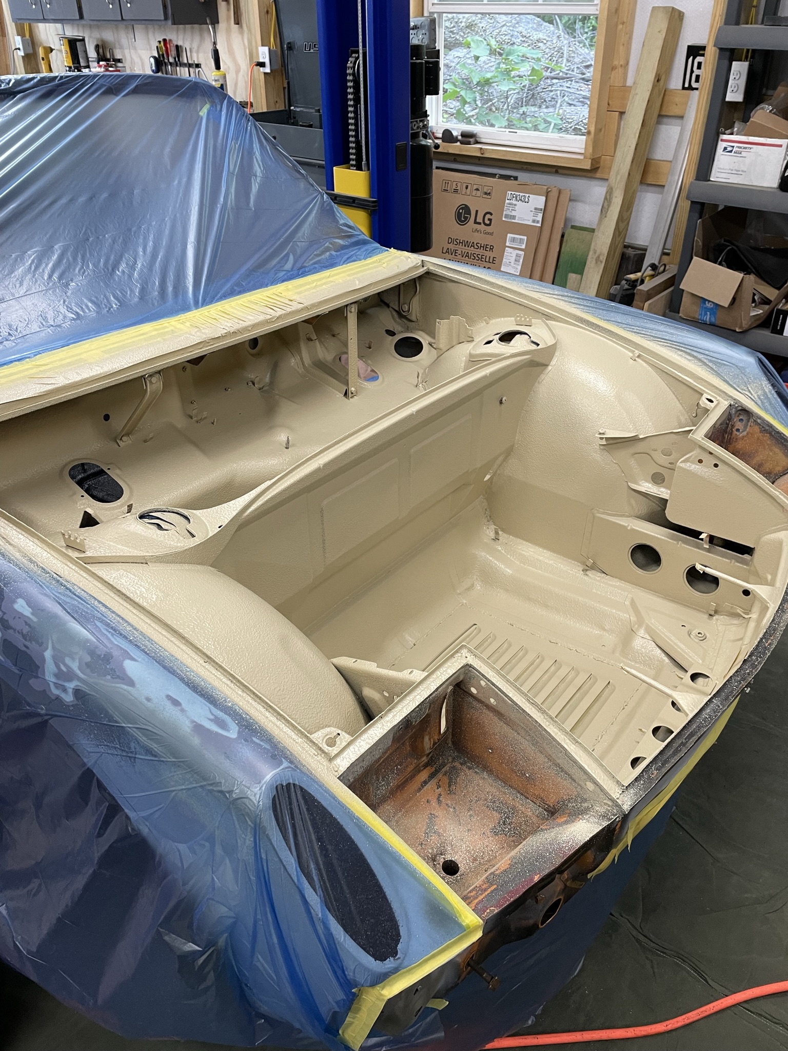

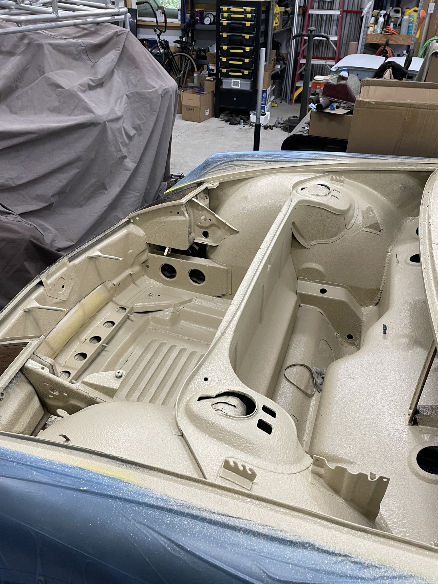

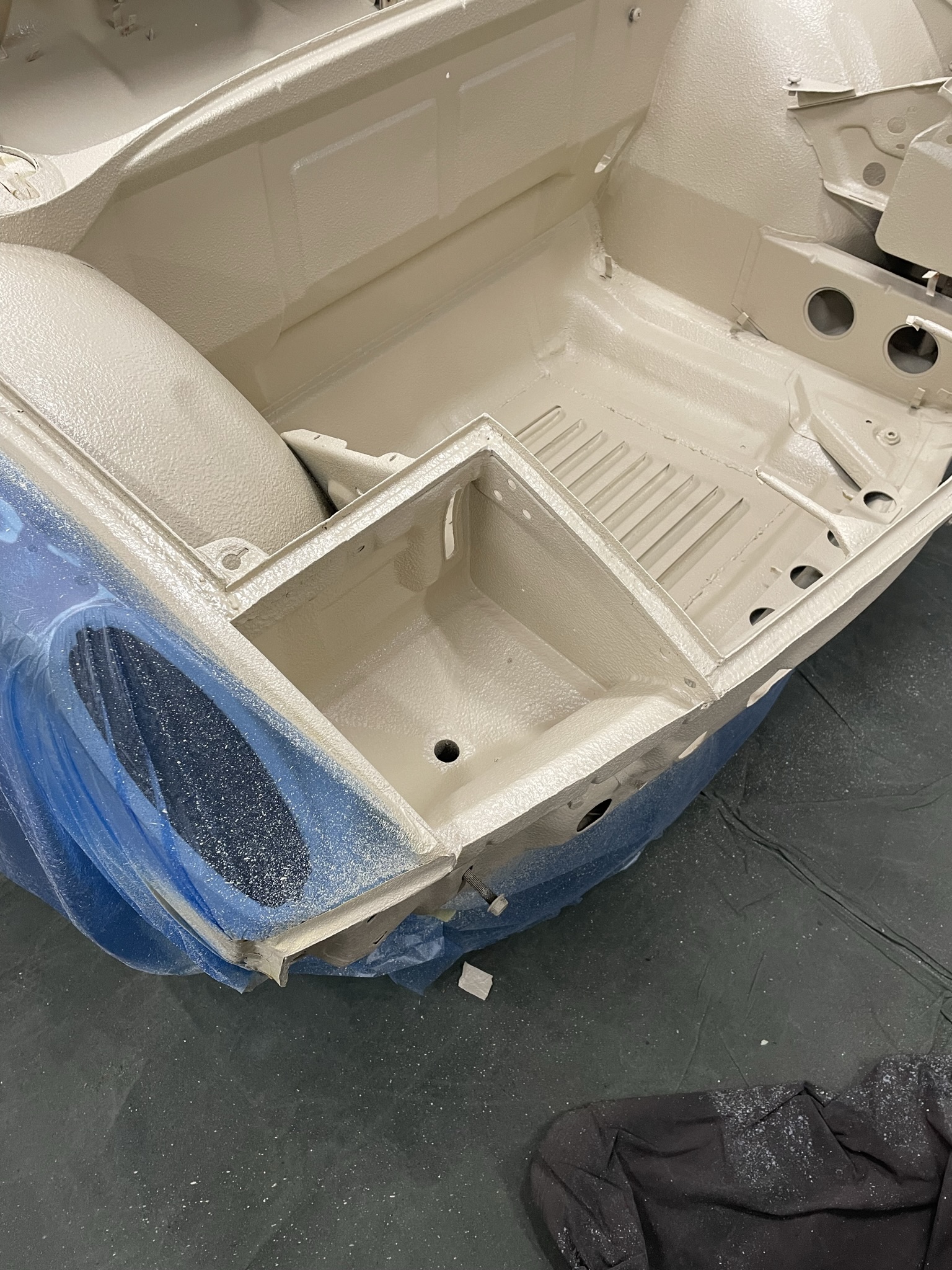

looking good! i have a question, why not spray inside the headlight bucket area too while you are sealing it and painting/coating? just wondering why you left that.

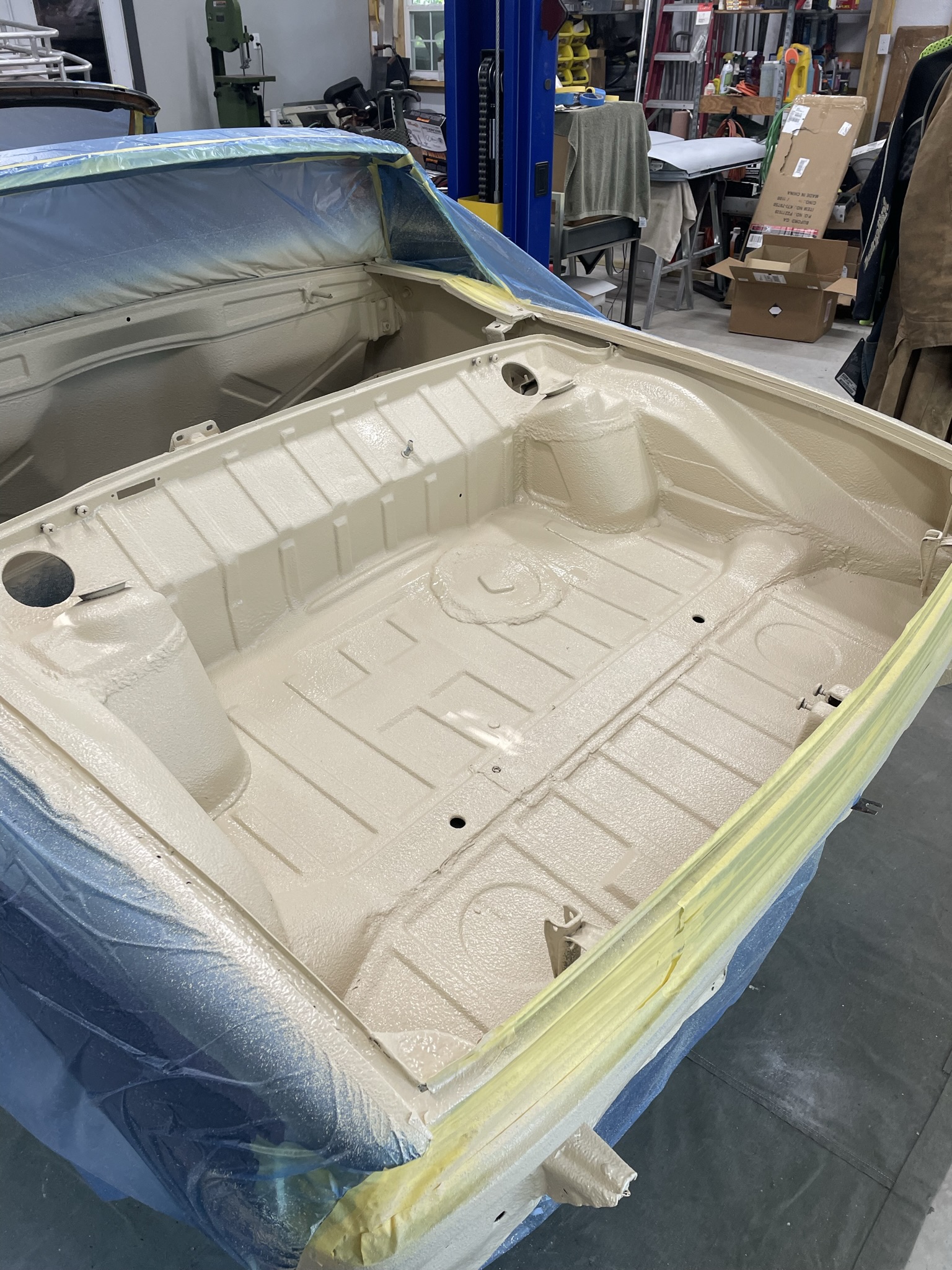

Is this better? I was waiting for supplies to finish it all up.

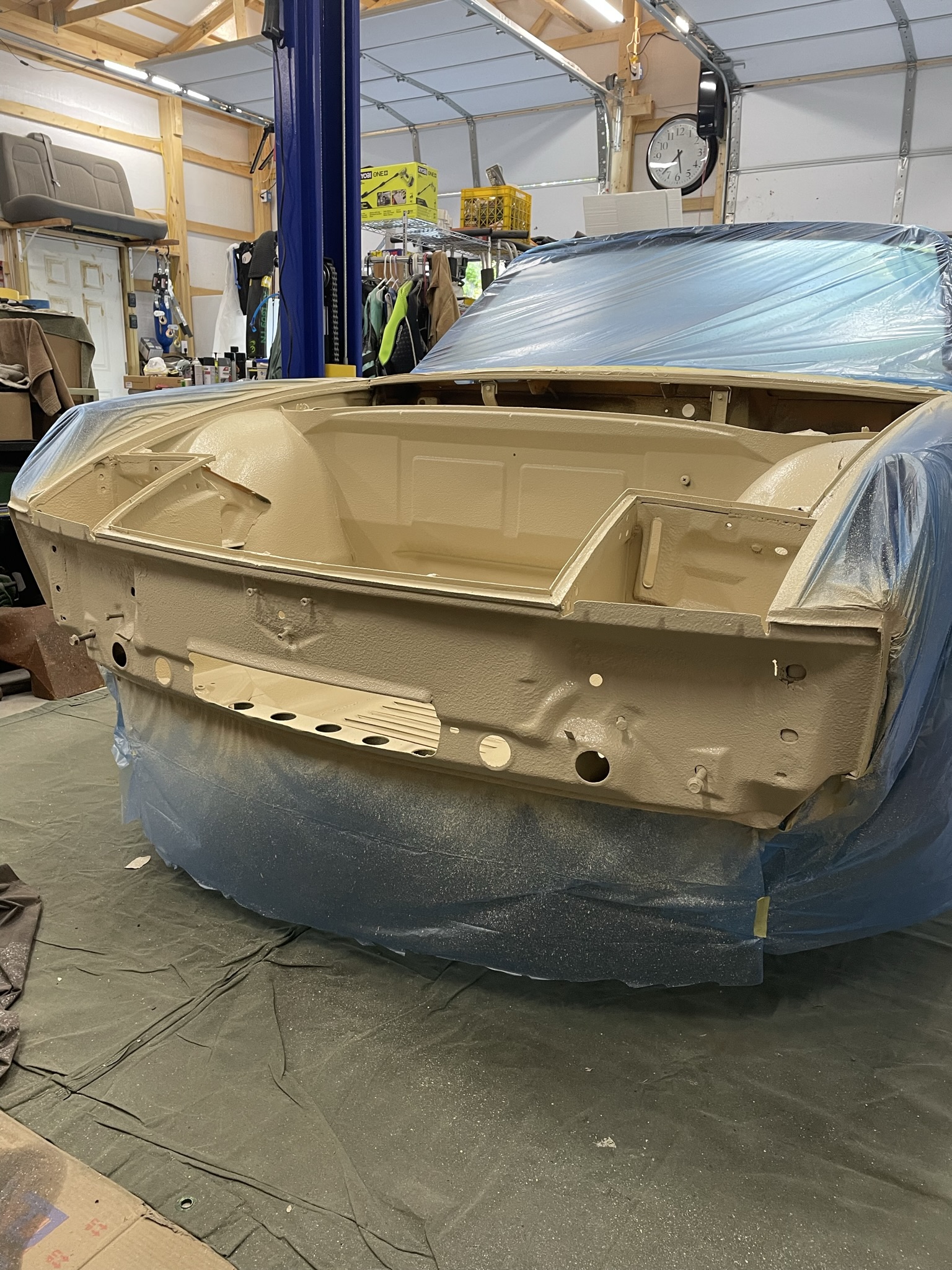

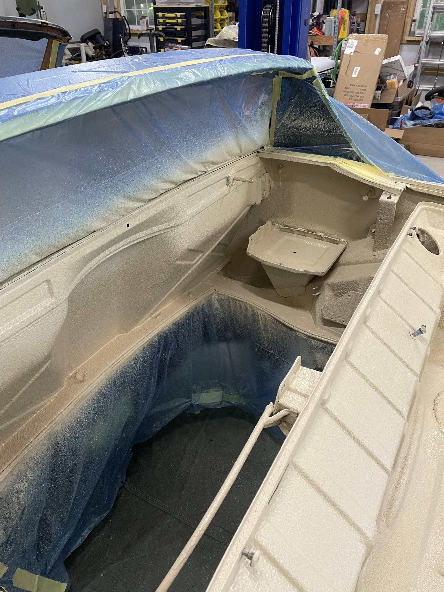

Finished the trunks, engine compartment, and interior today. I also did the areas behind the front and rear bumpers. Feeling some progress…..

One more….

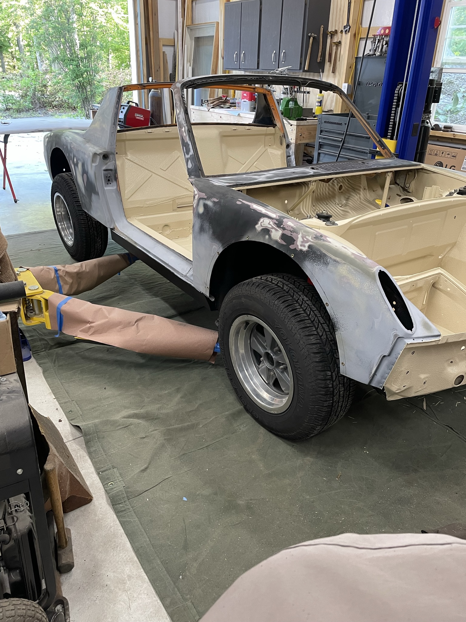

Got it back on its feet today. Put the front and rear suspension on and set it down on its new tires for the first time. Setup the heim joint tie rod ends and did a course adjustment so I can wheel it around…..good to see it back on its feet!

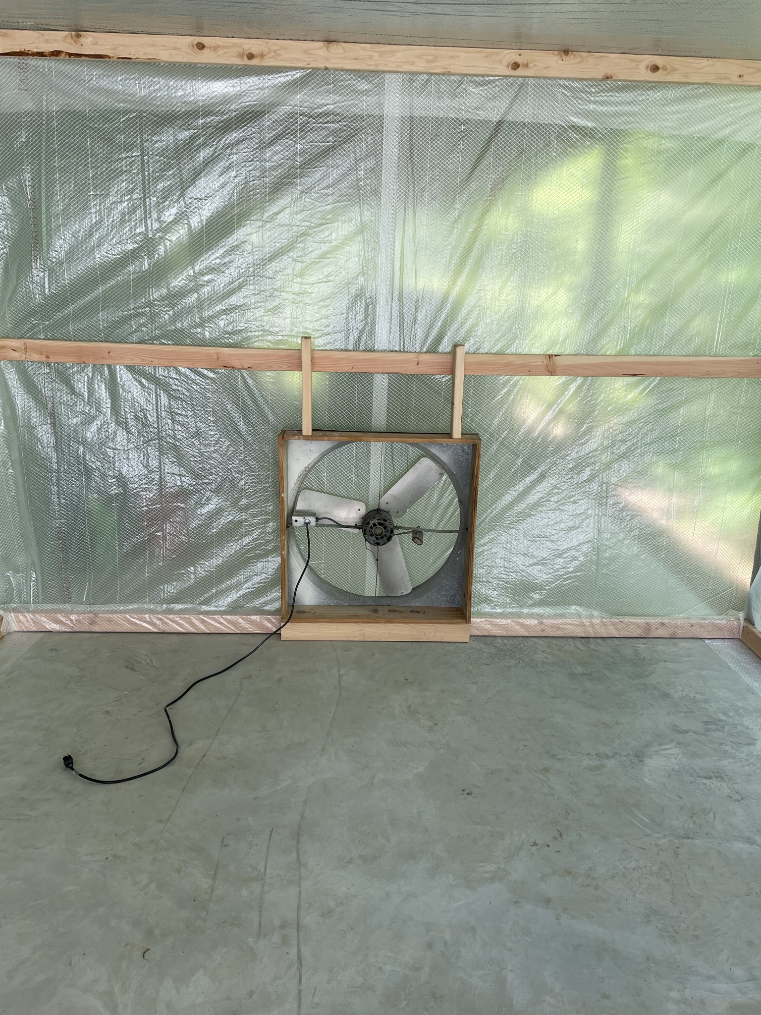

I’ve been quiet lately……..just doing body work to get ready for paint, and that’s kinda boring stuff.

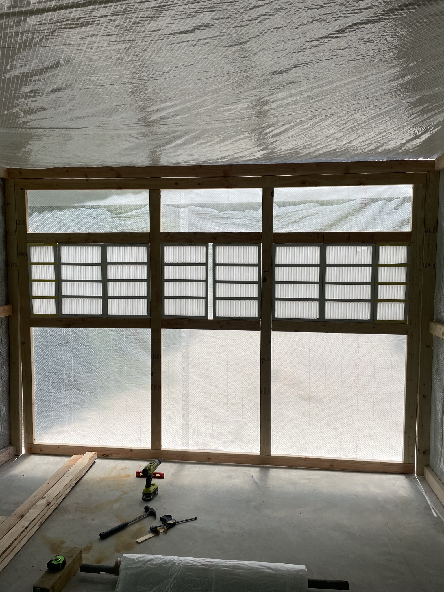

Broke away from sanding for a day to erect a paint booth in the “lean-to” off the side of my shop. It’s 20’x12’, with filters at one end and exhaust fan at the other. It’s all sealed in a heavy gauge reinforced plastic.

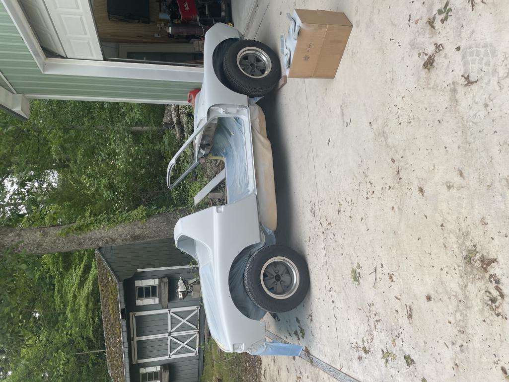

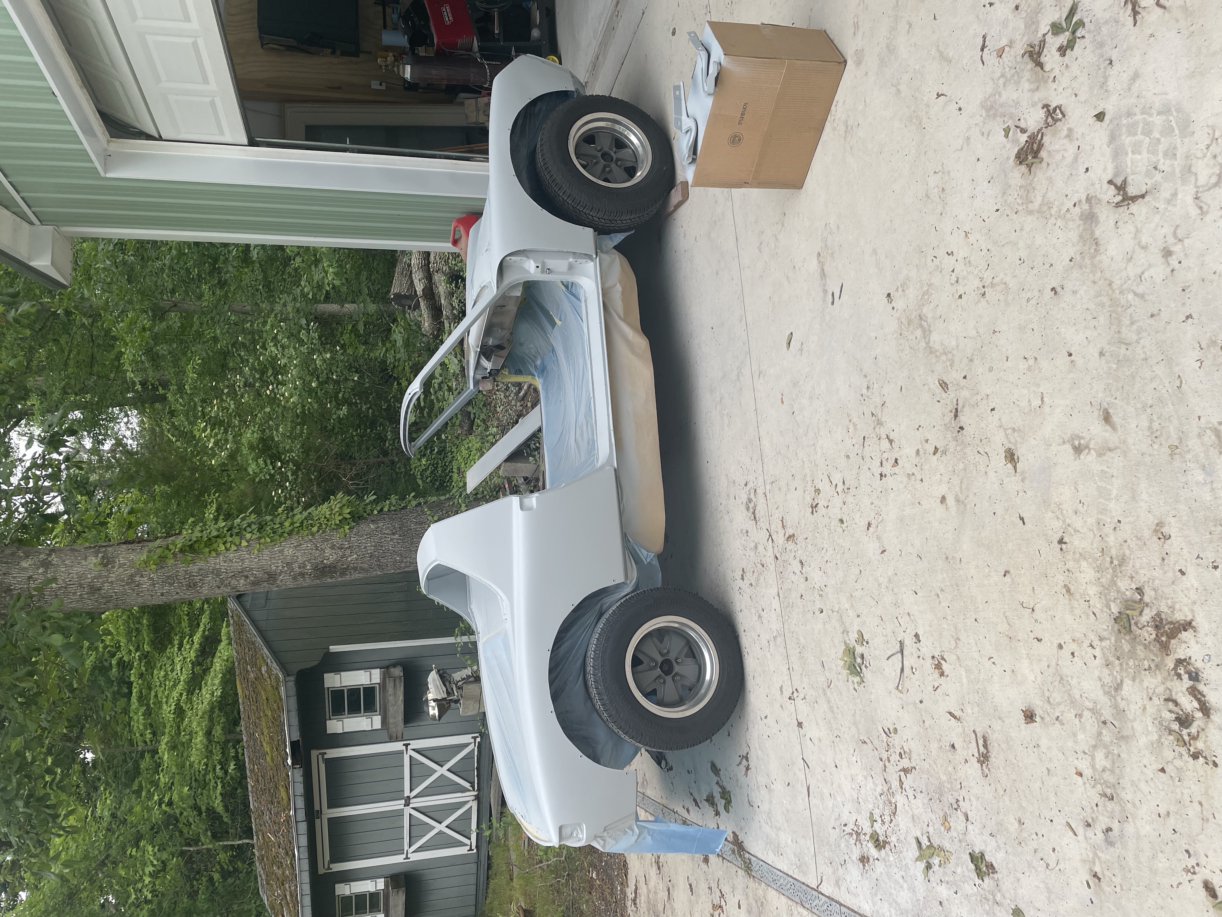

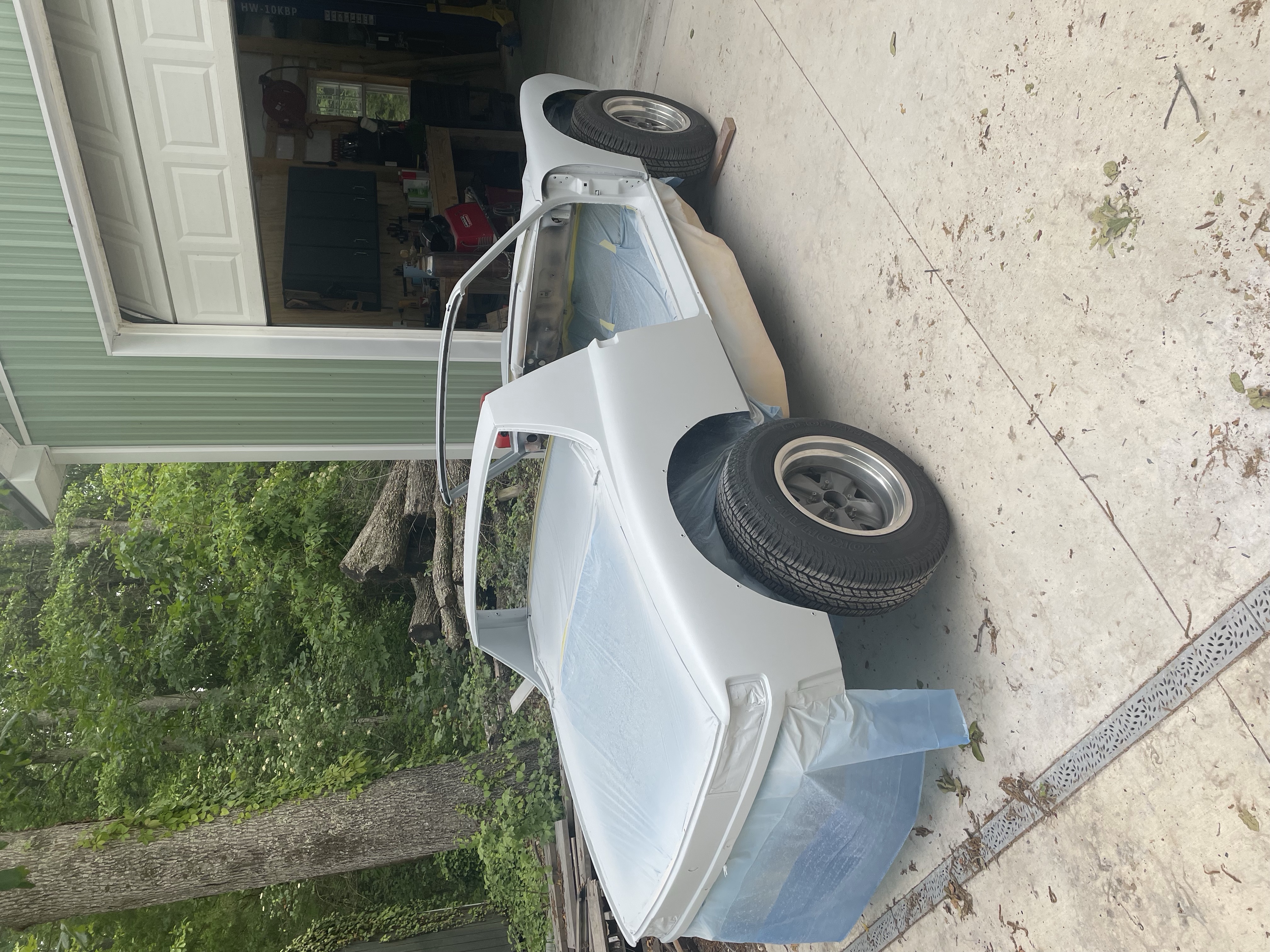

Well, it’s gray…..got it primed today, one step closer to paint…..
East coaster
post Jun 9 2023, 04:53 AM
Post #138
Posts: 1,992
Joined: 28-March 03
From: Millville, NJ
Member No.: 487
Not sure why pic came out sideways……oh well, here’s a different angle. Dang, this one’s sideways too…grrrr!

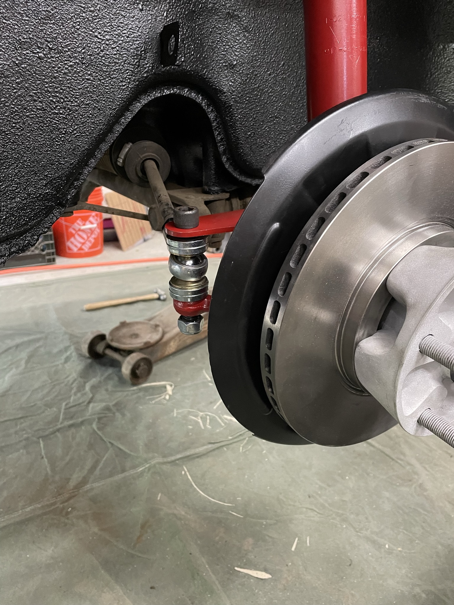

one othe rquestion, did you install a bump steer kit? if so what type/brand?
East coaster
post Jun 14 2023, 05:08 AM
Post #140
Posts: 1,992
Joined: 28-March 03
From: Millville, NJ
Member No.: 487

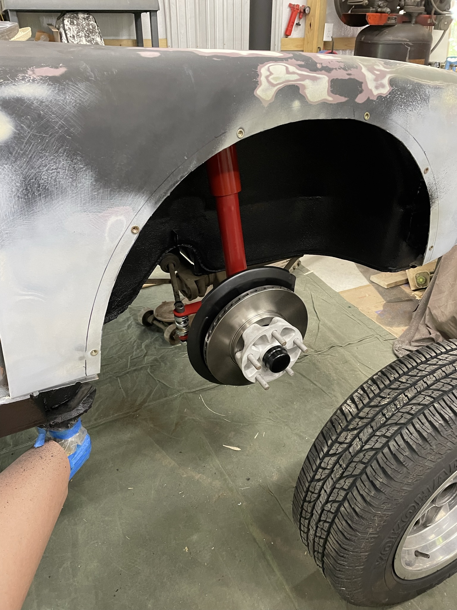

(IMG:style_emoticons/default/beerchug.gif) awesome!!! looking great! Lots of great protection against the elements, good for another 40 years, right??
what is the final color selection?

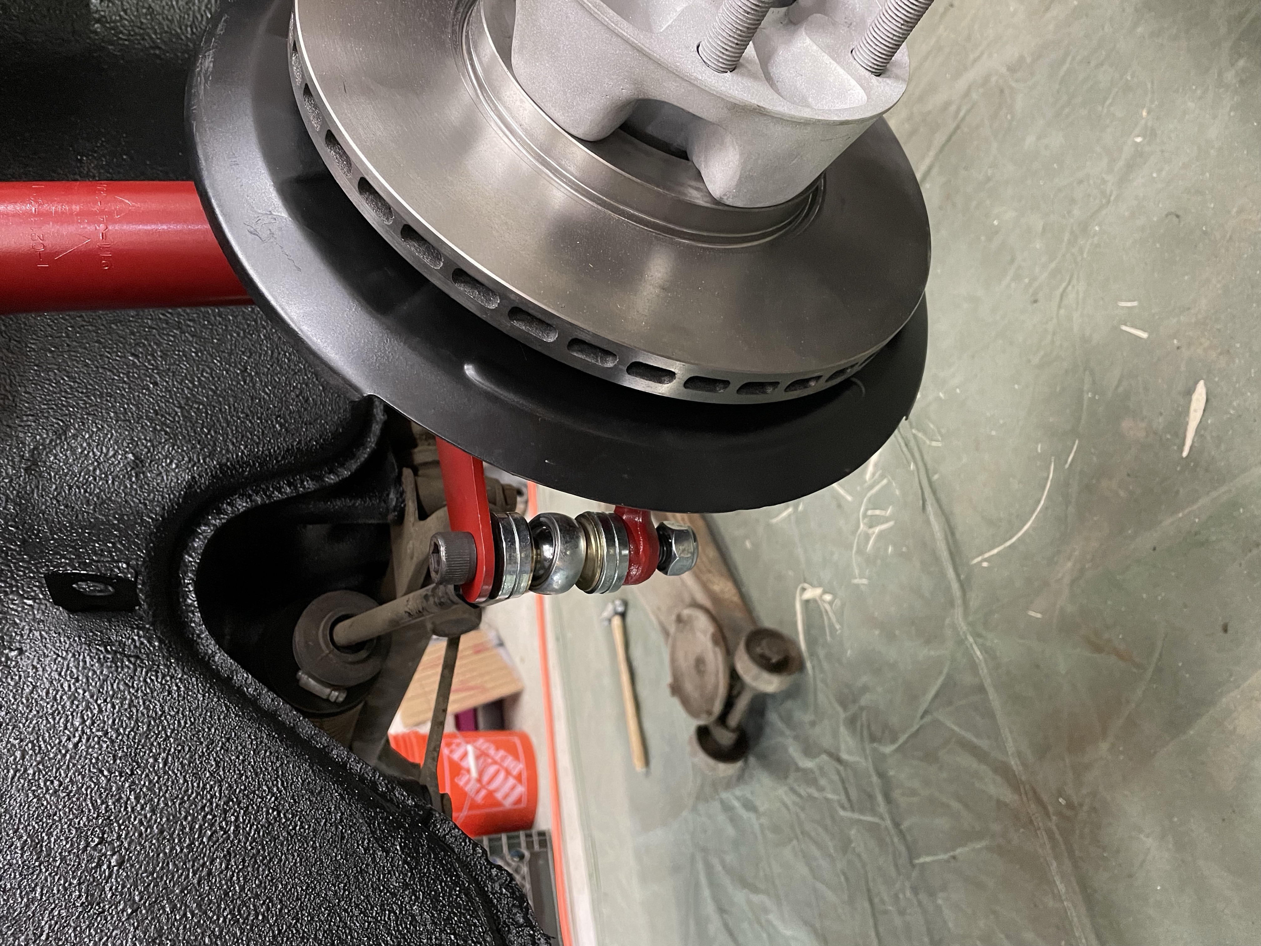

Final color will be Shoreline Beige. It’s a non-stock color but I think it will work well here. I did a full color change, so it’s “factory like” and not too ratty.
As far as bump steer, I modified my struts with a support arm and am using heim joints instead of tie rod ends for the linkage. This lets me set the height f the tie rods, and hopefully eliminates bump steer issues. Here’s a pic of the setup:
