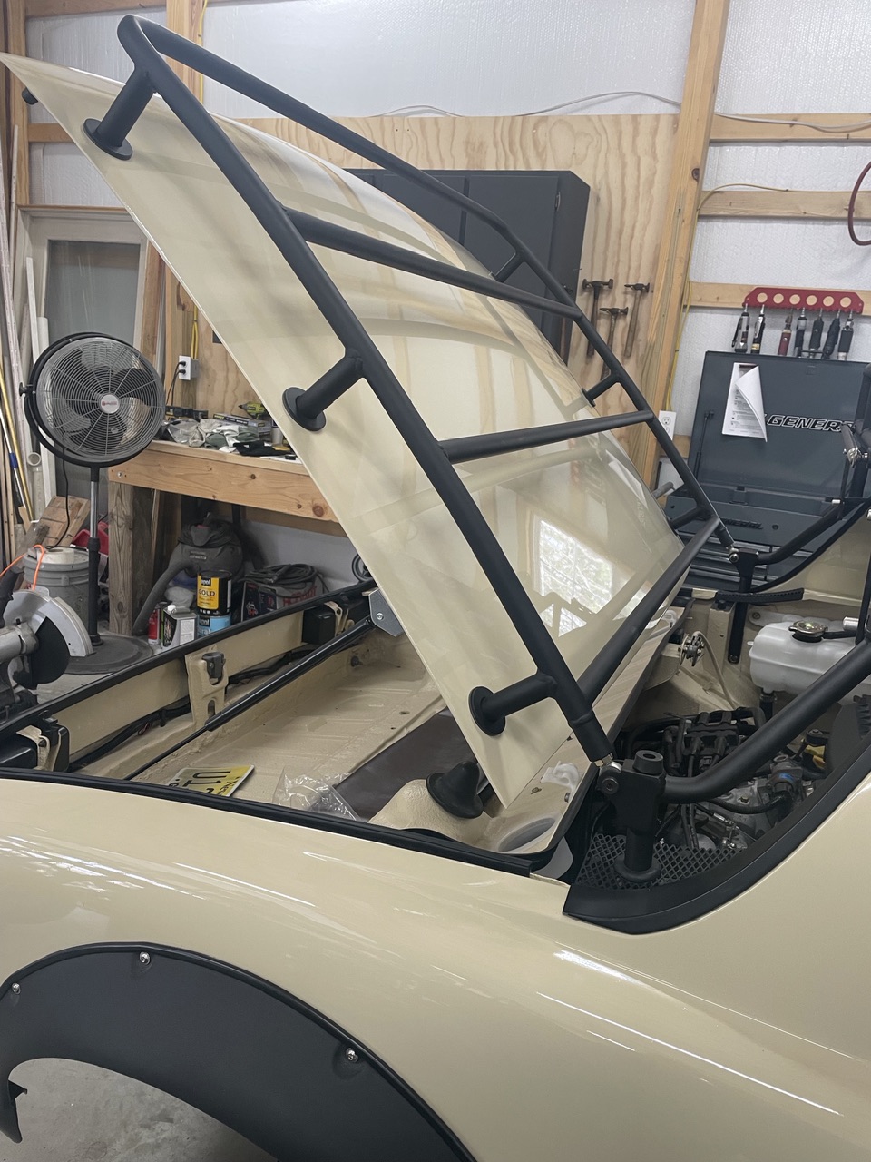

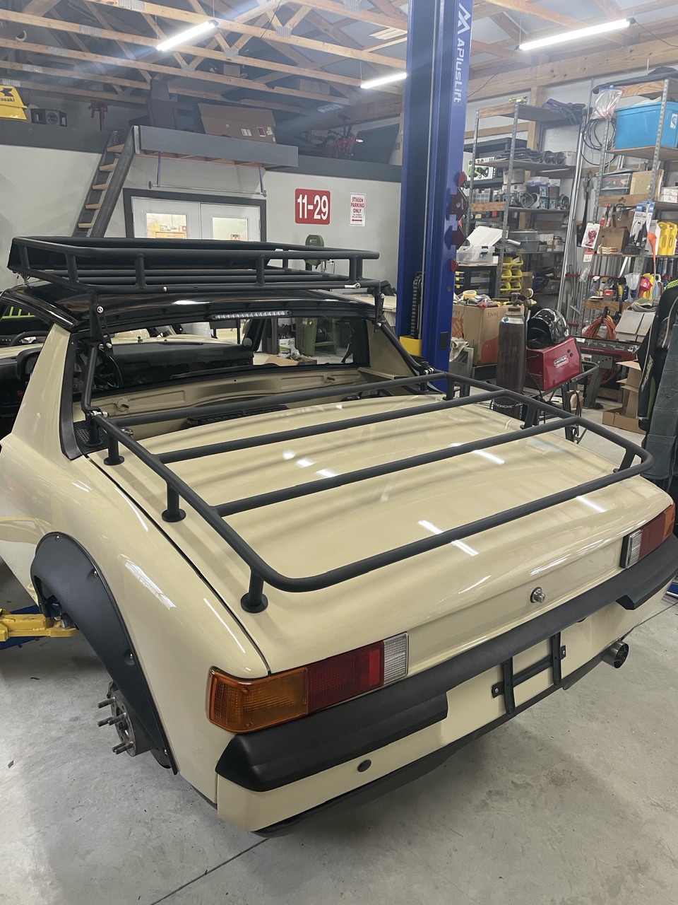

Got the trunk rack painted and mounted it up. This, combined with the roof rack supports, is how my trunk hinges. Trunk is supported by dual gas struts.
It’s so nice to start getting these panels on the car and out of my way in the shop. How I haven’t damaged a panel constantly working around them I’m not sure.
All that’s left is to mount the doors and the car will look complete and I’ll have all my shop real estate back. Unfortunately, I’m not going to mount the doors until all my interior work is done.

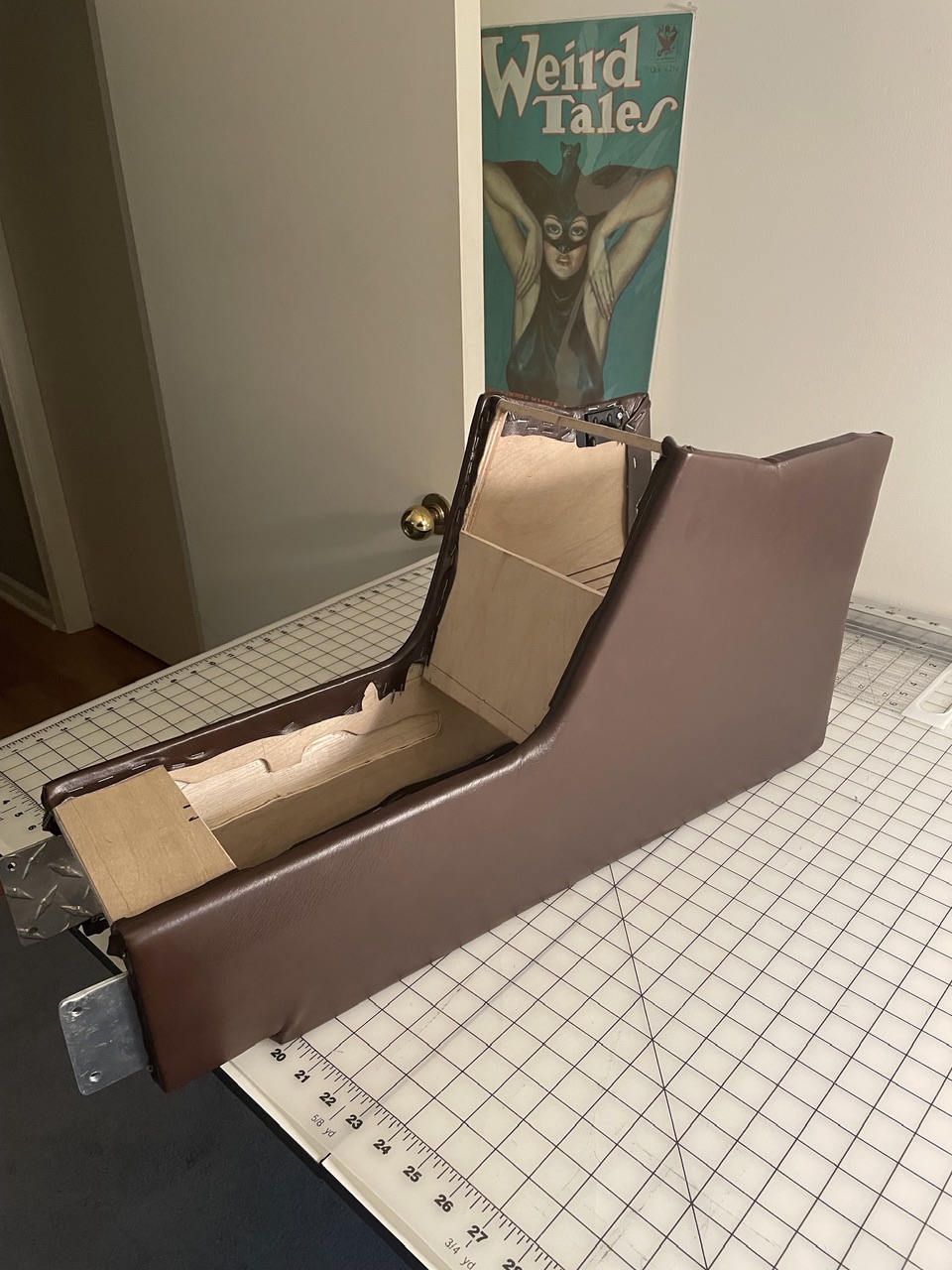

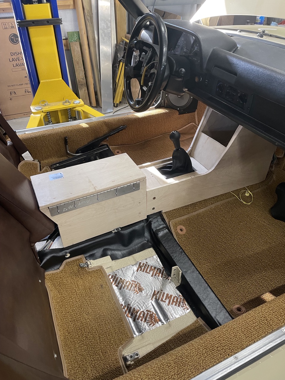

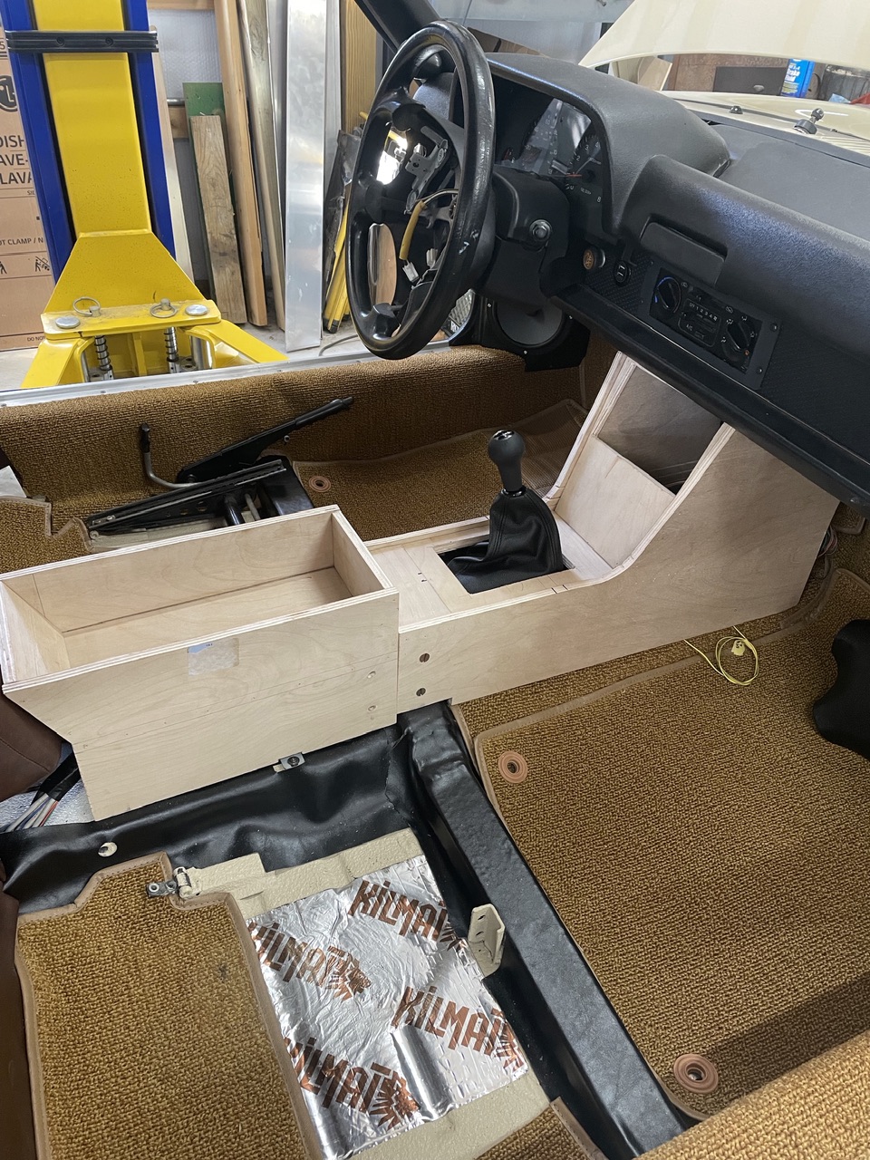

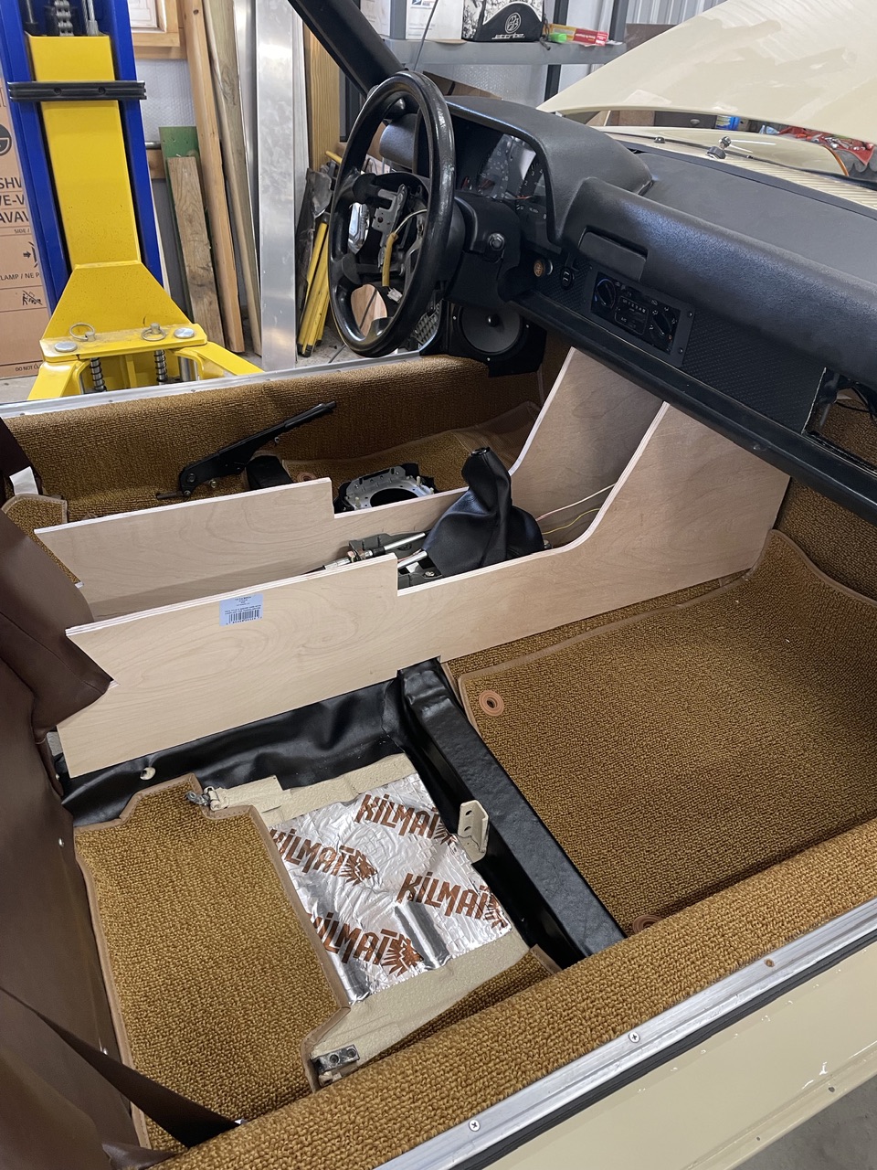

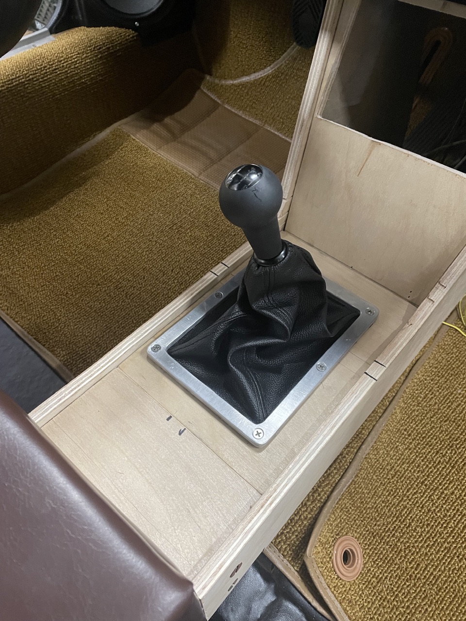

Ok, so I need a center console to conceal my shifter and the wiring harness and ECU. I hate working with wood, but it seemed the best medium for what I’m trying to do, maybe I’ll make another in fiberglass or carbon some day.
I also wanted to put my head unit in the console. This means the console has to flare out at the top to provide enough width for the unit. I’m using birch ply and I scored the backside (3 scores, 1/2” apart) where the it goes up to the dash to allow some flex to get the wedge shape I need. It’s coming along ok and will be ready for upholstery in another day. The rear height is just right for an armrest lined up with shifter, and it provides some good storage. The ECU is under the storage bin/armrest. The lid tilts from left to right and is padded with 1” high density foam (leftover from one of my jetski projects).

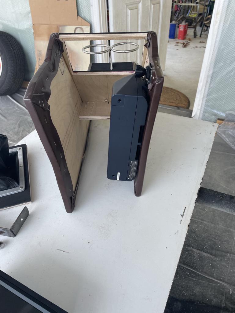

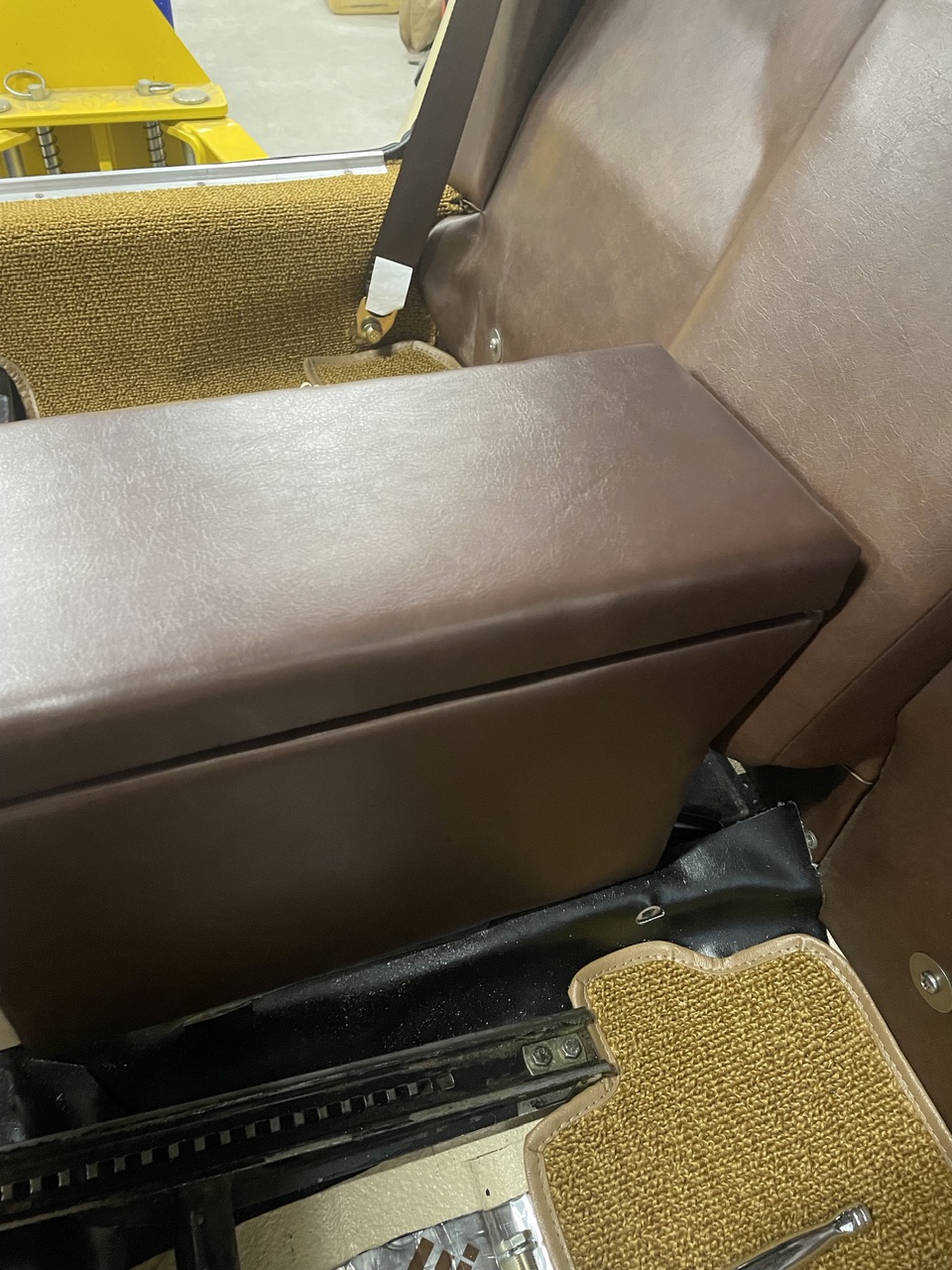

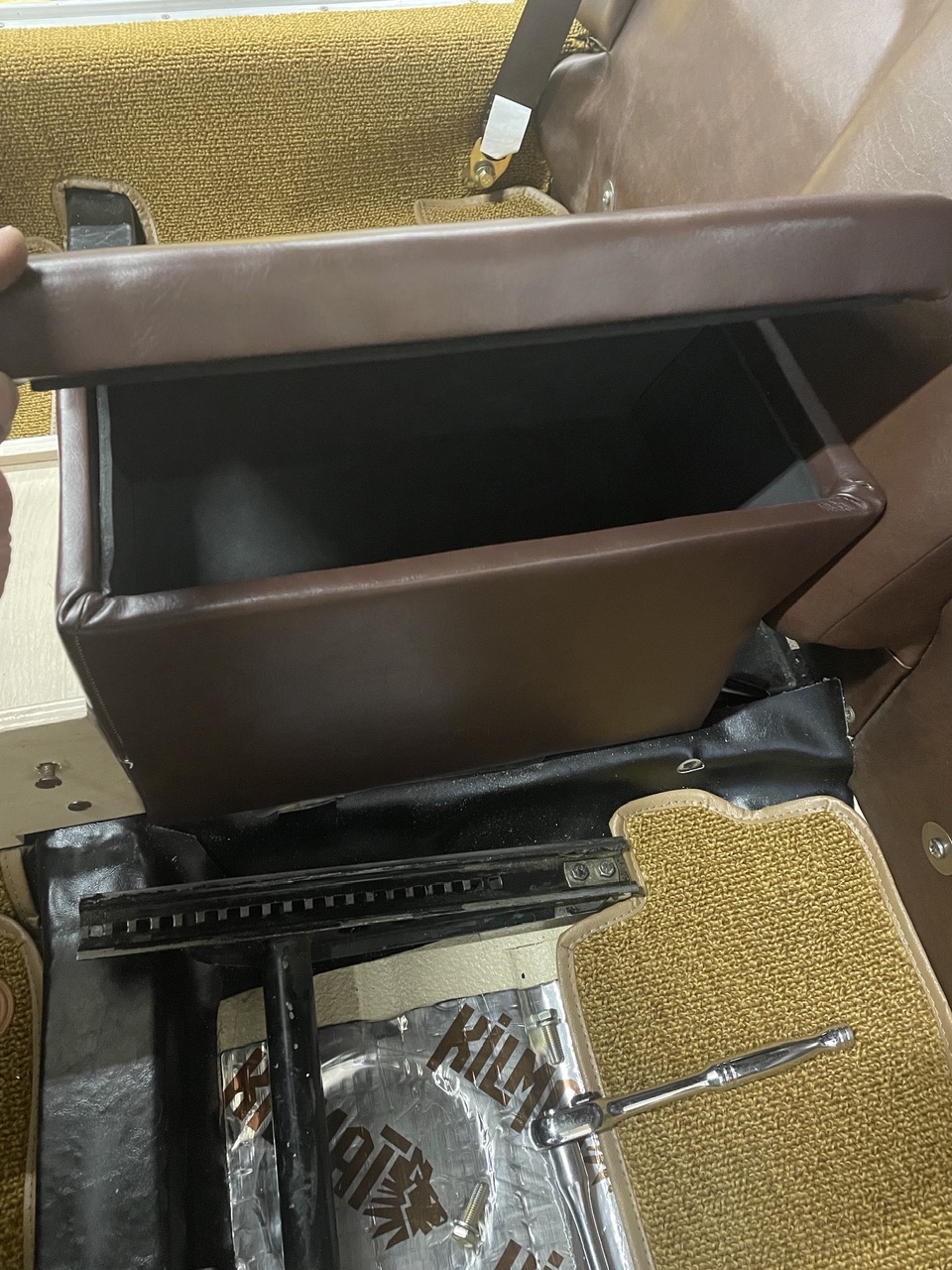

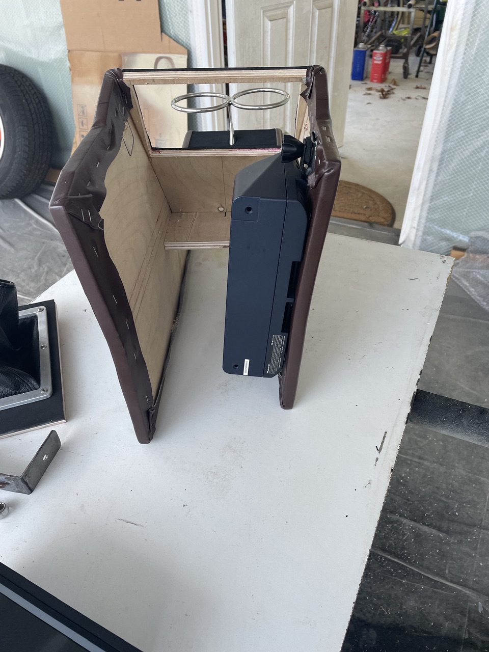

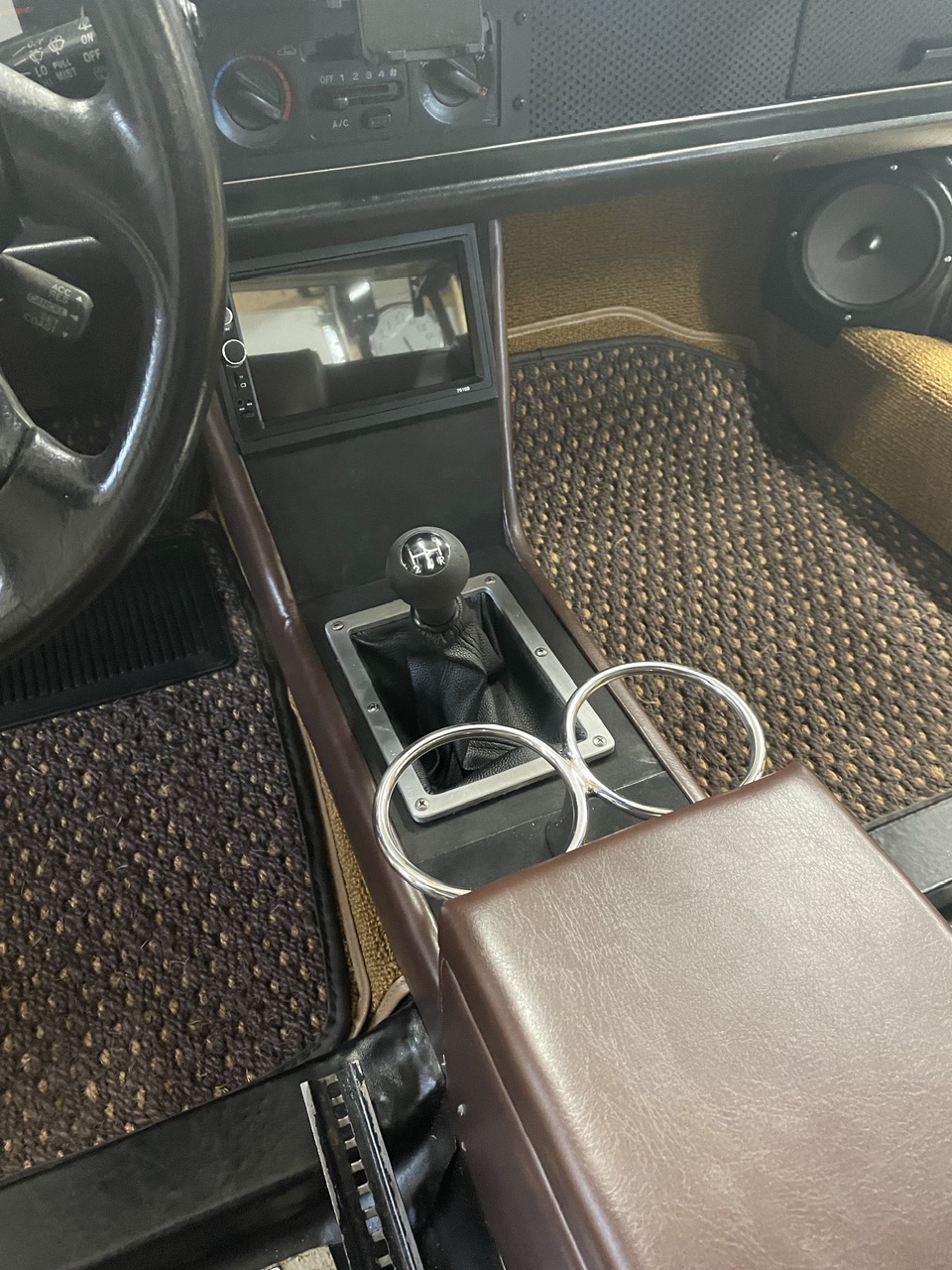

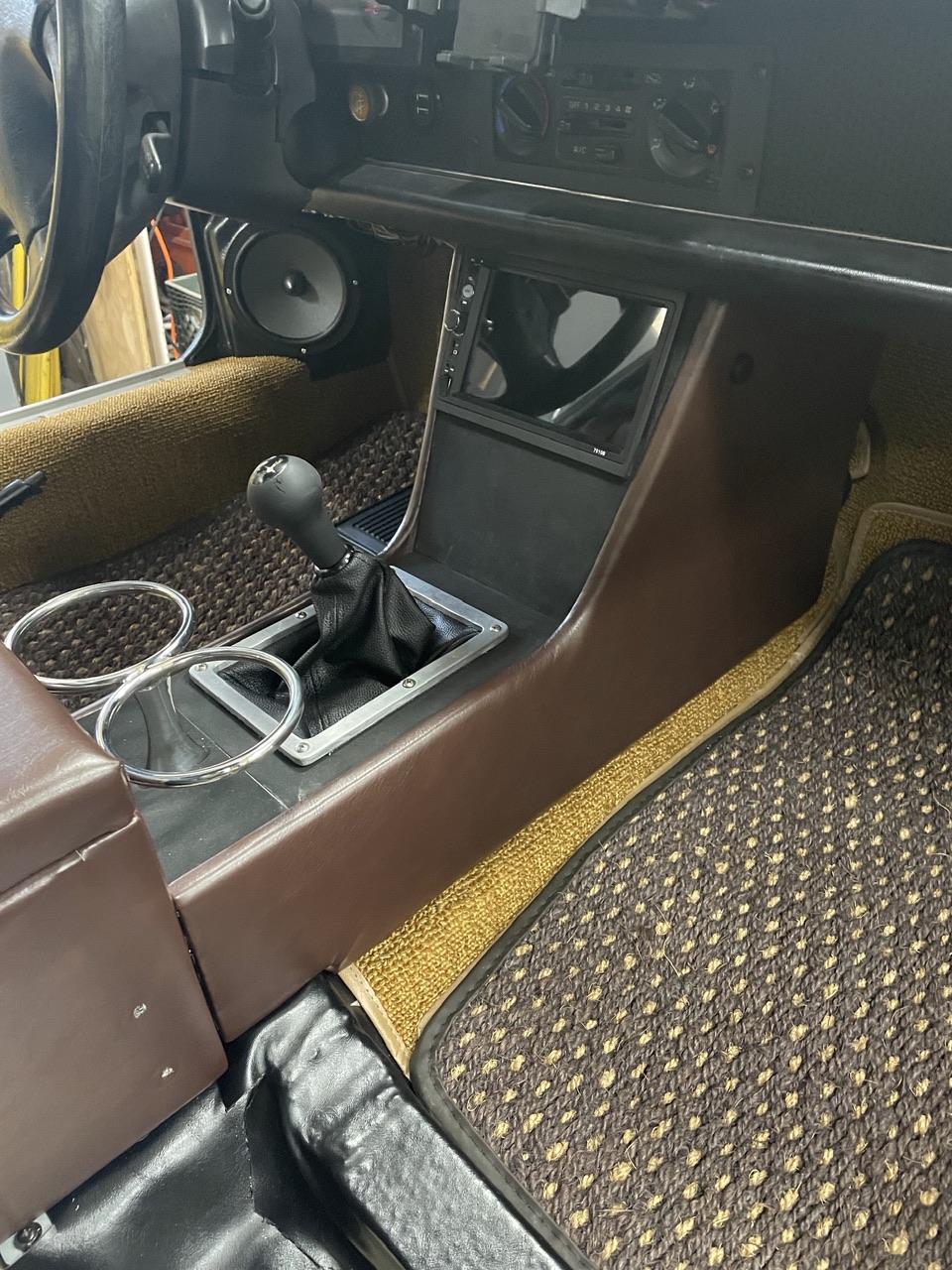

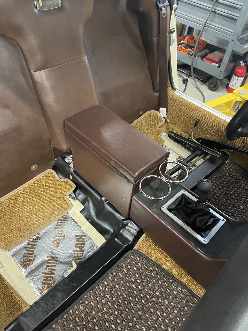

So after way too much time on my console, it’s finally done. I think one of the cool things about projects like this the varied tasks required to complete it. This one took woodworking, sewing, upholstery, and a little metal fab.
Getting everything to fit into the console and still be able to install/remove it was like working a Rubik’s cube. The console houses a subwoofer, head unit, cup holders, and conceals my shifter, ECU, and wire harness. It also provides some decent storage space.

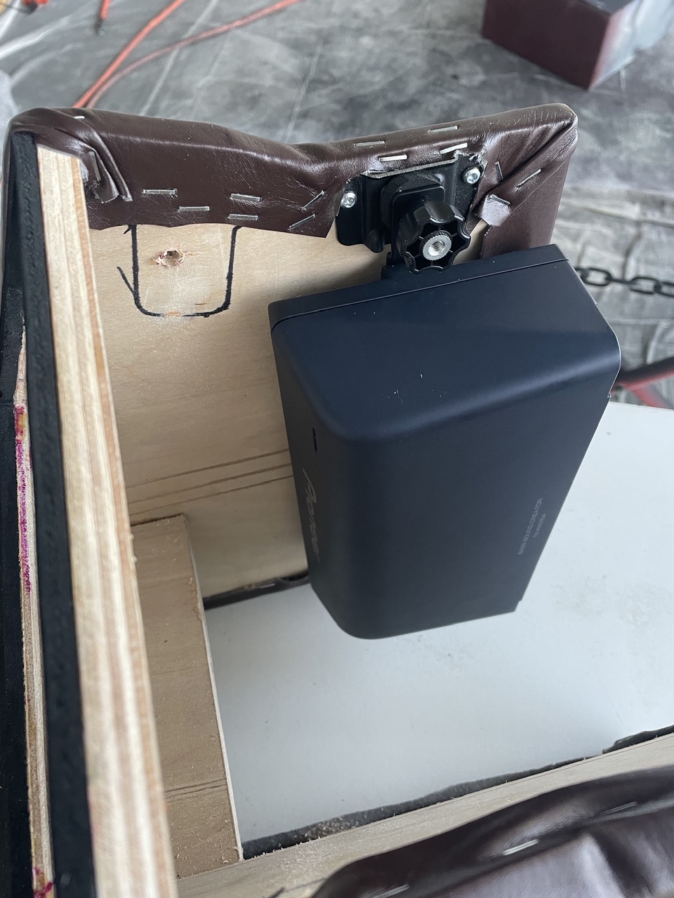

Here’s the Pioneer subwoofer installed. Added cup holders and did the inlay with black hydro turf (jetski padding).

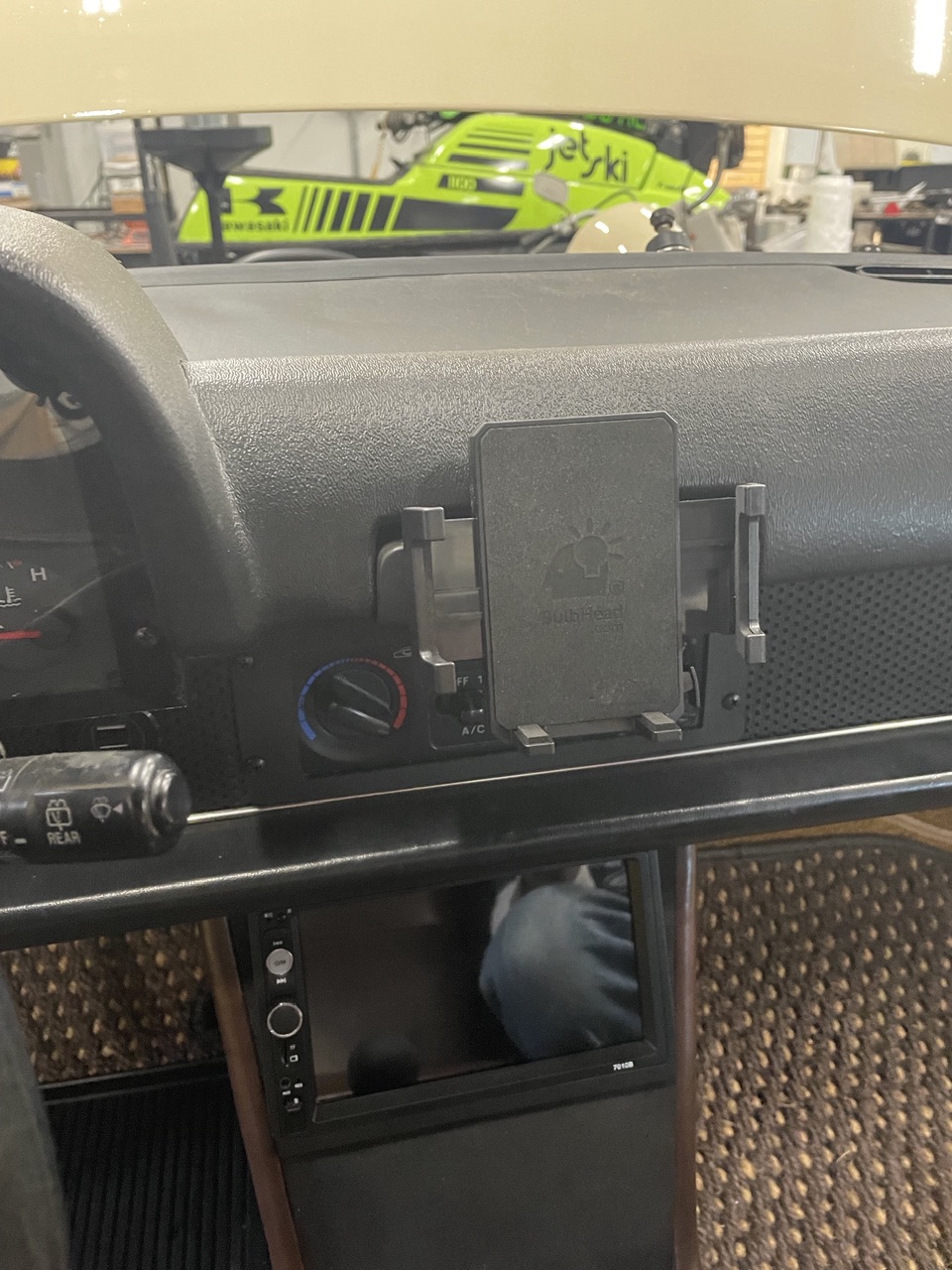

Also made a phone mount out of my ashtray…..

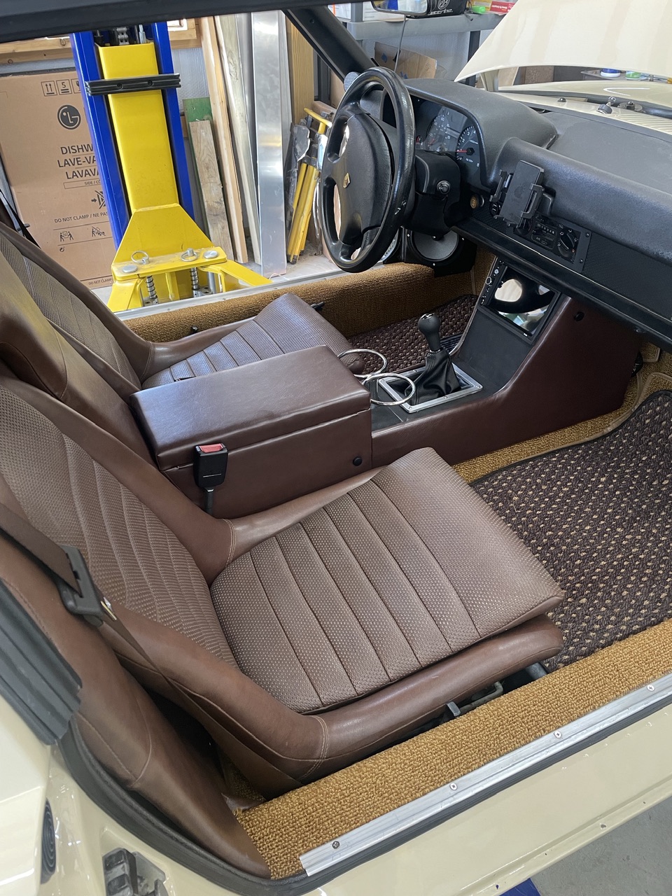

Cup holder is a marine piece. It’s stainless and worked for my setup. I didn’t have room to recess dual cup holders and I really wanted 2 (one for me and one for the Mrs). Seats will be stock. The interior was in nice shape when I bought the car so I’ll be using the stockers.

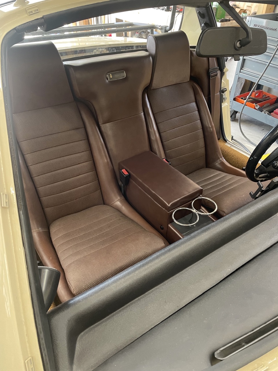

Got the seats in today, it’s starting to look like a car again (IMG:style_emoticons/default/smile.gif)

QUOTE(East coaster @ Mar 12 2024, 05:50 PM) *
(IMG:style_emoticons/default/beerchug.gif) beautiful!! stock brown seats look awesome, i figured since you had a stock back pad in the car that you might be keeping the stock seats, those look like new.
GTS classics has seats that fit into the back pad as well, if you wnated something with more lateral support, which you might need if you start doing some fun off road stuff with this car. (IMG:style_emoticons/default/driving.gif) (IMG:style_emoticons/default/aktion035.gif)

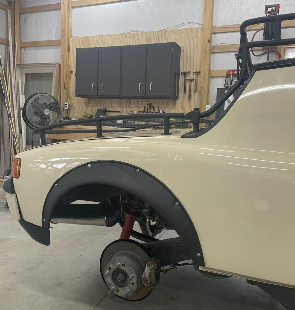

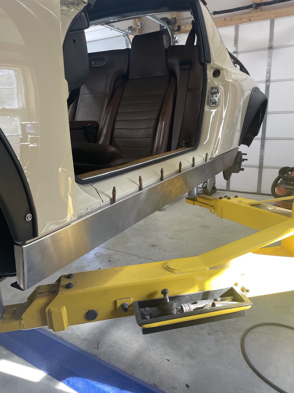

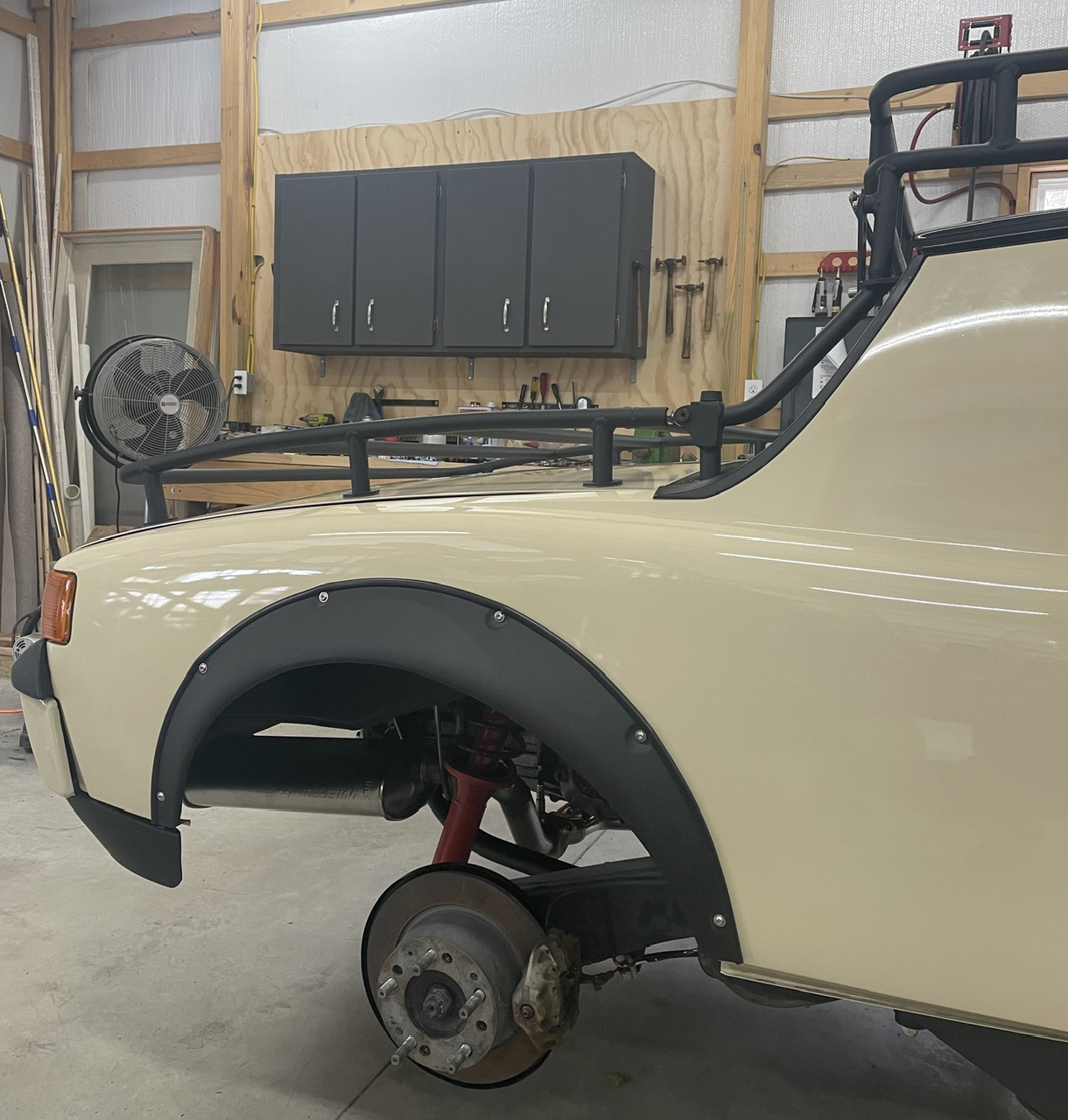

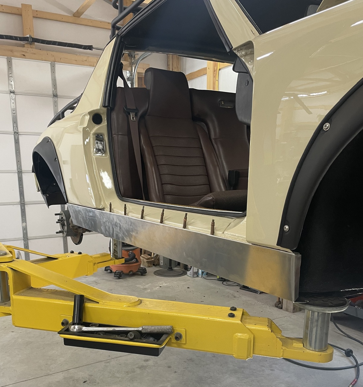

Fitted up the rockers today. They’re an aluminum set I got through someone here in the World. I had to remove 3/4” from each end and reform the lips to account for the larger wheel openings. Just need to get them painted now and they can go on for real.
