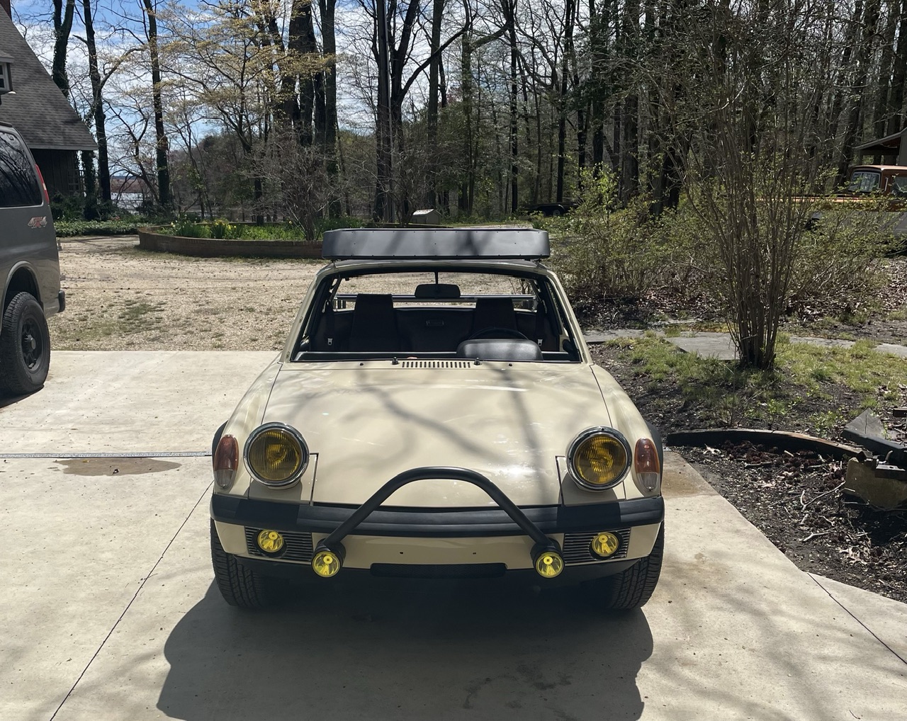

Got my wheels painted today (Phoenix red L21E), now I can get the car back on its feet and get a test drive as soon as I bleed brakes and clutch (I hate things I can’t do myself!)

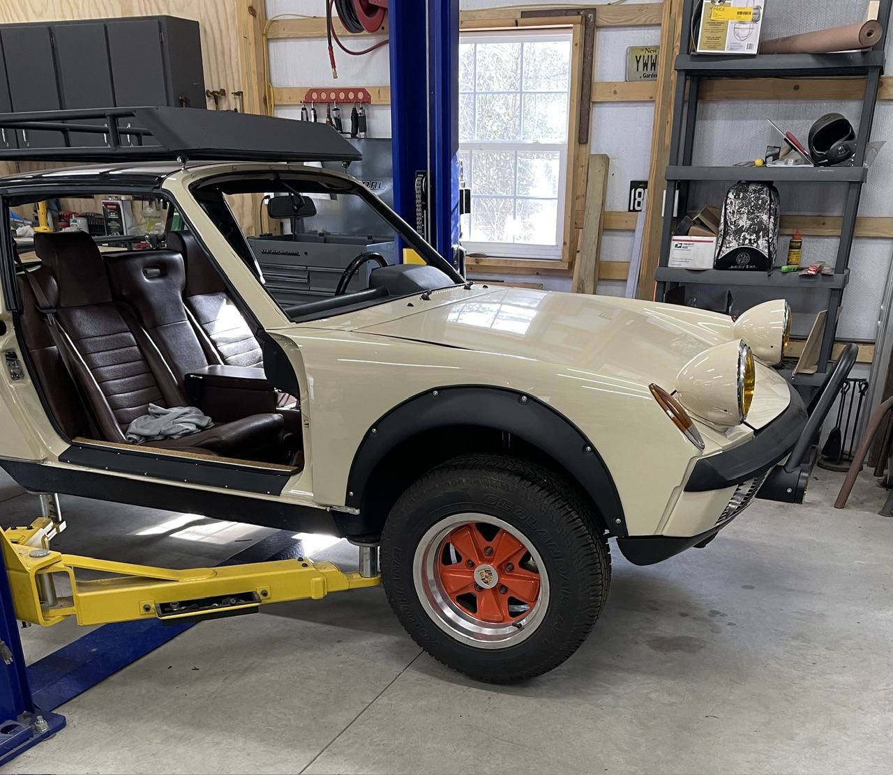

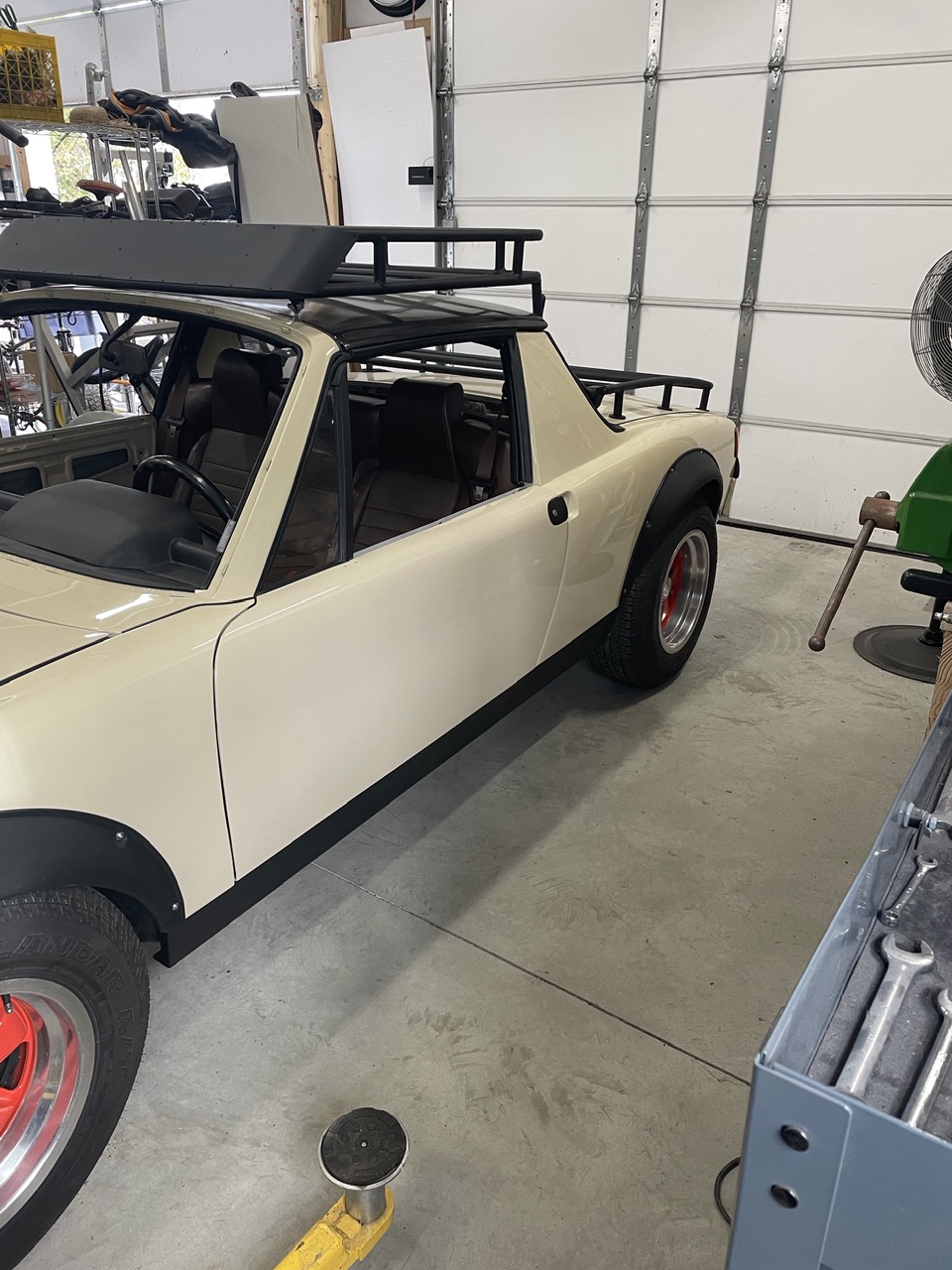

One door mounted, one to go…..

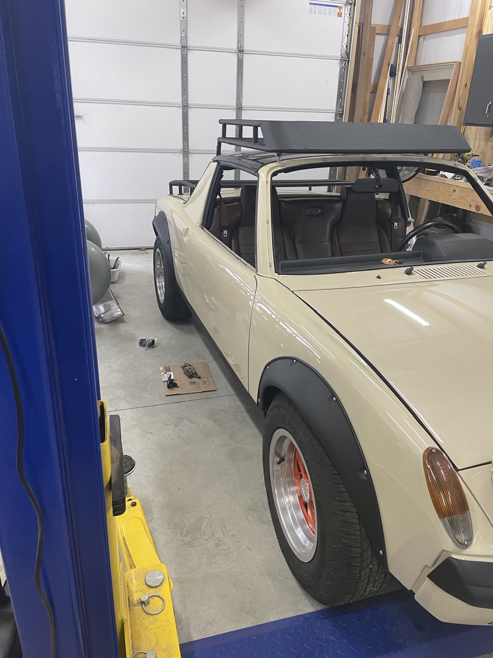

It got to see the light of day before I installed the drivers door today. It hasn’t been on its wheels or out of the shop for a while now and it was good to see it out in the sun!
On the downside, looking at the pics makes me realize I need to layoff the project for a few days and clean up the yard around the shop. I thought when I retired I’d have all this free time….huh!
Drivers door installed…..

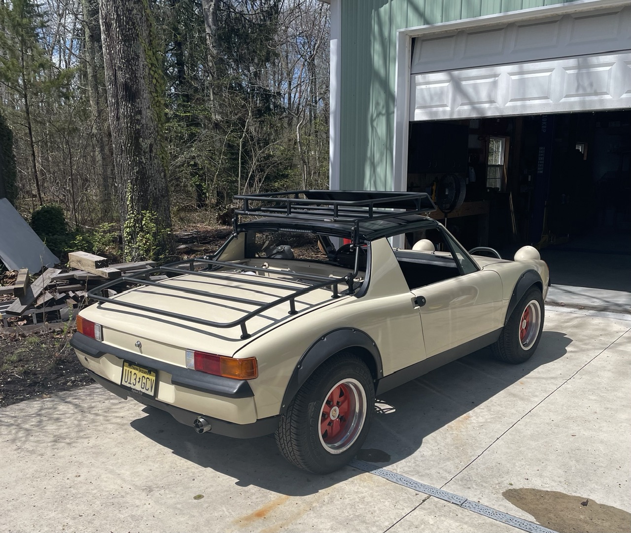

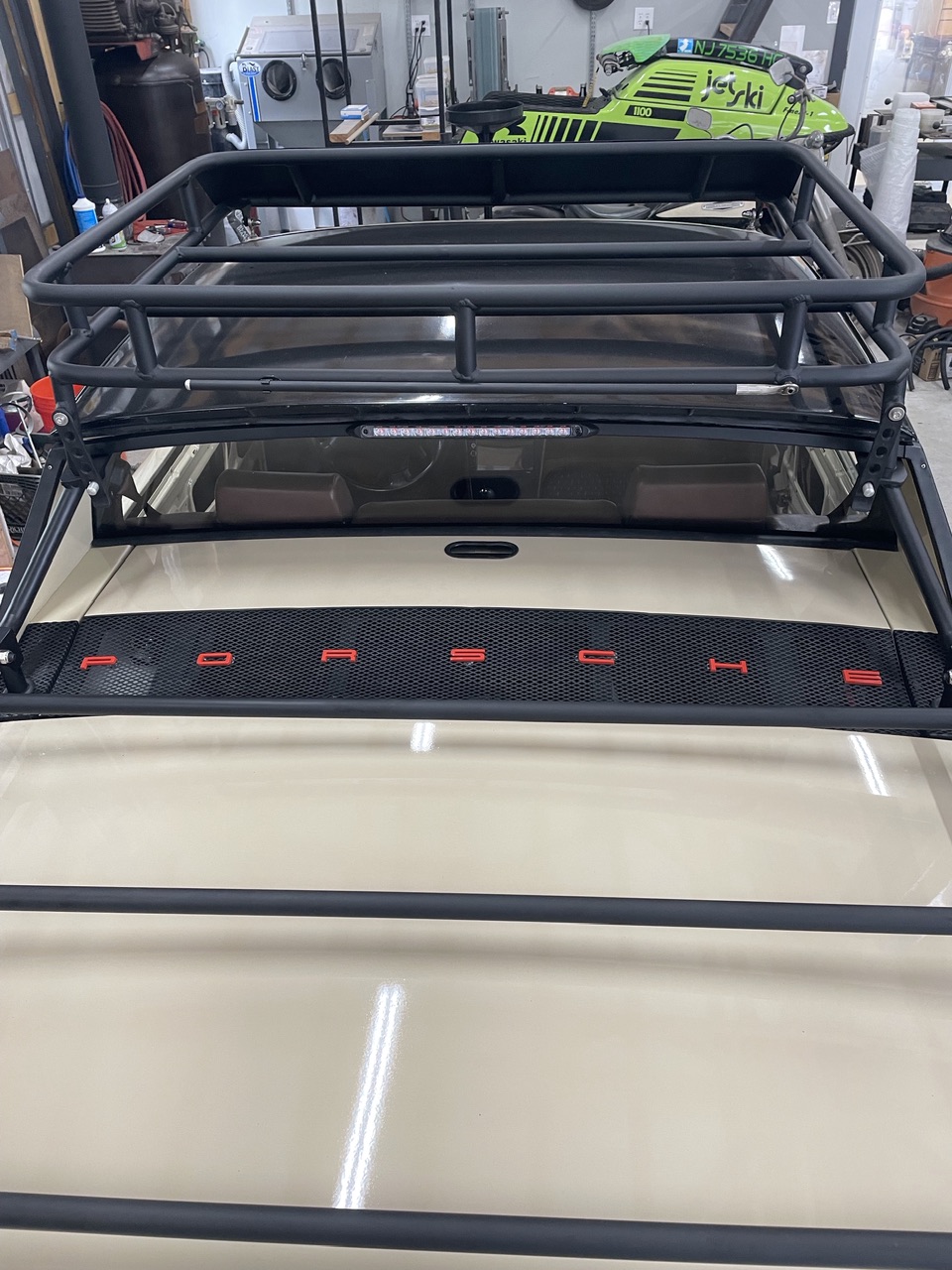

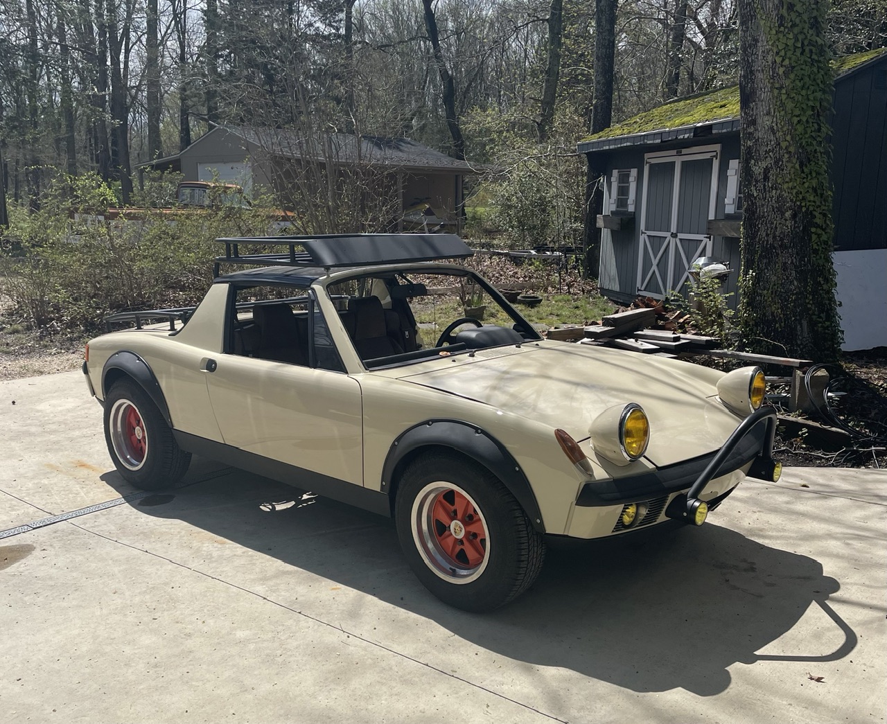

Finalized the engine cover install. Decided to do the letters to match the wheels since gold just didn’t seem to work with everything else. As a refresh, the cover doesn’t have hinges, it slides onto pins on the firewall and still uses the stock latch at the rear.

I love how those wheels and tires look on this Safari build with those "restrained" black fender flares. That's how fender flares should look on a 914 to fully expose the front and rear wheels and tires, at least in my opinion.

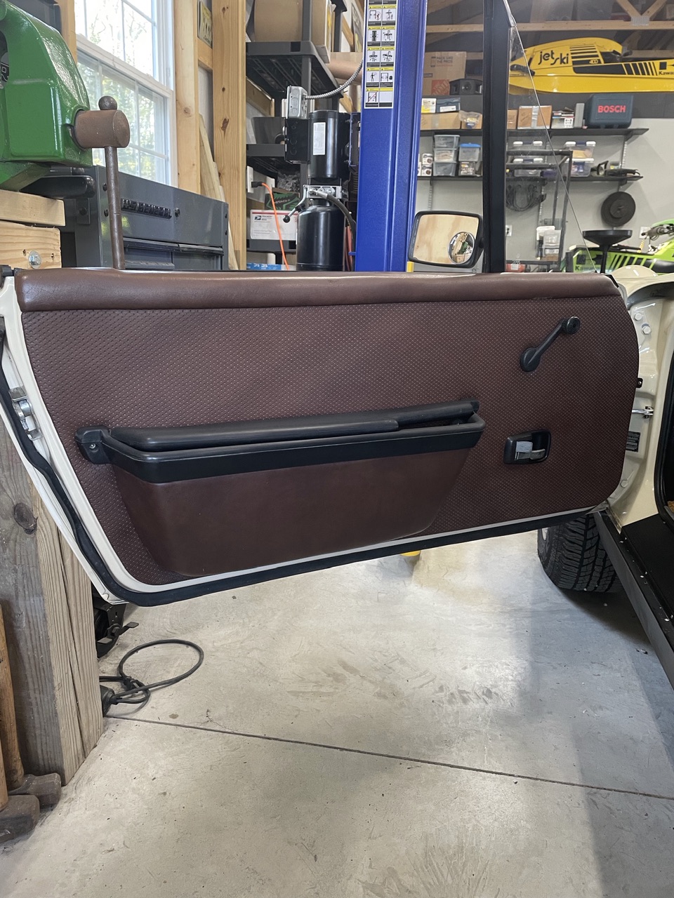

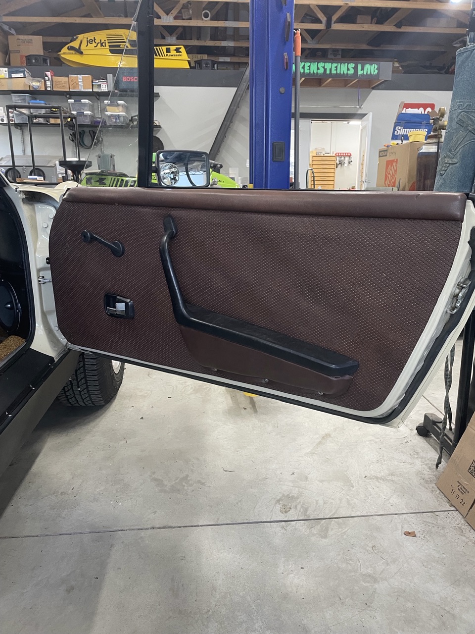

While contemplating next steps with my clutch, I decided to wrap up my door installation. It’s always fun wrangling in the windows, regulators, weatherstripping into the doors. Windows are working nicely and fitting fairly well (do they ever fit exactly?.) Also installed new vapor barriers and the door panels…….I’m calling the doors done.

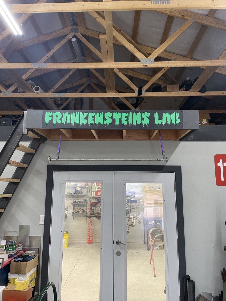

Oh…..and a new addition to my shop

I am so, so, SO envious of your shop! (IMG:style_emoticons/default/pray.gif) I also love the Frankenstein theme (IMG:style_emoticons/default/smilie_pokal.gif)
