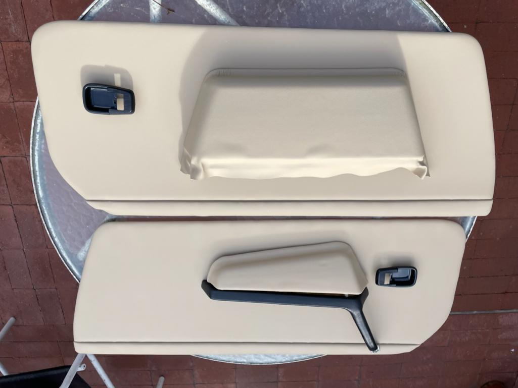

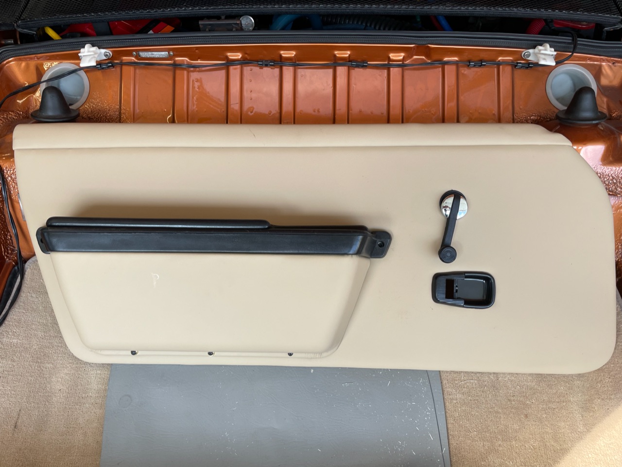

Just got these today. Really nice looking and matched the beige leather seatsI have a little finish up work to do and have a couple of questions:
1. PSsenger side looks straight forward; need to locate a cover for the handle
2. Driver side, got the cubby, but forgot how it gets attached to the panel
Suggestions will be appreciated

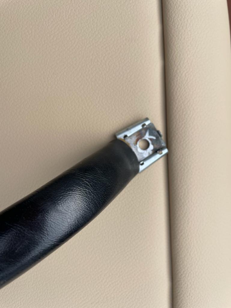

Need one of these covers

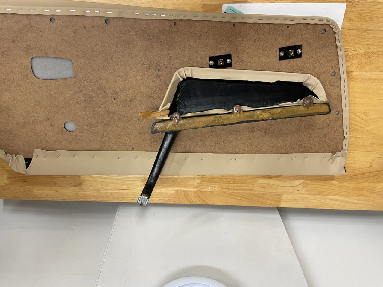

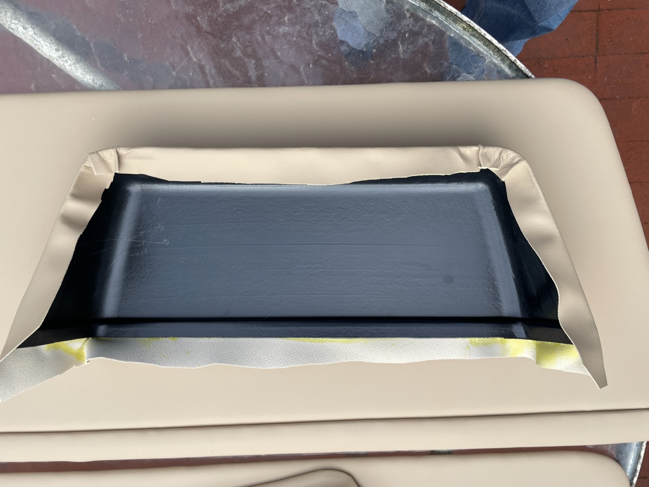

Need to know how this gets attached to the door panel
I’m going to trim and glue the edges; not a problem

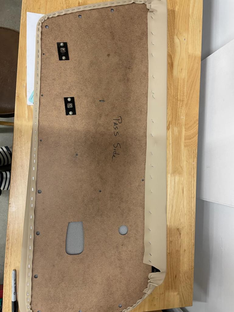

It should have small screw holes to screw it into the door card. Door card should have small metal inserts. The screws set into a little recessed trim washer
Show us a pic of the back of the door card.

QUOTE(mepstein @ Nov 7 2022, 02:19 PM) *
QUOTE(jim_hoyland @ Nov 7 2022, 04:57 PM) *
This is passenger side

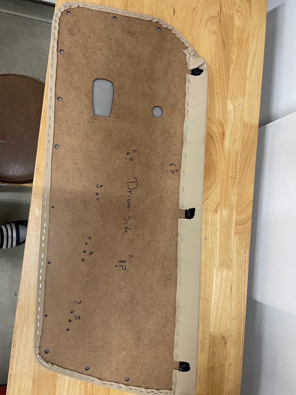

This is the driver side, I’m not sure what the numbered holes are for, need help here:
sportlicherFahrer
post Nov 7 2022, 06:12 PM
Nothing to see here.
Posts: 1,124
Joined: 18-April 05
From: Tacoma, WA
Member No.: 3,945
Holes in the backside if the driver's panel don't look like they are right for the factory map pocket to mount up. More like mirrored holes from the passenger side panel, or maybe a passenger side panel that got built to the wrong side? Perhaps @Mikey914 has some clues? Look beautiful otherwise!
Steve
post Nov 7 2022, 06:14 PM
Posts: 6,025
Joined: 14-June 03
From: Laguna Niguel, CA
Member No.: 822
Looks right to me. The three small holes are for sheet metal screws that hold the door pocket. The large holes are for the panel clips.
Mikey914
post Nov 7 2022, 09:31 PM
The rubber man
Posts: 12,772
Joined: 27-December 04
From: Hillsboro, OR
Member No.: 3,348
The holes 3, 4 and 5 are for the passenger lower secton of the htop habdle section.
You can see this on the passenger side. The 4 and 5 holes have an additional 2 holes that allow mounting of the 2 plates that hold the cage nuts.
We cut the panels the same so they can be used either left or right.
I predrilled the holes on the drivers pocket. They will line up nicely with the panel and screw holes in the door.
Hope this helps.
Mark

QUOTE(jim_hoyland @ Nov 7 2022, 01:57 PM) *
Your missing the top rubber piece.

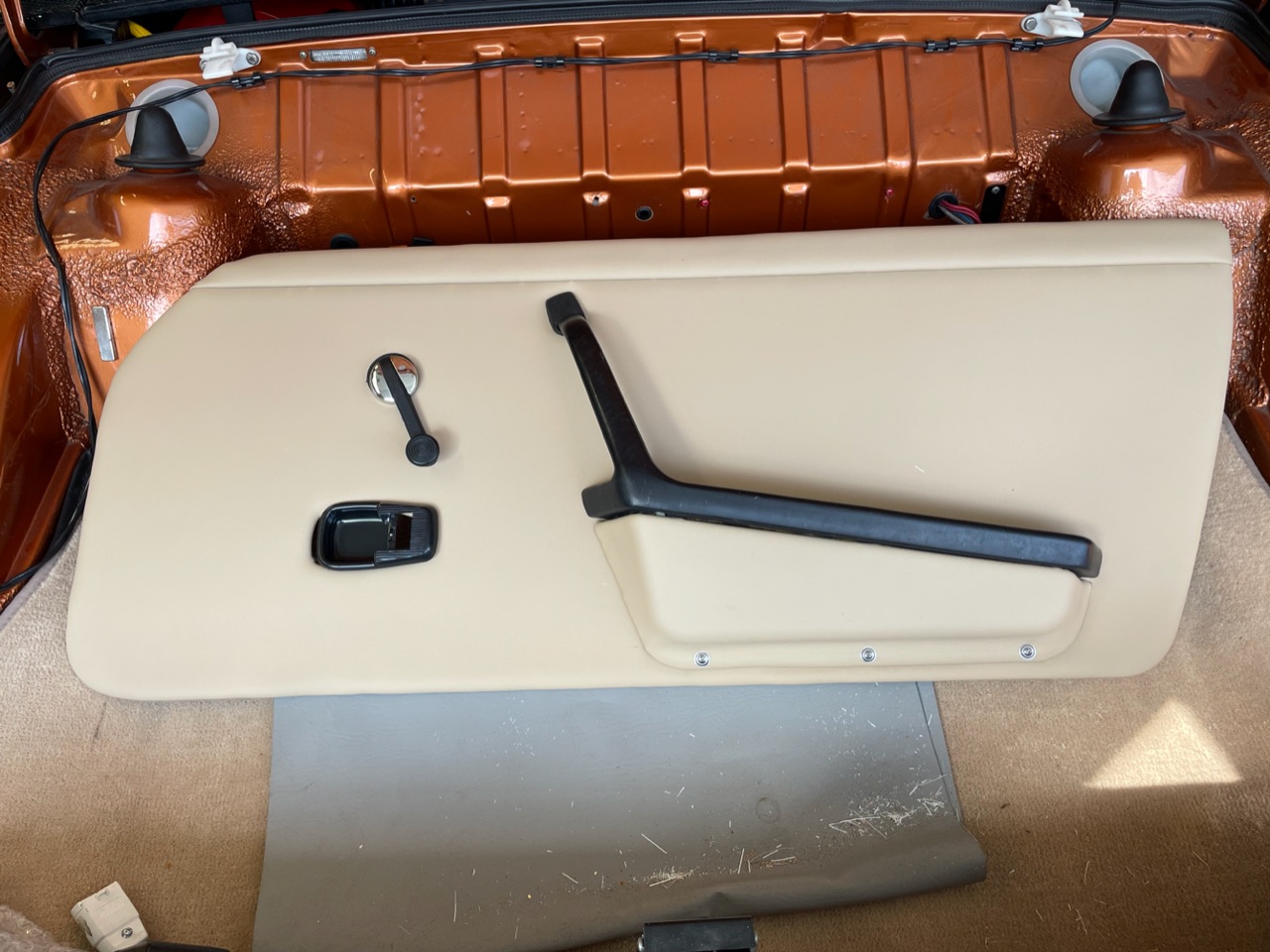

The door panels are all but installed and they look great !
Mike Kinne came through with a box of small and large parts as well as 914Werks. Thanks to both World members.
