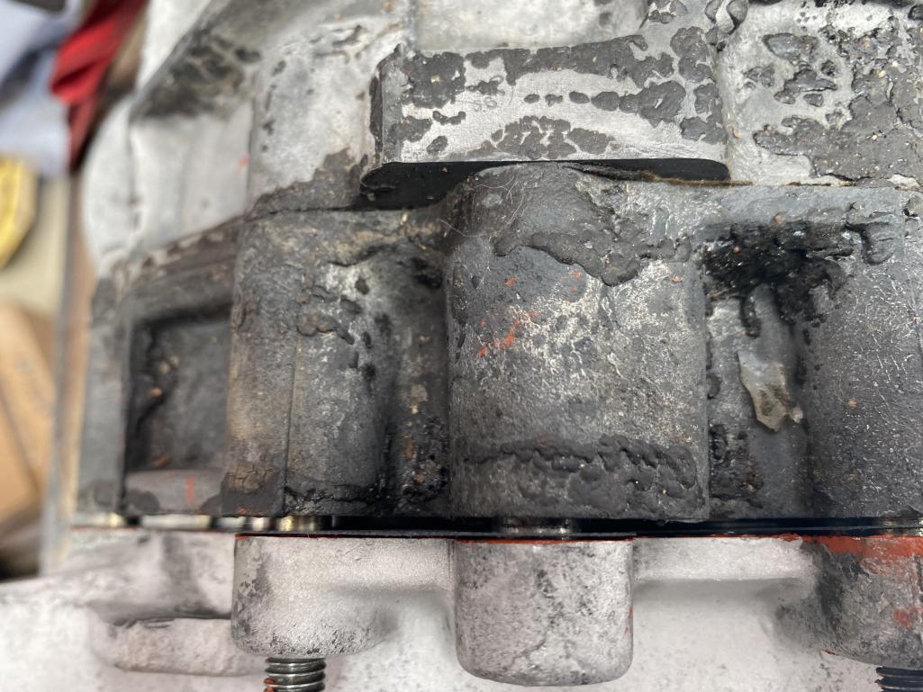

hi, working on a 1975 914 1,8 5spd.
so; i'm replacing the rear cover for the transmission. its the cover that the speedo drive is located in. i have it on but, i can't seem to get it to go on all the way. it is setting about 1/8" from seating all thew. i don't want to tighten the nuts until i can find out if this is normal or is there something i've missed or have out of alingment. any suggestions would be great! thanks. ive enclosed a pic |
doobie123 trans cover Nov 28 2022, 12:51 PM
mepstein Nope. It has to completely close the gap. There... Nov 28 2022, 12:57 PM
doobie123
Nope. It has to completely close the gap. There... Dec 2 2022, 11:37 AM
porschetub
Nope. It has to completely close the gap. There... Dec 2 2022, 08:06 PM
rbzymek The reverse gear set (the loose bits) has a spacer... Dec 2 2022, 08:41 PM
doobie123
The reverse gear set (the loose bits) has a space... Dec 3 2022, 09:53 AM
doobie123
[quote name='rbzymek' post='3042586' date='Dec 2 ... Dec 3 2022, 01:28 PM
doobie123
[quote name='doobie123' post='3042708' date='Dec ... Dec 3 2022, 01:29 PM
r_towle I might suggest a dry fit with no gasket.
It shoul... Dec 4 2022, 05:22 AM
doobie123 thanks for all the comments so far.
here is what ... Dec 5 2022, 09:49 AM
ejm Looks like the bushing from the old cover is stuck... Dec 5 2022, 12:06 PM
mb911 The RTV pictured is frowned upon. The gasket helps... Dec 5 2022, 12:43 PM
Dave_Darling The pinion depth is set by the gaskets between the... Dec 6 2022, 04:20 AM
