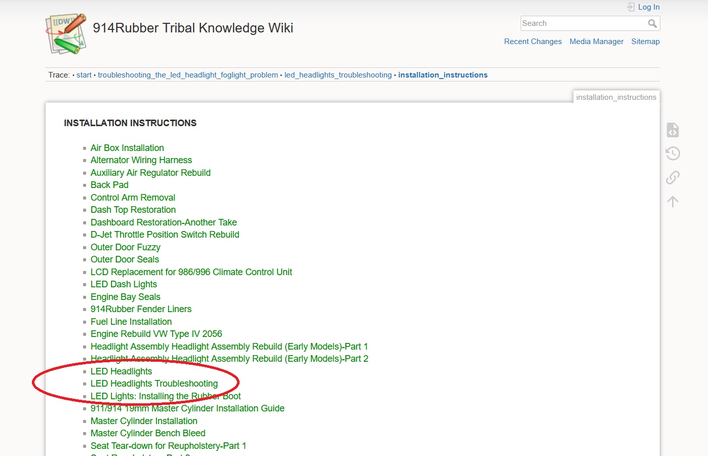

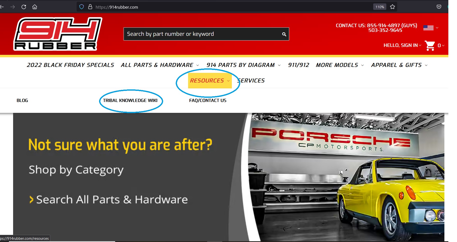

Mikey914
post Nov 30 2022, 01:41 PM
The rubber man
Posts: 12,772
Joined: 27-December 04
From: Hillsboro, OR
Member No.: 3,348
We actually have a few threads on our WIKI page to help understand and help out on this and other installation questions.
It's kind of hidden buy you can access from our home page nav bar.
Hope this helps

QUOTE(Mikey914 @ Nov 30 2022, 11:41 AM) *
Hope this helps
That's great, the gal on the phone when I called didn't suggest that.
