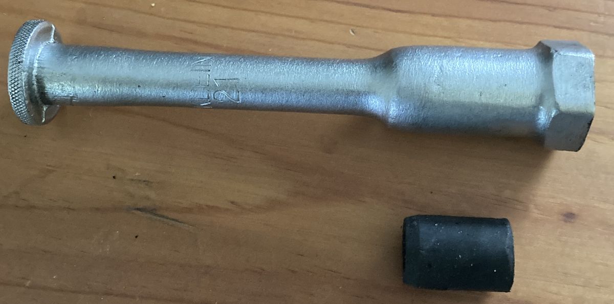

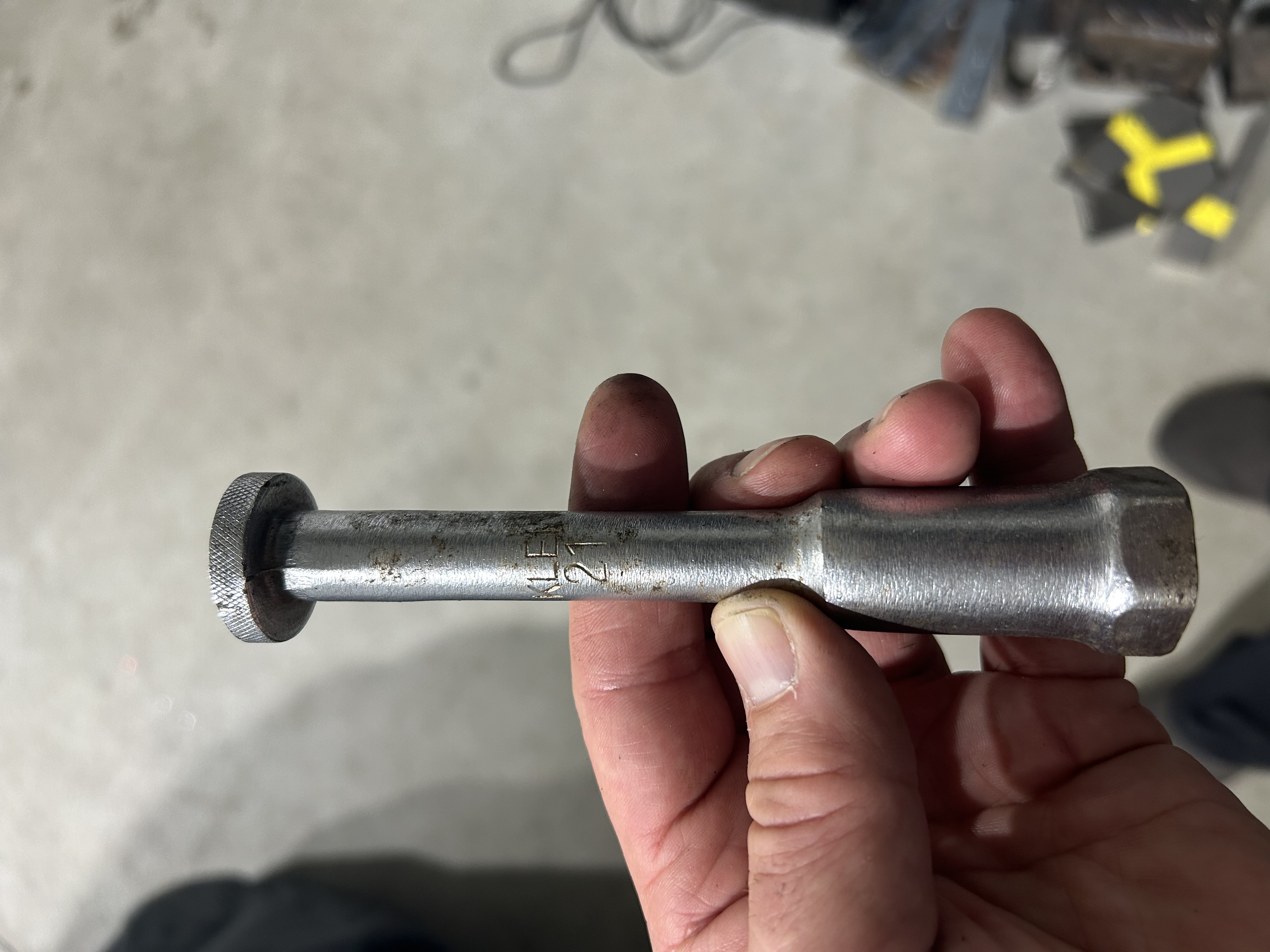

This is a spark plug tool from a 911 -914-6 tool kit. It’s missing the rubber insert. Anyone know where to source the insert? Attached Image

Do you need the 'official' insert? Mine has a slightly different spark plug tool, not sure where it is from. But I think it is more of a sponge rubber type.
Maybe buy a cheap plug socket from your FLAPs and take the insert out?

not necessarily need the official one just don't know exact specs so I can make one or source one.

I usually just chop a piece of the boot off an old spark plug wire and shove it in there (hard boots obviously don't work)

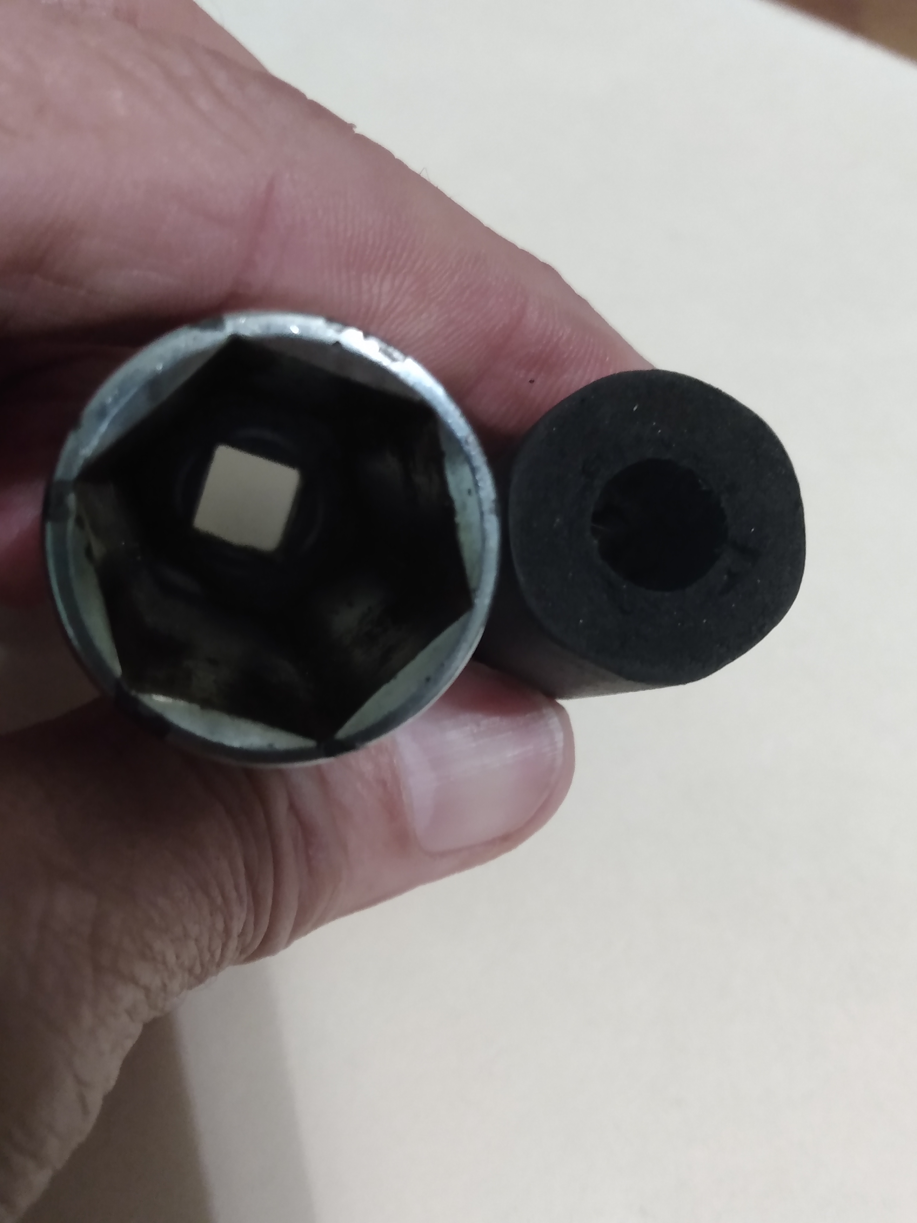

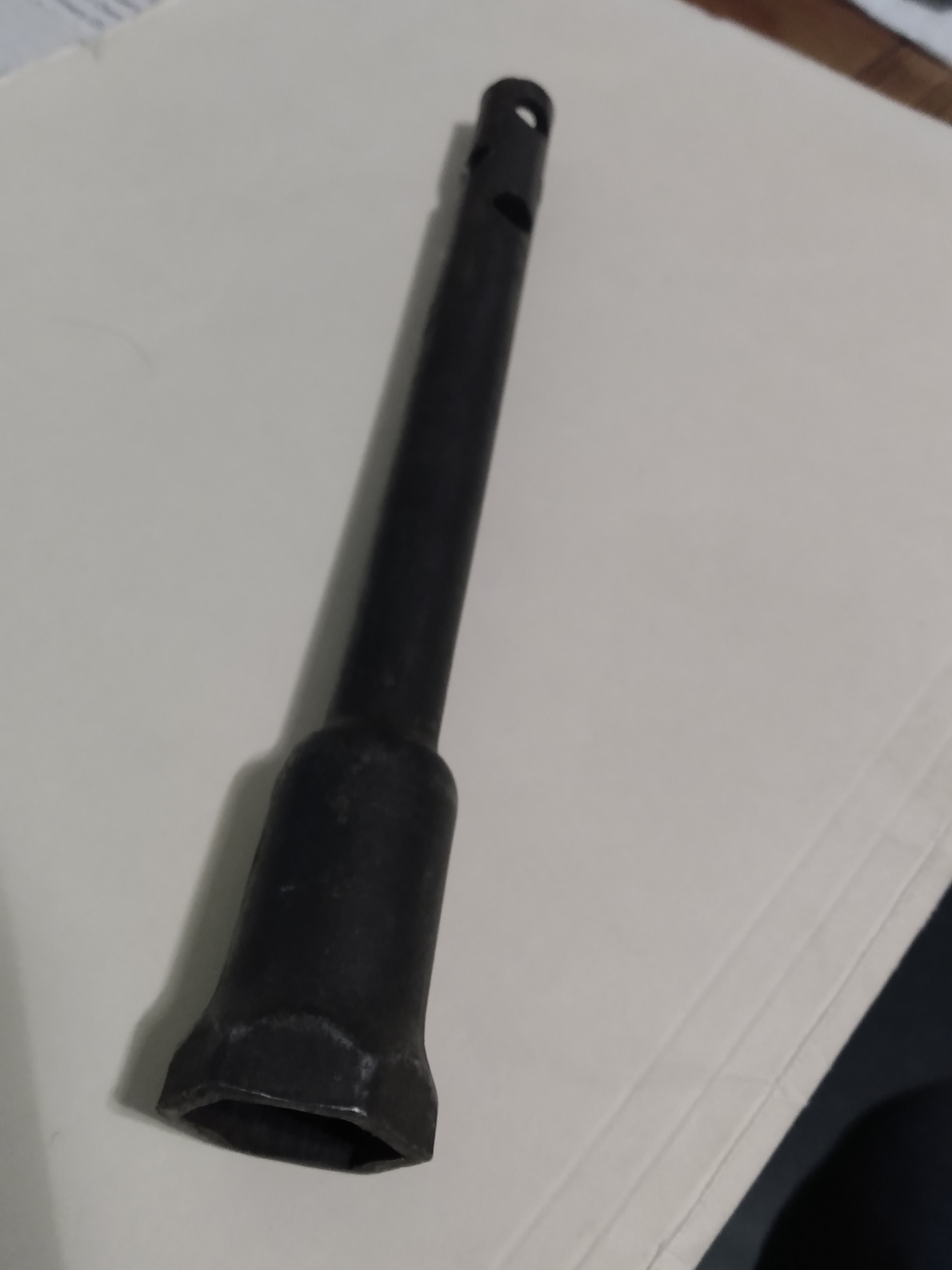

fixer34
post Nov 30 2022, 05:40 PM
Posts: 1,399
Joined: 16-September 14
From: Chicago area
Member No.: 17,908
Socket and insert from a FLAPS. It is not 'necked down' though like yours. Might have to trim the insert-it is high density sponge rubber.
This is the plug tool I have. Anyone recognize it?
I didn't want to pull the insert, but it looks like a harder rubber. As suggested, like a plug wire boot. Maybe make a junkyard trip and pull a couple?
Jamie
post Nov 30 2022, 06:23 PM
Posts: 1,193
Joined: 13-October 04
From: Georgetown,KY
Member No.: 2,939
QUOTE(fixer34 @ Nov 30 2022, 03:40 PM) *
That appears to be the standard plug tool that came with my 73 914-4 tool kit.

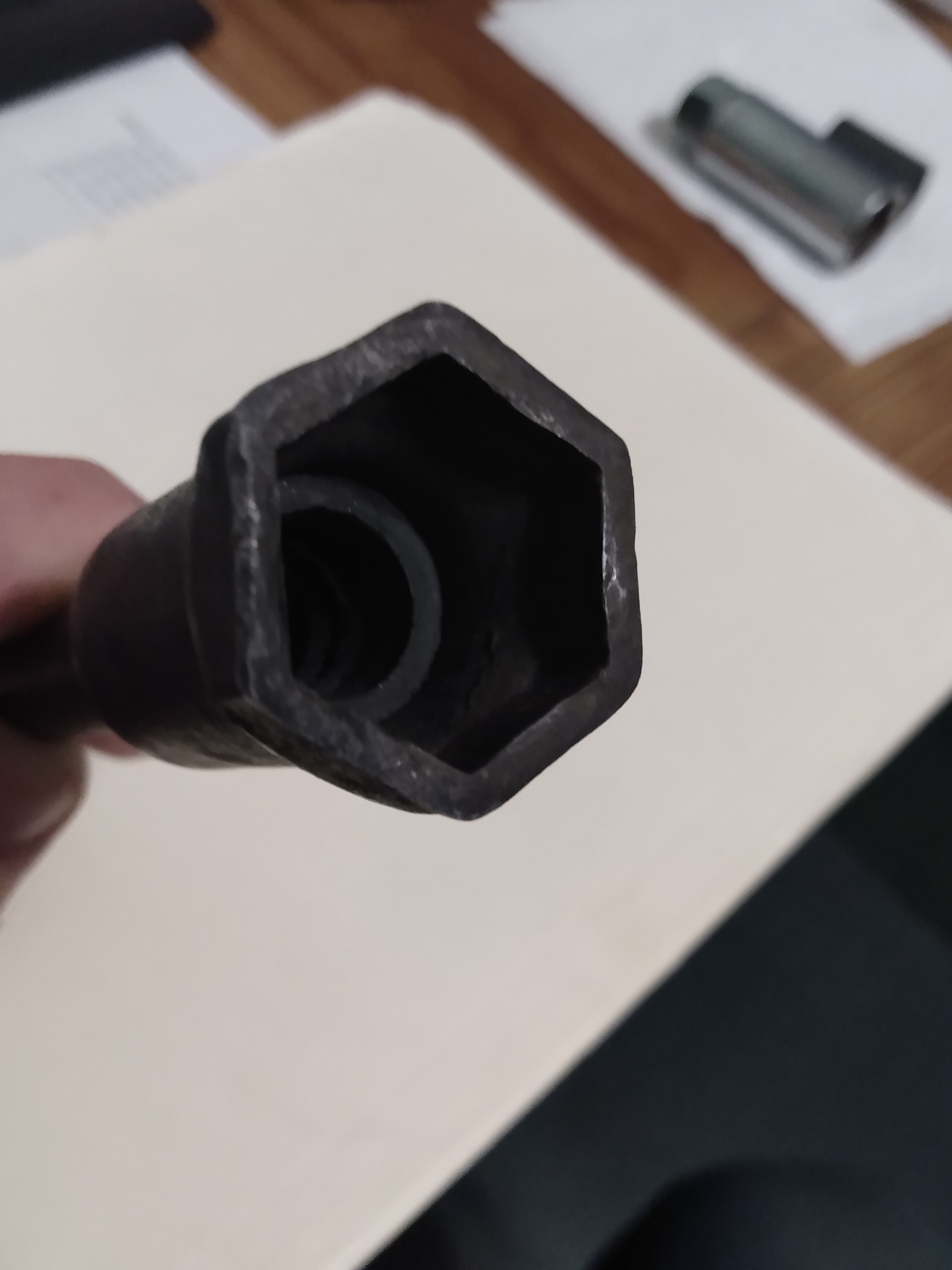

mskala
post Nov 30 2022, 06:55 PM
R
Posts: 1,935
Joined: 2-January 03
From: Massachusetts
Member No.: 79
I have the whole tool, but the rubber fails to grab any more, so
I pulled out the rubber. So this is what it looks like.
Sierra Madre is selling new spark plug wrenches but they don't really
match the old ones, so like everybody else, I think I want to find a cheap
new generic one and grab the insert if it matches well enough.

post Nov 30 2022, 07:44 PM
bdstone914
Posts: 5,270
Joined: 8-November 03
From: Riverside CA
Member No.: 1,319
QUOTE(mb911 @ Nov 30 2022, 06:48 AM) *
@mb911
Do you have an insert from a 944 spark plug tool?
I think they are very similar. If i remember correctly the insert has four ribs that run lenghtwise.
Bruce
