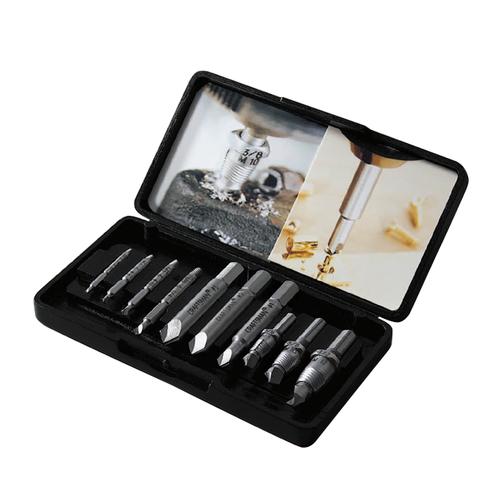

go to Sears and get a set of these:
Screw-Ups(OK, they actually call them "screw-Outs and Drill-Out" but we all really understand...
left-handed hardened (carbide?) drill bit cores the stud, the left-hand spiral threads grab and extract.
911 exhaust studs are M8x1,25 (i think. might be M8x1,50. take one with you to the FLAPS to match...)

Rich thanks for the link, but man I'd like to accomplish this task without spending ANOTHER $70 (IMG:http://www.914world.com/bbs2/html/emoticons/wacko.gif) . I know It would be an investment for the future but I have too many of these unexpected expenses already. With that said, I may have to get it anyway. Thanks.

As has been mentinioned, left hand drill bits are your friend.

if you're *sure* you've simply cored the steel, a left-handed drill - possibly operated by hand - might just grab the remains and pull them out. once the middle of a threaded fastener is removed there's nothing to tension the threads... or pretty gently, use a screw extractor. NOT a square "EZ-out" - those are pretty useless. screw extractors look like left-hand threaded VERY coarse spiral auger bits, and they're somewhat conical. those should grab the core and let you extract it without wedging it in harder like the square ones do.
