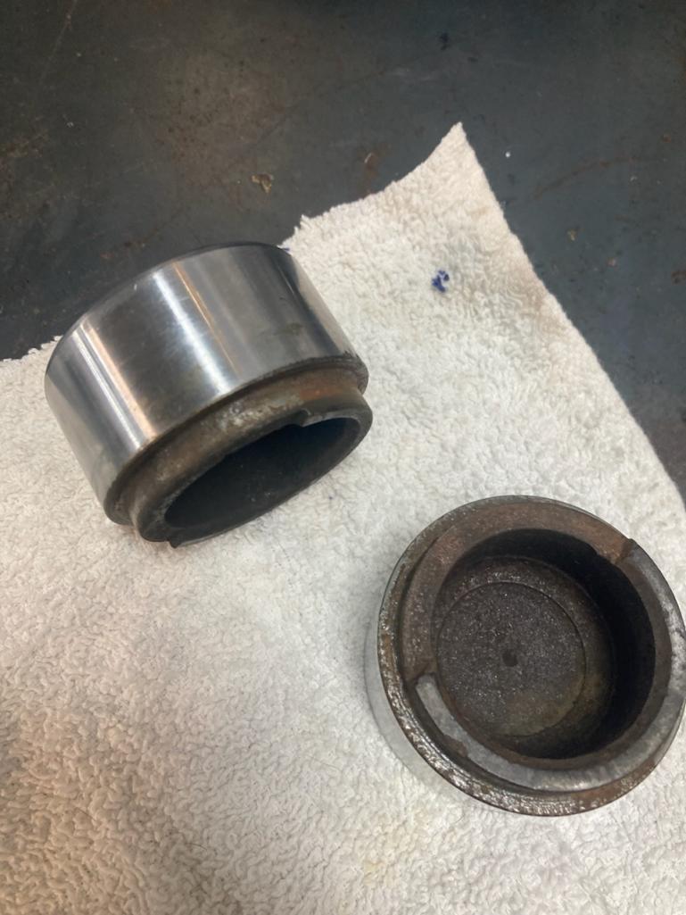

Any one know which way to orient the caliper piston on 911 A calipers?
My right and left sides are 90 degrees different from each other
I’m doing a maintenance rebuild and I assumed I could put the pistons back as before until I found the RF to be different than LF
Picture of the cut edge:

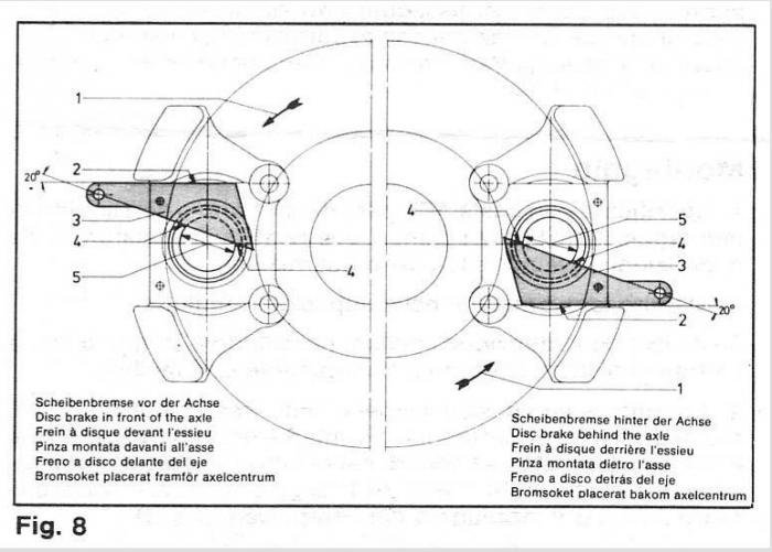

The 20° Notch will face upward toward the bleeder on each one. I don’t have the graphic on my phone right now. I’ll load it when I get to a PC

Here you go
