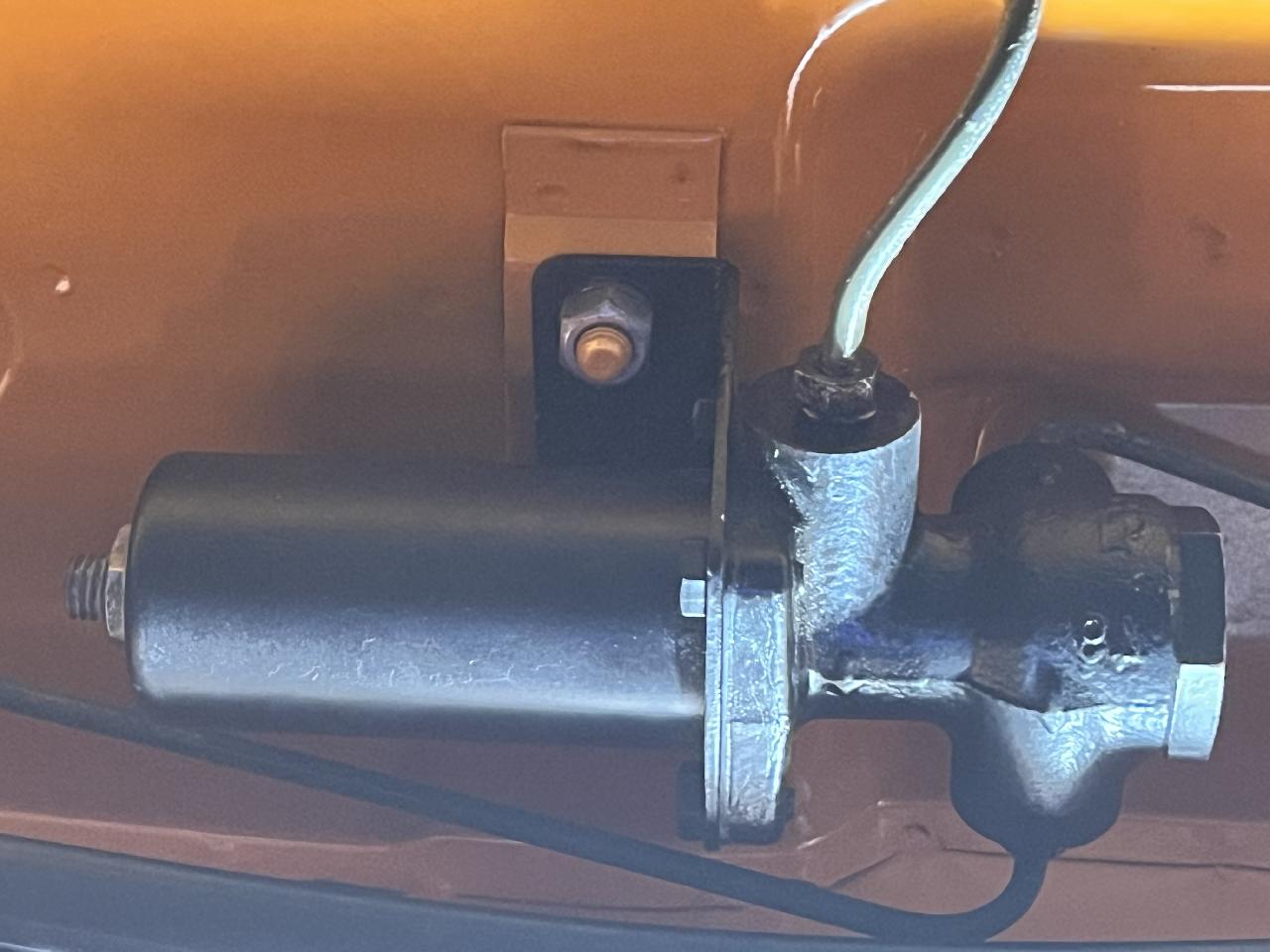

> finally got behind the wheel to bleed brakes, hit a snag with the rears
Type 47
post Dec 10 2022, 07:31 PM
Posts: 792
Joined: 1-June 10
From: St. Louis, MO
Member No.: 11,790
It was super cool to get behind the wheel, even though I'm sitting on a 6x6 piece of wood.
so bleeding the master and front went OK; we got nothing on the backs.
I suspect the brake pressure regulator needs to be wacked or something.
Please advise before I do something stupid.
Some videos show a different BPR, this is a 75'

FlacaProductions   Are your rear soft hoses expanded closed/clogged?   Dec 11 2022, 01:24 PM
Type 47   Are your rear soft hoses expanded closed/clogged?...   Dec 11 2022, 05:04 PM
Type 47   So is the BPR adjustable?? the alien screw and nu...   Dec 12 2022, 08:21 PM
Superhawk996   Regulator is set at at a specific brake pressure k...   Dec 13 2022, 06:02 AM
