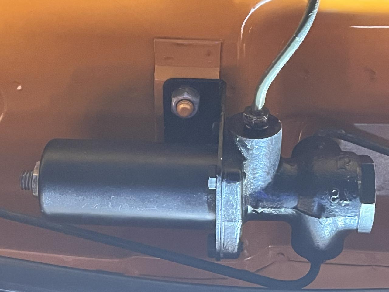

It was super cool to get behind the wheel, even though I'm sitting on a 6x6 piece of wood.
so bleeding the master and front went OK; we got nothing on the backs.
I suspect the brake pressure regulator needs to be wacked or something.
Please advise before I do something stupid.
Some videos show a different BPR, this is a 75'

Click to view attachmentI would get a GOOD flare nut wrench and try to bleed at the line going IN to the regulator, then once the air is done "popping" at that location, pick an outlet line and try it there...then if all goes well move to the caliper. If at some point you are not succesful, then your restriction is between that point and the last one that you were able to bleed.
Have a water hose ready to rinse off whatever brake fluid spills on painted surfaces

So is the BPR adjustable??
the alien screw and nut on the left indicates it should be, but it was not possible to move without rounding off the nut.
Superhawk996
Dec 13 2022, 06:02 AM
Regulator is set at at a specific brake pressure knee point. It is not meant nor should it be user adjusted. It’s operation and operational set points (914/4 vs 914/6) are outlined in the factory service manual. I don’t have the chart with me at the moment but it is a straight pass through of rear brake pressure initially.
Adjusting the regulator will not help you bleed the rear brakes.

You might have better luck using a pressure bleeder to move fluid through system. You either have blockage, a leak, or not enough fluid in the system.
Did you install a new MC? If you haven't removed the belly pan/mc cover yet (or put it back after installing the MC), remove it and check there for a leak.
Have you checked to see if the line is blocked going into or out of the regulator yet?
When bleeding brakes on a 914, I've always read to start with the right rear (furthest away from the MC).

If the MC is oldder the piston can get stuck in the end of MC , if you fully stroke ..while pumping...

We didn't put a new MC. The car was completely disassembled, painted, and now being reassembled.
there is fluid coming out of the feed line. we did start with the rears but when no fluid went to the fronts. they bled fine.
